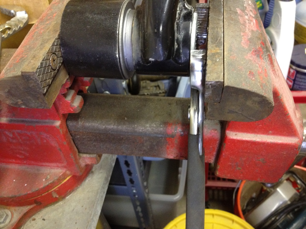

Next, pressing the new ones in. I used my bench vise, one of the cylindrical press sleeves from a rented ball joint press, and a pair of channel locks:

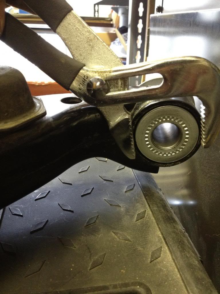

The idea behind the channel locks was merely to create a space for the inner part of the bushing in order to press the outer in completely via the vise.

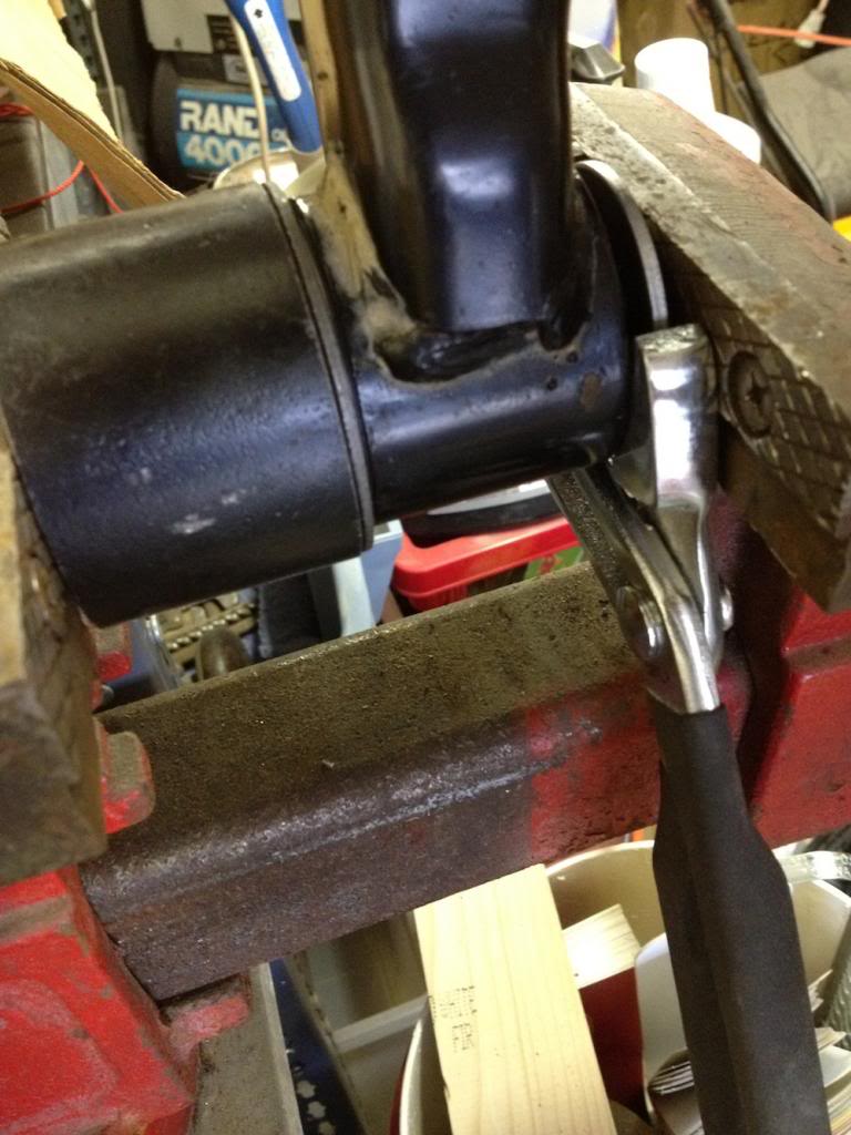

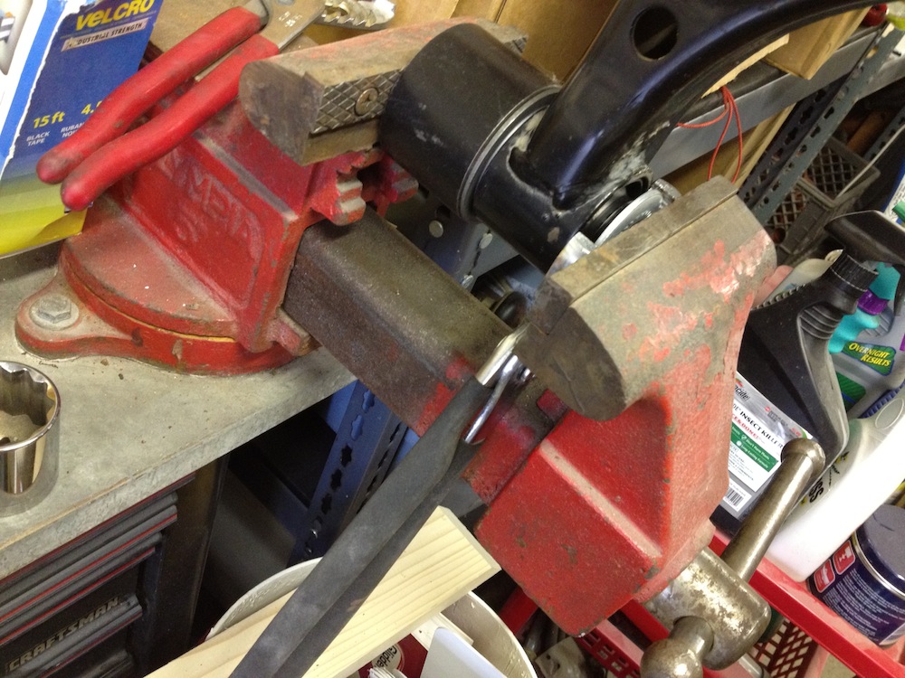

Although a bit of a juggling act to get each stack lined up in the vise without a helper, it worked like a charm - done with all four in about 20 minutes.

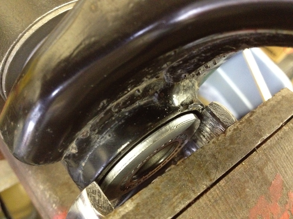

Bam!
