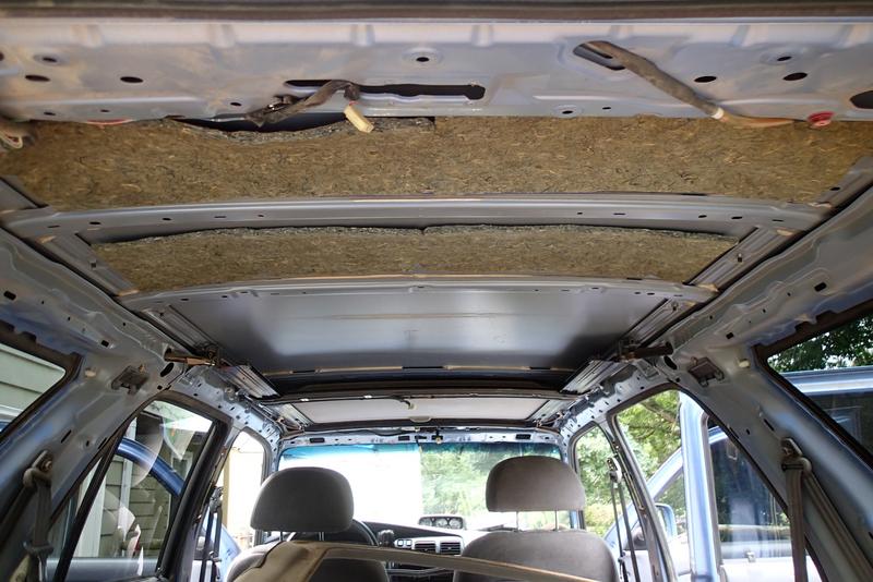

IIRC dropzone said something about the 2nd gen not having an internal rail support? I know the 3rd gen does:
to be honest i am not sure, i haven't gone to the extent as you did to pull the head liner completely out..not brave enough!

Yeah, 2nd's do. I'll stop hijackin' and start a thread. I'll try to post up a pic of the cross rails on the 2nds.
(Which may be a bit delayed as I "get" to go back to work manana. Hurray for 14 days on.) Hello How-Tos.
That far back one, BTW, actually bolts on. There is a system of 'supports' of some sort that actually hold the sheet metal up off the cross pieces. And I couldn't make my little cheater for the 6mm nutserts work. so hafta try to find an anvil / jabadabber to pull it up.
