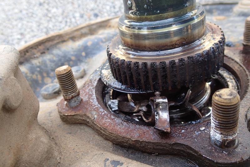

96 4Runner 297,664 miles
Found the cause of the slight rattle/squeak that started on Feb 8th, pulling out of the parking lot on my way home from work. Parked it when I got home,
pulled the right rear drum on the 12th and saw nothing. I couldn't get it to squeak again until I reinstalled the drum, and it was very intermittent and hard to hear. Pulled the abs sensor to see if the axle shaft had been moving/rubbing against it but aside from some black junk it was fine. Wiped off junk and reinstalled.
Kept it parked until the 16th, when I drove it for a beer run. Could no longer hear the noise but oddly the abs was activating at the end of stops during this run. Checked the sensor wires all the way 'round and all looked good, was suspecting the problem was at the right rear again.
The snow melted and went away so I pulled the right rear abs sensor and sure enough, full of junk. With sinking feeling pulled the right rear axle. Bingo.
A lot of ughs were said, and several yeps.
There was never the tell-tale oil all over the tires from a wobbling axle allowing oil past the seal. Until the rattle/squeak there wasn't anything growling or too weird sounding. I'll get a new Toyota bearing and seals and have it pressed by Phase II machine because they know how to do it correctly. Getting one of these axles out is scary easy, remove tire, 4 nuts, brake line, parking brake cable keeper, remove axle.
Went through my records, the right rear wheel bearing had about 120,000 miles on it, last replaced with toyota parts in 2008

That bearing is toast! I'm glad your diligence to weird noises paid off. I'm curious why you ordered new parts though. Don't you have a green parts rig hanging out at your house?

FYI -- you don't actually need to get the bearings directly from Toyota. Our axles (the 96-00 ones) spec a 6308 double-sealed bearing which is a standard size. I was able to find some Nachi's for $25 each when I did mine. The factory original ones in there were Nachi's as well.

My lovable husband said I should just throw Land Cruiser axles at both ends.
Hmmmm.....Yeah, I knew about the bearing and seals- not that I thought of them when I ordered my parts- and I'm not sure about the retainers. Phase II will re-use the abs ring so yay for that. Maybe I should've gone your route. Too late now, at least this should be the last one until another 120,000 miles, knock on wood!
Toyota 90363-40020-77 Bearing 64.72 is what I've got coming.
You know Mr. Rustbucket, thanks for bringing it up, It's good info that there's options for anyone reading this and needing to do their axles, Nachi, Koyo, I also saw Marlin Crawler has a kit though it doesn't seem to entirely match what's on there now.

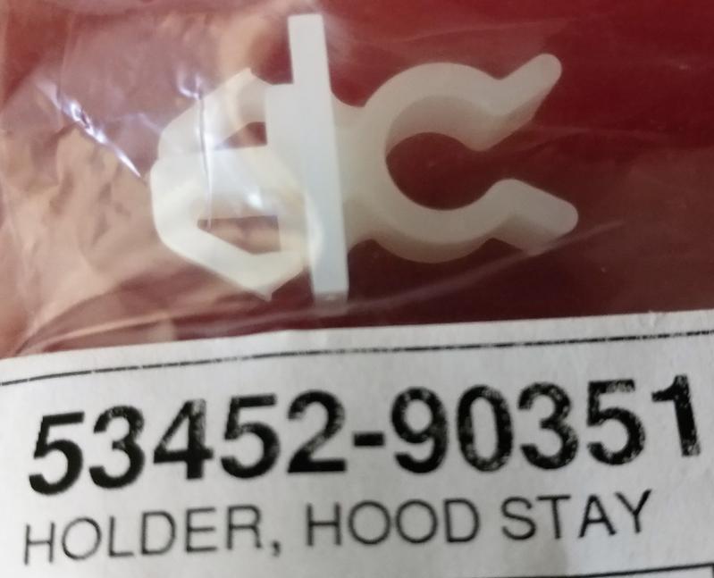

Waiting for the axle. In the meantime I replaced the hood support doo-dad that broke this past week. Easy, didn't worry about breaking the clip to get it out since it's not re-usable.

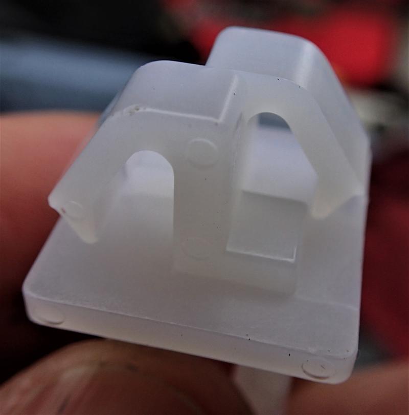

If you ever do need to get it out it's a staggered clip
that you can get to from the front of the support. Very obvious. Push in to install, also obvious.

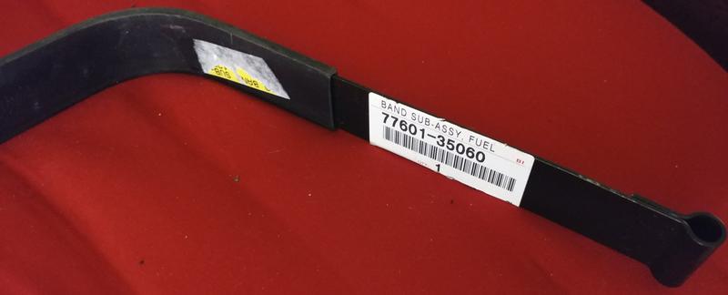

Also picked up a fuel tank strap for the '99 since the one it has rusted through and broke. This is available aftermarket from suppliers like Dorman but doesn't come with the insulator. Toyota's does:

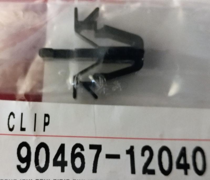

And got some of grille clips: they occasionally break:
