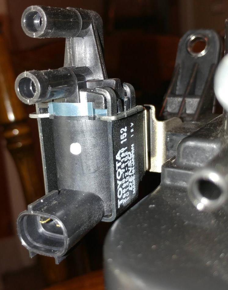

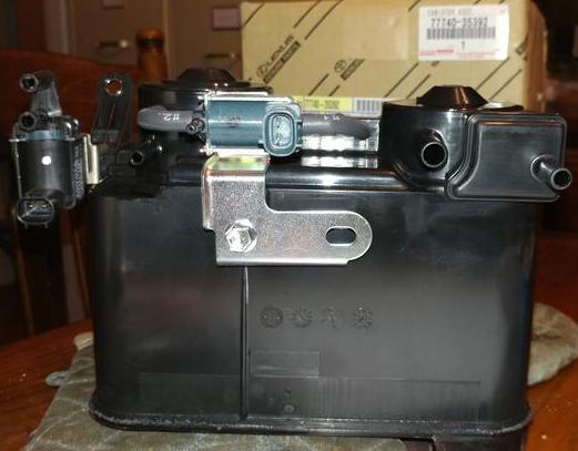

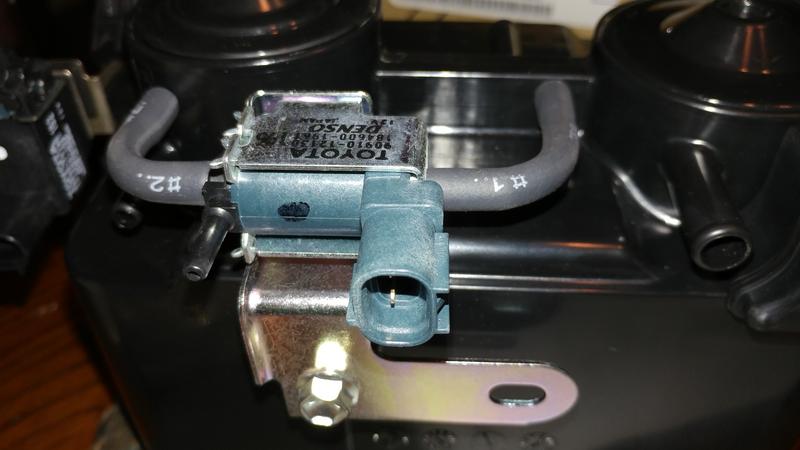

Gave in and finally bought a new moo box, er, charcoal canister. While my box tested fine without leaks both of the vsv and vsv for evap valves were bad, one working intermittently and one not at all. Have not gotten codes for anything other than the (I think) unrelated P0420.
$206.06 + shipping from LaGrange Toyota for vapor canister #77740-35392
I went ahead and got the assembly because it comes with the 2 vsv's and my canister is almost 23 years old so I figured since the cost of the 2 parts I need costs:
25860-75140 $78.40
90910-12268 $118.12
(replaces discontinued 90910-12130)
Total: $196.52 for Toyota parts
Dorman makes a vsv for evap for around $42 but I didn't want to go aftermarket on this part. I don't think they have the vsv but I haven't looked that hard into it.
Vapor canister
VSV
VSV for Evap
Will be installing today when it cools down.

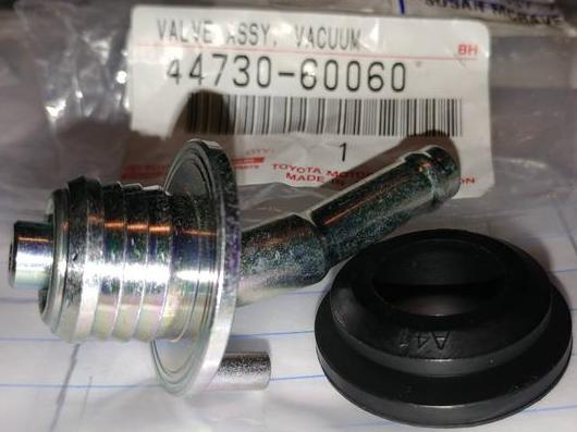

I also got a Check valve and grommet for the 99's brake booster. Super-stiff brake pedal when it's cold, doesn't want to stop. Apparently this is a common problem. Some people have mentioned cleaning the valve out but I went for the new part.
44730-60060 Valve assy, vacuum
90480-24015 grommet (superseded number)
I'll try to grab pics when he replaces it.

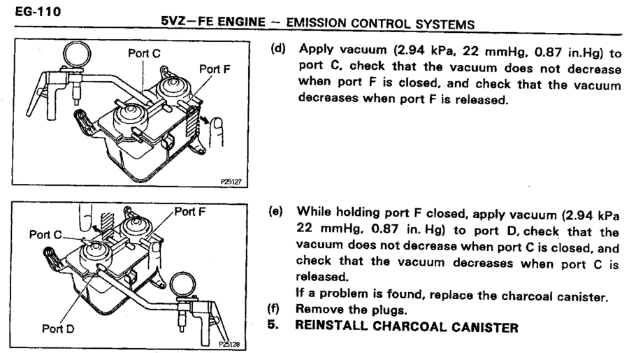

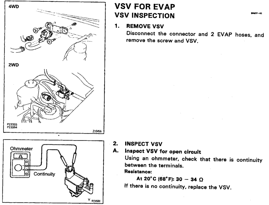

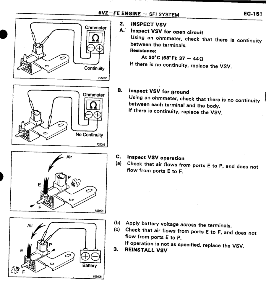

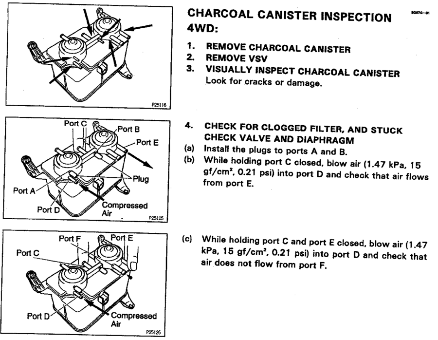

Test procedures I used for vsv for vapor pressure sensor (on top of charcoal canister) and vsv for evap (on the side of the canister closest to firewall) and the canister itself
FSM EG109- Charcoal Canister inspection:

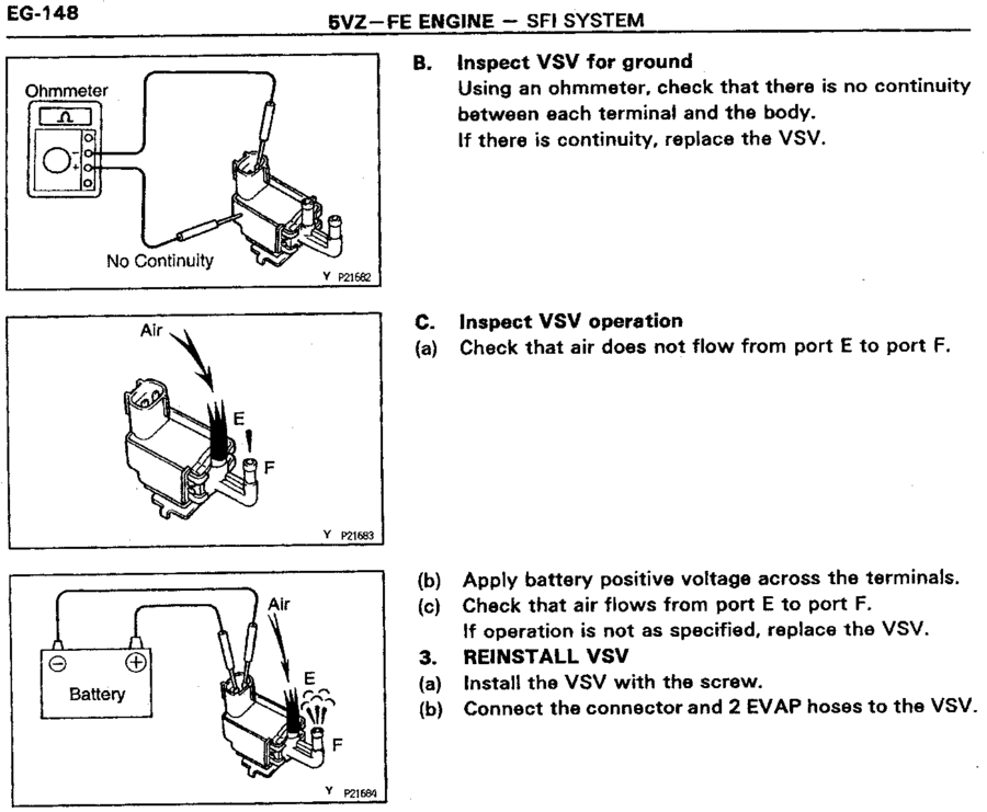

FSM EG147- VSV for Evap:

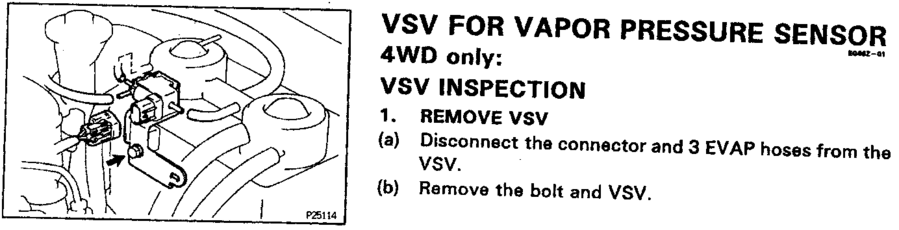

FSM EG150- VSV for Vapor Pressure Sensor 4wd only:

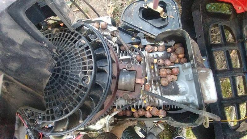

Darnit Jim! I'm a lunch lady, not a lawn mower de-seeder!
Not a lot going on. Slight fuel smell on deceleration, that's driving me crazy. It comes in to the cabin via the vents but when I pop the hood I can't find the smell there.
Also there's a weird steering thing that's vague but not right somehow.
Went ahead and ordered speed bleeders for the front that should be here Thursday.
Had a great hike today at Hawn State Park which is an excellent place.
Afterwards I started the lawn mower when I got home and it sounded like popping corn so had to deal with that ^. Also pulled a squishy mouse out of the seat. That was pretty gross. I neglected to get a pic of that for some reason.

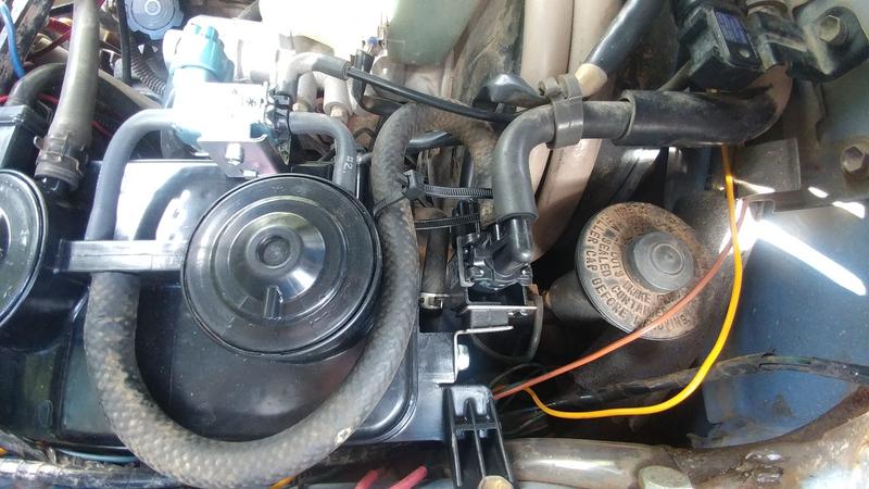

Got home and could smell the gas smell again so I popped the hood to see what I could see. Nothing......nothing......nothing......nothing.... ..
something! Spot the problem....it took me a bit to find it.....
Can't believe I missed it.
Old Oct 10, 2018 | 01:30 PM
  #3655
old87yota's Avatar
Joined: Jun 2013
Posts: 3,112
Likes: 582
From: Portland, Oregon, USA
I am not all that familiar with these, but it looks like a hose is disconnected on the right side of the canister.
Am I correct or do I need to keep looking?
This is like a game of "Spot the six Differences" in the Sunday Comics.
Old Oct 10, 2018 | 01:52 PM
  #3656
habanero's Avatar
Joined: Sep 2005
Posts: 8,247
Likes: 497
From: mo
Wow, that's awesome. Also-
Where were you when I needed you?????
I'd pulled it to put the new bit of hose on the VSV for Evap to Canister (zip tie to help it form the 's' shape) and apparently didn't un-pull it.
The barb for it is directly under another hose where I didn't see it.
I'm going to have to do stupider harder to figure out stuff to keep you entertained.....
Hummm.... I don't know where I was....... definitely not near MO!
I had to zoom in on the picture and stare at it for a few minutes to see that the hose was not connected. Even then, I really did not know if there was a connection that I could not see.
To make it harder, take the pictures in the dark. We will probably never figure it out!
