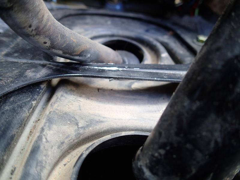

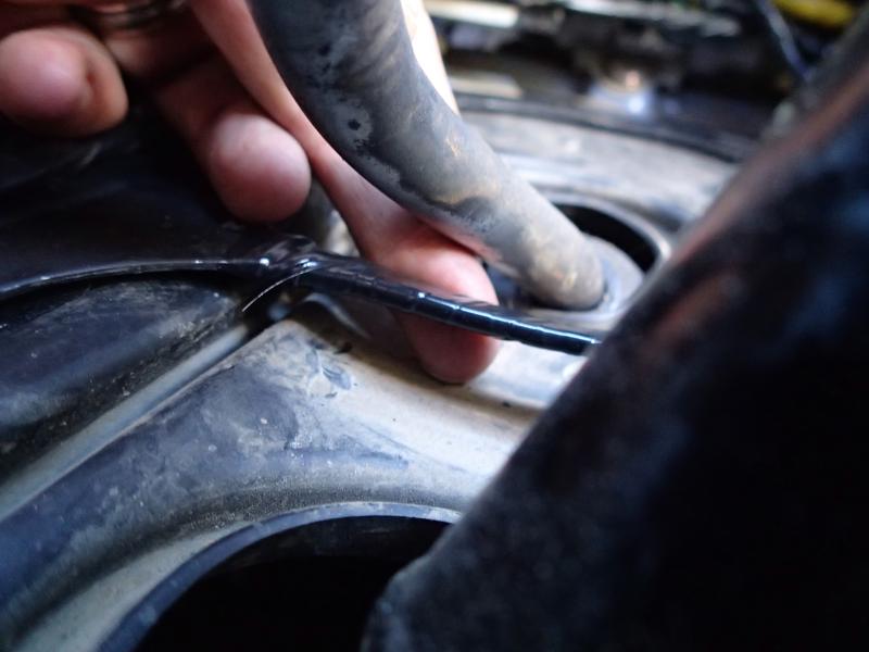

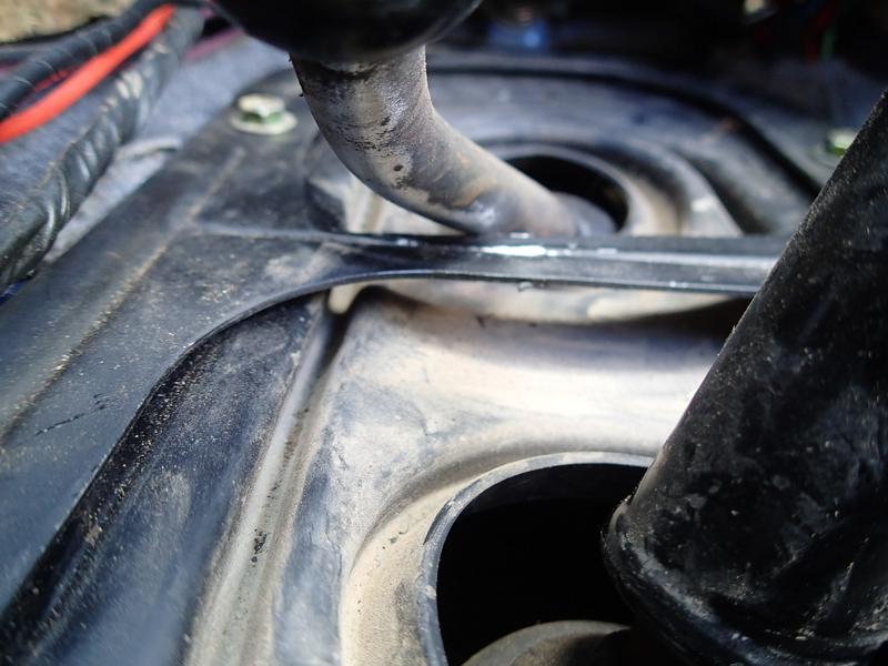

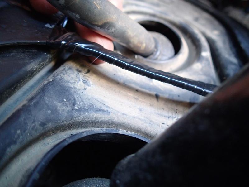

Addressed the shifter issue- the truck was popping out of 2nd especially and occasionally 4th mostly when in 4Lo.
I'd already adjusted the metal frame that fits between the body gasket and boot gasket by cutting out the section that was getting hit when in 2nd gear after replacing the trans mount. Now that the motor mounts and possibly even because of the new body mounts I'm getting shifter interference again- except this time it's enough to pop it out of gear if I am in 4wd Lo and especially if it's somewhere I didn't suddenly want to be not in gear.
Pulled off the pleather boot and the rubber boot gasket to see what's going on at the metal frame.
2nd
4th

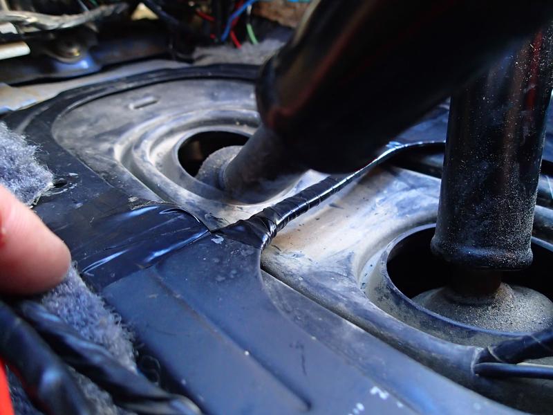

some chopping, some downward bending
2nd
4th
Chances are without the 1" body lift this wouldn't be a thing, but that and the 1/2" I gained from the new body mounts and the position shift from the new engine mounts all came together to make it a thing.

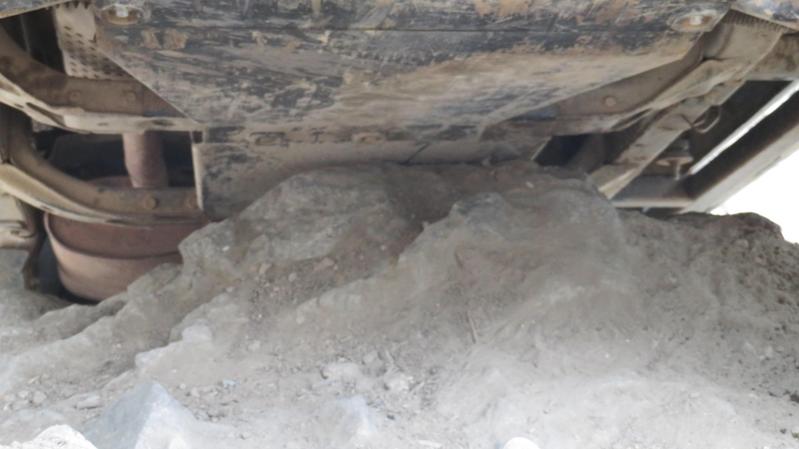

but the hubby had to give it a try. Of course it looks 'flat'- this is partway up. I ended up pulling the bikes off the rack to avoid damage to them.
We decided not to winch up and drag our underbellies up the rock and sparing the driveshafts, exhaust and gas tanks potential damage.
So we abandoned that idea and headed back over to Old Monarch Pass for another night with plans to mountain bike from Marshall pass on down.

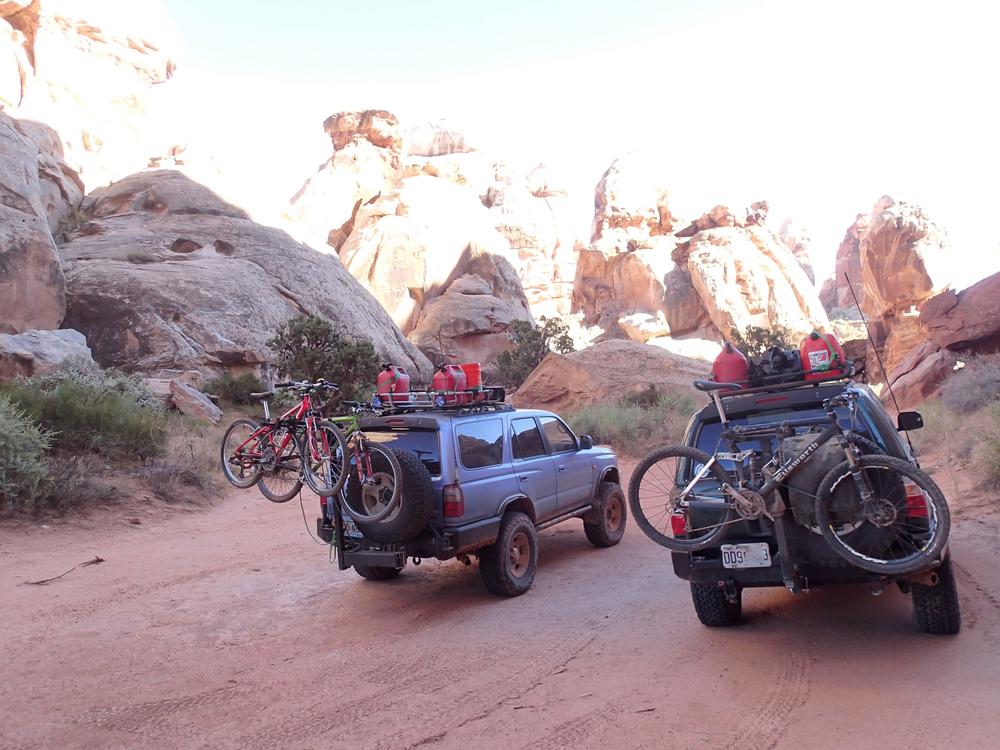

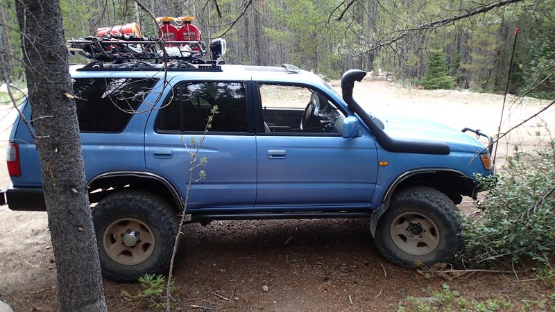

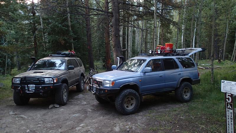

Just curious what the home depot buckets on the roof were used for?
How much weight did you have on the roof racks? I was planning on a couple of 5 gallon gas cans but some folks were saying it would cause a top heavy feeling...that whole pesky center of gravity physics BS..
Old Sep 21, 2018 | 06:09 PM
  #3637
habanero's Avatar
Joined: Sep 2005
Posts: 8,247
Likes: 497
From: mo
Originally Posted by dropzone
looks like a great vacation Habanero! Pics of the scenery and trails are awesome
Okay....just remember you asked!
The Let's Do This bucket is for....um....doo. The grey briefcase looking thing on the rack is a toilet and, well, the, um, end results get packed out.
(you asked)
Pett toilet
https://www.amazon.com/Cleanwaste-Go-Anywhere-Portable-Toilet/dp/B001TKGAKO/ref=asc_df_B001TKGAKO/?tag=hyprod-20&linkCode=df0&hvadid=167119746601&hvpos=1o4&hvnetw=g&hvrand=17166583385996655393&hvpone=&hvptwo=&hvqmt=&hvdev=c&hvdvcmdl=&hvlocint=&hvlocphy=9022814&hvtargid=pla-306581012858&psc=1 https://www.amazon.com/Cleanwaste-Go-Anywhere-Portable-Toilet/dp/B001TKGAKO/ref=asc_df_B001TKGAKO/?tag=hyprod-20&linkCode=df0&hvadid=167119746601&hvpos=1o4&hvnetw=g&hvrand=17166583385996655393&hvpone=&hvptwo=&hvqmt=&hvdev=c&hvdvcmdl=&hvlocint=&hvlocphy=9022814&hvtargid=pla-306581012858&psc=1
Wag Bags
https://www.austinkayak.com/products...k-Wag-Bag.html

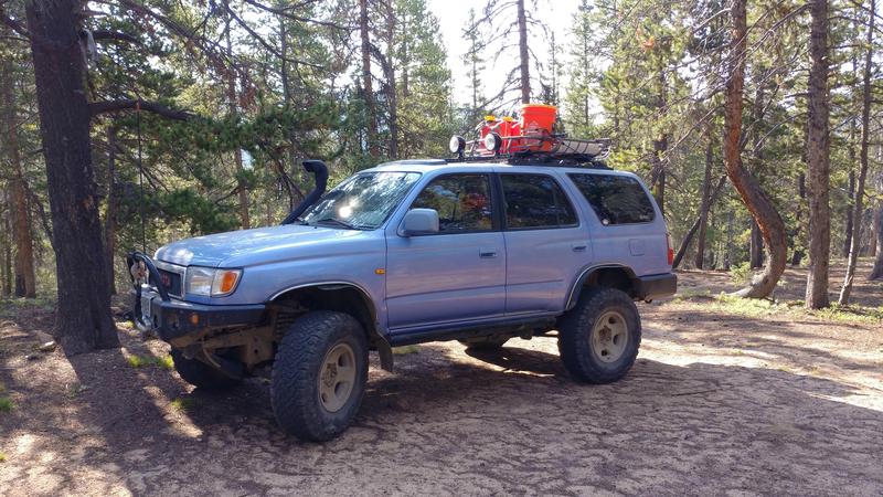

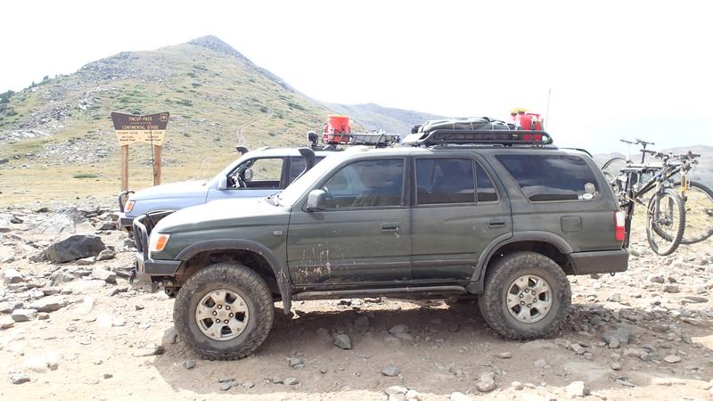

This year we weren't doing the Maze district so we each had two 2-gallon gas cans. I had those, the bucket which never got more than 1/3 full, a bones bike rack and the toilet so not a ton of weight this time, under 50#.
I have used two 5 gallon tanks, a bike rack, the toilet, the sometimes full bucket, and a shower enclosure on the rack in the past. I didn't notice being top-heavy (a lot of weight inside the truck too) or feeling uncomfortably more tippy than normal.
I did originally put both 5 gallon cans in one corner of the rack. That was a mistake as it bent the load bar. The next time I put one on either side. Same trail but no bent bar.
If you haven't got one I recommend one of those shakey siphons with hose long enough to easily reach the gas tank filler. Much more convenient. I also fill the cans as they sit up on the rack rather than fill and lug them up there. https://www.basspro.com/shop/en/bass...ops-e-z-siphon + longer hose from hardware store
So far the best conventional plastic can I've used is the No-Spill. https://www.tractorsupply.com/tsc/search/gas%20can
Here's from a few years ago with everything but the Bones bike rack, hubby has chairs, table and gas cans.
This year with the smaller cans in the front center of the rack
There's no way I'm putting gas where someone can run into it, I lost some childhood friends from a scenario like that when their rv was rear-ended. I'd rather have it up out of the way thank you very much. It would be either that or a well-protected aux tank underneath, but I'd have to move my air tank to do that.
To each their own.

haha, i figured the bucket was a poop pot. Thanks for the info on driving characteristics. I am just gonna have to throw some junk on the roof and see how the truck drives. Having weight down low to sort of counter balance the top load makes sense in a physics science sort of way.
I have an assorted collection of cans ranging from the 2.5 gallon NATO style (they tucked away nicely in a spot on my old tacoma) to the 5 gallon Nato type.
I also have some of the 4 gallon Rotopax that i like because they lay nice and flat. I have thought about an auxillary tank in the back where the spare use to mount. It would probably be a transfer tank and not full all of the time. with a 16 gallon tank at 14-15 mpg the range on my 4runner is pretty limited.
I hear you on limitation! The Rotopax look like they'd be nice for setting in the rack, but oh, that price!
