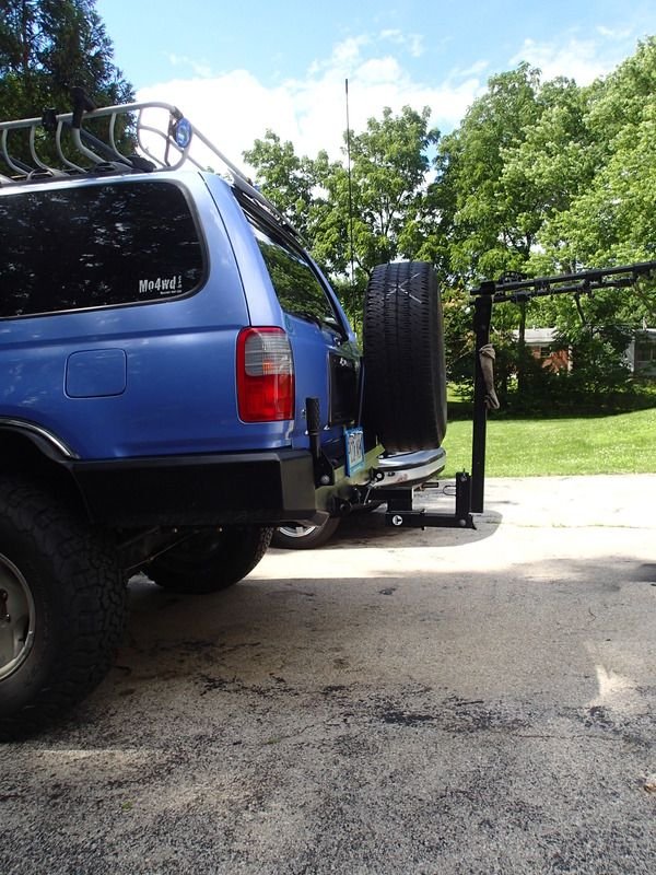

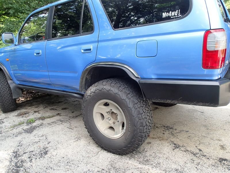

Trimmed the home made mud flaps to go with the 4xInnovations bumper. May have to get something to cover below the bumper. Don't have to have them, but don't want to throw any rocks at anybody, either. Will have to see how bad it is. Will also have to see if CO UT IL KS and OK are mudflap states too, I guess? Or does it not matter if I'm out of state...I forget these things...
Got a 4" drop/rise 6" hitch extender to get the bike rack to work with the spare tire. It was the shortest length I could get and fits about perfect in that direction. Low for everyday will allow the spare carrier to open with the bike rack on (no bikes), high for those bumpy bumpy roads we sometimes get to take though the rack would have to come off if I wanted to open the hatch. I'd still rather have a left-hand swing away rack, I think, but this'll do for now.

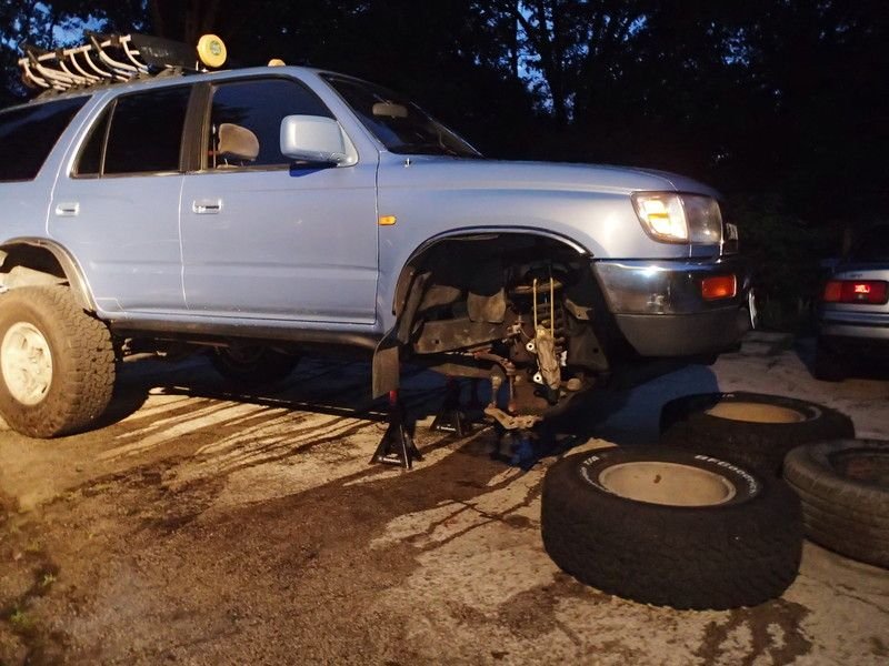

So when I did the cv reboot on the left I noticed a lot of brass shavings on the backside of the hub.
Which got me to thinking. Which of course led to going overboard with it.
I've decided to replace the non-abs spindles with the abs spindles that were originally on the truck. I will have a new bearing and the manual hub pressed in and put the abs ring in there instead of the spacer.
There is a nut on the back of the manual hubs that has to come off. It takes a special tool and is torqued to 203 ft lbs. I set the lugs into a spare tire so the thing wouldn't move around. The hubby and kid stood on said tire. I used a cheater bar with a cheater bar with a cheater bar. Still took quite a bit of steady oomph before it popped loose.
Whew.
I'm going to have the hub and bearing presswork done by someone who isn't me. Currently one of the upper ball joints is not willing to part with the a-arm. Pickle fork, big hammer, puller, nope, nope, nope. I've got it sitting with some b'laster and tension with the puller, hoping it cries uncle or I'll be back at it tomorrow.
Why is it always just one little bolt?
Pic, so it happened:
While I'm waiting the presswork I'll be rebooting the right side cvs. At least that side didn't have any shavings to worry me.

  #2459
dcyota410's Avatar
Joined: Mar 2014
Posts: 16
Gotta love that baby blue color. I don't see that much around where I live.
