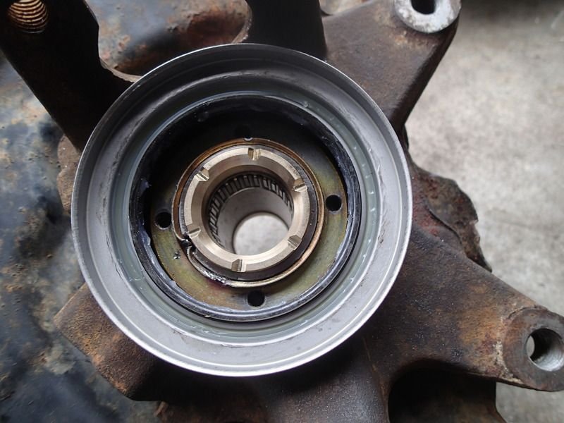

Got the parts from Off Road Solutions at 11:18 today.
Confirmed the new bearing has a race- it does- so I knocked the old one out. Got the new bearings in along with the new bushings. Froze them first and they went in pretty easy.
Upper ball joints 82 ft lbs. Brake caliper bolts 90 ft lbs. Abs in, hubs on, tires on and test drove. I'm not mad as one but I am certainly a wet cat. One very rainy day! At least I got to do the bearing/bushing parts in the garage. Had a bit of a dry spell which was nice, then more and more and more rain. I'm a little wet and dirty and have half a grease mustache, but it's okay because all I have left to do is put the abs light back in the cluster.
I'm done I'm done I'm done!!!
Pics to follow...

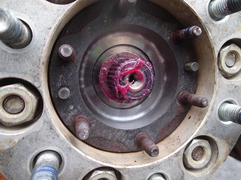

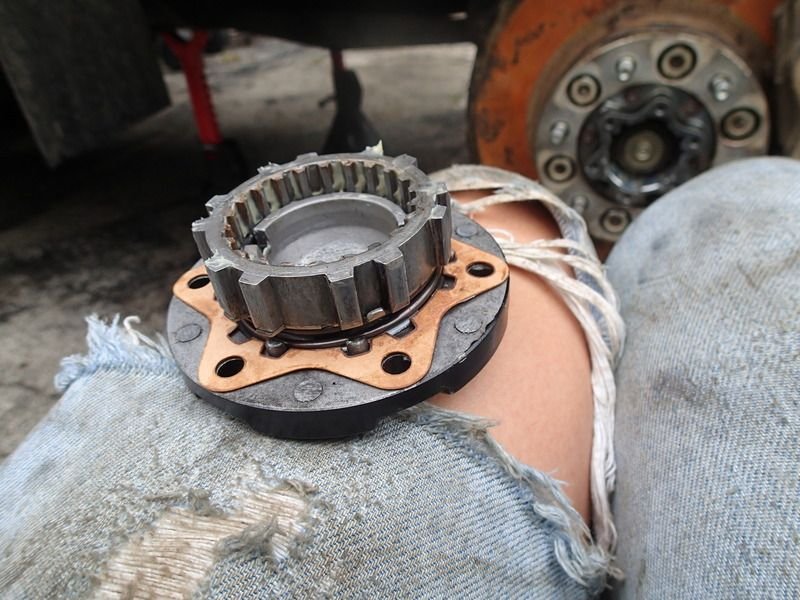

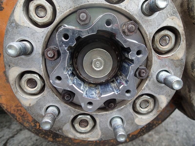

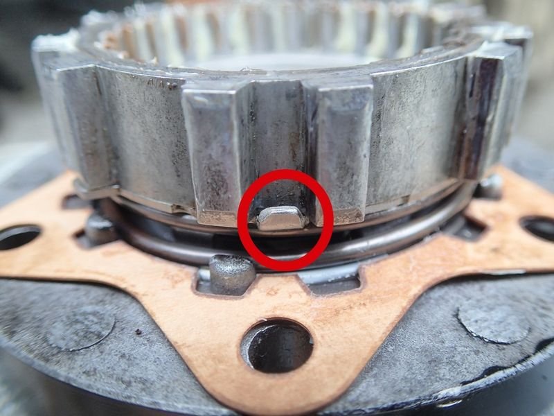

If you've got to get a cv shaft out of a manual hub first turn the dial to 'FREE'
Undo the 6 bolts that hold the dial on
dial should come off
unbolt the bolt w/large washer at the end of the cv shaft
Take out the 6 bolts or nuts (I have one hub with each) that hold the hub body on the flange. There are a variety of ways to get those stupid cone washers to pop out. I find colorful adjectives don't really help.
Take off the clip (not pictured) holding the shaft on. It's right in front of the washer pictured...
and you should have this (with or without wheel adapter):
Remove your 4 lower ball joint bolts and pull the spindle towards you. The cv shaft should be encouraged to leave the hub (I pushed mine out with a thumb)
Then it's business as usual for a cv change.
When you button it back up grease the bearings inside the hub in the spindle and the shaft. Once you get the shaft through the spindle hub it goes washer, c-clip (you may have to seat the shaft until the groove for the c-clip can be seen), hub body, little gold bolt w/big washer, dial w/mechanism and spring. The gear on the dial part will only go on a couple of ways. Where there is a small clip in the groove between 2 teeth-
that only fits in the larger single cut-out.
The torque specs on all this stuff is light, don't over do it.
While you've got it all apart a nice regrease if needed is a good idea. Go light on the grease. There are several excellent write-ups on it, better than anything I'd put together.

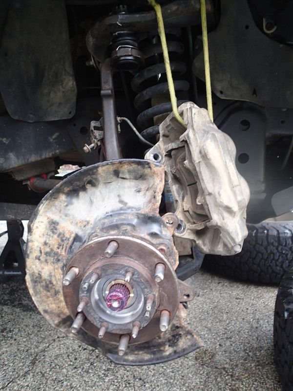

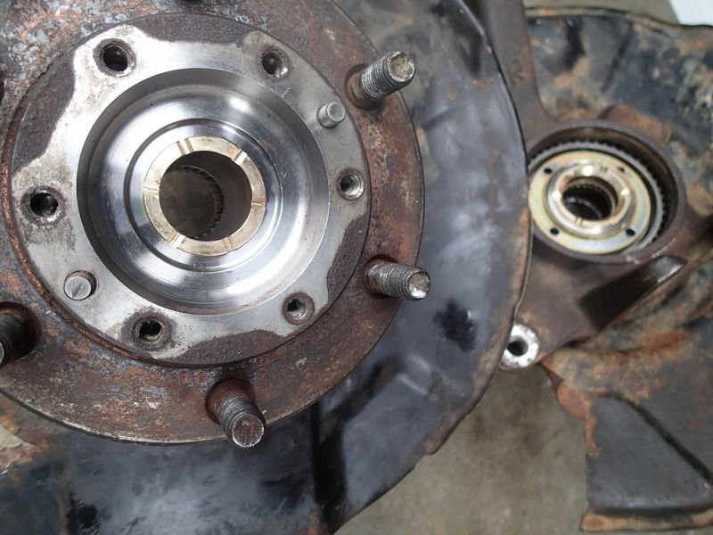

And a few random pics from today...
You can see the bushings and the abs reluctor ring behind the lock nut...
And the needle bearings (pre-greasing). The old race isn't easy to get out of there....That bushing and needle bearing is the part that got destroyed when Toyota tried to press it. The only way to get those little pretties from Toyota is to buy the whole hub that goes in the spindle. That's where ORS's having those parts solved what could have been a very expensive situation and dried out the wet cat.
