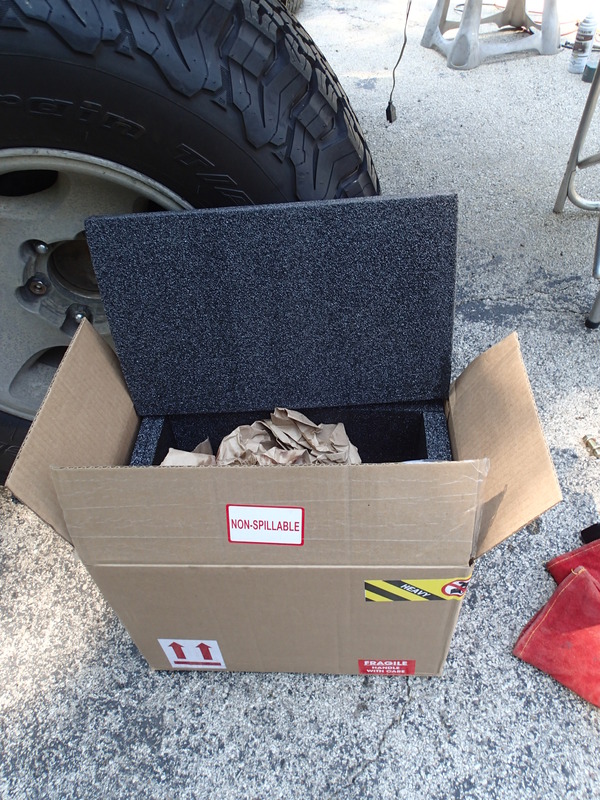

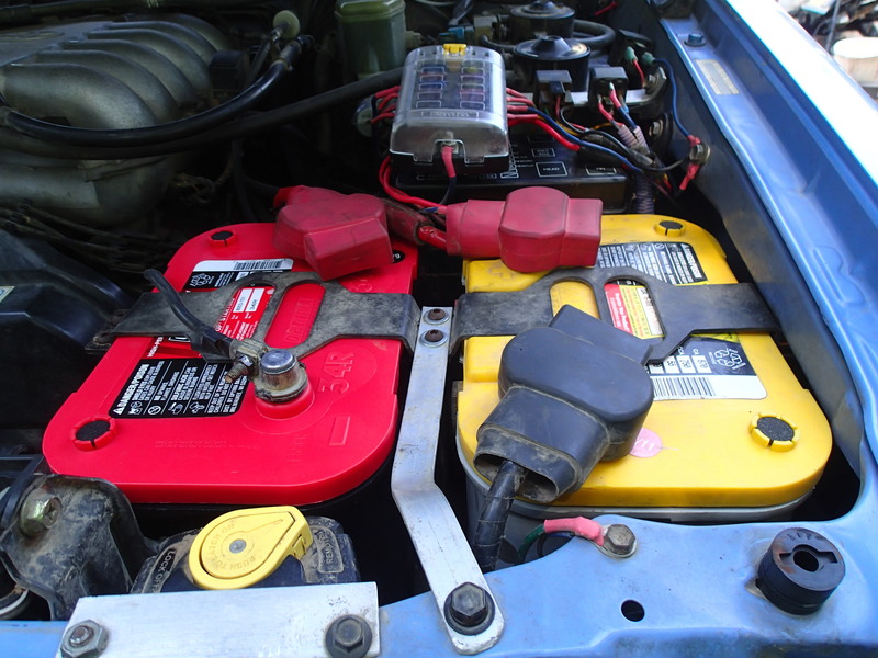

New start battery. Optima 34r red top to replace the just over 9 year old (or is it 10?) red top. Wish they were still solidly that long-lasting....
Ordered from Streetside Auto at 2pm June 4th, Fed Ex dropped it off today, 2 days later. Impressed with the speedy shipping, the freshness (built 6/15), impressed with the shipping container.
Popped it in and life is once again good good good. Thank goodness for the dual set-up or I would have had to have been careful to park on hills these past couple days.

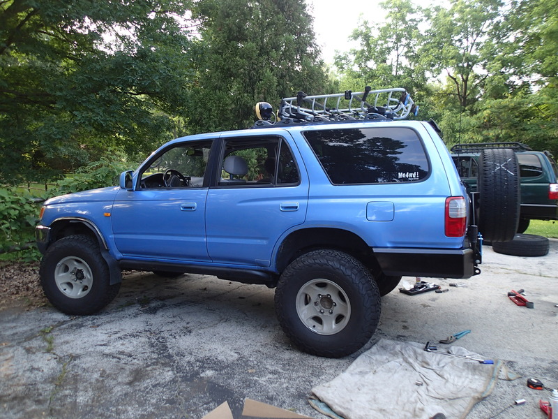

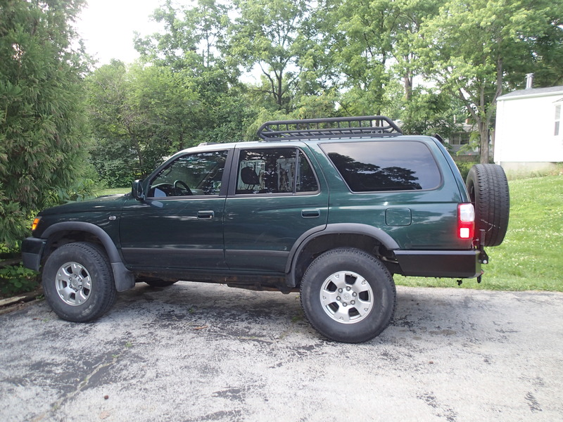

Spent Friday afternoon taking the bumper and hitch off the 96, hubby did likewise on the 99.
Spent Saturday watching paint dry!
And installing these...
4xInnovations rear bumper with tire carrier. Adam was a pleasure to work with, he answered my questions and was very helpful.
The tranny jack is useful once again. Tolerances were tight (in a good way) and the holes lined up perfectly. We needed to drill 2 holes in the frame of each truck. The foremost upper part of the wing is coming in contact with the bodies on both sides, will have to wait and see if frame vs body flex causes issues. We figured we can use washers to tilt the contact area away from the body if it comes to that.
Overall I am impressed with construction and fit, would not hesitate to buy from 4xInnovations again.
I still have to put my trim back on and I think I will be able to keep using my rear mud flaps as well. Oh, and wire up the license plate lights.
