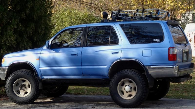

The latter is exactly what Yota Tech member habanero has done with her trusty 1996 Toyota 4Runner. She originally purchased the ‘ute back in 2005, and drove it for five years before deciding that some repairs were needed. Little did she know that his initial post back in January 2010 would turn into the ever-evolving project it’s become today.
Toyota 4Runner
That, of course, is an ongoing saga spanning seven years and 169 pages (as of this writing) of documented progress. Things began, innocently enough, with a Sonoran Steel System 1.2-inch lift and Michelin A/T LT285/75r16 tires. But they quickly escalated to include a laundry list of add-ons, as well as repairs, along the way. Not to mention a whole bunch of memorable trips and miles driven.
To date, modifications run the gauntlet from rear air bags to a bigger alternator and Bus Depot awning. A rear e-locker and manual hub retrofit helps out off-road. Pretty much the entire suspension, from the control arms to the bushings has received attention. A body lift gives the 4Runner more clearance, and fresh ball joints keep it all on track. To top things off, a full-on brake job slows the truck’s roll with ease.
The appearance of the 4Runner wasn’t neglected either, of course. A bumper gap fix gives the front a cleaner look. Out back, a 4x Innovations piece holds a spare tire. The grille was modified, ’99+ headlights installed, and Land Cruiser wheels fitted. Light bars help navigate dark trails, and a winch is there to help if trouble strikes. Oh, and the interior has received a full refresh as well.
Fittingly, habanero has put her work to the test over the years. She’s taken the 4Runner on at least one good vacation every year since 2010, documenting each one on Yota Tech. To date, she’s logged nearly 300,000 miles. And many of them weren’t exactly accumulated on paved surfaces. No, they racked up over the course of many trails, passes, and muddy roads.
