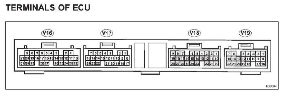

The VSC ECU is mounted upright. The wiring connector you are interested in is the 2nd one from the top (V18). Pull this connector out and locate Terminal V18-3. It’s a Red/Black wire. (NOTE: The view of the pin diagram below is looking at the back of the connector, as the wires feed into each terminal of the connector.)

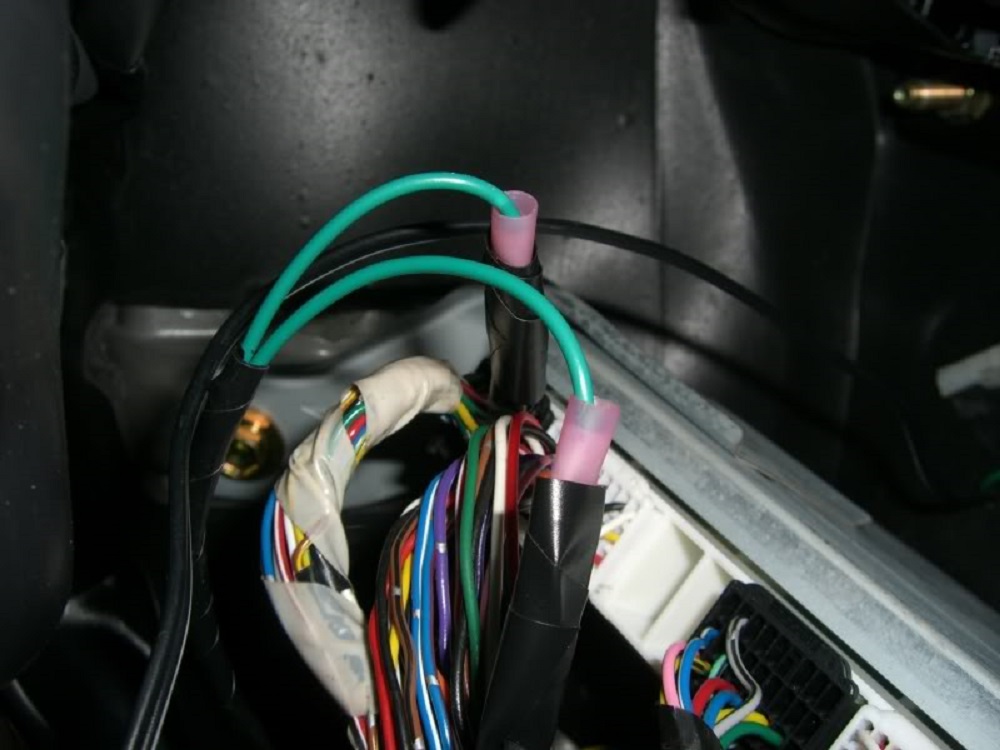

STEP 3: We cut the red/black wire and crimped a wire to each of the cut ends. (Solder these connections or depin them is optional.)

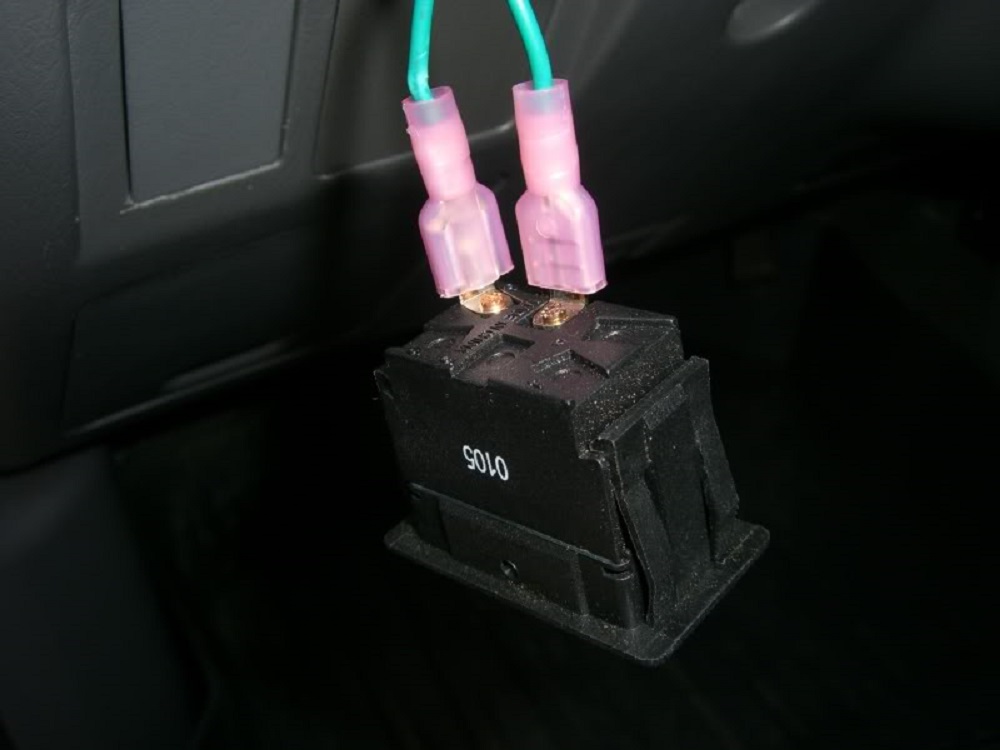

STEP 4: Remove a factory switch blank and insert your wires through the void. Plug them into each prong of the rocker switch:
YotaTech

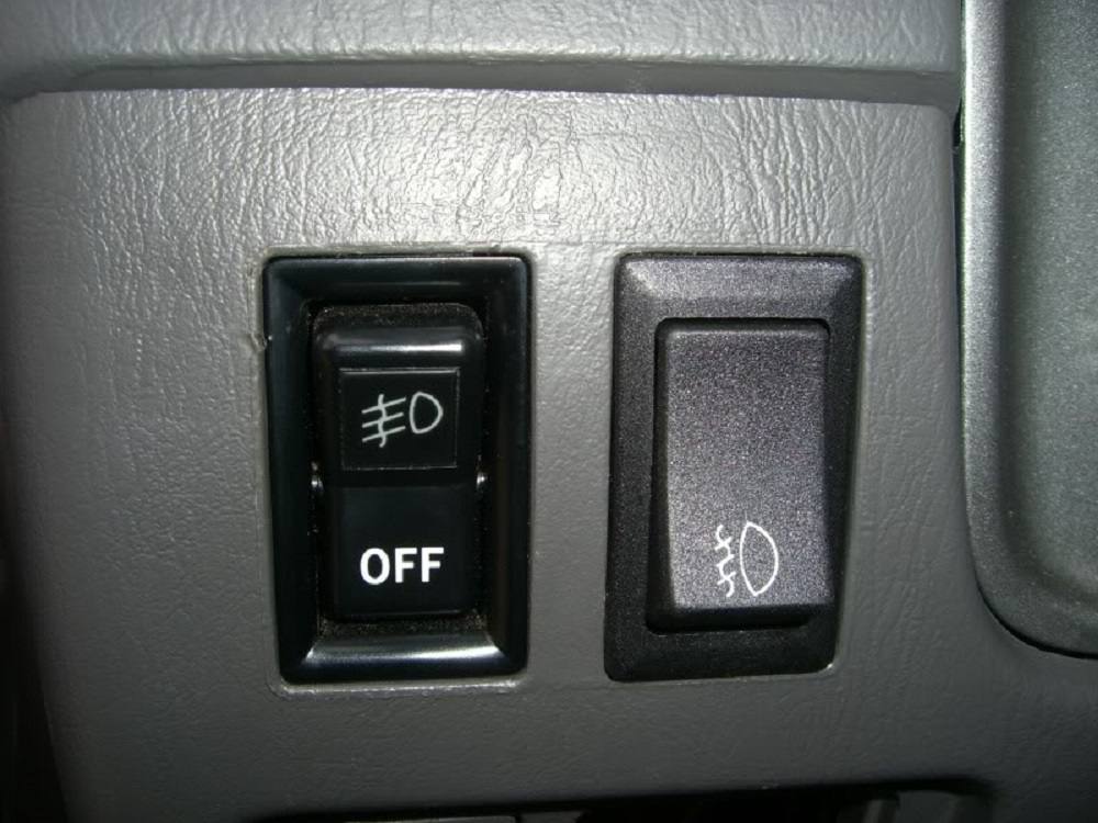

We wired our rocker switch so that when the bottom of the switch is depressed, VSC & TRAC are disabled. This matches the orientation of our two additional rocker switches. You can always switch the wires on the back of the rock switch to change the face orientation of the switch. New fog light switch installed on the right:
YotaTech

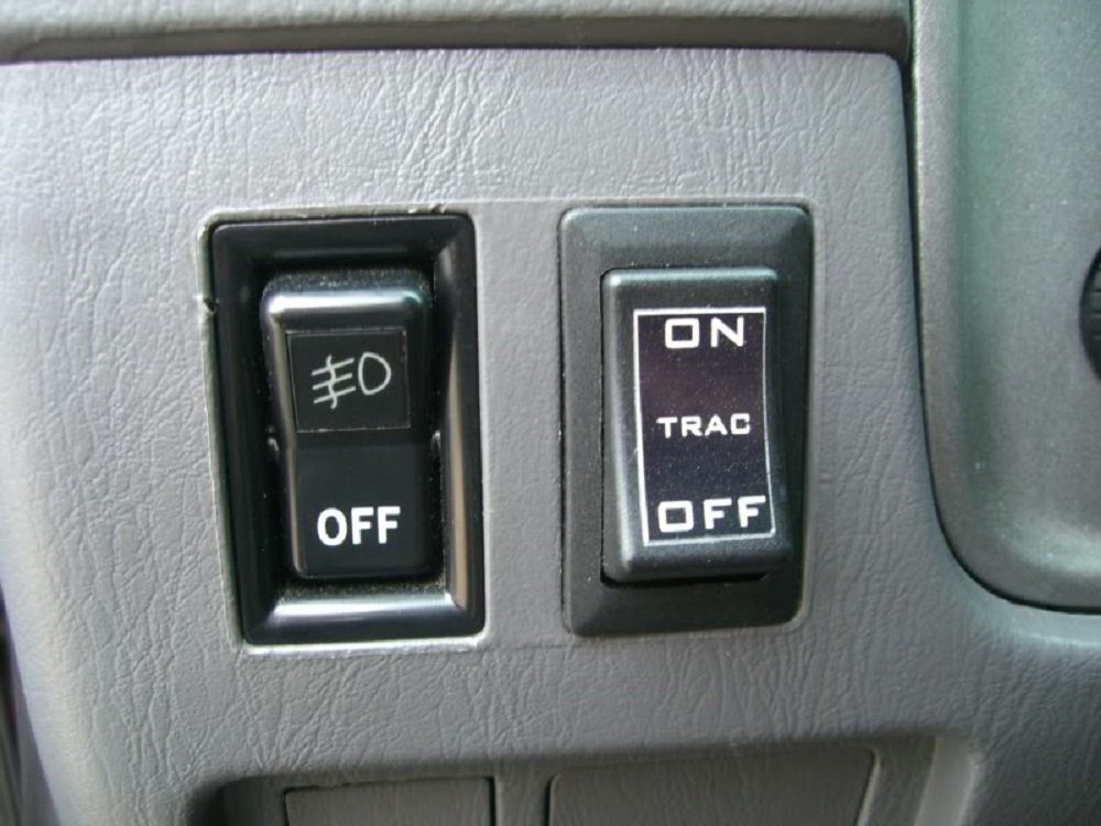

We made our own “TRAC OFF” label by scanning the factory TRAC OFF switch, darkening the image and printing it on a standard mailing label. A few coats of satin polyurethane spray on the actual rocker portion to complete the process:
YotaTech
