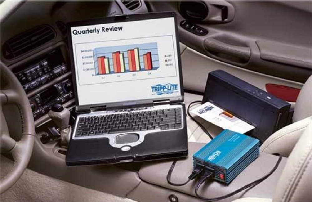

Does it feel like you’re always in need of auxiliary power when you’re off the grid with no electrical outlet anywhere sight?
Whether it’s to charge spare batteries of a digital camera or simply get those reports out on your laptop, there’s always a need for AC power. Tripp-Lite solves that problem with their portable 375 watt Power Inverter. Its compact size makes it a perfect fit for carrying along in any vehicle.
This unit plugs directly into your vehicle’s existing auxiliary outlet. For safety, this unit will sense when your vehicle battery is getting low and will emit beeps to alert you.
If you continue operate the unit in this state, it will eventually shut off automatically when it detects your battery reaching to low of a charge.
