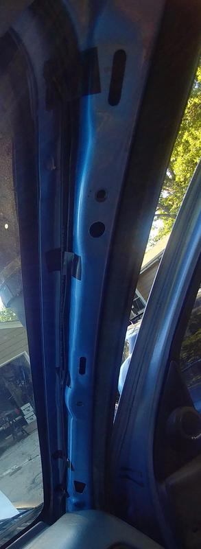

96 4Runner 321,695 miles

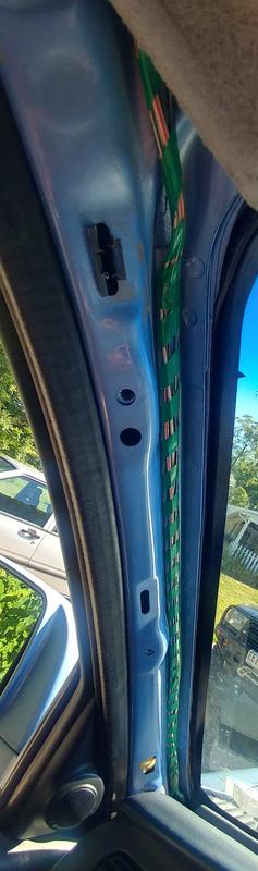

Finished routing the coax and buttoning everything back up.
For anyone who wants to know, there's a bundle of wires running down the left a-pillar
and nothing on the right a-pillar- except the front sunroof drain, one for each side. I used some tape to hold the coax and Roav camera wire in place until the trim piece is back on.
I used the right angle PL259 connector from my husband's cb since he took his out. It fits just right, I can easily get to both map light switches and the coax is routed around them.
Everything fits, buttons can be used, visors have room to work. There is a small air gap above the radio to help keep it cooler. The speaker being underneath makes it very easy to hear.
Now I need to figure out where to go with the mic.

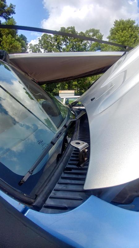

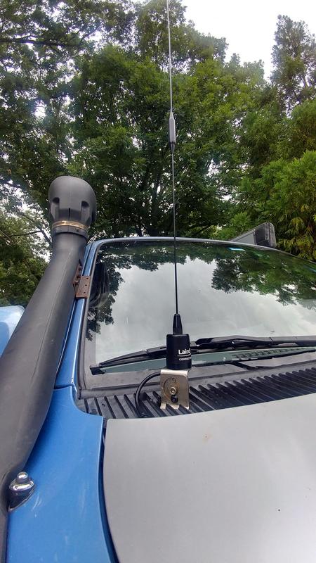

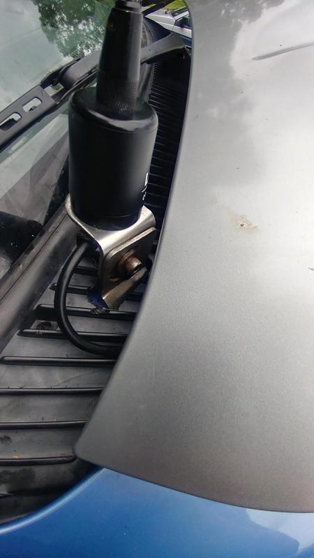

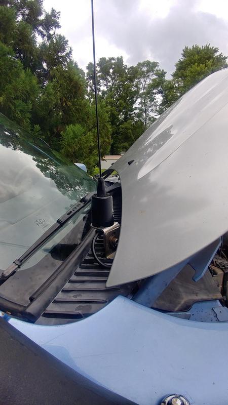

Almost forgot...
Antenna. I used the old cb antenna mount that was on the back corner of the truck for awhile before I moved the antenna to the front bumper. I did have to drill out the hole for the nmo mount.
Pulled (and washed, that thing was clogged with debris) the cowl and screwed the antenna mount to the truck after multiple bouts of hammer time.
Somehow I forgot to take a pic, so sorta like this...
and cut a hole in the cowl (cover?) to re-install
Installed the antenna a few days ago, everything clears...
Laird nmo mount antenna, ngp, 5db, 32". I put dielectric grease in the antenna base and silicone on the nmo base (where the coax is soldered on) to help keep it safe from the elements.

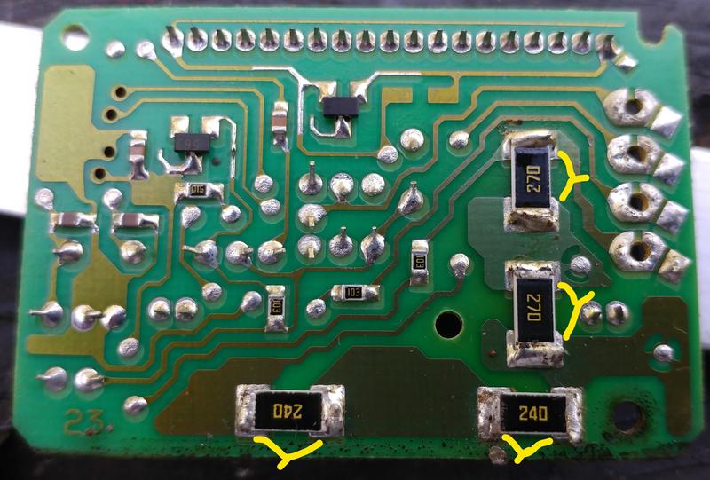

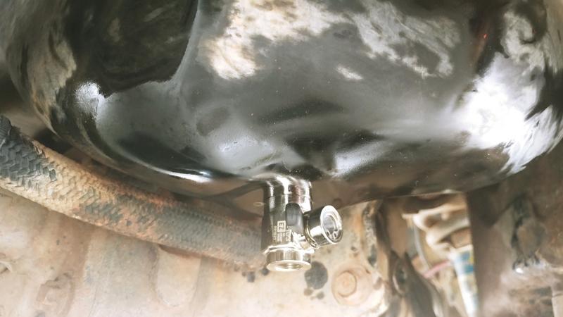

Repaired a rear seatbelt mount- rusted/striped threads. The bolt simply runs to the wheel well, so I grabbed a longer bolt and a large stout washer and bolted the seatbelt in. No drilling required.
Finally got around to a wash and wax. It was a quick and clean job...

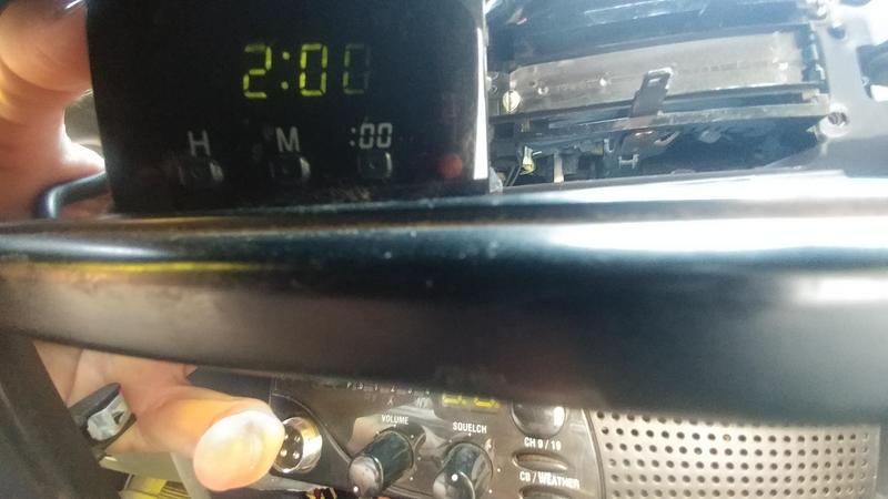

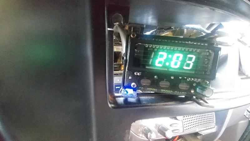

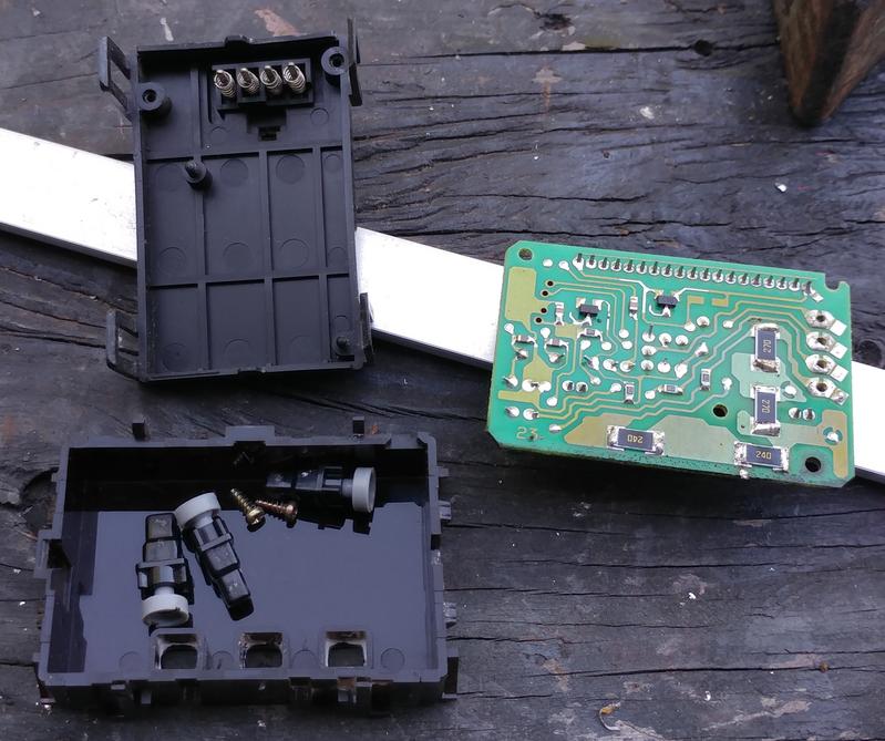

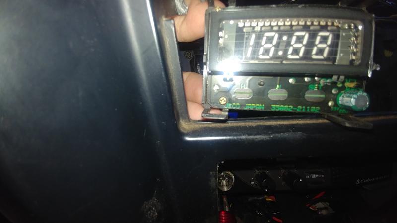

Noticed the clock was getting flaky partial numbers again. Sometimes you could see everything-ish, sometimes not. I last repaired it in 2011...
I pressed lightly on the circuit board and everything turned off.
Re-flowed the points shown below. It's been a long time, it appears the solder cracked again, this time the one on the bottom left for sure, too hard to tell if any of the others were cracked. I need a better soldering iron for this kind of work.
Not a difficult fix, 4 catches (2 each left and right, none top or bottom) hold the clock in the bezel, catches to open the clock, watch out for the buttons and their cushions, 2 tiny screws hold the circuit board in, watch out for the 4 tiny springs (mine had mild tension on the board= were good).
And we're good to go until the solder fails again. It's a cruddy pic, but things are back in order again.
NOTE. If you have the 99+ clock (in center of bezel between the vents) and it was working, but then you had to unplug it for whatever reason and when you plugged it back in it doesn't work at all check the plug, there's a look-a-like plug in there that often is mistaken for the real thing.
and worked on a mic mount for awhile, but now it's very very sunny and also hot. Should be shady enough in another hour or so.

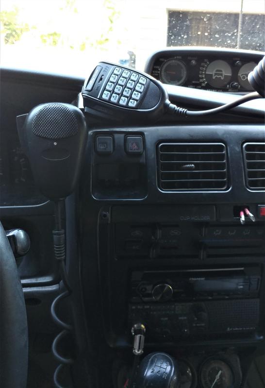

96 4Runner, it's been a long day...

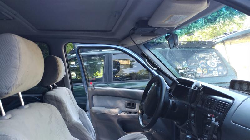

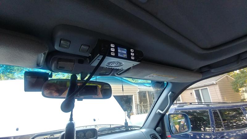

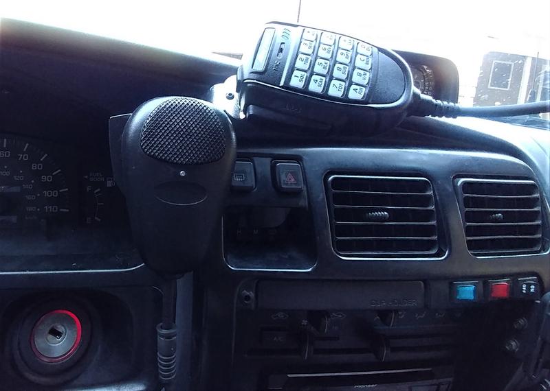

Mic holder for the GMRS radio.
I sure struggled with where to put this one. It hung pretty nicely over the rearview mirror, but not a good spot when wheeling, swinging around loosely up there.
Not on the backside of the mirror, unless I wanted to adjust the mirror every time I grabbed the mic.
There was nowhere on the ceiling that wouldn't be in the way of the visors or sunroof or radio itself.
Not attached to a seat, it'd get in the way if I needed to reach back for something.
Not where there's bolt holes for a grab bar on the driver's side above the door, it'd droop into my field of vision.
Same for the a-pillar oh-heck bars.
That pretty much left down on the dash.
I've already got the home brew cb mic holder there, so I added to it....
No new holes, easily reversible if I come up with something better
both mics are accessible and play well with each other
My view of the cockpit that cord is not in my way
it's a lot further forward than I am
I may add a support for the mic cord at some point, one of those retractable deals. As it is right now the straight part of the mic cord is all I can see in the rear view, don't want to raise the larger coiled part into the picture.

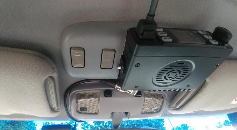

Anytone AT-779u/v 20watt. Smallest radio I could find. Wouxun and Midland make as high as 50 watt, but they won't fit where we wanted our radios to go (and they cost a lot).
We just spent 2 weeks truck-to-truck simplex with good results. It can receive NOAA weather, but I use my cb for that. Today I used my cb to find out from the truckers which lane was open after someone crashed on 70, and the GMRS to relay the info to my husband.
So far so good.

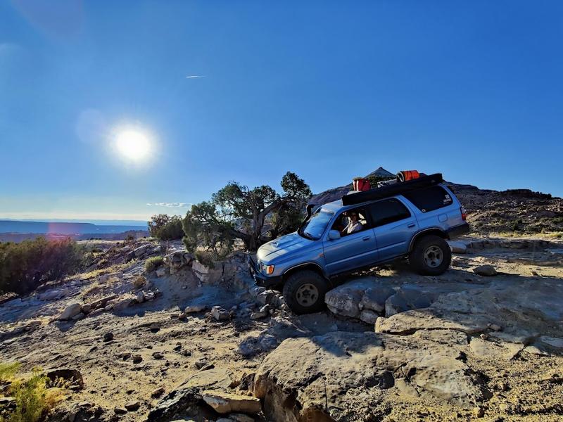

Teaser for a future report-

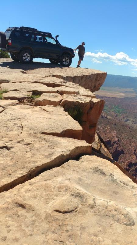

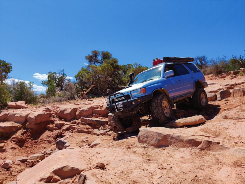

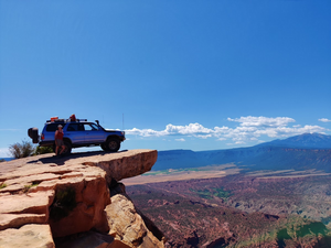

Top of the World, after you get to the Top this is from the lollypop loop to go back down...
This is a wall of a few steep steps, here I've gotten my front wheels to the bottom, my handsome hubby is standing right in front of the hood...I normally wouldn't see anywhere near that much of him...he reached down to grab my bumper hoop
So far so good.
