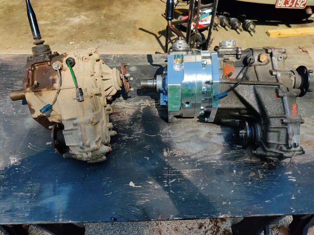

Getting the '99 ready for the NWF Ecocrawler install. Took the belly skids off, and removed the transfer case. Apparently it had been leaking a little form two places - the base of the shifter and the front output.
Here's a pic of the original transfer case and the two donors built into the EcoCrawler kit:
Now all I need to do is wait for the triple stick kit to arrive, install it, and put it all back in the car. And install the new driveshaft.
And then some sort of creativity in terms of a shifter boot setup.

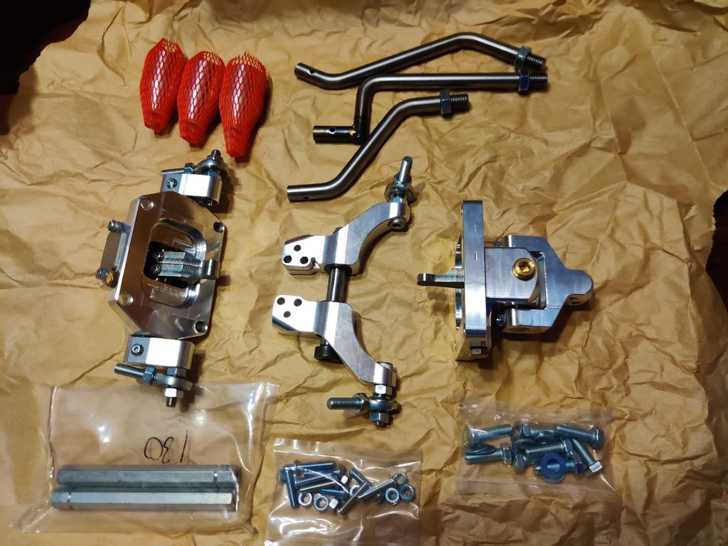

Got some blingy parts in from NWF today!

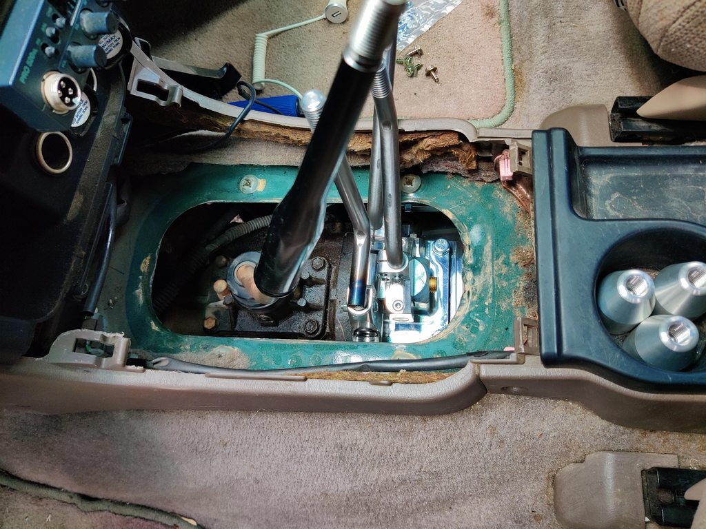

I can't believe I didn't take any pics. No pic = didn't happen. But after a long day Saturday it's in. Ended up clocking the front drop up a bit - with the case extended 6.5 inches back (=/- a little) and the drivetrain angled down some, it would have been down into the transfer case skid a bit. I should have noticed that a bit earlier, but I thought when I put in the trans crossmember and trans mount that it would lift it up more. So I continued installing it, and when it was all together, looked at it... and yeah, it needs to go up. I tried briefly to get all 8 nuts and studs out so I could rotate it in place, but there's not enough room in the tunnel to get to three of them. So out it came, clocked it up a couple of inches, and back in again.
Not sure what happened with the measurements on the front driveshaft, it seems like it's a couple of inches too short. But it should still work, the slip yoke is pulled out fairly far.. But it still has a couple of inches engaged, grease seal still engaged between the two halves. The rear driveshaft fit like it should.
I fiddled with the shifters a bit, got the positions dialed in with the adjusters on the shift rods going to the rear case and tightened them up. But I didn't mess with the inside too much, I was grungy from rolling around under the car all day.
So up next - getting one more 3/8 NPT plug - I seem to have one extra smaller brass plug with my parts from NWF, but missing a larger one? Putting oil in both cases, and then working on the shifter boot area to seal it off.
