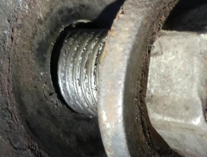

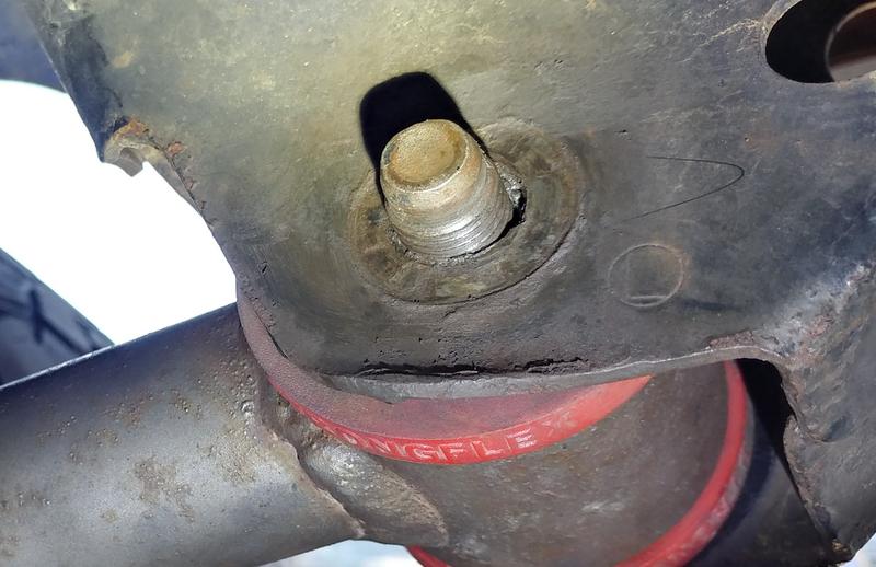

My husband got a great idea and put his go-pro on the left lower control arm so we could watch the bolts wiggle back and forward. That translates into a lot of axle movement. The bushings are a bit messed up too, but don't know if they're the cart or the horse. Kinda thinking the cart.
The holes appear to be a little woggled out.
Thoughts, ideas, and magic fixes wholly welcomed.
Ideas with a Magic Fix: https://www.4wheelunderground.com/ when in doubt SAC!
At a hair over 700' above sea level....
Yep, they're flogged out, anyone with tig skills you can call on Hab, that could build up the worn section around the holes ? You'll need to look at the metal sleeves inside the Nolathane Bushes, as I'd suspect they are also worn length wise moving around in the housing, maybe stitch weld high tensile washers over holes (correcting the hole wear/mis-alignment) replace the bolts and make sure they stay tight (check regularly) Using Nolathane Bushes, definitely has its advantages, but there stiffness cause problems such as this IMHO.
my 2c worth !

My idea is to weld a washer to the outside of the mount if mine ever get wallered out like that
my 2c worth !
I'm agreeing with you on the poly bushings. That, combo'd with a heavy duty link...The poly has tears in a couple of the bushings and you can see the rub from being stuffed in the oe mounts. The sleeve itself is actually in good enough shape.
I'm a little overboard on checking those bolts after very nearly losing one a couple of years ago, out in the middle of the Maze district of Canyonlands. Lost a nut (used nut off rt front upper control arm- worked great- and got a new nut once I got back to civilization) so those get checked early and often now. The rear ones also get double-nutted.
Love the idea of using heavy duty washers over the holes. I think I'm going to have to address the issue of the heavy duty link in the stock duty mounts somehow.
Okay, that's 2 votes (plus a dropzone approval) for washers. Even the strongest are cheap, I'll have the hole sizes I need....cheap washers, not cheap welder! Gotta have someone who can do a good job, that's worth extra.
You are all so very awesome!
One thought was to have the holes built back up and drilled to the proper size like Kitty says, but if I had that done (I need a Kitty here!), then added the washers you all mention to shore things up a bit that might just be crazy enough to work.
I've also contacted eimkeith and asked a couple of questions about his rear lower link skids.
Doing the research.

nice thing about a washer is you could drill some holes (not a lot) and have some small rosette welds for some extra oomph. but i am no welder or fab guy so seek professional help since your butt is literally gonna count on this..
if no one is willing to tackle it i guess you can always do a frame swap
Frame.......swap?????
Whoa whoa whoa whoa back that horse right on up!
(sorry, we're back to reverse again)
Definitely will be talking to some people I know who know more about what they're doing than I ever will. Having my butt stay attached to the truck and not swaying weirdly- it randomly feels like there's no sway bars, kinda wanders a bit- and that's with just those small woggles- es muy importante!
