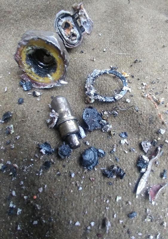

96 4Runner 316,541 miles
I happened to notice my reverse lights weren't working. Fuse was good, the aux lights work when switched on.
Checked the backup switch. It's on the right side (passenger) of the transmission.
The plastic plug was broken nearly off. Alright, bad back-up switch. Toyota 84210-52050 for those who would like to know.
It wasn't terribly old, I know I replaced it a 10/2016 with a Toyota part, so I figured I broke it when I was installing the transmission.
No worries. I looked at a Toyota Parts site for one, then looked at what else it came on. A LOT of different vehicles.
JUNKYARD RUN!!
Cars and Coffee at Worldwide Technology Raceway in Illinois first. Spent a few hours looking at cool cars and people disinterestedly glancing at my 4Runner (as usual) and doing double takes at the hubby's LS swapped turbo 93 Volvo 240.
Afterwards we went to the junkyard nearby and pulled a backup switch and corresponding pigtail out of an 02 Tundra. Perfect match.
Got home and pulled the old switch. That's when I noticed the old switch was toaster-fried, the plug was melted-fused to the pigtail. Turns out the switch was not quite disengaging, the spring was sticking so that it wasn't releasing all the way. It seemed to be working, I guess it was getting some sort of power, but not enough to activate the lights? Just enough dysfunction to fry the switch. I did notice but couldn't find a plasticky burning smell after driving, moved the transfer case wiring further away from the cat in case that was it. Apparently That. Was not it.
And that was that.
These aren't meant to be taken apart...
That's a bunch of crispy-brittle stuff.
Even before I pulled it apart I could see that it wasn't entirely disengaging/ de-energizing. There was about a quarter inch of loose play when the spring tension was released, which means it was not quite off.

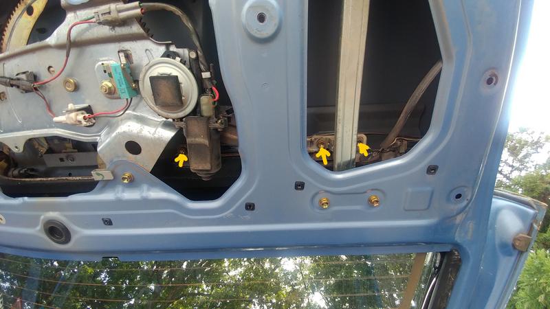

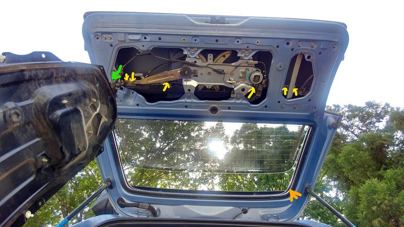

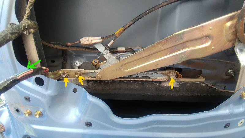

96 4Runner 317,002 miles
Way behind on posting this...
Pick n pull's memorial day sale netted a rear window out of a '97. The defrost stuff is in better shape than the '96 so I pulled it for $15.
A little finesse, 6 bolts, the window seal in the hatch, turning the glass until it could clear everything and come out.
So I didn't read the manual, just did it.
Removed the tailgate panel, then the two metal panels underneath it.
Unbolted 6 bolts that holds the window onto the track (yellow arrows) access was easier when someone worked the switch up or down depending on which bolt you're trying to reach. Keep fingers and what-all out of the way while it's moving- and make sure the person toggling the switch knows not to touch it when fingers are present.
Unplugged the two defrost wires (green arrow marks their approximate position- they on on the bottom passenger side of the window) - spade connectors w/lever to release
Removed the seal (orange arrow) to get enough room to maneuver the window out of the tailgate by turning it a little until it can slide out.It pulls right off, but the piece at the bottom takes some patience if you find you need to remove it too, for space to work.
Right side bolts again
and left side
Don't forget to unplug the defrost (green arrow again).
It goes back in pretty much opposite of how it went out.
6 bolts, 2 defroster wires,
I used fipg to reseal the window gasket. It goes down in the rubber channel where metal meets rubber. There's probably a specific gasket goop for it, I just used what I had on hand.
Thought I took a lot more pics, but this was all I could find. It wasn't terribly hard to do, hardest part was getting the window just the right amount of crooked to get it out without scratching the defrost surface or window.
My only prior experience was removing the window at the junkyard.
