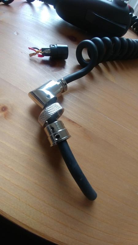

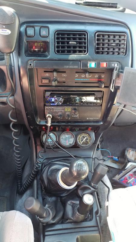

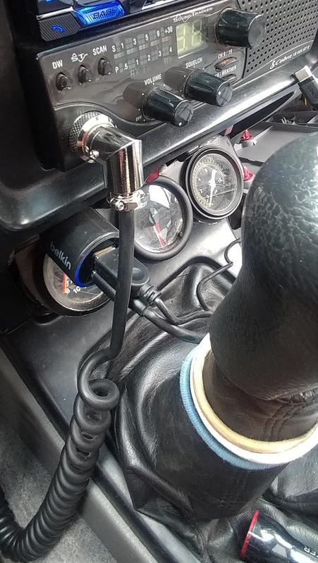

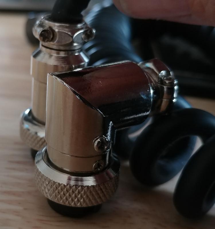

A small project.

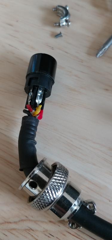

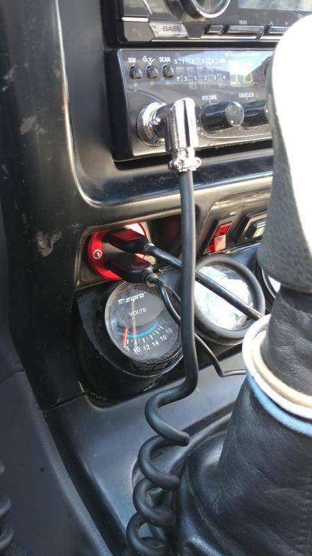

My stick shifter was bent to clear the variety of other shifters, bringing it a little more forward and towards driver. That puts my knuckle very close and occasionally brushing the cb mic connector, the collar of which being a little scratchy.
I have an 'L' connector for the antenna cable for clearance back there, why not the same up front?
new vs old

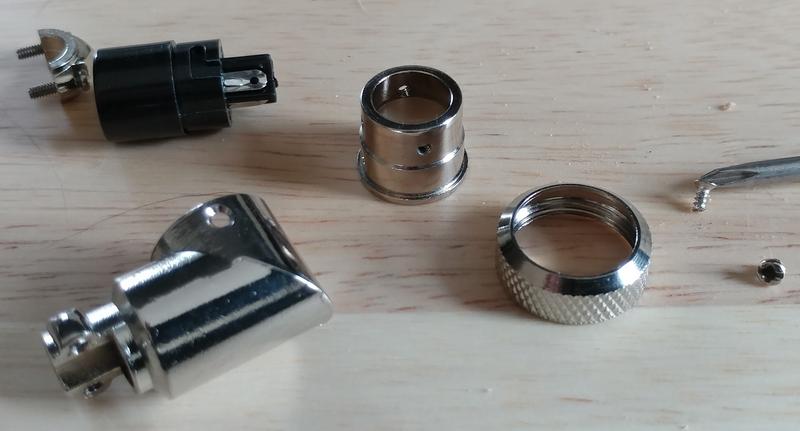

take old apart
Wiring that needs to move over in this order (several landmarks on the connector to get them in the right places)
New connector

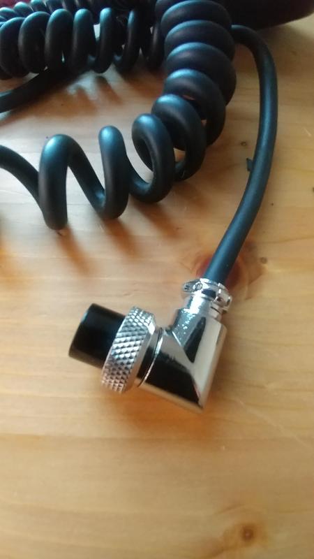

Goes on like so. Cut back the cover, strip wires, solder to new connector (old one in pic)
Like so
With my stick in 1st. It's only a little extra clearance, but beings I was only occasionally tagging it, it's enough. On the off chance I do hit it, a smoother contact spot.

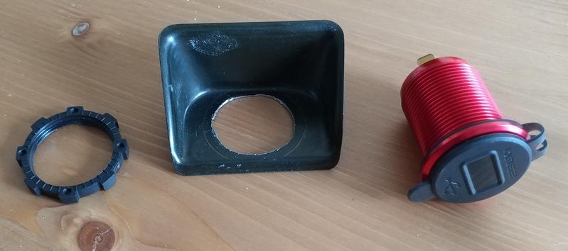

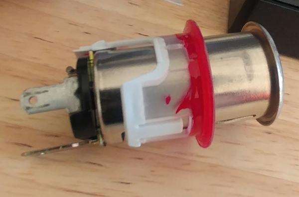

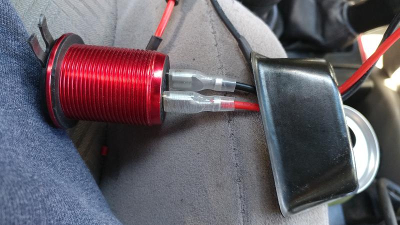

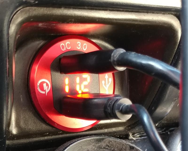

USB port where the lighter socket used to be...
Pulled the lighter socket out, rotated it until it pushed out forward, then was able to remove the white surround.
You can see what I did to make the lighter surround red- fingernail polish!
Once you push in the two tabs that hold in the socket...surround?...sleeve?...containment?
the metal plate can be easily removed. I enlarged the hole until it was big enough for the new usb charger, leaving the top alone and working sideways and downward. The lip on the charger is going to make for a tight fit at the top.
Next the dremel went to work on the plastic of the bezel, using the metal plate as a template for making my hole the correct size. If it's too big the retaining ring on the back won't hold the whole mess together.
On the charger red is positive and black is negative. On my 4Runner blue/pink is positive and white/black is ground. After testing to make sure that was correct I removed the lighter plug and added spade connectors, male for pos and female for ground, then trimmed and did the opposite for the charger spade connectors.

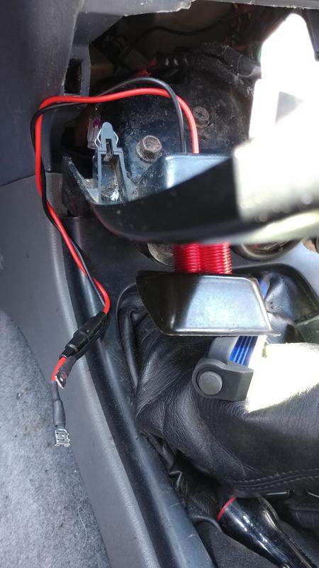

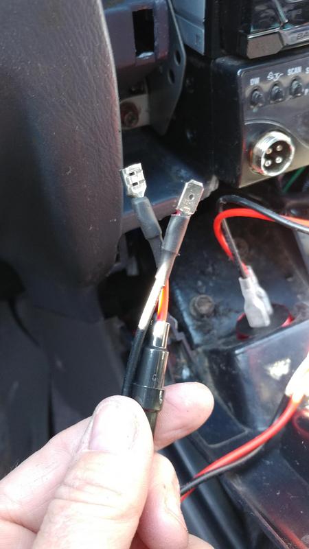

I trimmed the retainers for the usb cover, the fit at the top is too tight. I left the remaining ring as a gasket and tossed the cover in the center console- there's always at least usb plugged in.
Then I put it all together.
And used the charger's retaining ring to hold it all together.
I plugged the appropriate spade connectors together, buttoned it up, and it's doing its thing.
and my start battery is ailing and doesn't like the cold. It would need a little help from the house battery to start in this weather.
This is as the lighter socket was, powered only when the key is on acc or on.

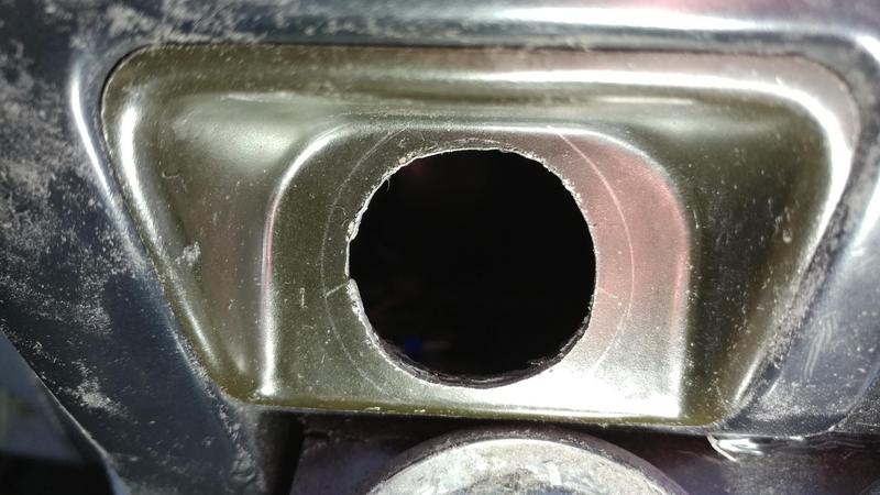

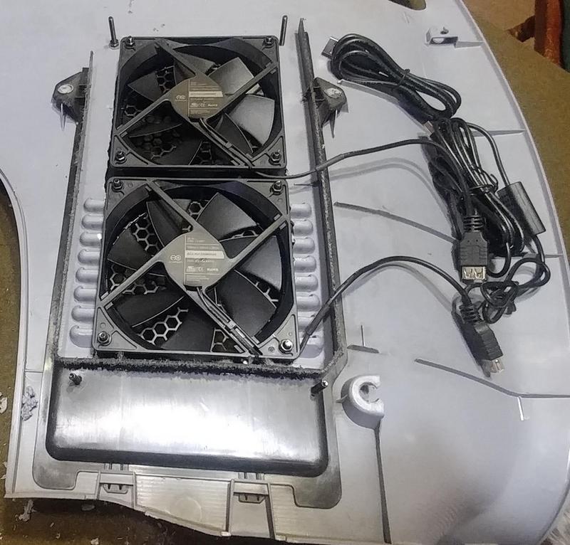

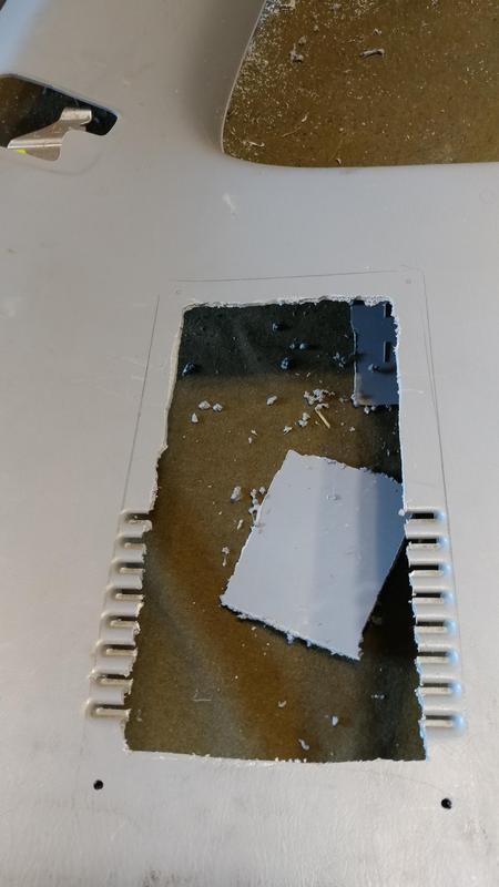

I should've made dinner an hour ago...
Driver's side cargo panel shenanigans.
Making a hole for venting the compressor that sits behind where this hole is...
This time I'm adding a vent
And a couple of usb powered fans
Tomorrow, a(nother) usb charger and a hole for the oba air filter line, maybe.

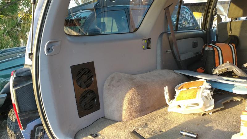

Installed the left cargo panel, muffin fans on when the winch/anderson/oba solenoid is on. Oba doesn't have to be on for the fans to work.
2 AC Infinity 120mm usb fans
FXC QC 3.0 dual usb car charger w/voltmeter, NO on/off button
AC Infinity ventilation grille 12.6 x 6.4" (doesn't quite cover the vents that were in the panel, but darned close)
Recoil BBPG4 power and ground busbar (ran out of room plus a failed post on the Blue Sea bus bar that was originally back there)
The grille looks crooked because of the panel and the camera, it's not. I used the original vent to line it up straight.

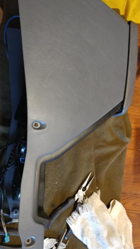

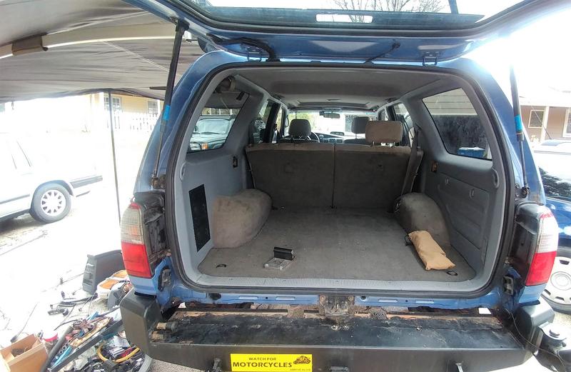

Rainy day, made use of the awning coupled with the tailgate to stay dry. My resealed tailgate window kept the water out while it was open, happy (dry) me.
It used to leak at the top as water pooled when the tailgate was open.
Got the arb solenoid figured out and the right side cargo panel in, then the upper light panel and the tailgate sill cover thingy.

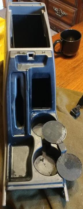

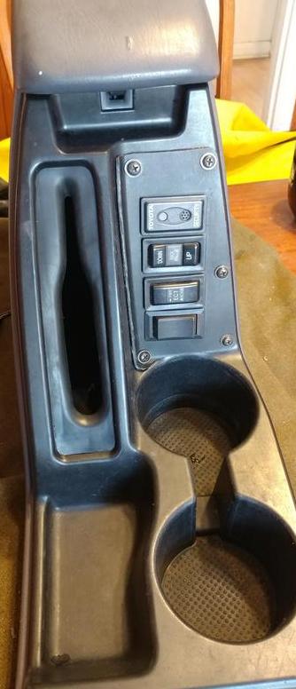

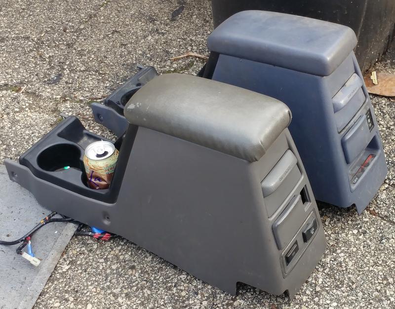

Pulled the center console. The 'new' one needs a serious cleaning and then even more cleaning. It's blue-grey like the rest of the truck vs the grey I had in there.
Old Mar 19, 2022 | 06:35 PM
  #4314
habanero's Avatar
Joined: Sep 2005
Posts: 8,247
Likes: 497
From: mo
96 4Runner 320,754 miles

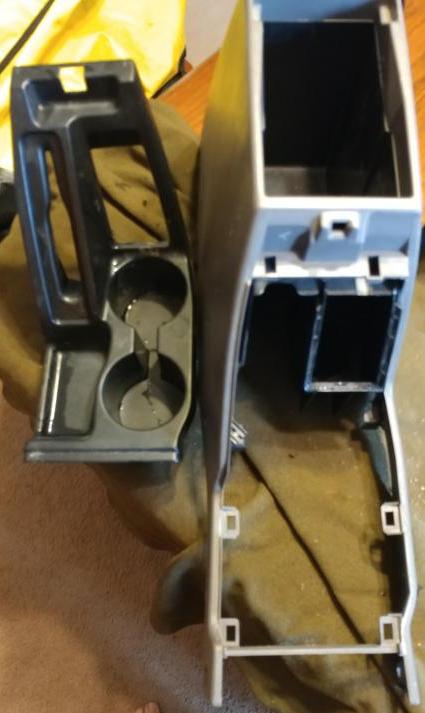

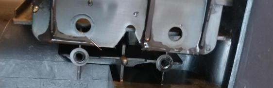

Cleaned the 'new' center console and moved my switch plate over.
Starting with the rear cup holder. Two screws and up and forward out of the keeper tabs.
Next comes the cup holders/brake lever housing.
There are 6 catches that hold it in place. I found once I did the 4 lower ones the other two popped out. I was able to access the catches from the underside and used a pair of pliers to squeeze the keepers in and pop them through the holes.
You can see on the center console where the 4 tabs/holes are, the other 2 are at the top by where the latch catches.

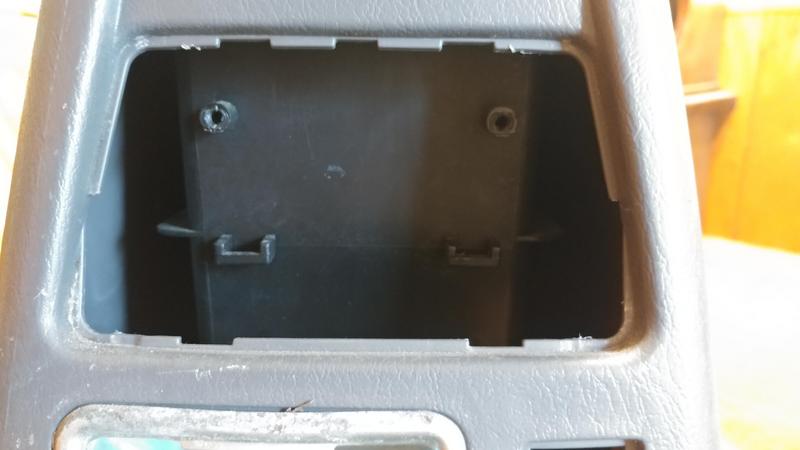

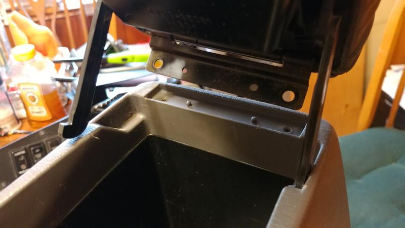

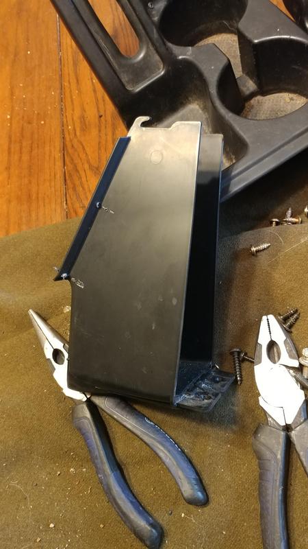

Glove storage area is next. The bottom can be pulled off the posts and the top has keys that slide off once the bottom's popped loose.
Bottom:
and side view that shows the keyed area...The front is facing towards the left
I pulled the lid and swapped the tops because the new one was missing the spring on the latch. 2 screws, the arms pull up and maneuver the hooks out.

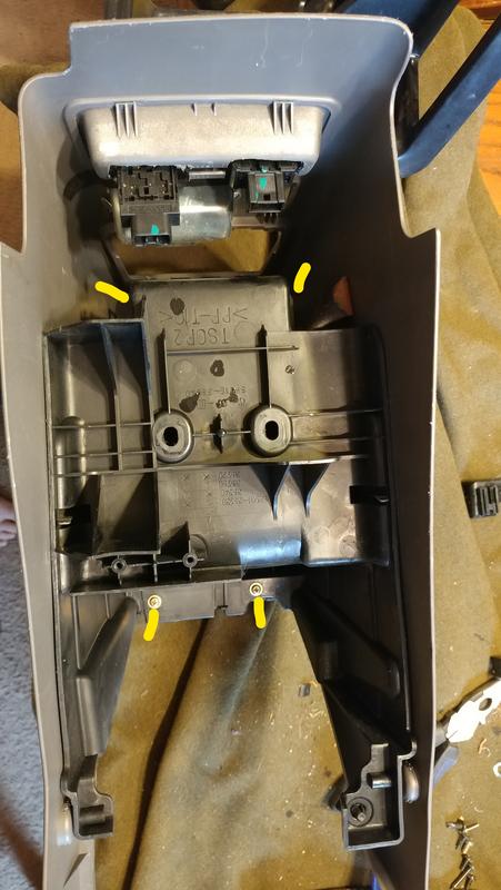

Now we're ready for the main storage compartment
a screw on either side of the center console, at the bottom and about mid-point
and 4 screws holding the box in, 2 in the front and 2 in the back (yellow marks)
I cleaned it all up pretty well and put it all back together using parts from both consoles. Reverse order.
The little cupholder cushion got cleaned up and put back in place too
Can you see where I made a hole in the bottom of the glove storage area and ran my wires through?
I made this switch plate of a bit of plastic and reinforced the switch holder area with metal slots behind the plastic. So basically it's just some random junk I had laying around and the switches that were in the 96's old style center console.
Before I can install it in the truck I've got some holes to make.

Nice clean install on the compressor fans!
Old Mar 23, 2022 | 06:28 AM
  #4316
habanero's Avatar
Joined: Sep 2005
Posts: 8,247
Likes: 497
From: mo
Thanks!
