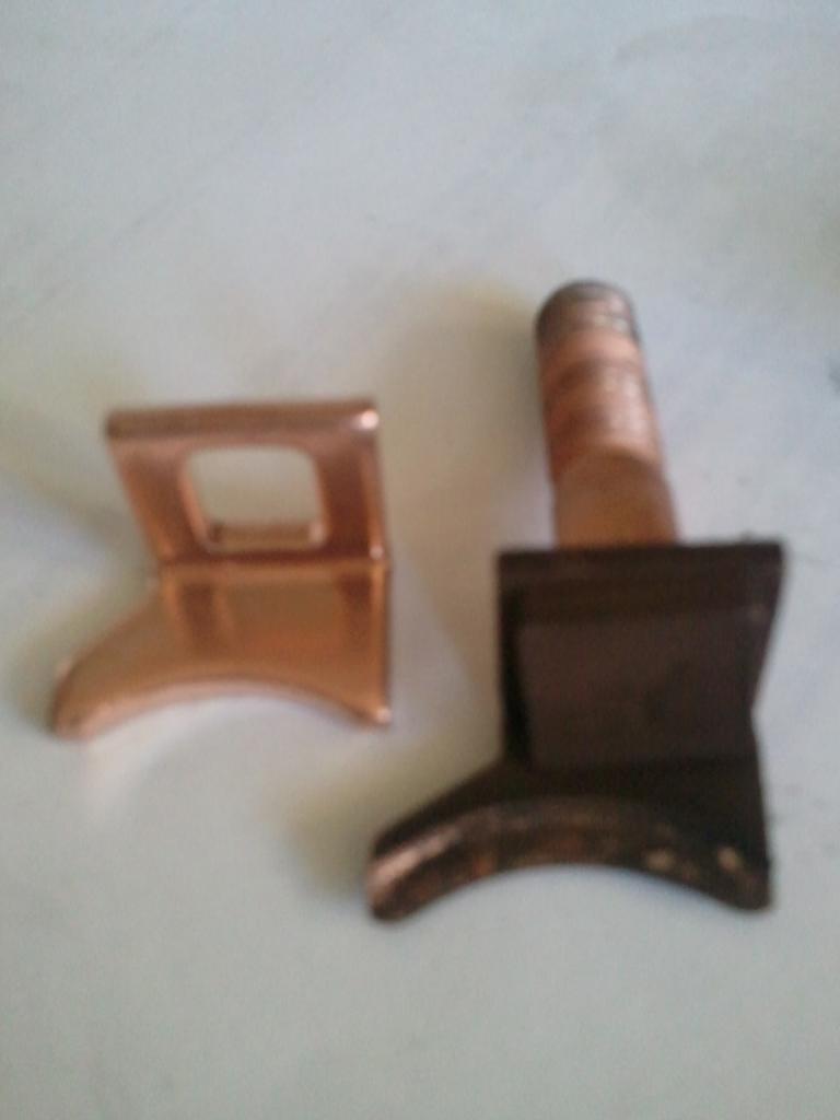

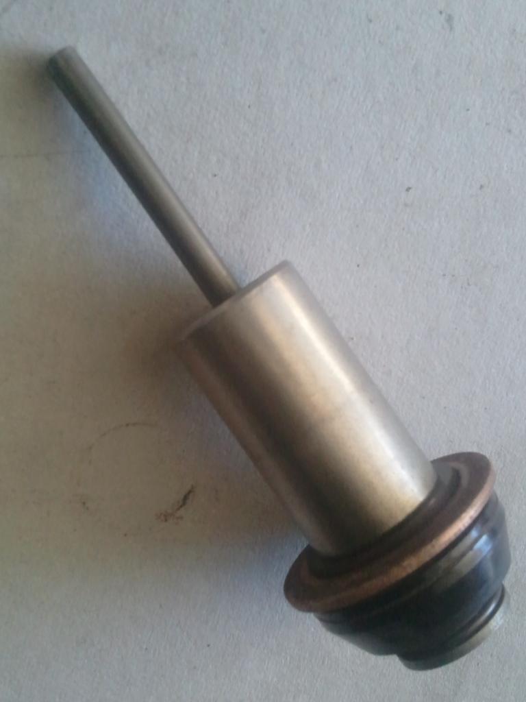

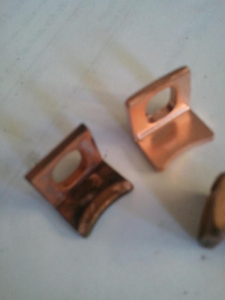

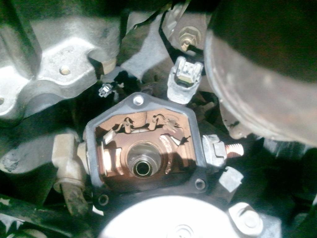

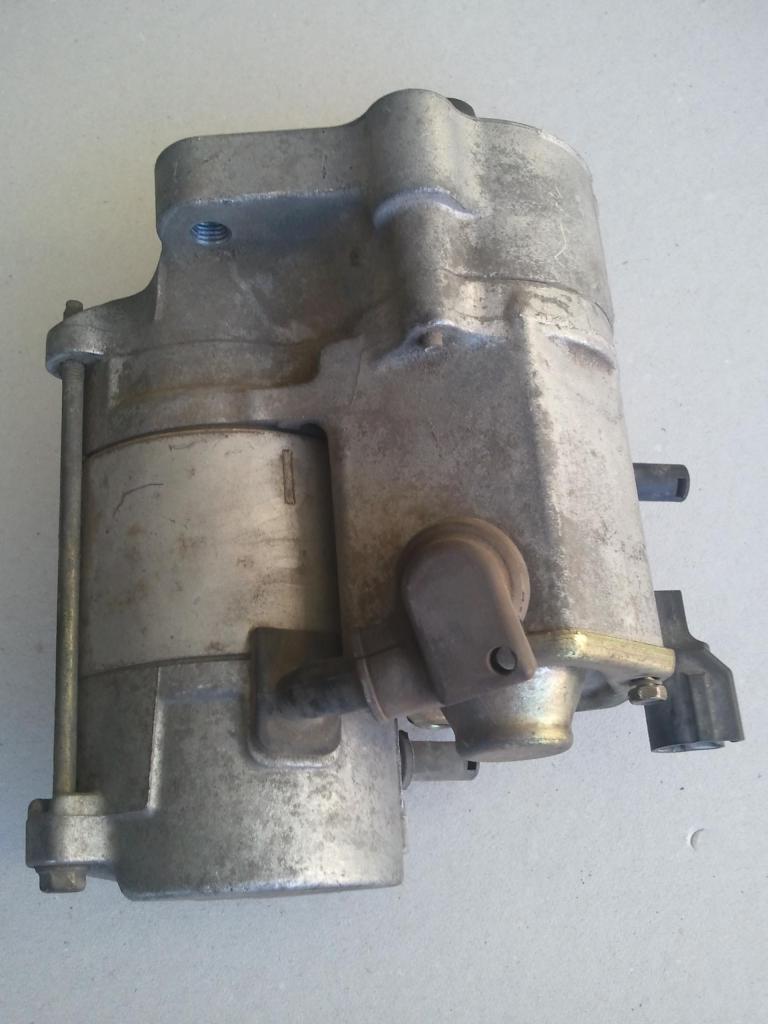

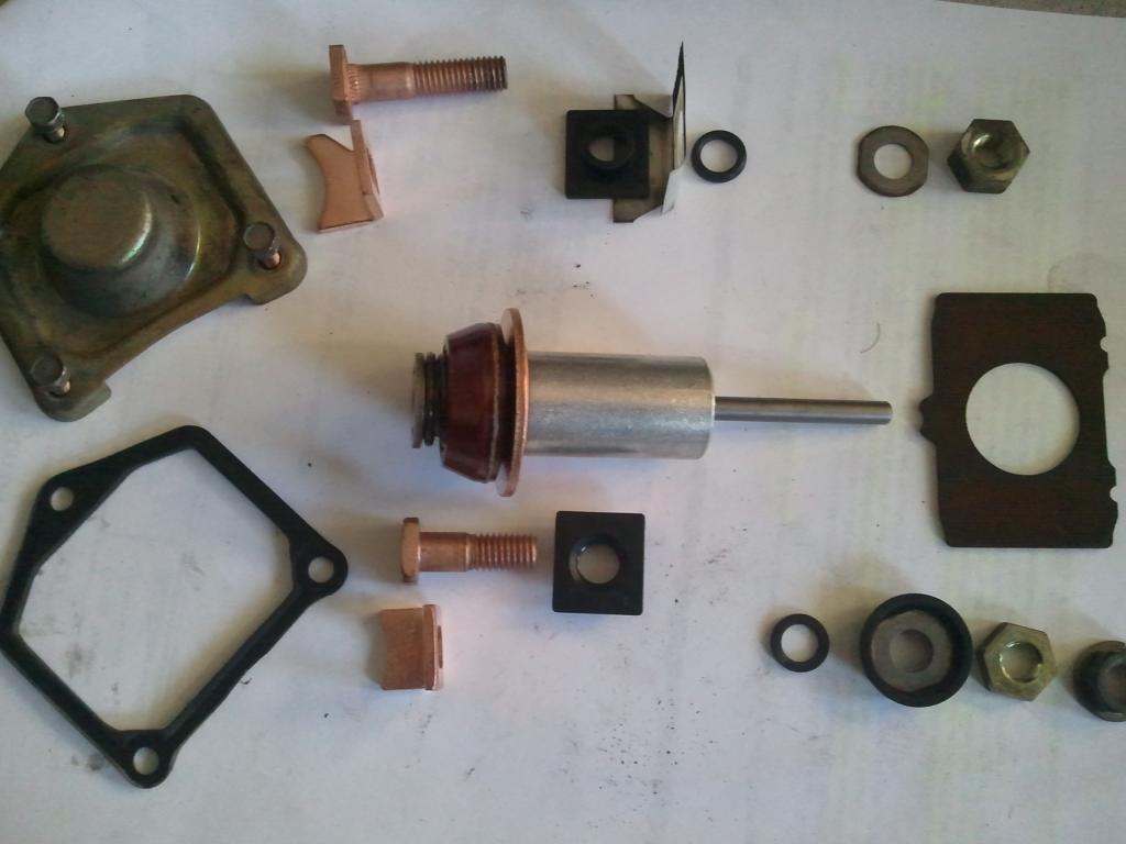

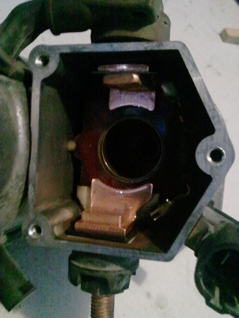

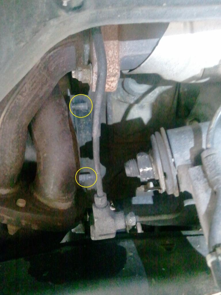

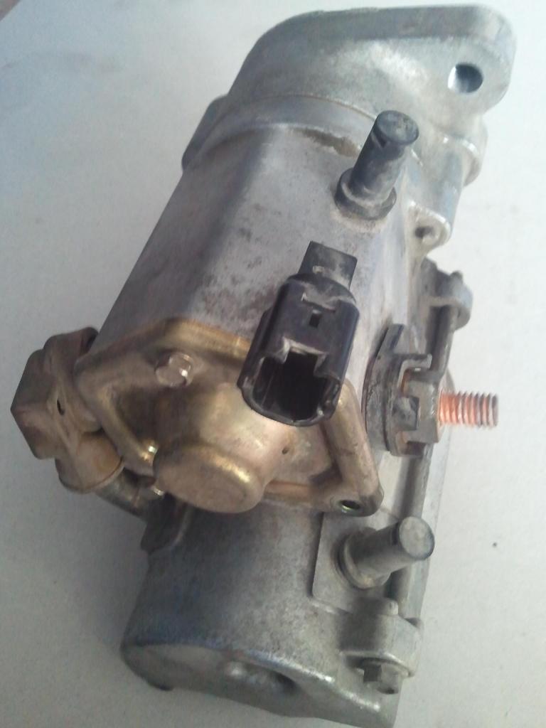

Ever since I bought my '96 SR5 V6 5-speed 4WD (with rear E-locker) in September 2012, I occasionally experienced a click when turning the key in the ignition to start my 4Runner. I thought it was just because I did not have the clutch pressed in all the way, so whenever I readjusted and moved my body further forward and tried again, it started up right away on the second try. It never occurred to me that my starter was going out until that click happened more frequently, and/or I had to turn the key in the ignition more than one additional time to start my 4Runner.
The final straw happened three (3) weeks ago, when I first experienced the click, moved forward closer to the clutch and turned the key in the ignition again. That time, my 4Runner started up but then the starter continued to try to "start" while the engine was already running. Moreover, when I tried to shut off the engine by turning the key in the ignition to the OFF position (and even removing the key from the ignition entirely), the starter kept trying to "start" the engine. I purposely re-started the engine and eventually the starter just quit trying to "start"; I had never before experienced anything like that!
So I began researching all the various starter repair threads I could find and learned I most likely only needed to replace both the starter contacts, as well as possibly the plunger itself, dependent upon what I found when I opened up the starter. After thoroughly reading Starter Contacts Removal (without removing starter), I decided to tackle this project myself; I ordered the starter contacts from Roger Brown, a.k.a. 4Crawler, and bought the plunger directly from Toyota of Dallas, which happens to be only 3 miles from my office.
In hindsight, I could have saved almost $30 and probably just used a generic Nippon Denso starter repair kit, which I've seen online for less than $10, rather than paying dealer price for the plunger (which I wasn't sure I'd need, but I wanted to have on hand just in case - I could always return it in the event I ended up not using it)...

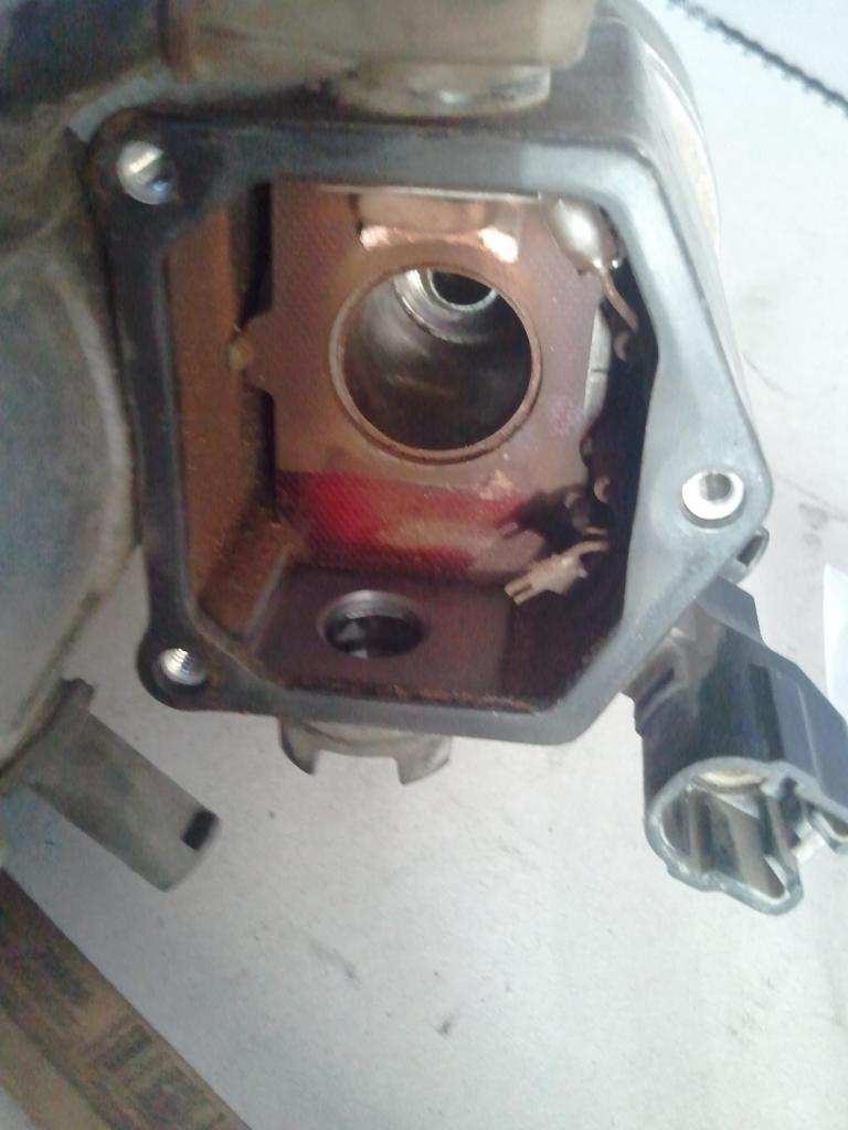

Comarc's above-referenced DIY write-up was pretty easy to follow, but I got stuck temporarily trying to loosen the top starter bolt, as well as trying to unclip the small black connector and remove the gray plastic cover from the positive (+) battery cable. I eventually prevailed, loosening the upper starter bolt with my breaker bar and an extended socket I had to go buy, and just prying off the gray plastic cover and unclipping the small black connector by hand, all from underneath my 4Runner with the rear skid plate removed. I finally got the starter completely unbolted from the engine (in the following photo, you can see the starter bolts still in place through the engine):

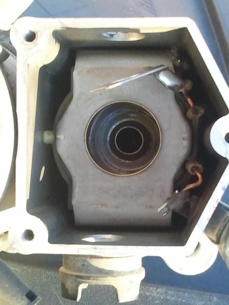

and dropped down from the engine, resting on the steering rack so I could unbolt the three (3) 7mm cover bolts. I had initially planned to simply replace both the contacts right there in place, until I opened the cover and saw how dirty the inner housing was:

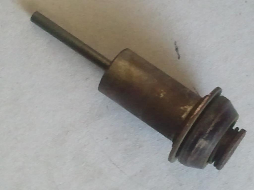

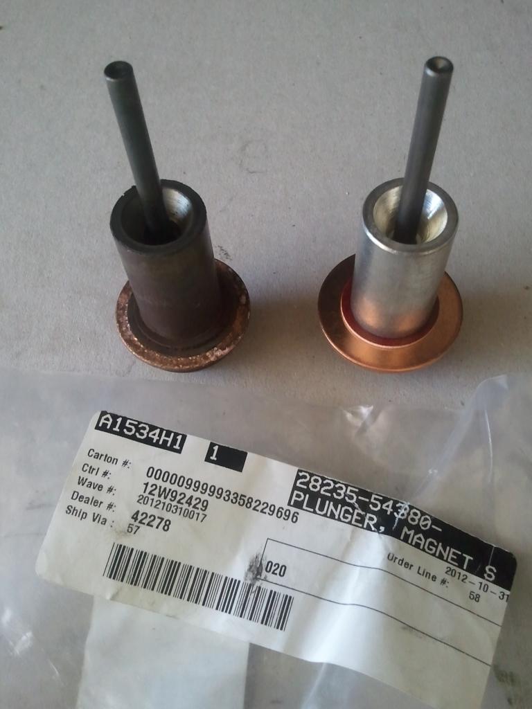

I removed the plunger and spring; you can see how filthy the old plunger was:

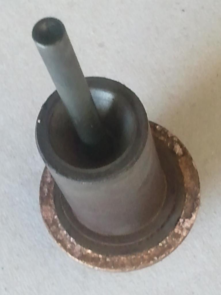

and this next photo depicts how worn & pitted the copper disc on the plunger was:

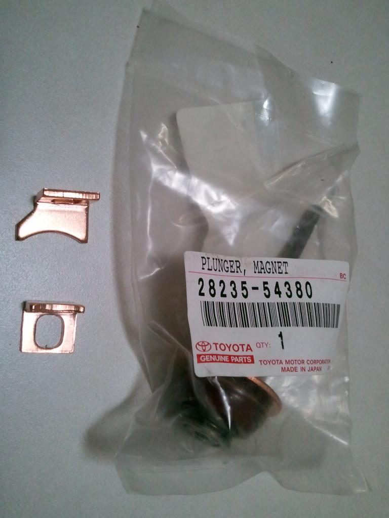

for comparison, here is the old plunger and the new replacement plunger (now I was glad I had the foresight to buy one to have on hand, just in case):
finally, this next photo depicts the old plunger after I cleaned it by simply wiping off all the crud built up on it:

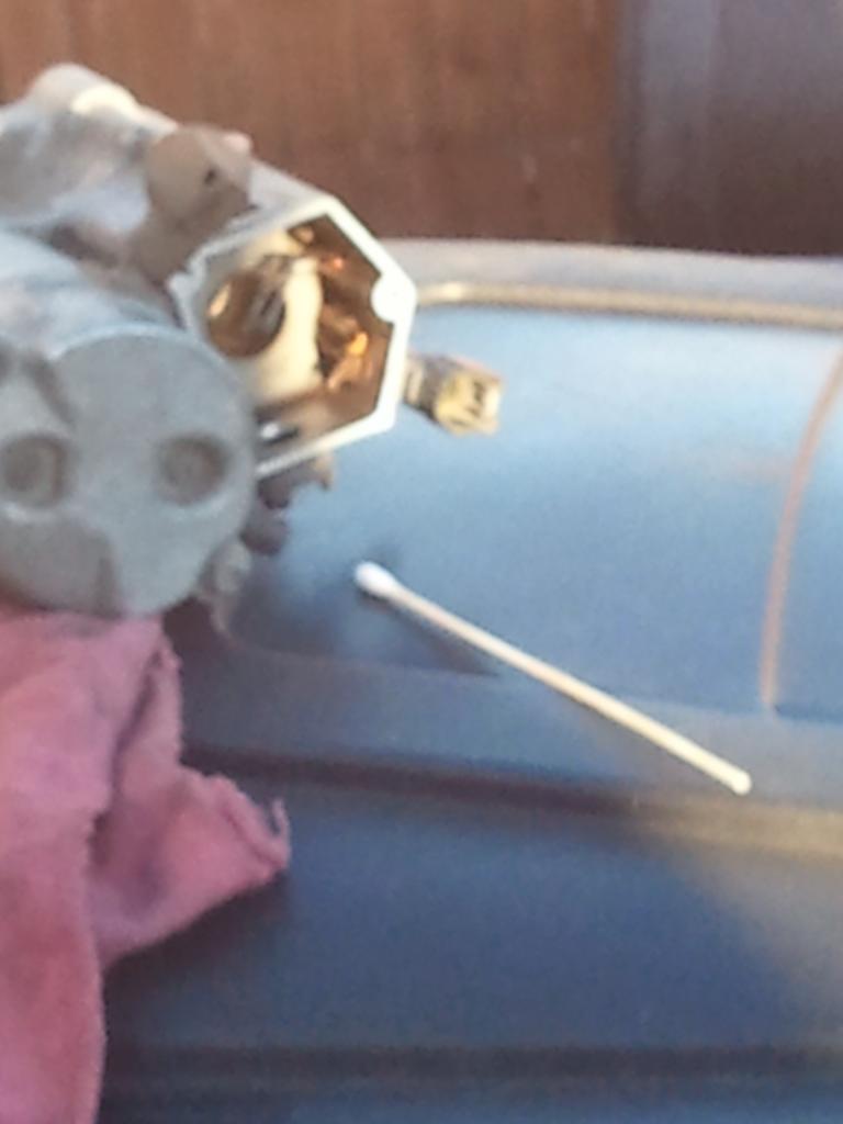

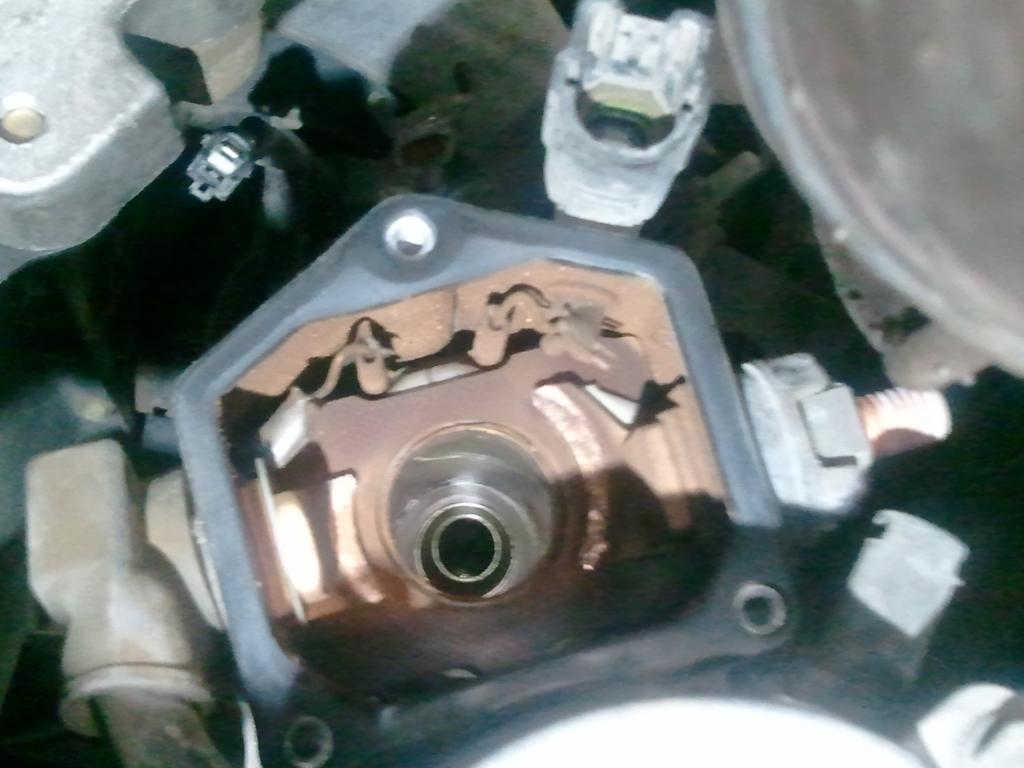

In my research, I had found Dave's Denso starter contact replacement thread on the ExPo forums, which helped explain why my starter had kept trying to start the one time, both when the engine was already running, as well as when the engine was off with the key removed from the ignition. According to Dave, my starter contacts had gotten pitted and worn down to the point such that when the starter engaged, the plunger stuck between the channels dug out of the contacts, keeping the starter engaged, even when I removed the key from the ignition; Dave went on to further explain there was full battery amperage going through the motor, and so when that happened, I risk my 4Runner catching fire! BTW, Dave's particular thread was furthermore a great reference for all the proper torque specs (stud nuts and cover bolts), as well as the piece of steel which Dave machined to apply force to both the starter contacts while properly torquing down the 14mm stud nuts on the outside of the housing.
So once I unbolted the starter from the engine, dropped it down to the steering rack, unbolted the cover, saw how dirty the inner housing was, and realized I could simply wipe all that crud from the plunger, I decided to completely remove the starter so I could thoroughly clean it on the bench, as well as properly torque all the nuts to spec.
I took a break and went back inside to research again how to actually remove the starter itself. I found THIS THREAD describing several approaches and figured I could make at least one of them work, but I also found THIS THREAD, which sounded a whole lot easier than trying to wiggle and orient the heavy starter through a maze of vehicle components. So I ended up simply unbolting the front sway bar mounting brackets (2 bolts and 2 nuts/washers on each side), and I was able to ease the starter right out past the steering rack from underneath my 4Runner; here is the starter completely out of the 4Runner:

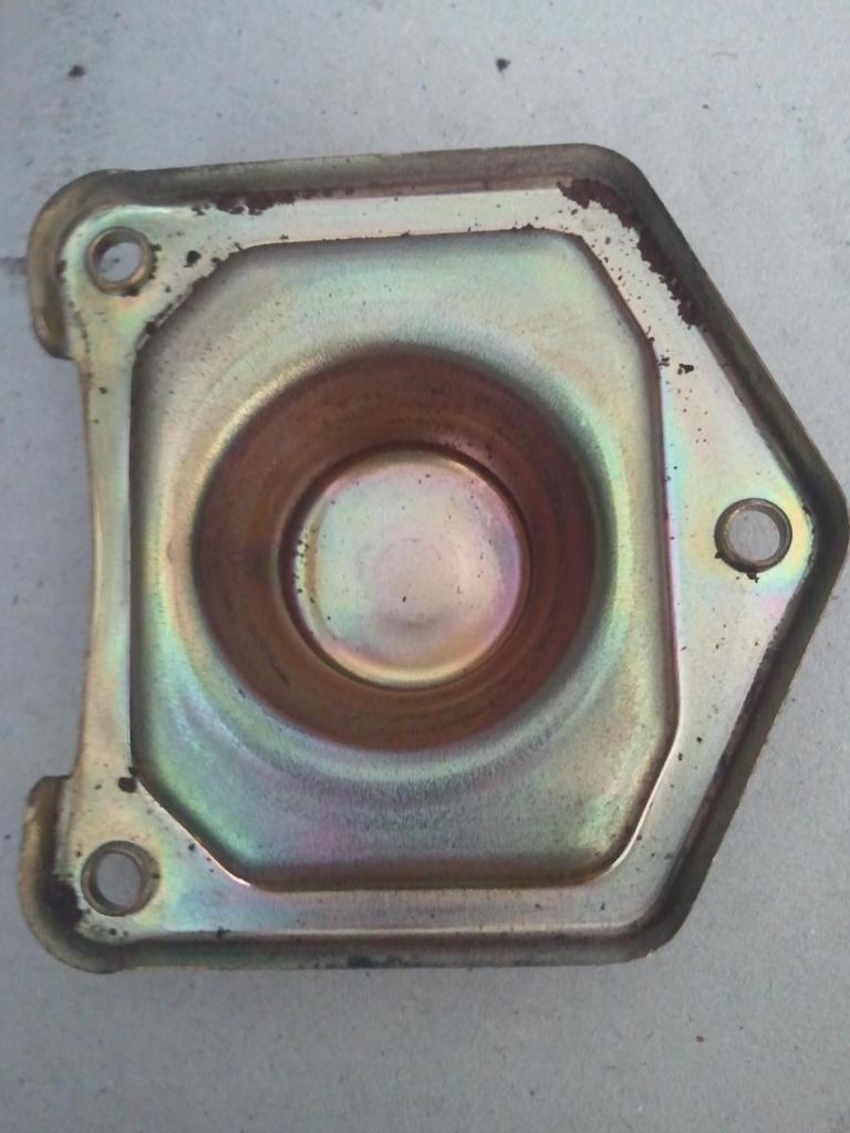

I had reinstalled the cover to prevent damaging anything during removal, so I unbolted the cover again; it looked relatively clean, and I easily wiped off the crud from its inner portion:

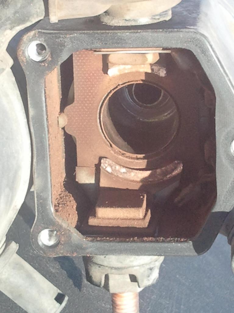

This next photo again shows how dirty the inner housing was:
I unbolted the starter contact on the battery side:

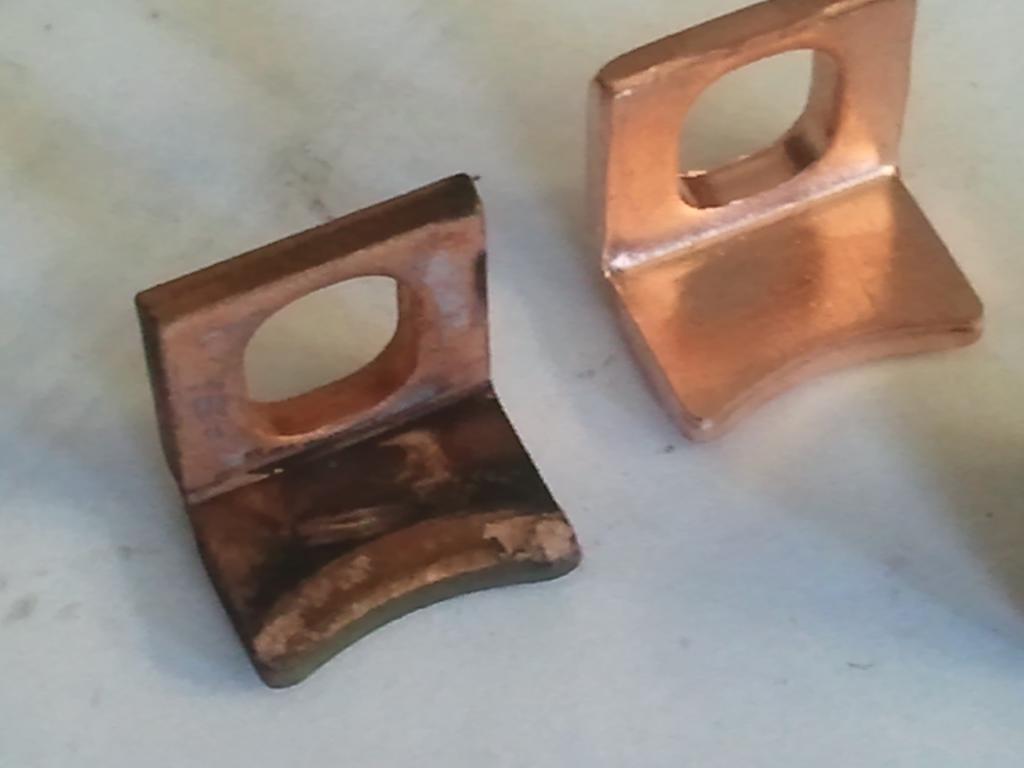

here is the new versus the old starter contact from the battery side:
and a close-up showing how the old starter contact (battery side) was pitted and worn:

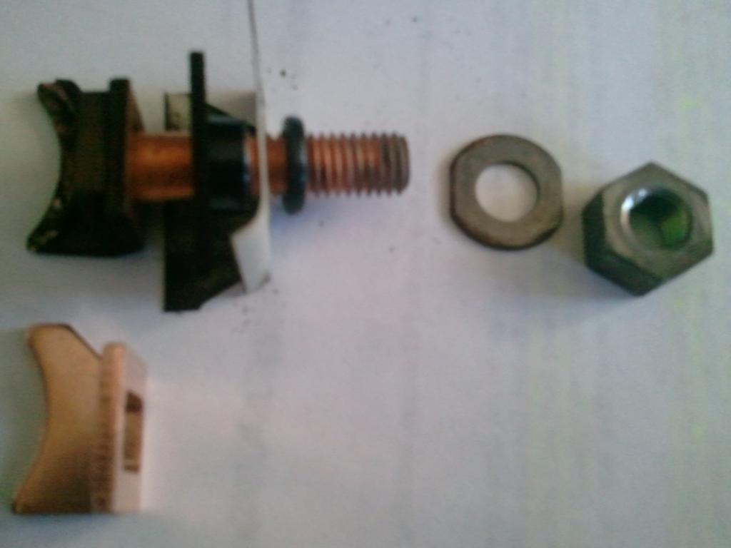

this next photo shows the inner housing with the starter contact removed from the battery side; you can see how much crud was built up in there, compared to where the contact used to be:

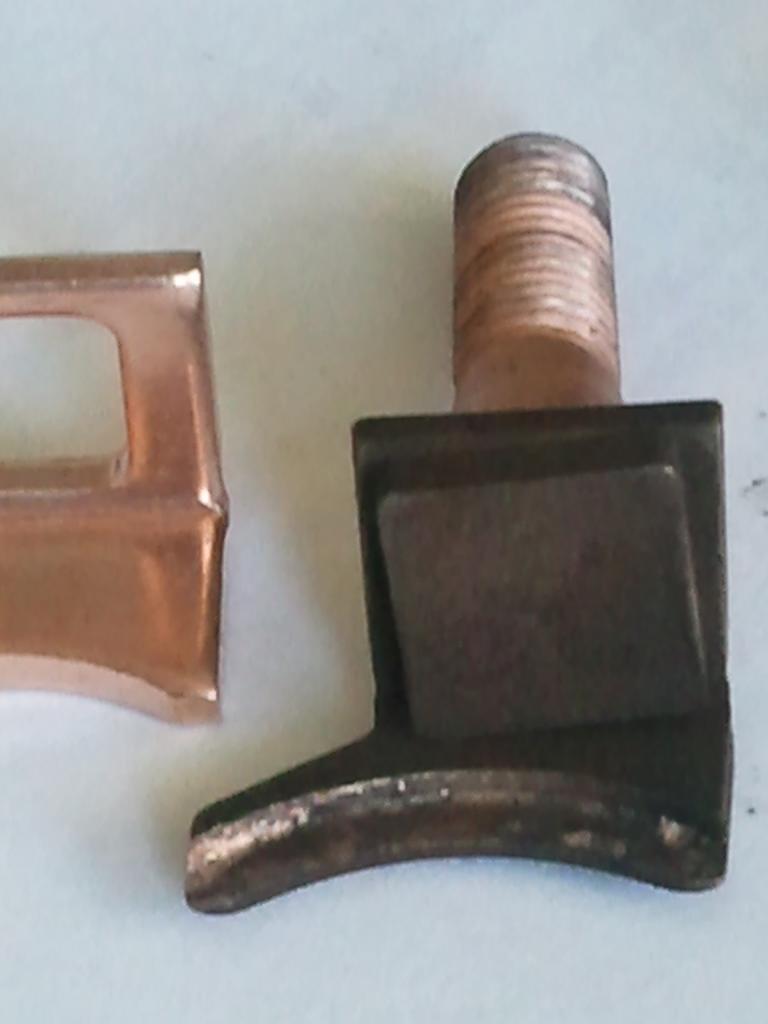

this is the starter contact removed from the motor side:
and a close-up, again showing the pitting and wear on the starter contact from the motor side:
I used cotton swabs and brake cleaner to thoroughly wipe and clean the inner housing:
and here is the finished result, a clean inner housing awaiting new parts (starter contacts and plunger):
here are the parts ready to bolt back into the housing (everything except the plunger spring):
and here are all those parts bolted back into the starter housing and properly torqued to specifications (I followed Dave's advice and used a large socket to apply force on both starter contacts as I torqued the 14mm nuts on the outside of the housing):
By the time I cleaned the inside of the housing and replaced the worn plunger & both contacts and bolted on the cover and torqued the three (3) 7mm bolts, I tried to slide the starter back in place from underneath the 4Runner, past the front sway bar and steering rack, the opposite way I had taken it out. I could just not, however, recall exactly how it came out, and I was unable to properly orient it for installation... and it was getting heavy lying under the 4Runner! So I ended up getting the starter back in place via the passenger wheel well; I had already previously unbolted the two (2) 12mm bolts which keep the brake line in place on both the outside and inside of the frame (based on THIS THREAD, whose instructions I had initially followed anyway), and it turned out to be very easy to maneuver the starter back in place that way. I read elsewhere that the starter is easier to remove on the 4Runners with 5-speed manual transmissions compared to those with automatic transmissions.
Anyway, now my starter starts right up again, and so I hope my intermittent starter issues (clicking, and one time recently, the starter still attempted to start both when the engine was already running, as well as when I tried to shut off the engine and removed the key from the ignition!) are a thing of the past... only time will tell whether or not I did a good job...

I meant to throw in the Toyota part numbers to help others in the future:
Each engine has one of two different starters, they are usually marked with either the part number or the kw.
2.7L (1.4kw) starter P/N: 28100-0C010-84 (non-cold spec)
2.7L (1.8kw) starter P/N: 28100-75140-84 (cold spec)
(Required) Contact P/N: 28226-74070
(Required) Contact P/N (non-cold spec): 28226-54340 or Contact P/N (cold spec): 28226-22050
(Recommended) Plunger P/N: 28235-54380
(Optional, if needed) Clutch P/N: 28011-26042
3.4L (1.4kw) starter P/N: 28100-07010-84 (non-cold spec)
3.4L (1.8kw) starter P/N: 28100-62030-84 (cold spec)
(Required) Contact P/N (non-cold spec): 28226-16130 or Contact P/N (cold spec): 28226-54340
(Recommended) Plunger P/N: 28235-55050 (non-cold spec) 28235-54380 (cold spec)
