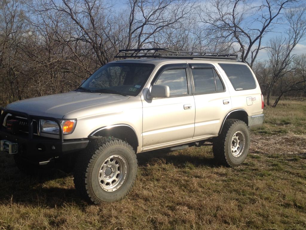

Originally Posted by habanero
That's pretty cool and those are some nice goodies, but yeah. At first I thought you were linking me to some pics of your rig...darn it!
OK, a teaser pic just for you, habs... you can see more when I'm back in the Show Me State in the Spring... by then the Shrockworks rear bumper will be mounted (the bumper is on now, but I still need to install the swing-out tire & fuel carrier), and I will add my Cobra CB and Yaesu 2m/70cm dual band radios, my sliders, two 13.5" LED light bars on the WMW roof rack, fog and driving lights on the Shrockworks front bumper, etc.

Like that roof rack hrt... and what rims are those?

Originally Posted by hrt4me
I had already ordered a SW rear bumper during the latest Summer 2013 group buy and had just planned to get the ARB 34230-20 bumper for the front until fjatheart sold me his SW front bumper.
I saw what you did over on t4r. It's a better fit with less cut and paste = good thing.
Way to notice! I flew out to Scottsdale last week for my annual mecca to fly in helicopters and fire guns at static ground targets, and EdmundGTP just happens to work for my host, so we spent some time looking at his 4th Gen 4Runner with WMW roof rack. I essentially plan to copy his dual Hanma 13.5" LED light bars, and in fact, Ed also pointed out (both in that linked thread and in person) that he needed to address their glare...
My daylighters work because of the length of roof that catches and blocks the glare from the windshield and hood. Can you emulate something along that line with a small metal shade, just enough to keep the light off where you don't want it? I think I've seen something like that for the KC lites, maybe check that out and design from there? Bet you're already thinking out something cool, would love to see it when you've got it figured.
Also, helicopters and guns sounds awesome. Okay, too loud and I don't like being too far off the ground unless I'm in a tree, but in theory.....
I did used to enjoy shooting at the shootin' car off my Cousin Jimmy's back deck. That were fun.
I still need to do the TBU with 231mm 13WL calipers, but I'm just not sure yet whether or not my current wheels will fit/clear; I do not want to run wheel spacers...
Well, the split-spoke and Landcruiser Rims will not work without either spacers or some grinding, but the Taco snowflakes (like on my 99) clear fine. 5-stars clear, from what I've read. These are prolly things you already know...it seems to me that the 5 star and such are flatter across, whereas the split-spokes come in a tad. !/4" spacers gave me about an 1/8" clearance with the split-spokes. Tire rub on the a-arm was a little bit of a problem even with the 1/4" spacers. Frame too, though less so. You've prolly heard all that before a few times.

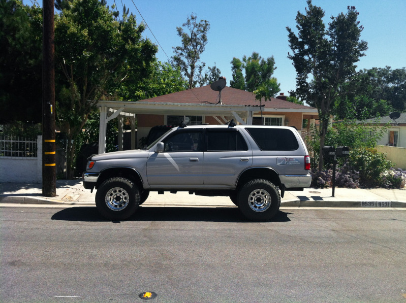

an oldie but goodie (the photo, that is)!
you may recall my wife and I went to Colorado this year at the end of July, but I did not have the 4Runner when I dropped her off at her women's retreat in Winter Park and went on to hike Long's Peak and explore Rocky Mountain NP and Glenwood Springs
I plan to take the 4Runner this year, and we want to hike Maroon Bells and then revisit Ouray and drive the passes; would you agree late July/early August seems to be an ideal time to go in terms of road and weather conditions?
BTW, my wheels are Eagle Alloys, but I'm not sure which specific model; they came with the 4Runner at time of purchase in September 2012... along with my current BFG All-Terrain T/A KO 285/75R16 tires
