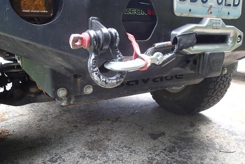

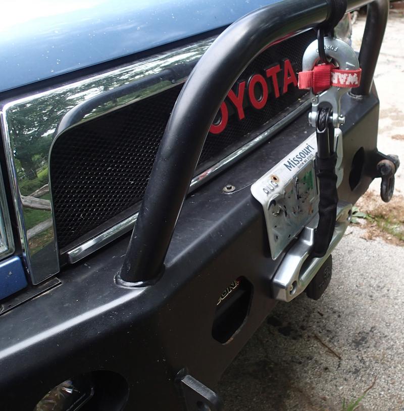

A while ago after getting the winch into the bumper I was thinking about how the winch hook and some of the line is below the front face of the bumper and wondered how people get their line up and out of the way to keep it from getting hooked, dragged, pinched or damaged.
This is the '99, but the '96 looked the same other than to the driver's left.
I saw this option for $19 shipped:
Interesting. I did a lot of searching for a D-ring that would work with my winch hook and came up with something from Tractor Supply for about $3. I already had the velcro.
So I put it together and got this:
Which I'll probably use on an as-needed basis (off-road) though I don't know how often I'd need the winch line to be that far out of the way.
I believe the husbandio is going to flip the D-ring he has the winch hook attached to (first pic) up and tighten the line a little to make it stay so it won't be hanging below the bumper face either.
And that's my super-dumb mod of the day.

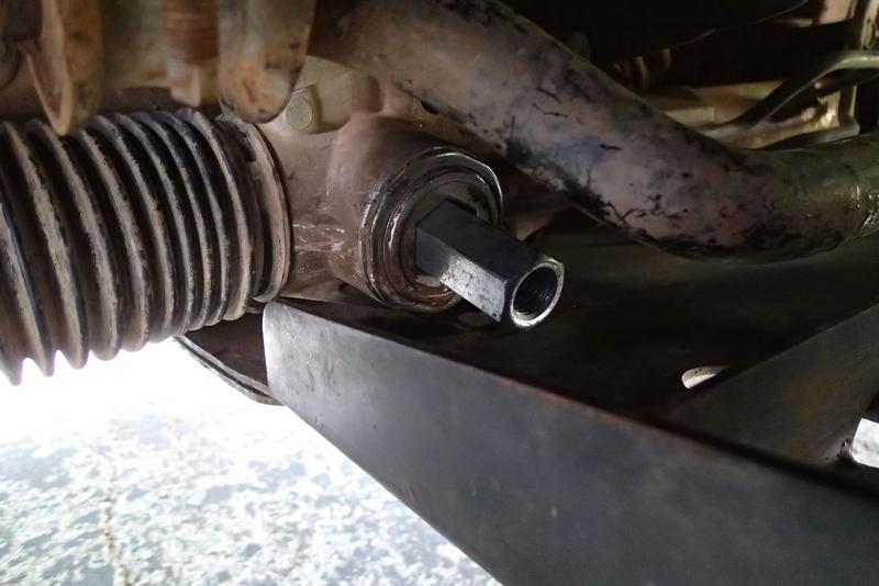

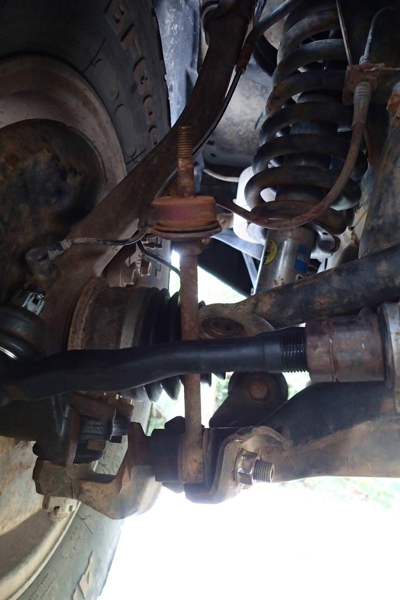

Highway test this evening- the shimmy that wasn't as bad as the bad upper control arm bushing but increasing in severity appears to be gone. Still getting the stupid guide just right, it's not real easy if you've left the skid on like somebody here did.
Look, these actually unbolted without breaking! Removed the links so the sway bar could come up out of the way of the guide.
I forget who came up with using this handy dandy threaded rod connector (Home Depot, cheap enough)but it's an awesome find for this job. You have to loosen the lock-ring before adjusting and be aware that the nut will want to tighten along with the lock ring.
And the husbandio swapped his 3rd member. The 99's got some sad bearing sounds in the old one and we have a spare. Now the '99's will be a spare. He also pulled the e-locker because needed to move it over. His E-locker looks so much cleaner and less corroded than mine. It had a crack on the back which got jb welded and he had a great time swapping things during a heat warning day.

My caliper says the outer size of the rod nut is right at 24mm if that helps. It does appear to be for 5/8" threaded rod.

It's a bit of back n forth, trying to get that thing tight enough but not toooo tight, isn't it?

Awesome! I ran out and checked my rod nut, definitely won't fit in a 21mm socket. You must have gotten the special one.

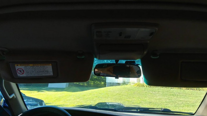

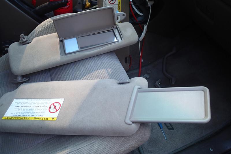

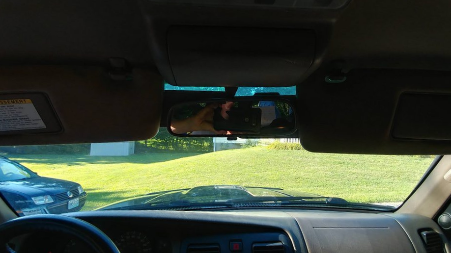

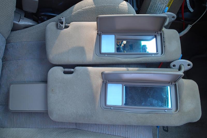

Junkyard run today, mostly for ^ Volvo parts. Husband mentioned a 4Runner showed up on Row52 while I was scrounging around the pick n pull. It's an '02 and lo and behold- EXTENDING VISORS!
Been watching for these almost forever.
Of course, they're not grey which was a small bummer but even better, they are oak or tan or whatever that color that's not grey is called.
So Happy Anniversary to my husband and I'm sure he liked working in the heat-warning hot this afternoon. If it weren't for the extra wiring this would have been a cut and paste job. One of his visors already had electric and now they both do.
Old vs New. 5 1/2" wide vs 6 1/4", and as you can see they're longer, too, even without the extension out.
New ones installed...
Down:
Down and extended:
