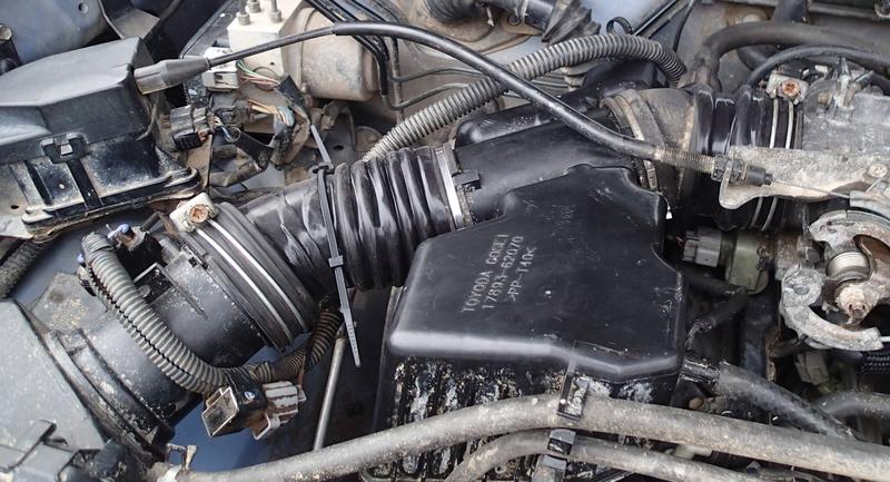

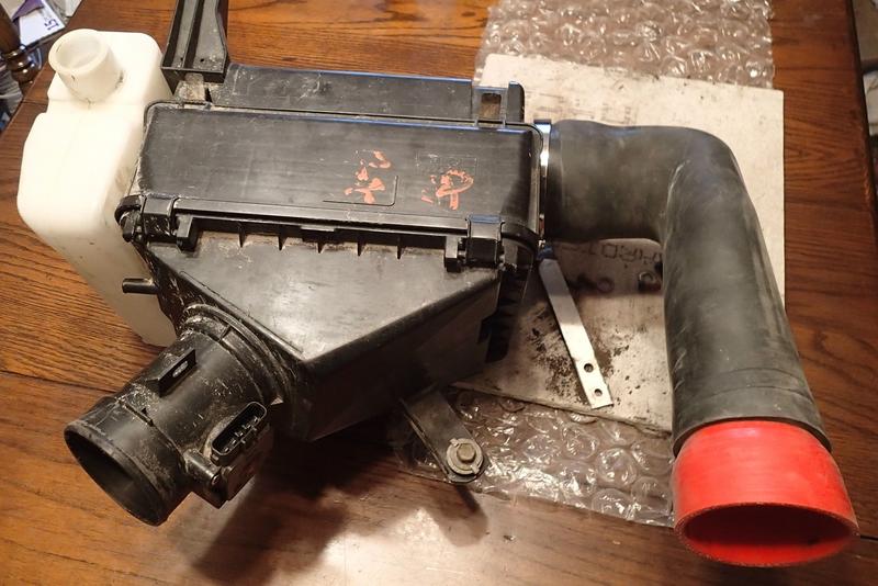

The union between the snorkel and air box has a very short interface which bothered me. I've 'borrowed' one of my husband's silicone reducer hose bits to extend the elbow and get a better, more secure fit.

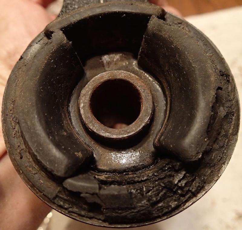

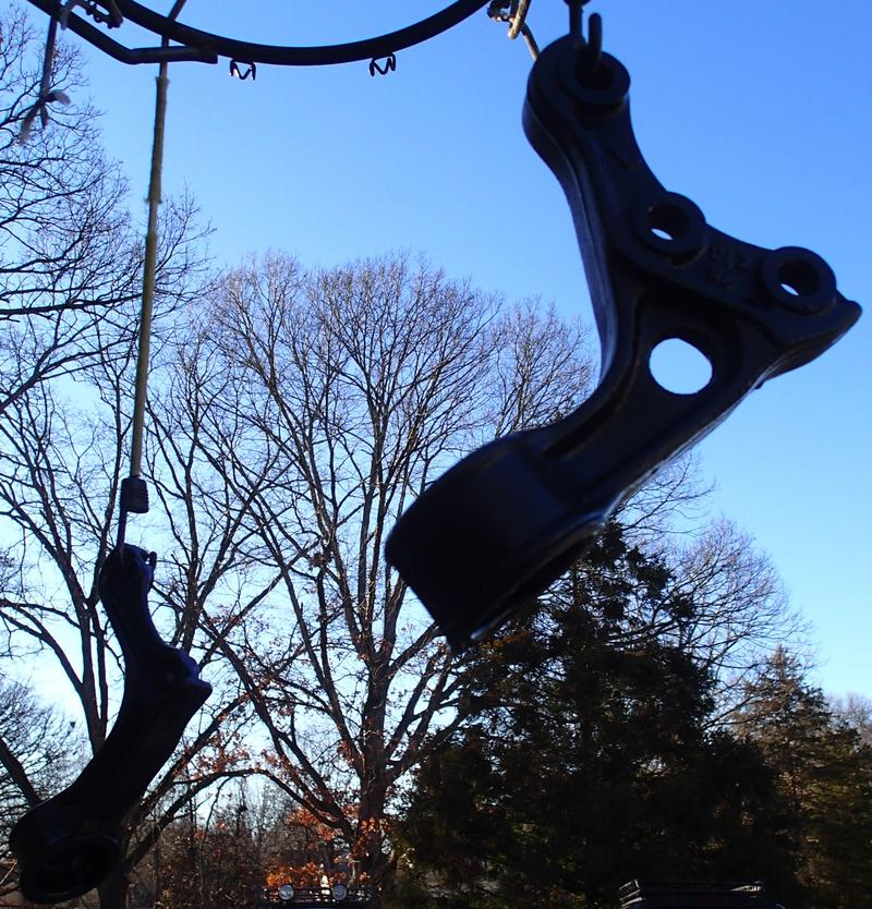

Saw a set of replacement front differential bracket bushings when plasticsguy over on t4r posted a thread to gauge interest and quickly developed the product. I was concerned about removing the old bushing sleeves but you only remove the bushing for these.
https://www.toyotabumpstops.com/inde...cket-bushings/
Had them in the cart and was putting off buying them but then he ran a black friday special so of course I had no choice.

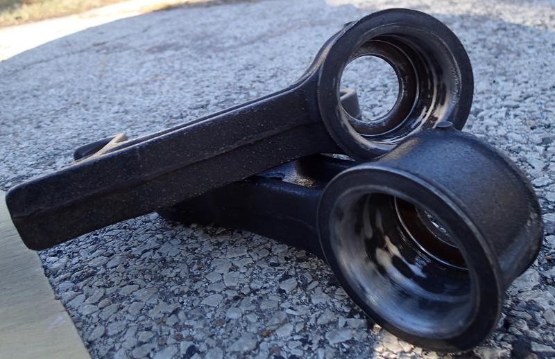

Dug the dif brackets off the '96 out of the basement in preparation for their new bushings-
Step 1 is maybe I should clean them...

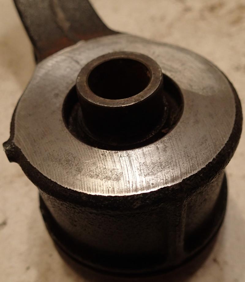

And then I gotta get the bushing out. The how-two said heat the surrounding metal and they'll release to either pop out on their own or push out.
Nope. Maybe because it's cold out, even though they were already partially separated from the sleeve these fought me quite a lot.
Eventually:
According to the Durobumps site painting them adds 5 hp. I fully expect and believe that.
If everything goes as USPS says they will show up tomorrow. Once that happens it's a matter of finding some spare time.
