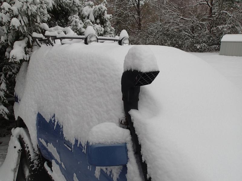

Dangit...
And it's still snowing. When it's done I'll pull the blanket off and see what's what. Still supposed to be above freezing tomorrow.

Well, at least the snorkel mod. still looks great!
I guess this is what happens when we joke about snow....
Of course "above freezing" probably means 32.1°F or "just" above freezing.

But I didn't know I'd need the snorkel mod to find the truck in the snow...
Supposed to make almost 50 tomorrow and mid 40's on Saturday! I am unreasonably excited.
Hmmmm, the snow mod.....
Excited to see progress? You and me both
Today I did the usual snowday things, get bored hanging around inside and running out to shovel a couple of neighbor's driveways- only this time I forgot that my 4Runner....isn't....so I'm driving the VW wagon- which means we also shoveled our driveway too.
After that I cleaned a lot of the snow off the 4Runner and shoveled around it in preparation for tomorrow.
Still looking for something to do and have a house-bound neighbor so winter showed up waving hello right outside his window.

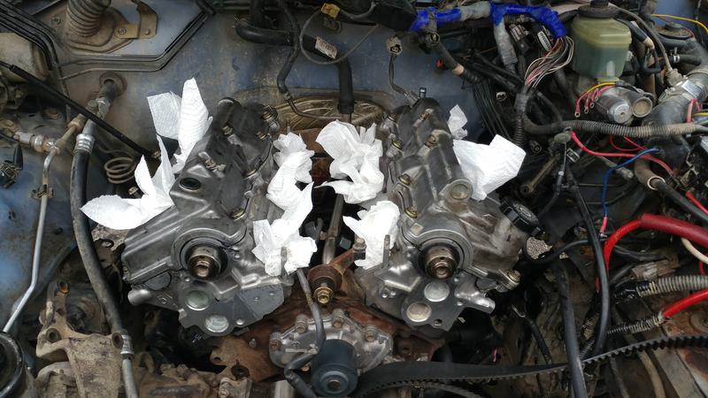

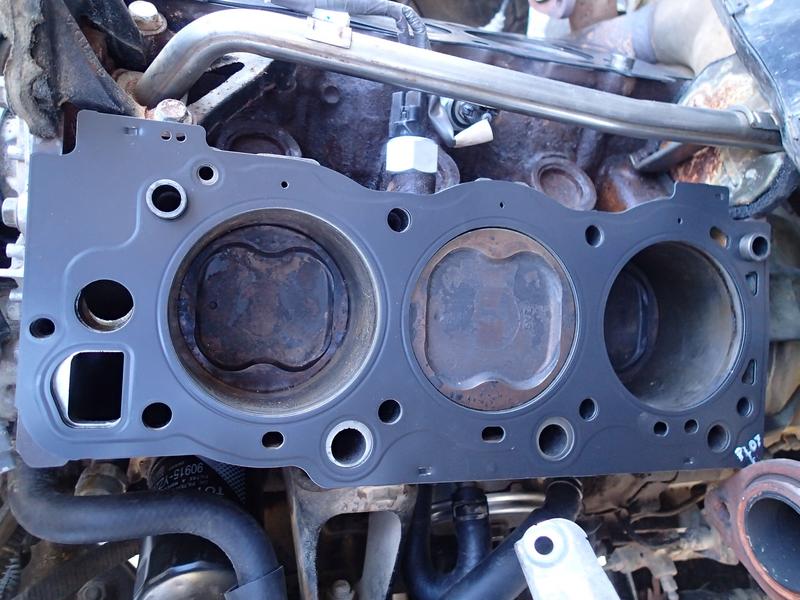

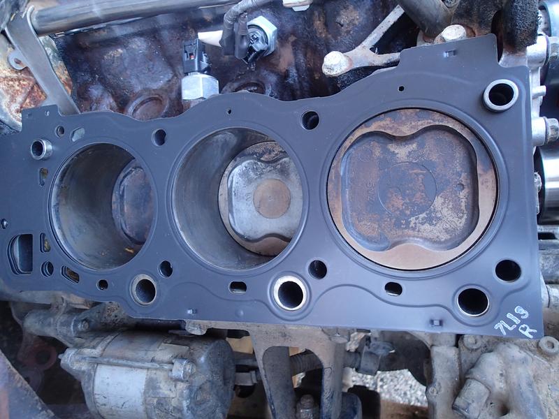

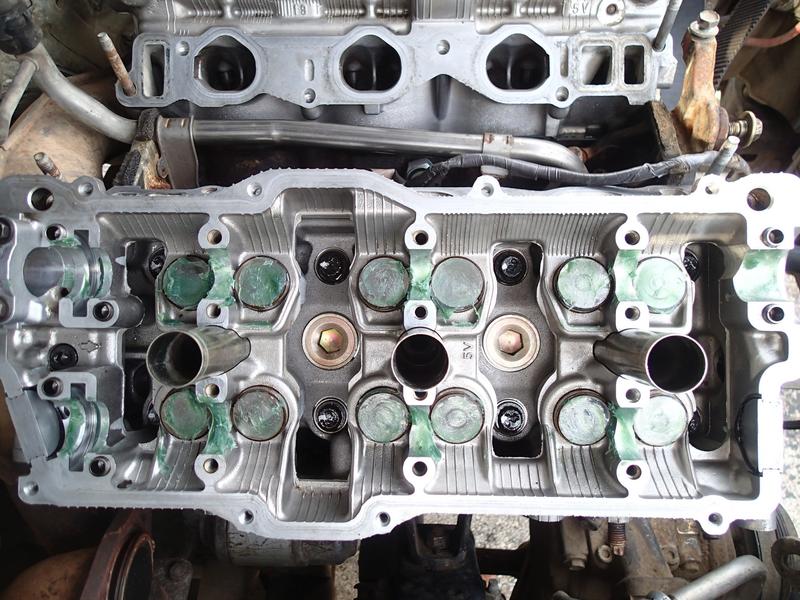

96 4Notrunner
Got home this afternoon, it was 52 degrees, one last wipe-down of the block and clean-out of the holes, then the MLS (stock gasket for 1/99-02 instead of the composites) head gaskets got plopped on, they are marked L and R so driver and passenger
#11115-62081 right
#11116-62081 left

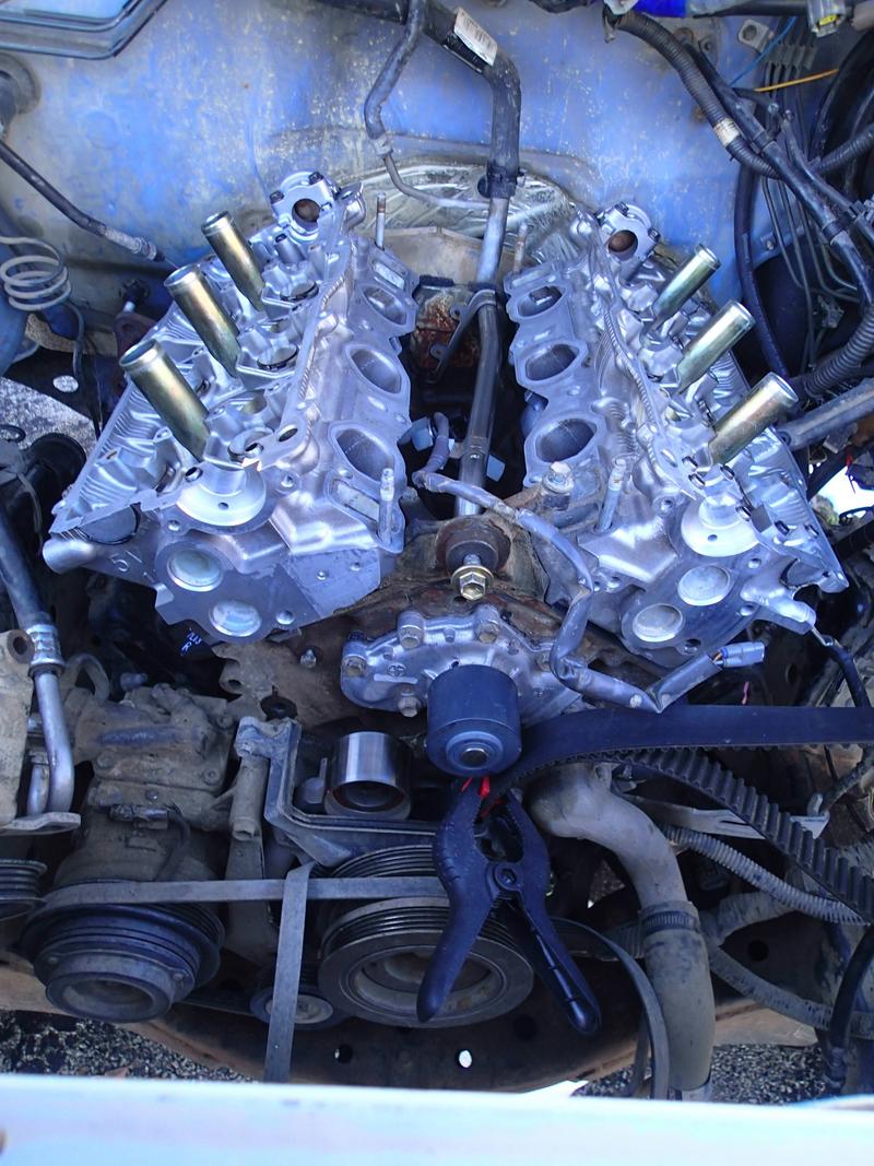

A couple of straw guides...
The prettiness...

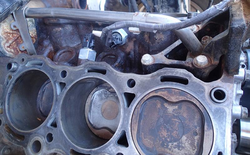

And a pic of the knock sensors for anyone who might want to know what they look like under the intake manifold
annnnd then the kid came home adn the teacher emailed a bunch and I felt like some kind of go-between and ran out of daylight.
So the heads are just sitting there looking shiny. Tomorrow maybe I'll get some bolts in! New ones, TTY bolts.

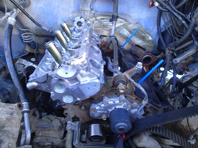

I also got to work on the truck today.

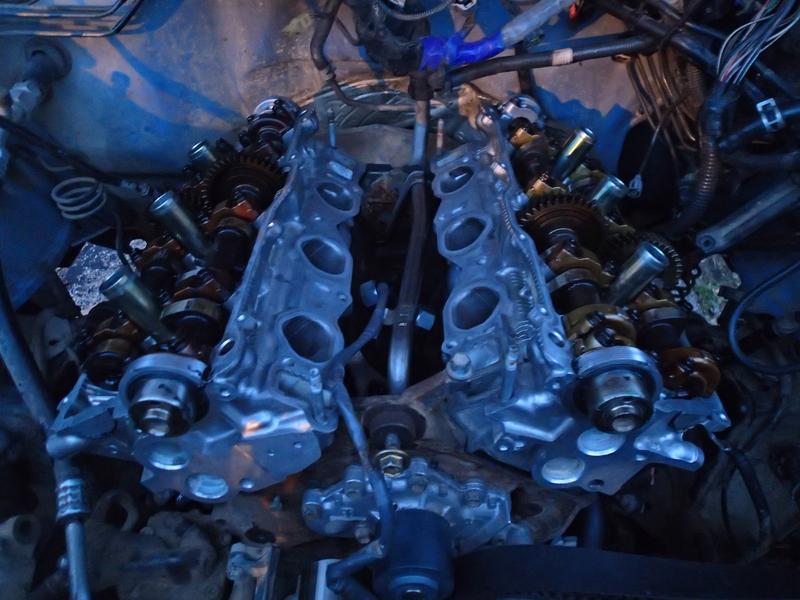

Cleaned out the bolt holes and stuck the head gaskets and heads back on.
Heads now officially on. Dunno if you can see the little silver marks on the new head bolts....25 ft lbs in a pattern, wait a little bit and double check 25 ft lbs, marks towards front on bolt heads, 90 degrees, 90 degrees. Marks now at rear.

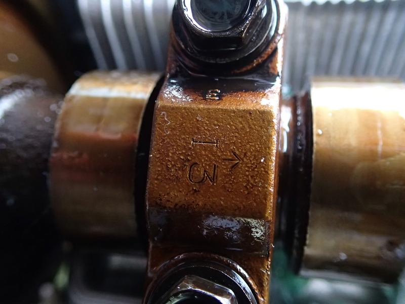

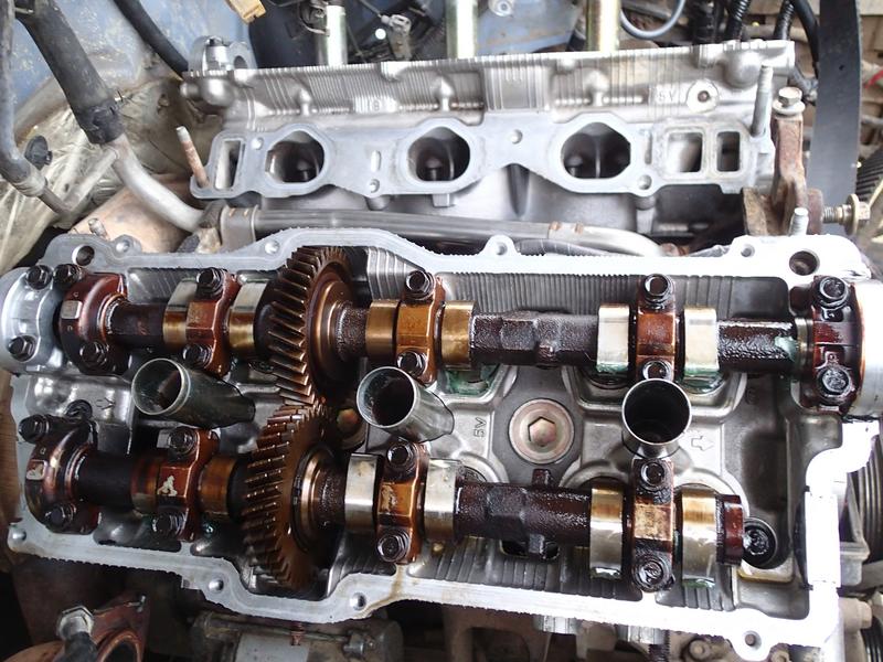

Right side cam first. Intake, then exhaust. Caps on (they're numbered and arrowed)
16 ft lbs in a pattern, several passes tightened evenly. Got the little double dots on the gears lined up and exhaust cam installed, same on the caps. Once everything was good I removed the bolt from the exhaust gear and turned the cams to line up the single dots.
About halfway through the right side the wind picked up and brought a 12 degree temp drop. With humidity it now feels like 36. I'm freezing but want to get the cams in and done.
So I did. Double checked the caps are on correctly and the dots lined up, and remembered to remove both of the sst bolts from the gears. I'll triple check before putting the valve covers on- that's the next step.
Pic is kinda dark because I ran out of daylight. It's getting there!

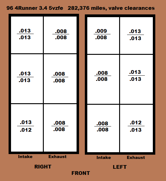

96 4ever getting worked on
304,219 miles

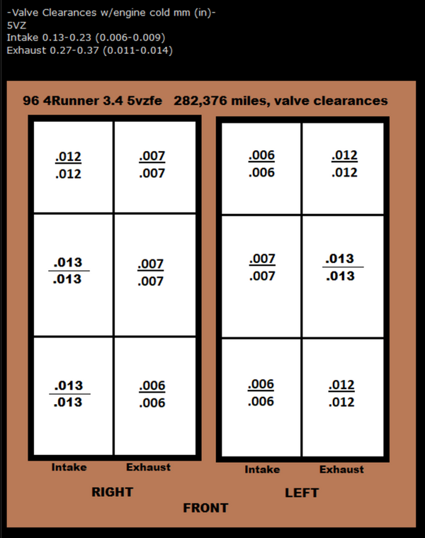

And not that it matters, but the one I did when I did the valve cover gaskets at
282,376 miles

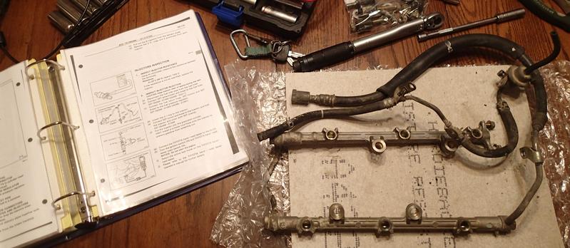

96 4get that blowing up thing!
Too dark for outside but not too dark for inside.

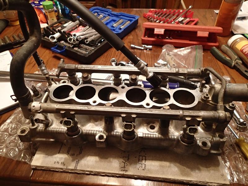

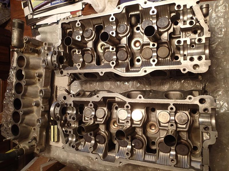

Prepped the intake manifold with its injectors that came back from Witch Hunter, all new vacuum line and new fuel line. The rails got new metal seals and everything was torqued to spec.
Was very careful about the injector o-rings, hopefully I did good. All of them moved freely before I torqued the rail down

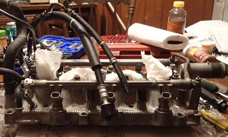

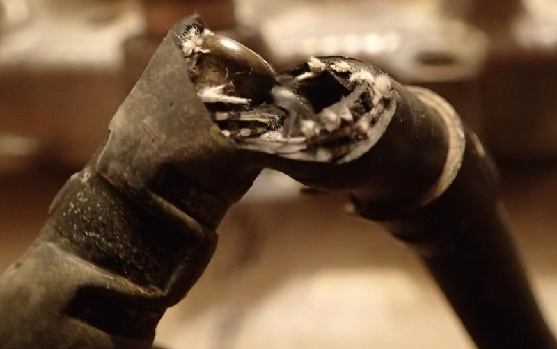

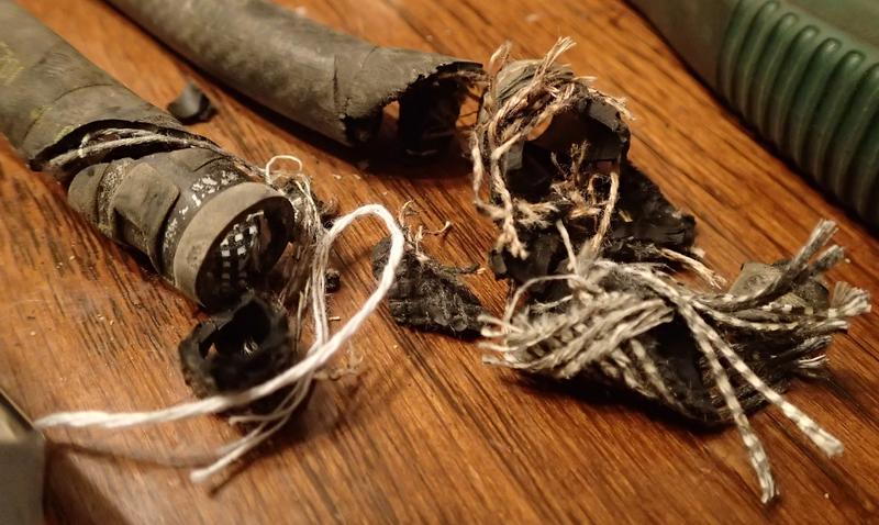

When I twisted the return fuel line to pop it free from the hose nipples it fell apart
I'm really glad I'd decided to replace the fuel lines!
Ready to go
