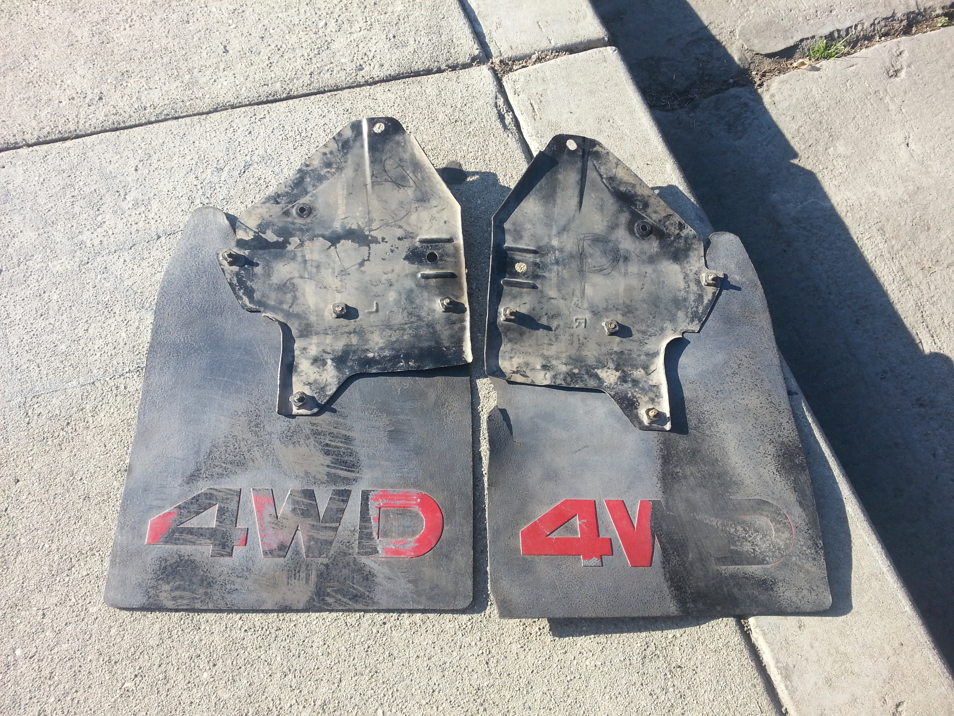

Fixed my mud flaps today. That was a quick little fix. Ever since we mounted my rear bumper i lost the bracket that holds the mud flaps away from the tire. So as a result i had lots of rubbing over the past few months especially in the past 2 weeks. This past offroad trip my driver side mud flap was torn off. and the passenger side was beginning to get mangled on the leaf spring. So i had to fix them.
Here are what they looked like when i took them off the truck.

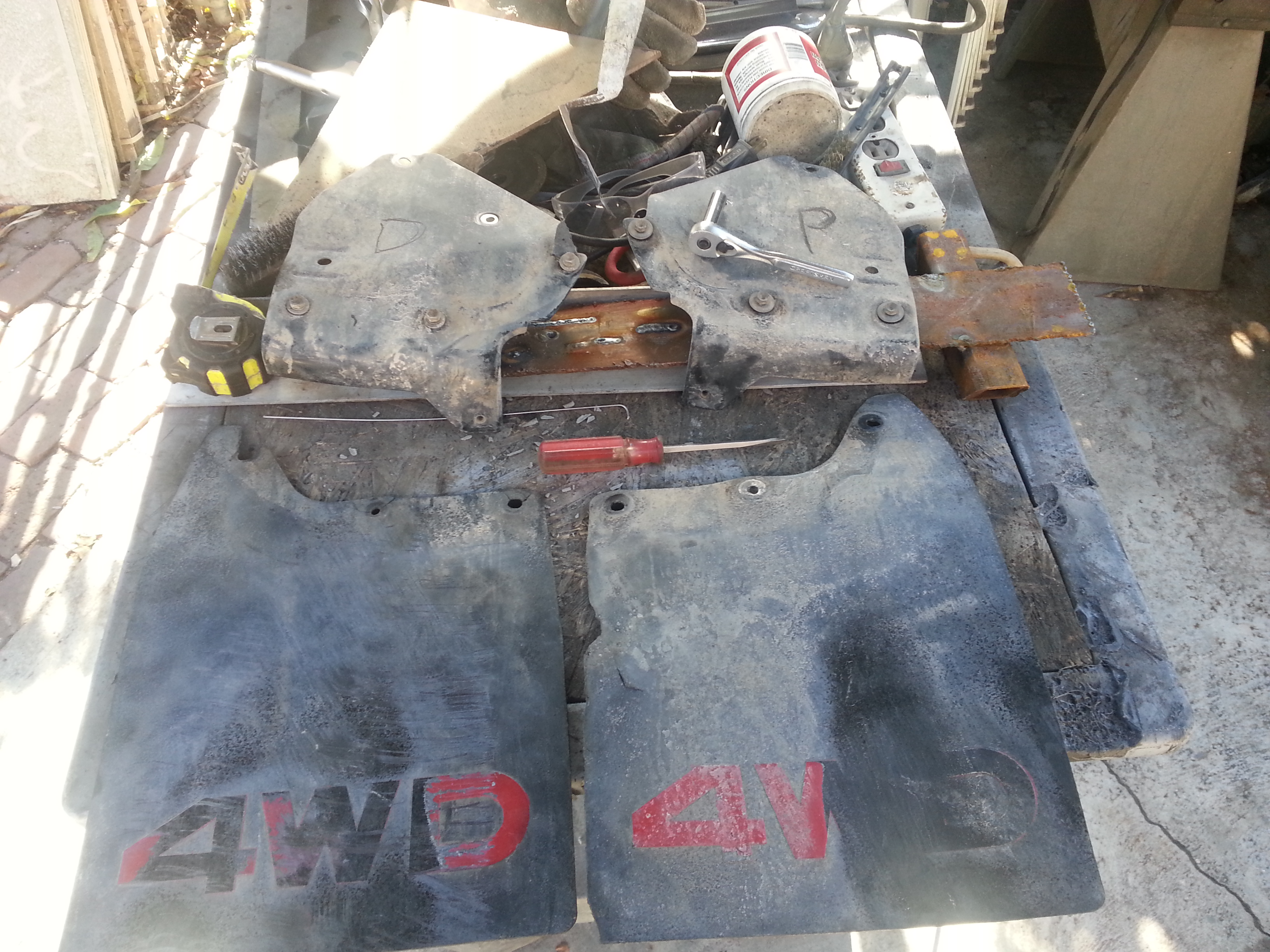

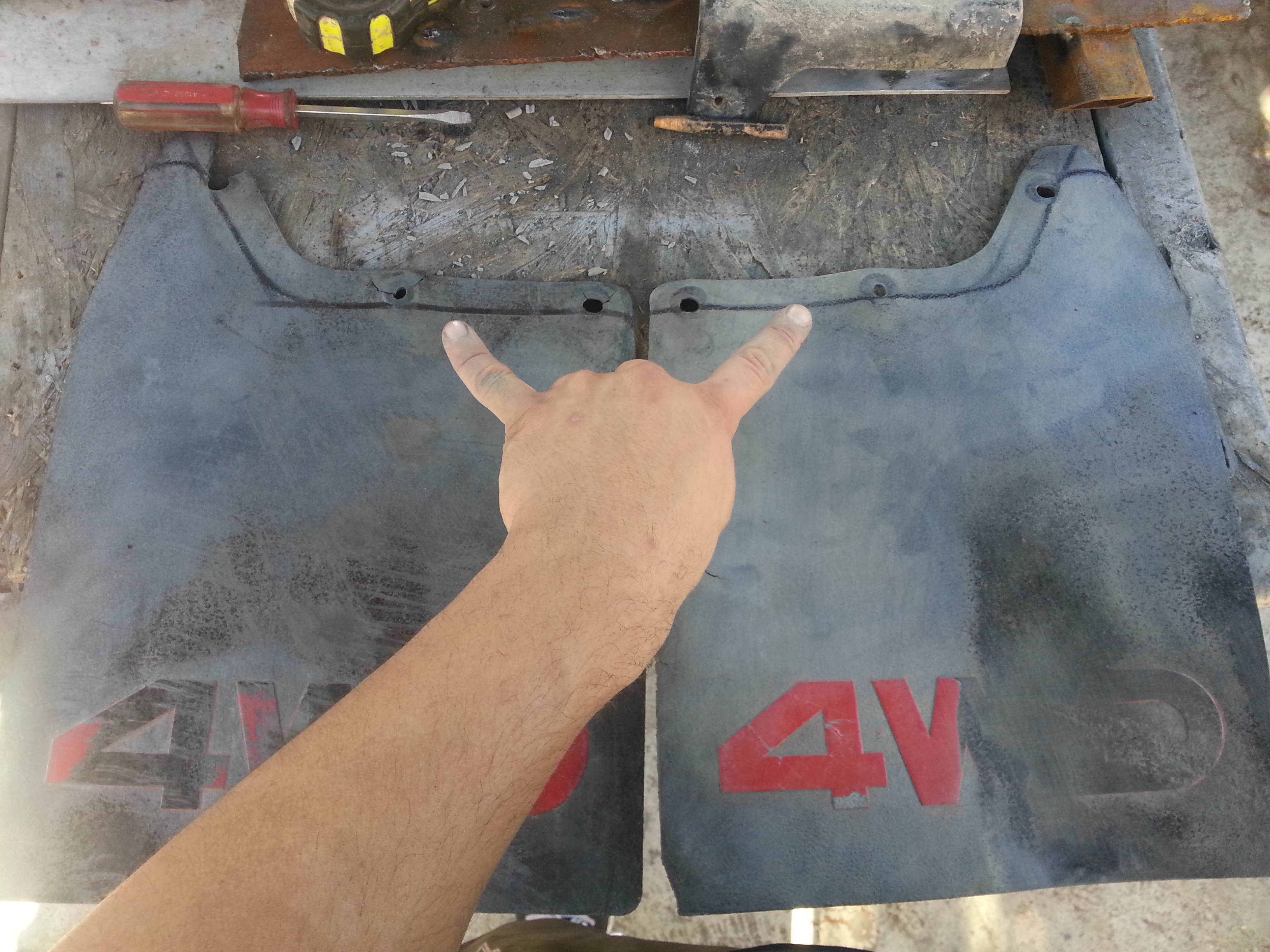

traced lines for where i need to cut with the jig saw.

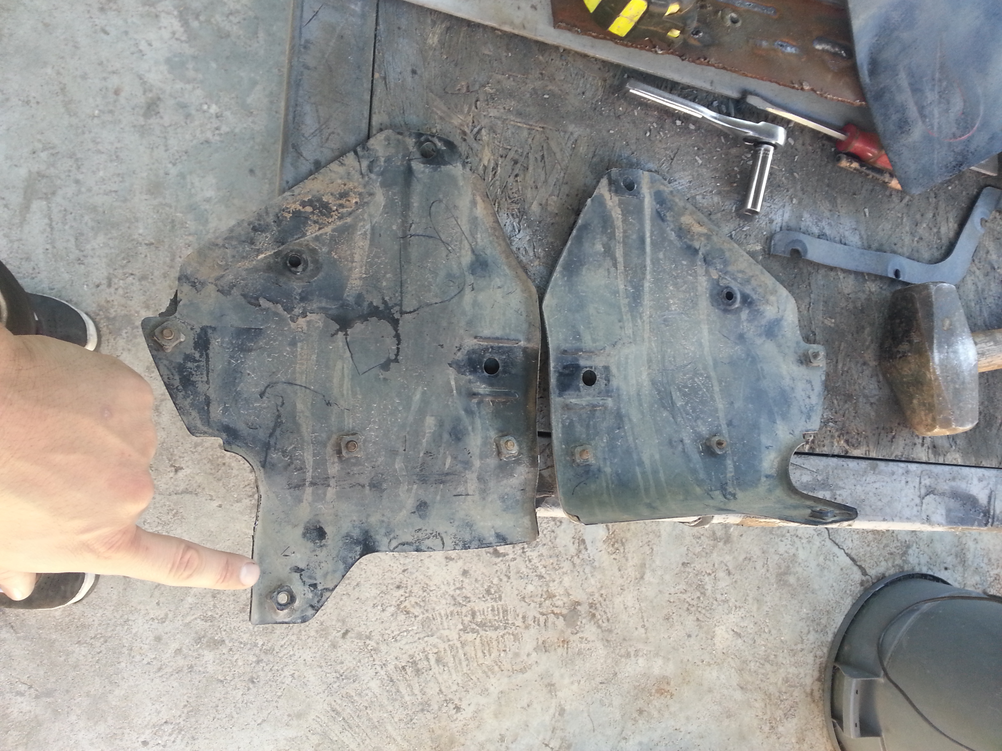

I noticed that i could bend the bracket down to be flat vs the "L" shape it was. The "L" shape part is where the old bracket used to mount to to pull the mud flab back. But since im not using it i took a hammer to it to flatten them out like this
Drilled out new holes on the mud flaps, and with that bracket bend downward i was able to hold those mud flaps back away from the tire to prevent rubbing. it works great! All that is needed now is to get some red rubber paint and redo my "4WD" text on the flaps.
Finished job
