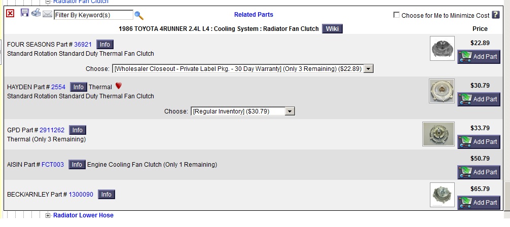

Rock Auto Prices:

Yes, it's that simple (at least it was on my 3.4) and Aisin is the stock manufacturer. The torque values may be at the end of that manual section.
