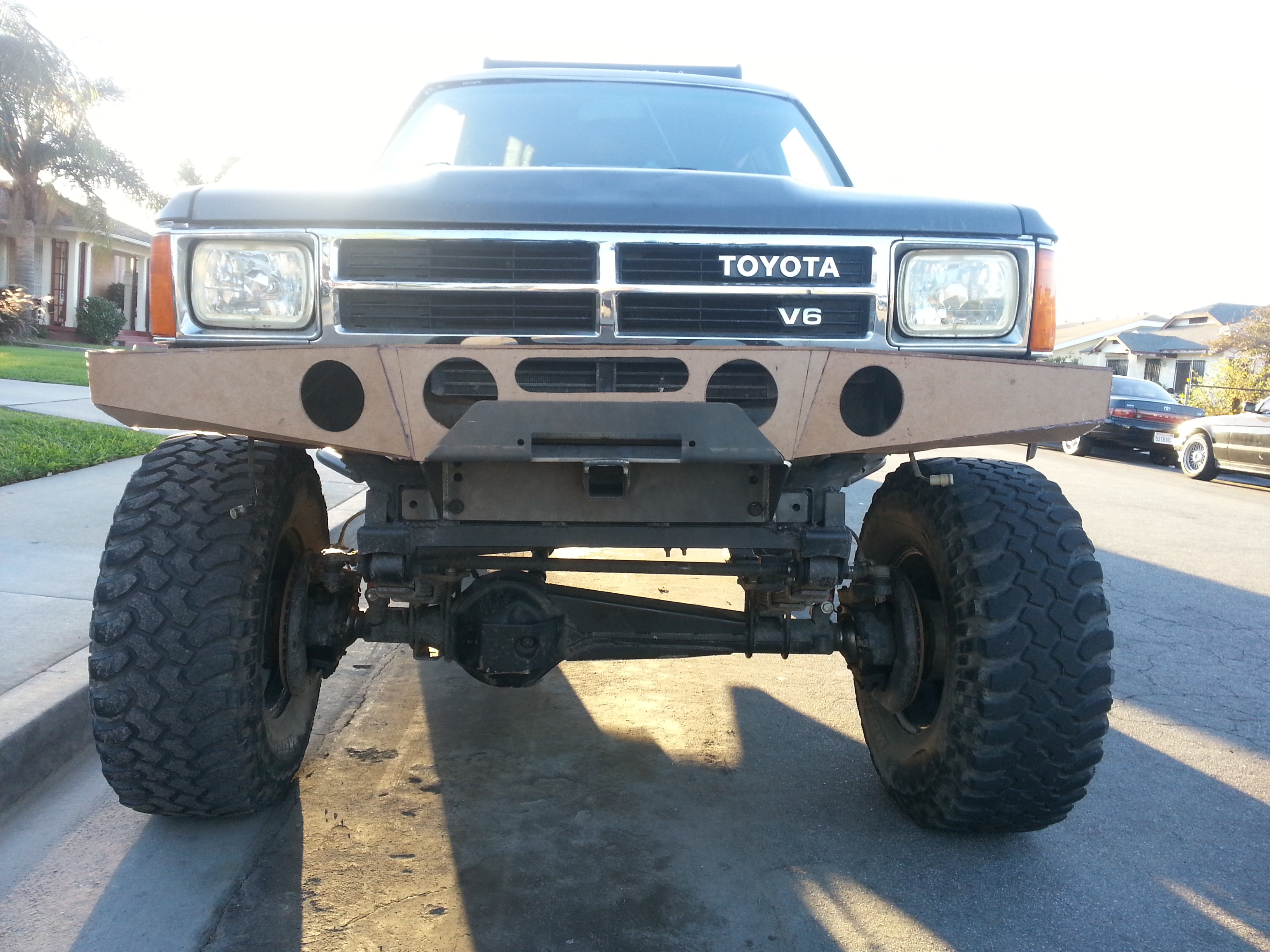

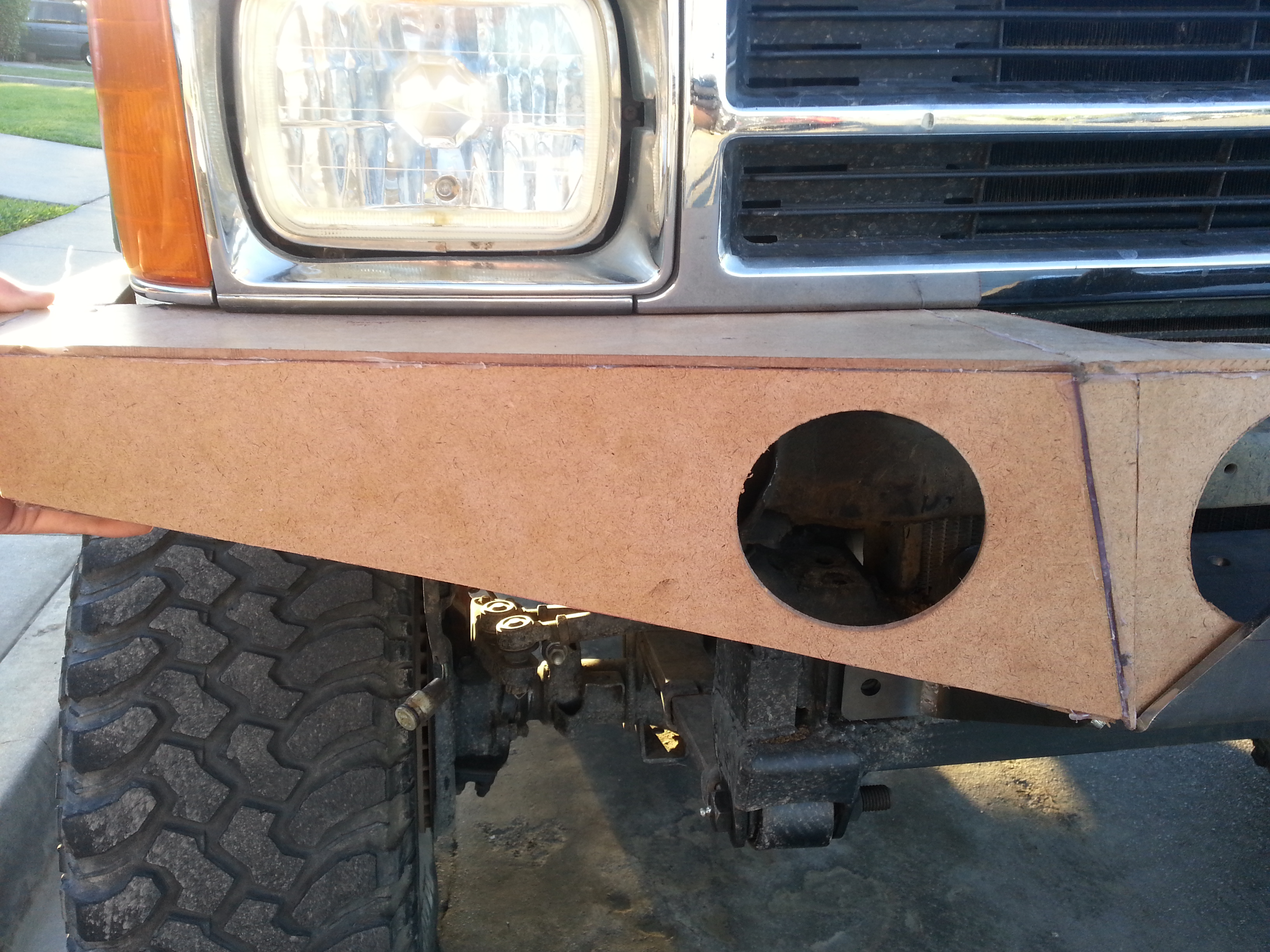

So pretty much this is all summed up for the past 2 weeks.

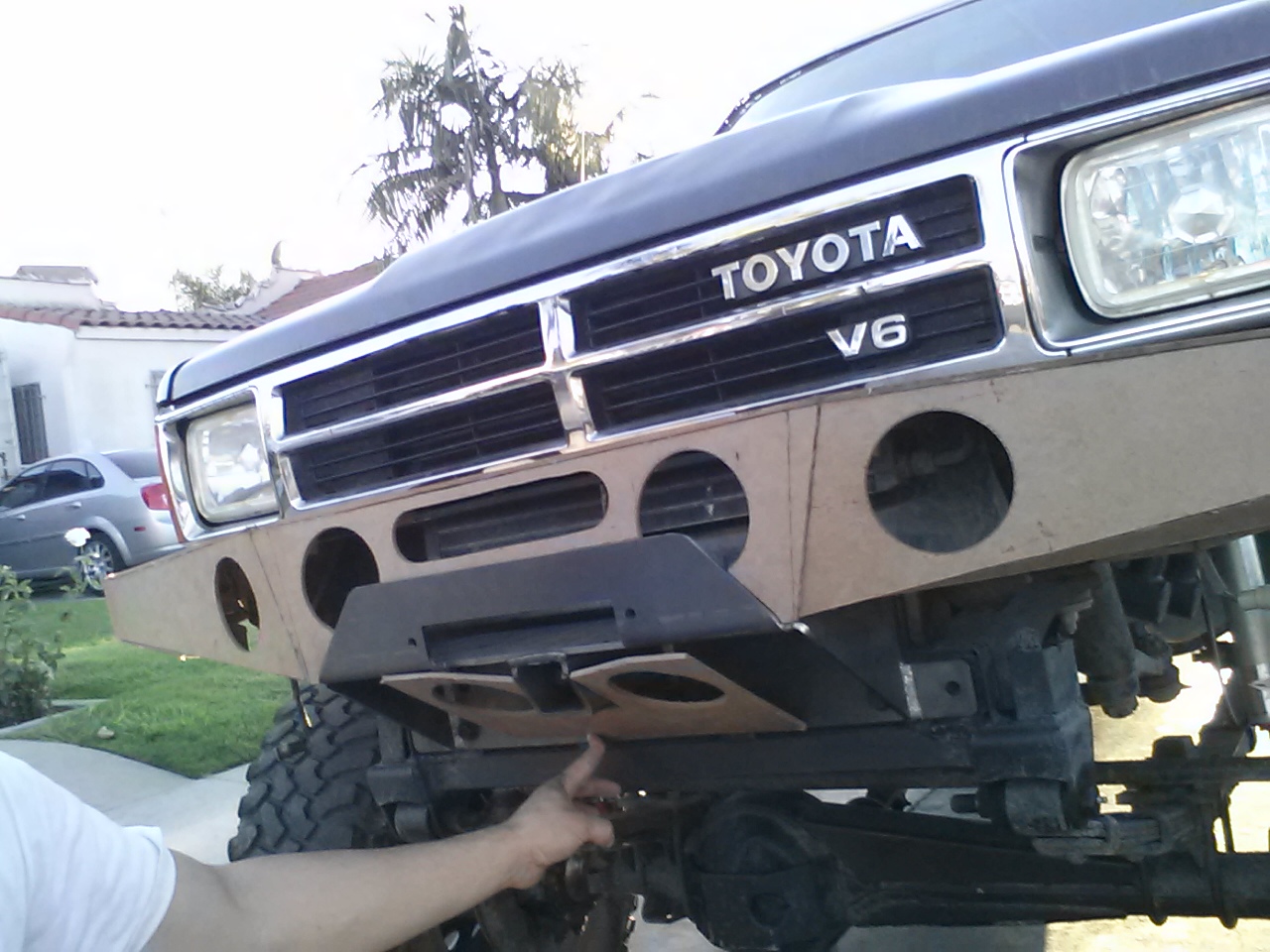

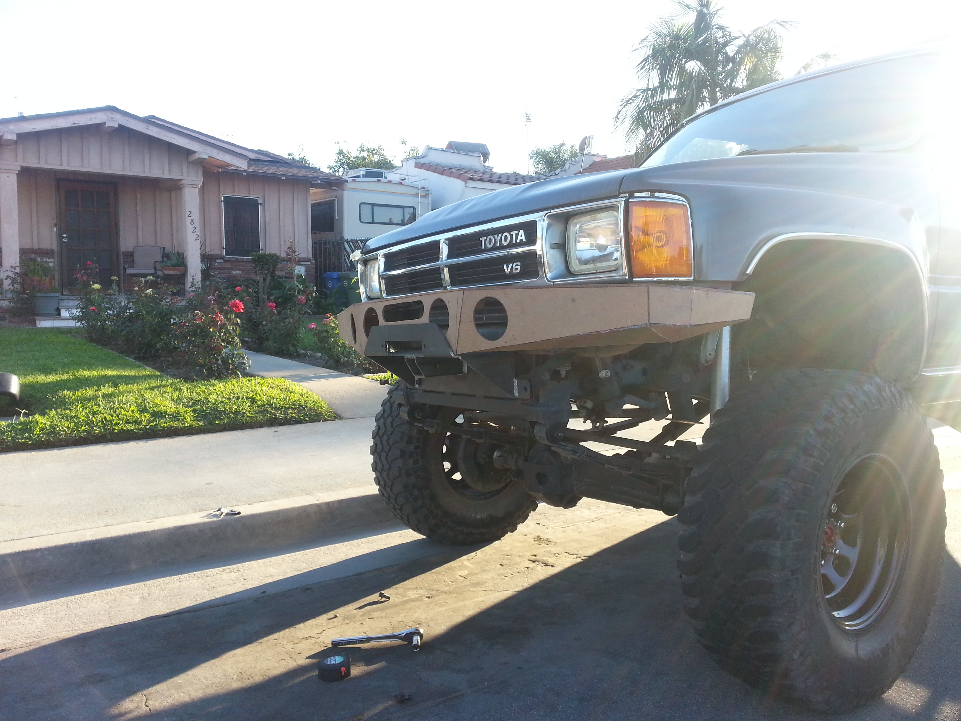

Alright guys I managed to get some type of progress in. Not a lot. but it was just fitting the prototype. Either way it was still fun.
My favorite shot.

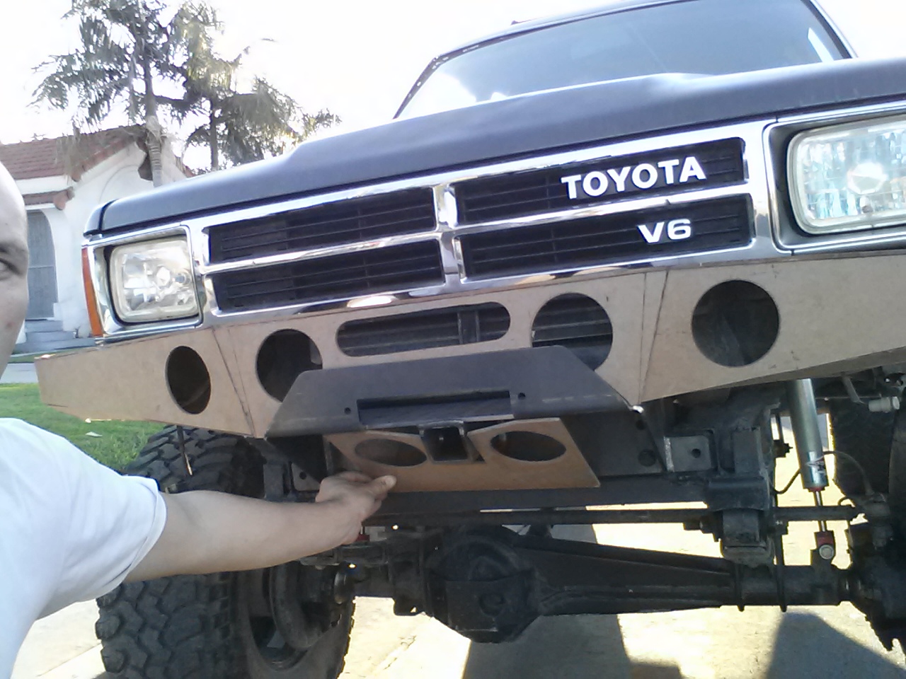

I realized i have too much of a bump on the bottom side of those corners. It has a lot to do with how the bumper is curving like an arch. but even when straightened out you can still see a slight bump.I'm just going to need to make sure that when i do the real thing to tack weld those ends first before actually welding. Also the small square piece that connects the front face to the side is too square. i need to make it more at an angle; i think so at least. Maybe im just being too picky now. but I'll make sure to fix this when the real bumper comes around.
Dont mind the top curve. it isnt going to be like that once it is made of steel. It curves because the sides are to heavy for the center to hold up with just hot glue lol Also see the center holes. This should be plenty of ventilation for that radiator. they are pretty big size so even though the winch is there i'm sure it will get plenty of air.
Corner
Winch spot
Now here are the few problems i ran into:
The bumper needs to be shortened a total of 3/4" to be able to clear the screws and clips that hold the grill in place. So that will need to come down some. As you can see in the picture below that bumper is right up against the grill.
The whole overall width of the bumper needs to be shortened 1.5". I thought i had the measurements correct and i drew everything out according to all measurements the tape measure gave me and also based on the stock bumper dimensions, but when i had the stock bumper width at 66" from edge to edge(where the bumper ends go to the wheel wells) it just looks goofy. It's too wide and you can definitely tell. Will need to shorten about 1.5 maybe even 1&3/4 to be flush with the fenders.

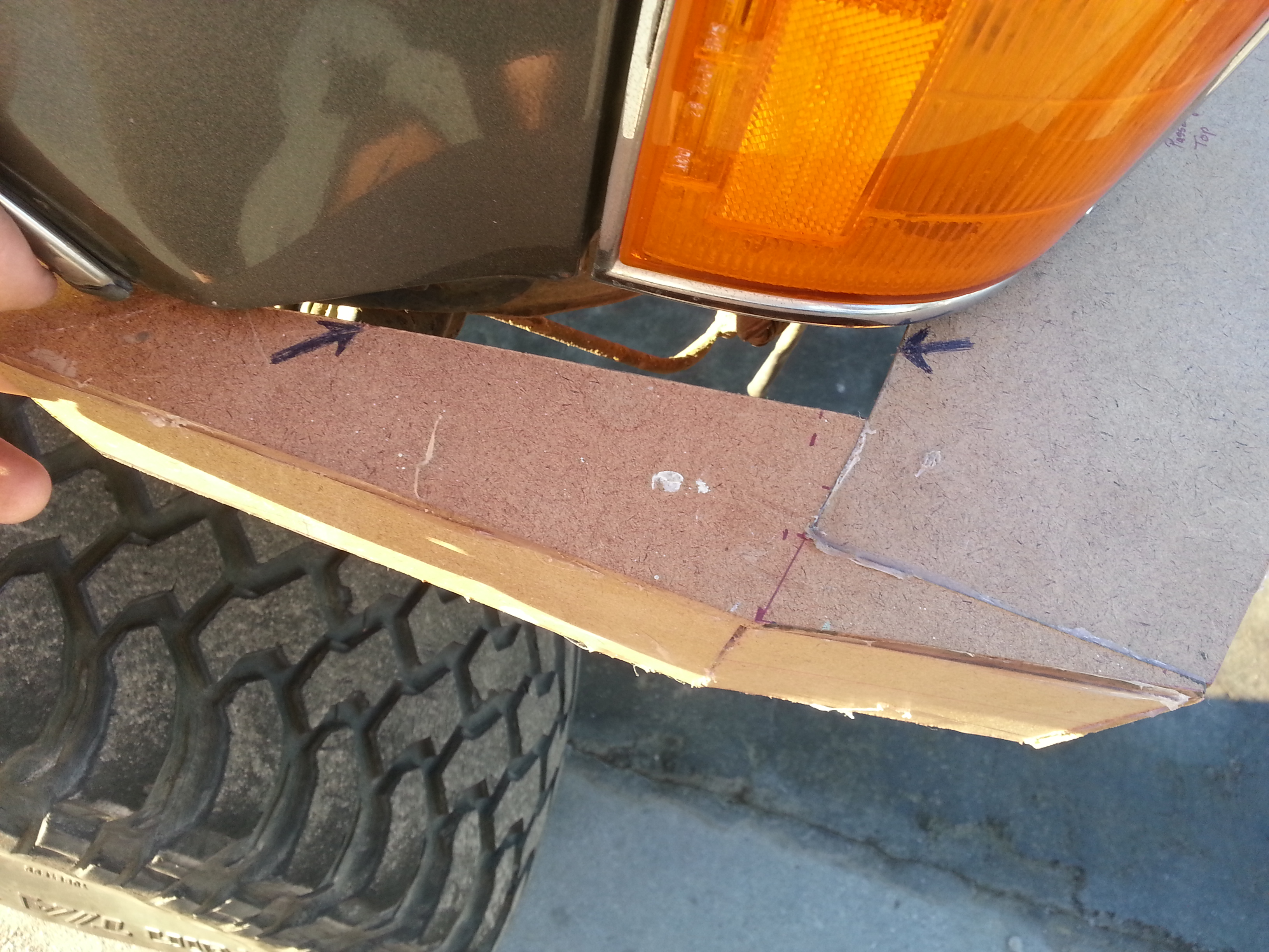

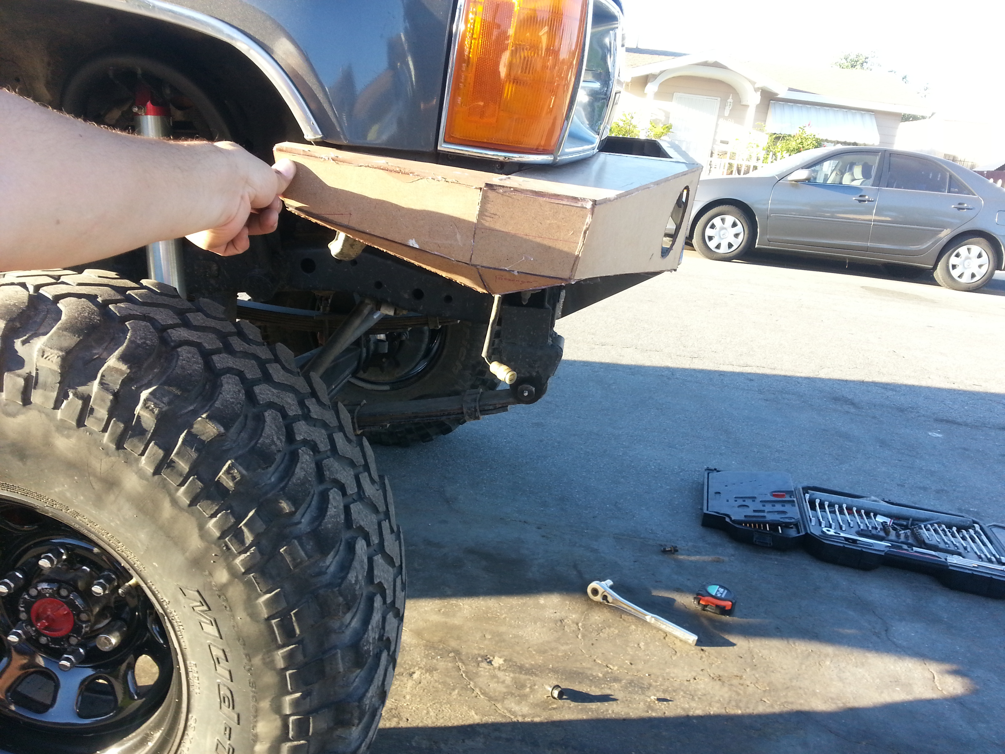

The corner piece had a gap on both sides. i am going to need to bring in this piece about another inch toward the center. I put arrows to show from where to where.

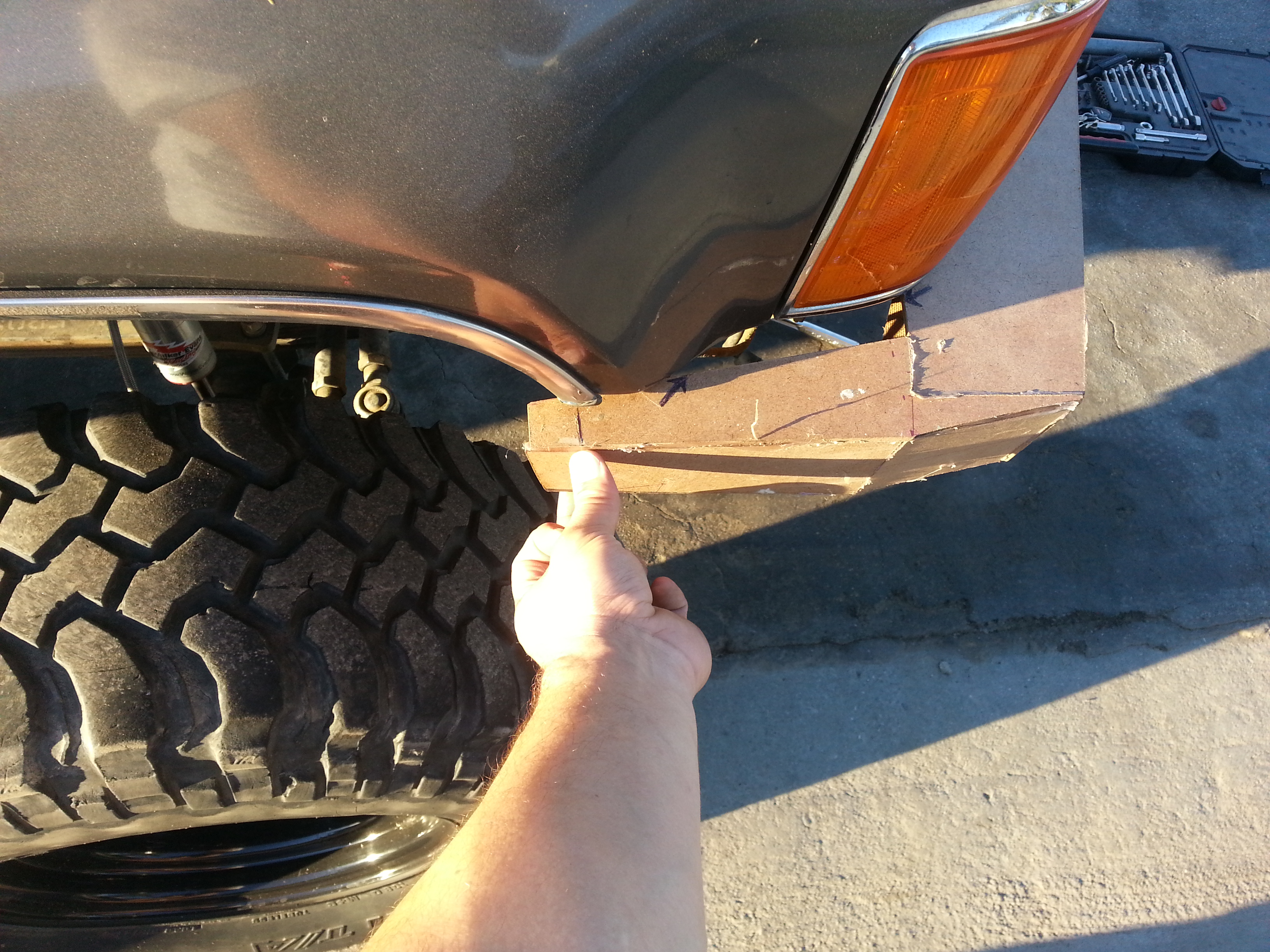

Also going to need to shorten the side piece that goes to the wheel well(where my thumb is at). Drew a line where i'm going to need to cut. this will have to be shortened about 1" on both sides.
Fitting and troubleshooting. This is the main reason i don't start off working with steel. Always gotta make sure everything fits before i buy steel and begin to cut. Steel cost a lot of money and i would hate to have to buy steel twice!
EDIT:
Oh yea also. i don't plan to use that skid plate thing on the front. It restricts me from being able to put the winch bolts through. its too close to the holes. So i might need to either bring the plate down about 0.5" just to clear that hole. or just build an entirely different plate of some sort.

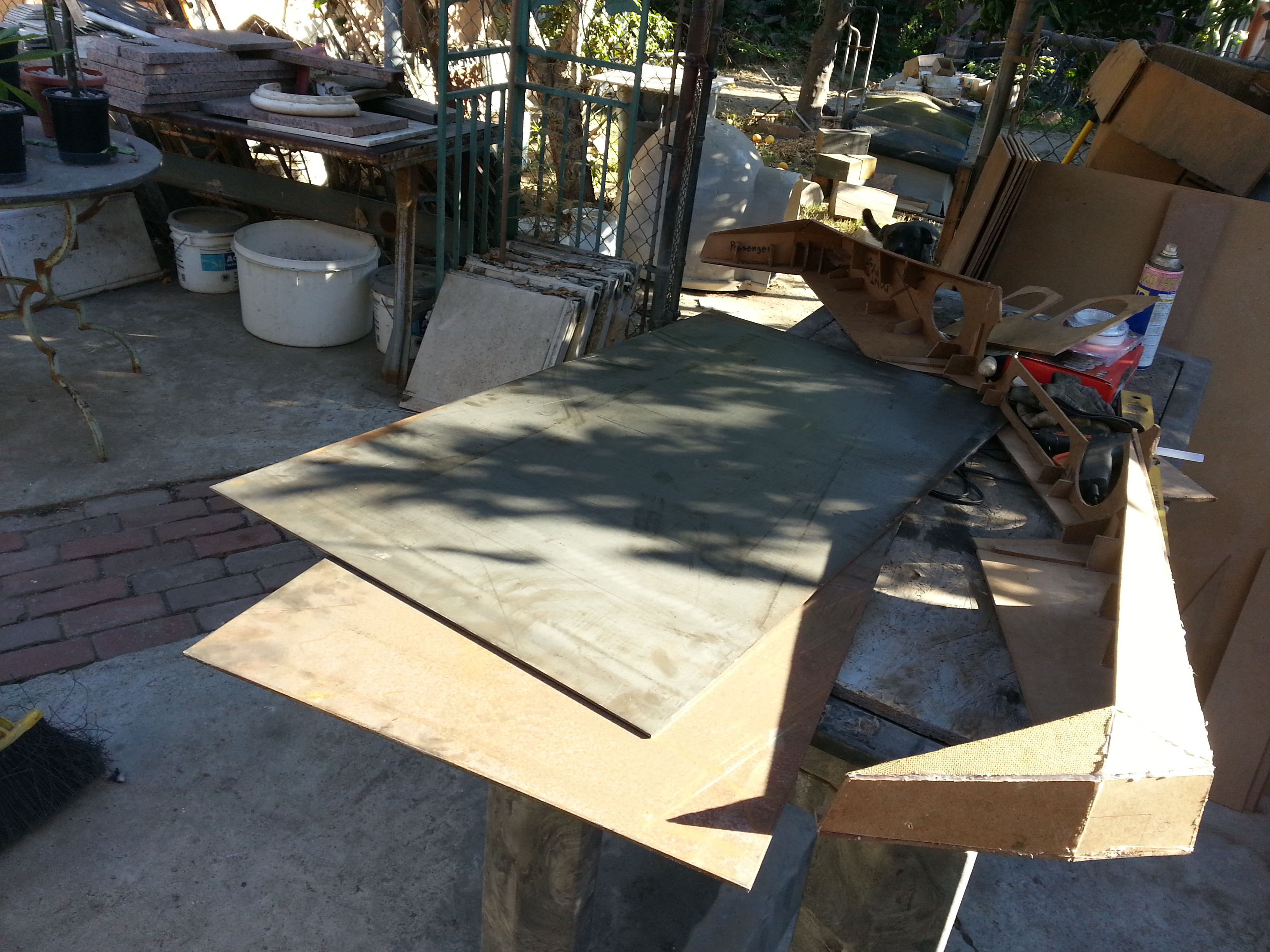

Alright so i have some good and bad news. Good news is that i finally bought the plate steel. This is 3/16" thick. I believe these 2 sheets should be sufficient enough to make the bumper. Plus i still have 1 sheet (about2.5'x2.5') that i had left over from the rear bumper i made a while back; that one being 1/4" thick. Not bad at all guys. This steel only came out to $61. I was expecting somewhere around $80 for this scrap metal.

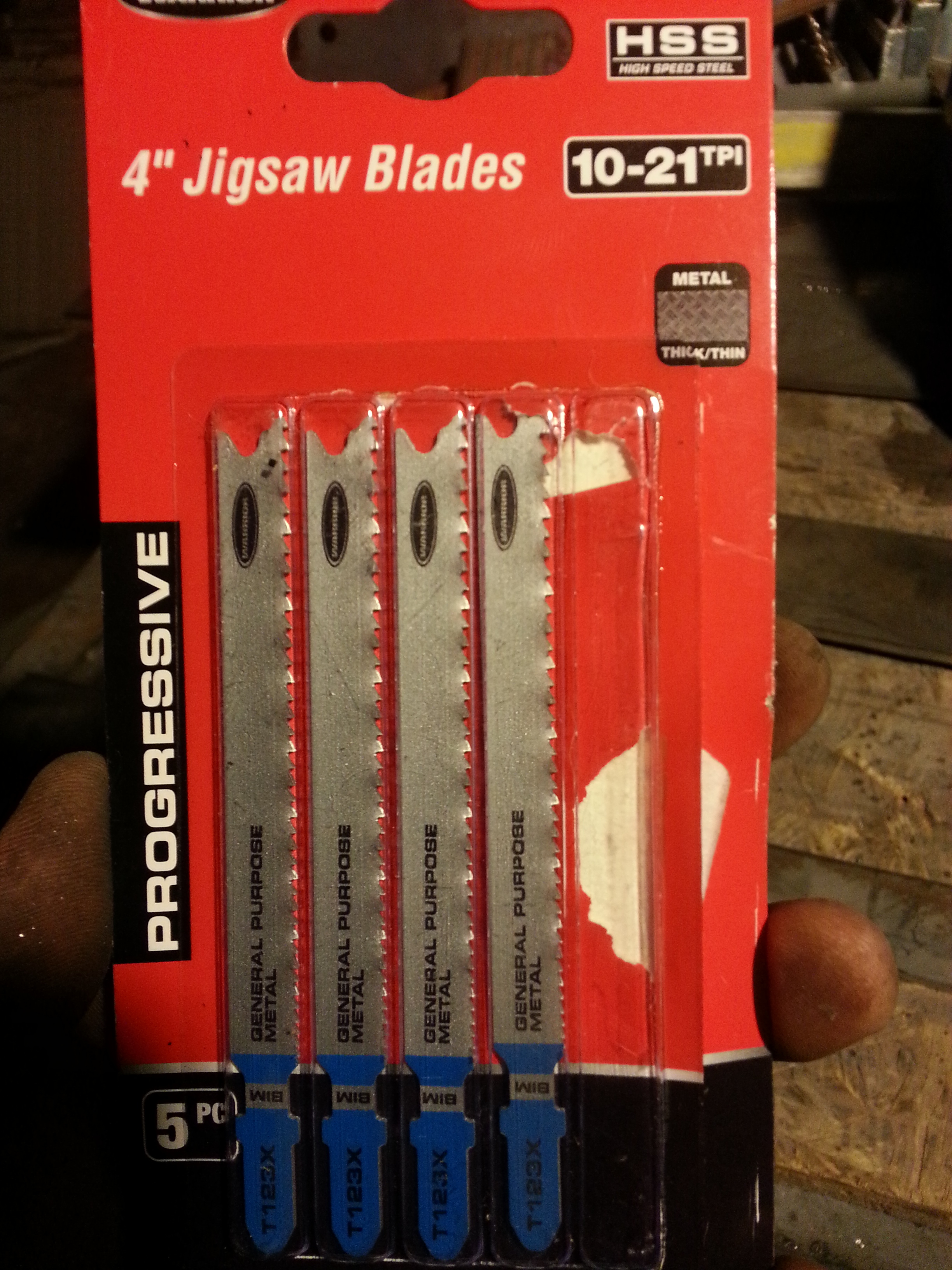

Started off by out lining the 2 center pieces of the bumper with my Masonite templates. We pulled out the acetylene torch to cut the pieces quick like last time but we kinda ran into some problems. We ran out of Acetylene before we could eve start lol So i went out to harbor freight and bought some metal tips for my jigsaw I didn't plan to use this but this is the only alternative i have right now.
These are the tips i bought

Not much accomplished. Spent too much time at Harbor freight just to buy these dang blades. I'll continue to cut some more tomorrow guys. or at least get that center piece welded together so i can fit that winch for clearance.

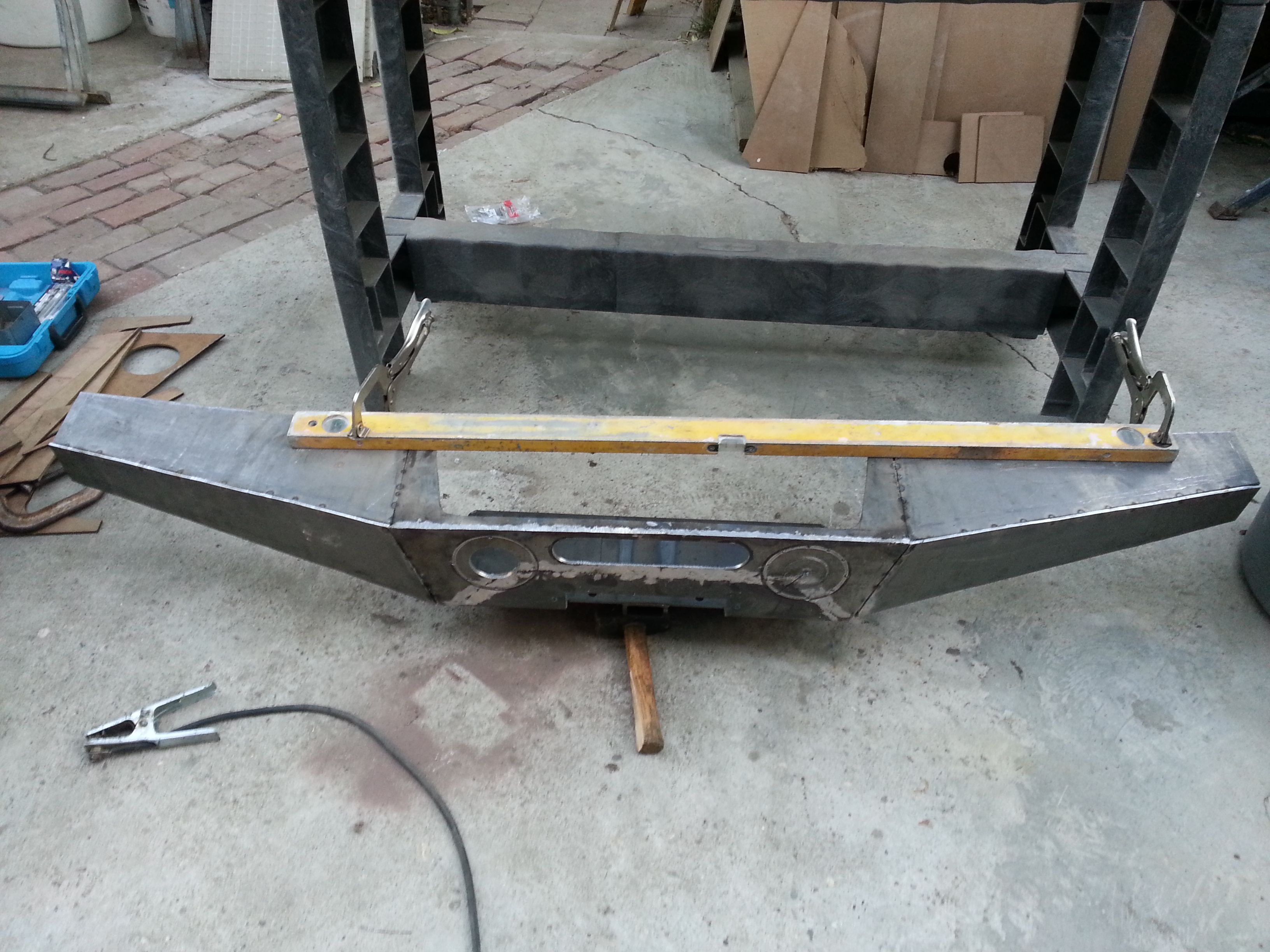

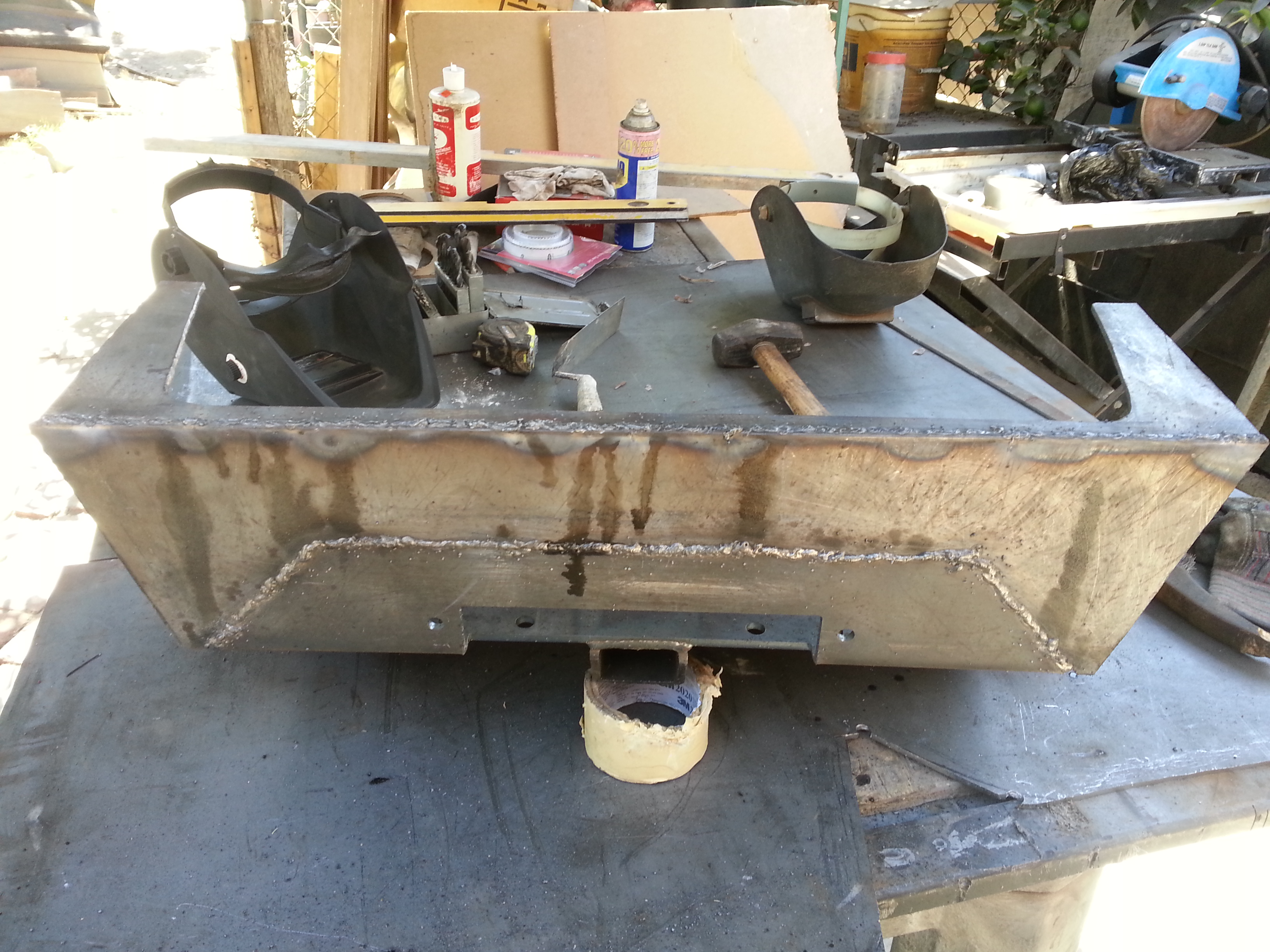

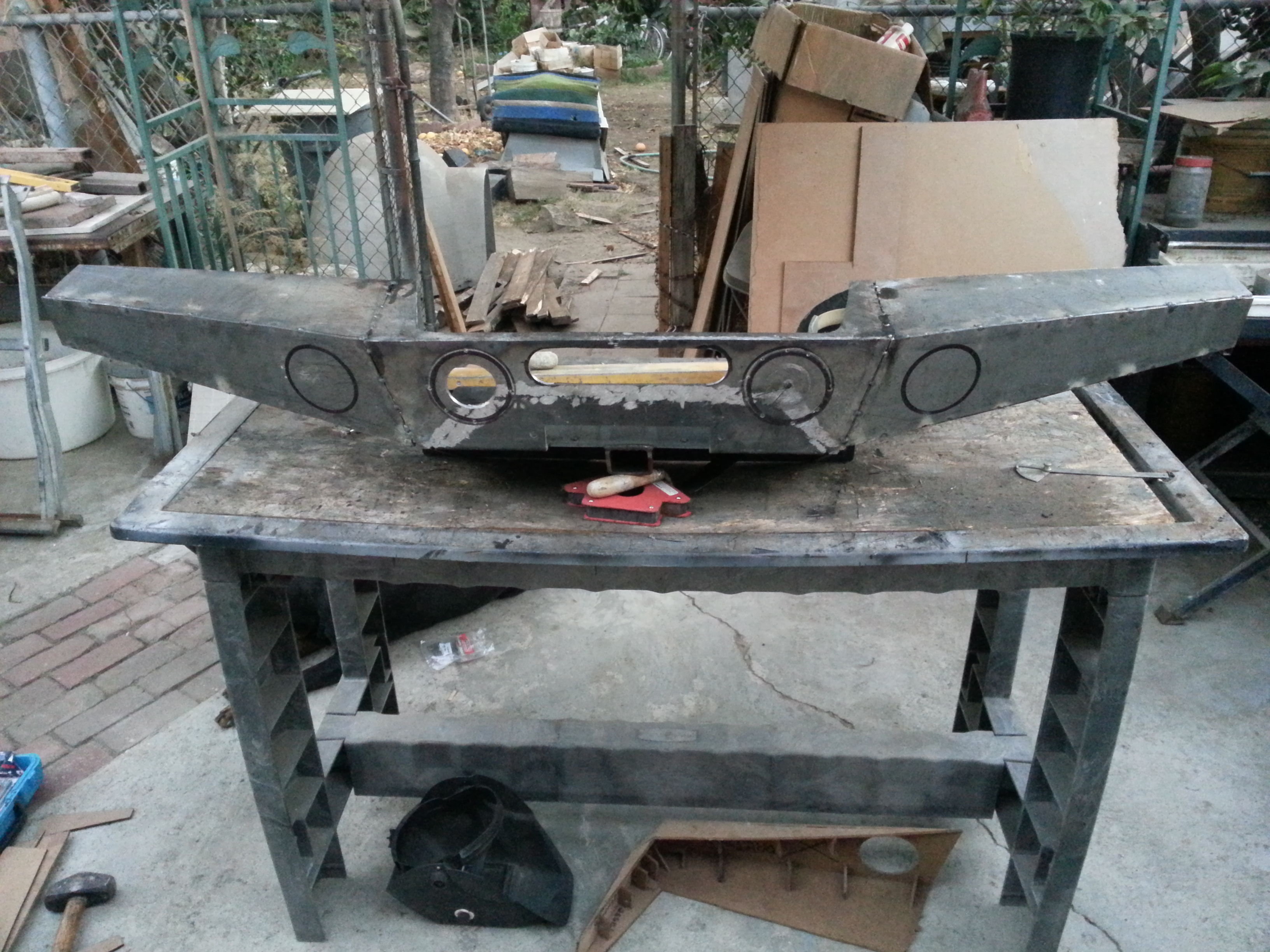

Hi guys. Well since i dont have many people checking up on my Bumper Fab thread i'm just gonna go ahead and copy and paste the progress on here too so you guys can also keep up with the project.

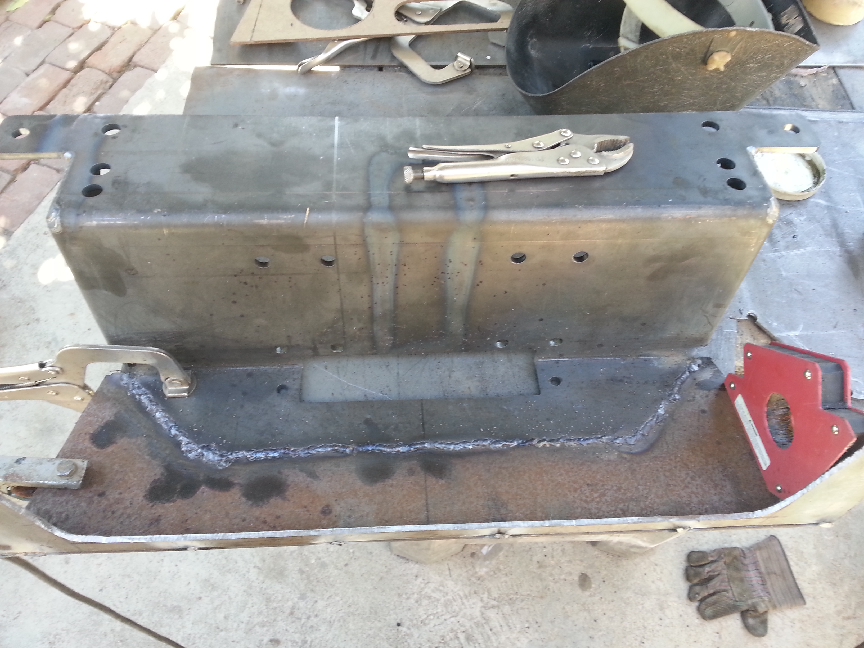

I got tons accomplished today. Started the day off at about 1:00pm.

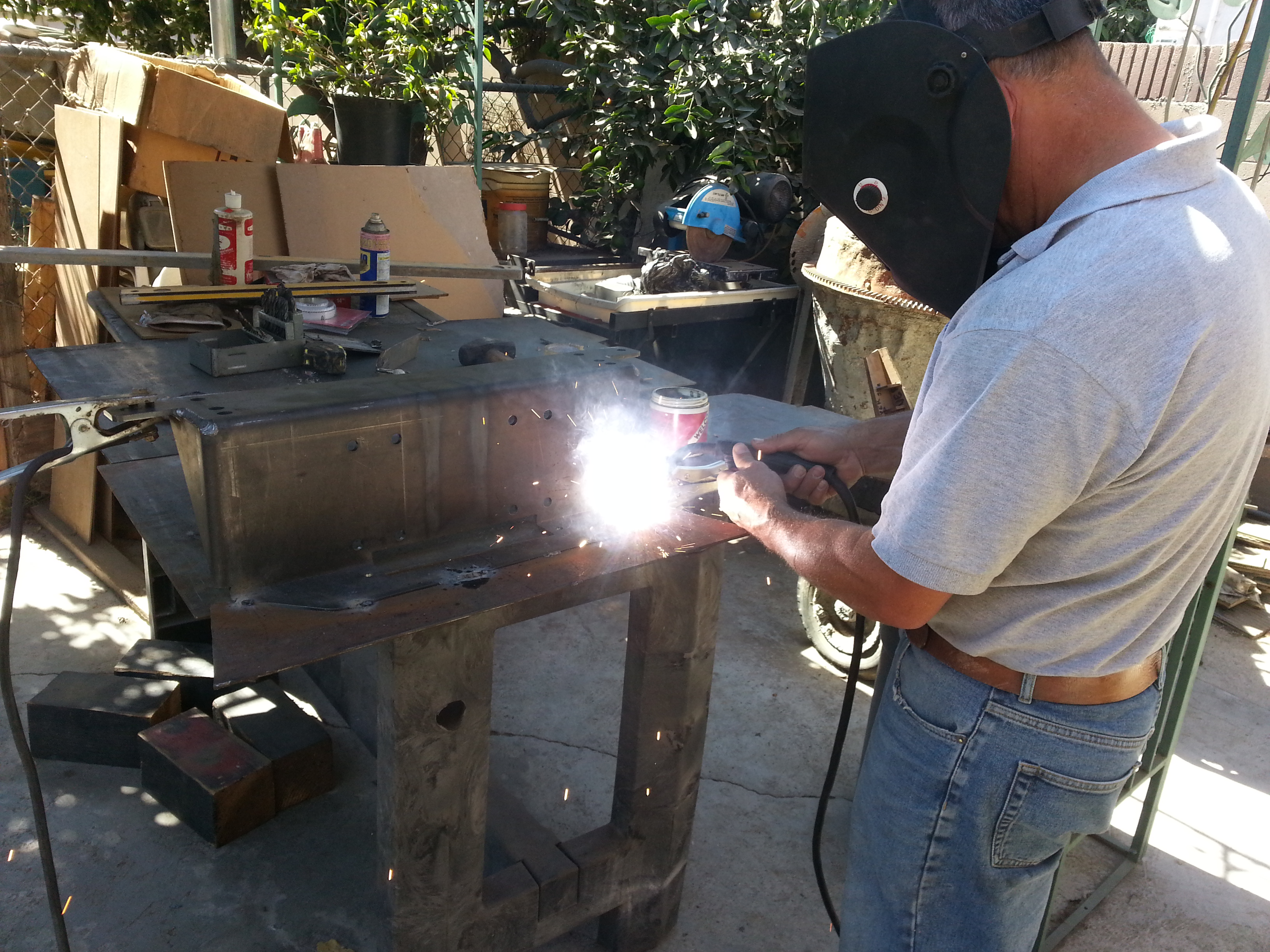

I tack welded the 2 center pieces of the bumper where the winch plate is. After i tack welded i had my dad check up on my work and he didnt have very much to complain about. He just said my welds are getting better.
Dad touching up my tack welds:
Squaring stuff out to make sure it isn't all thrown off when i add the rest of the pieces.
Completed my welds for the center pieces. I know i know I'm not the greatest welder. I'm still learning getting the technique down. but i have full confidence that my welds will hold, they just look messy thats all lol

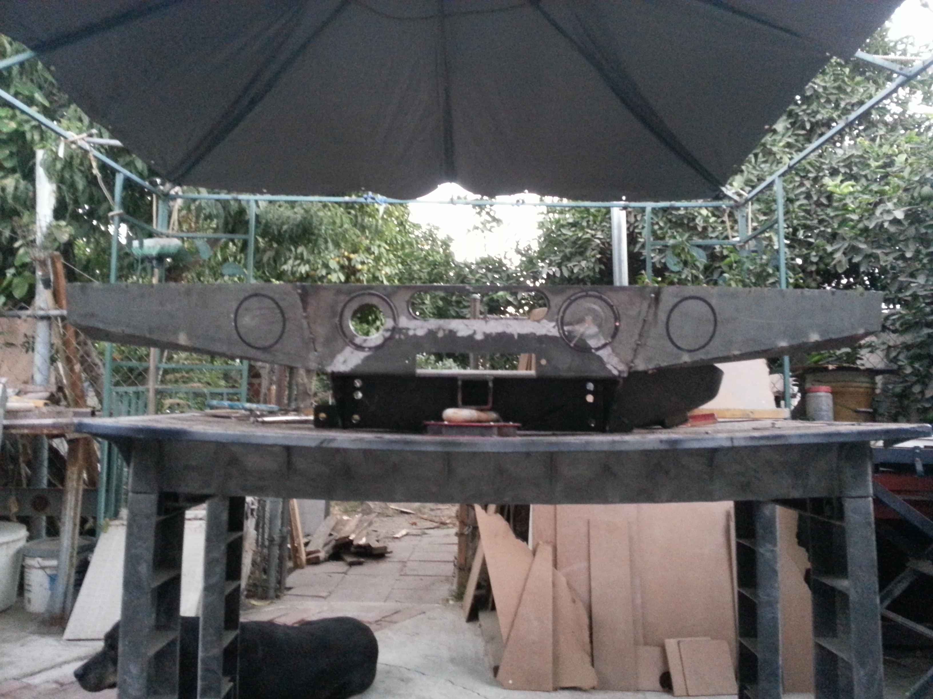

I cut up the rest of the pieces to the bumper with the jigsaw.
NOTE:
- Cutting with the acetylene torch like i did for the rear bumper will save your tons of time when cutting out the pieces BUT the down fall to that is that you will spend lots of time grinding the melted metal edges down.
- I found that when cutting with the jig saw, although it took much longer to make all the cuts, it was way cleaner. All the pieces i cut were ready to be welded together right after i cut. practically didnt even need to grind anything.
***That was just a thought. Just in case you didnt know which route to go.***

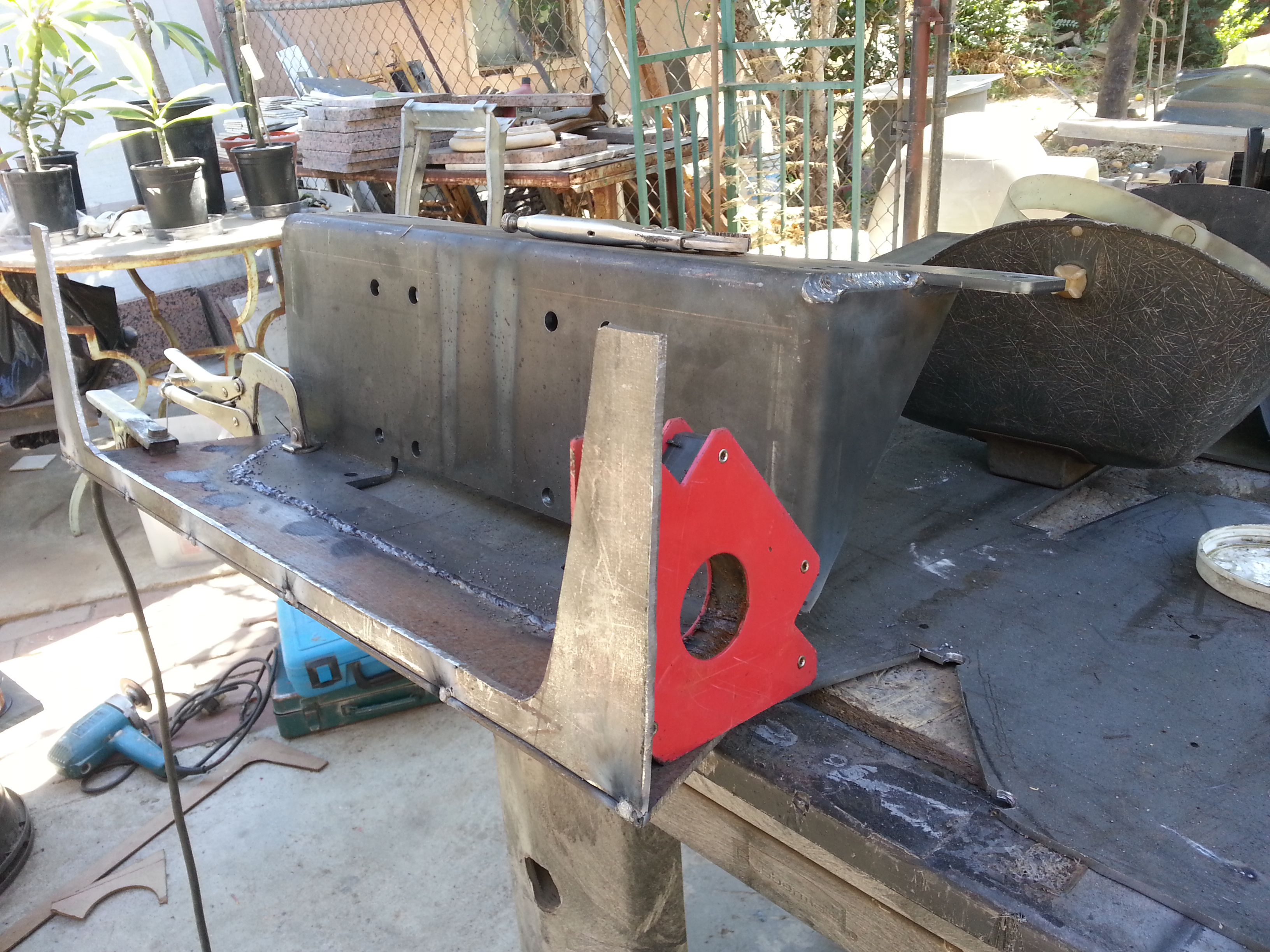

Adding the top side of the bumper:

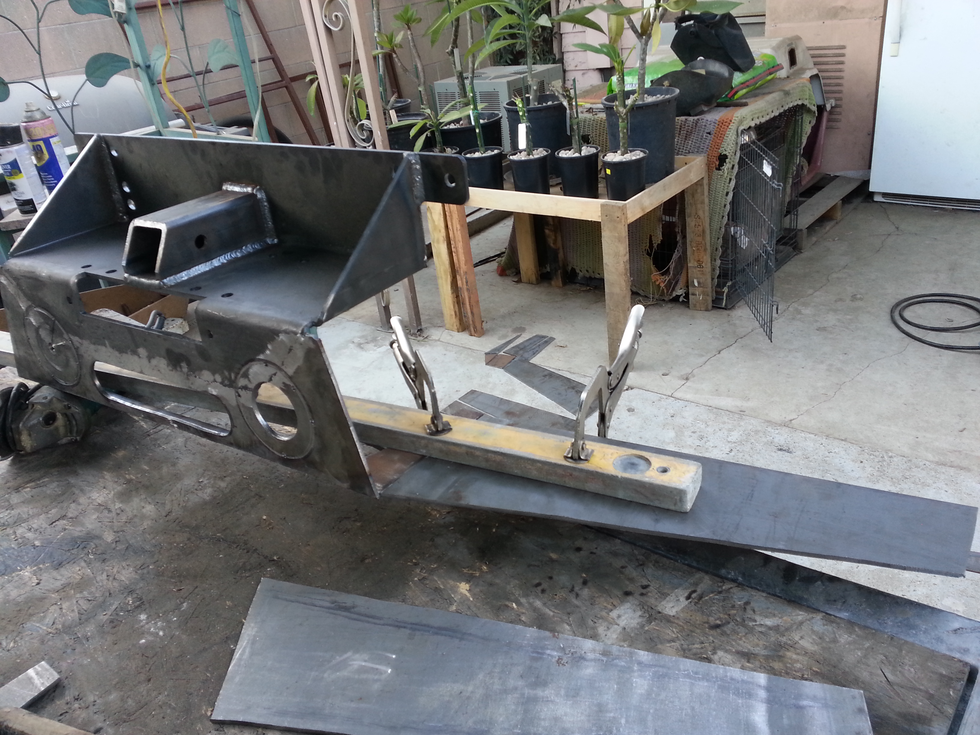

I ran into some problems with the hole saw today. The smaller size worked fine. as you can see the oval shape in the center came out fine. But when i tried to get the 4&1/4" holes cut they just barely scratched the surface. This hole saw sucks! So i figured i would just cut a smaller hole in the center. then try to cut the circle with the jig saw. but the 1/4" metal on the winch plate is too thick and i wasted 2 jigsaw blades by trying to cut through it. So you will see in the following pictures that the holes didnt get finished. I am going to go fill my dad's Oxygen and Acetylene tanks at a local welding supplies store during the week. Then i'll be able to get those circle holes cut out just fine with no problem at all.
Tack welding it all together

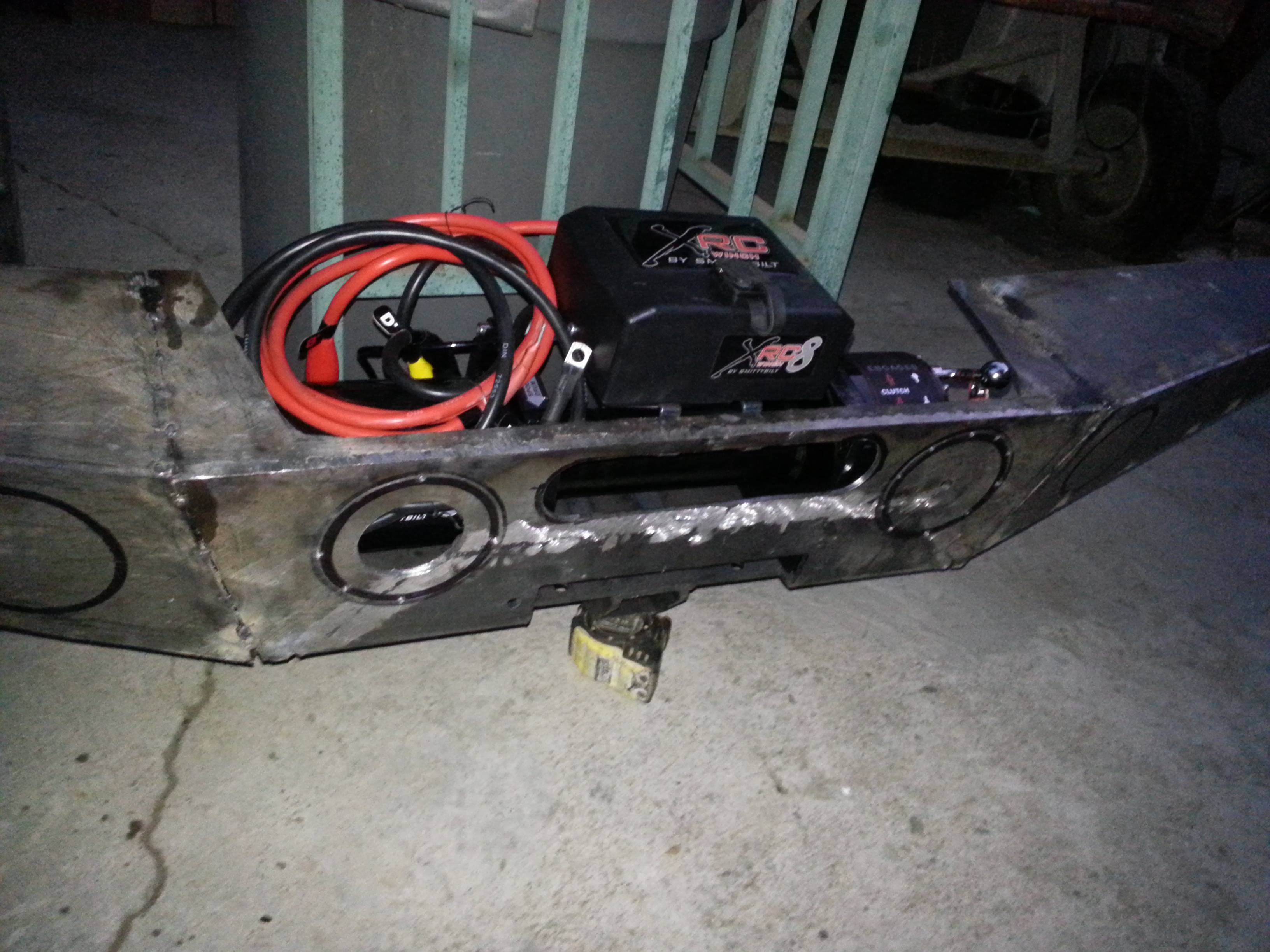

Smittybilt XRC8 Winch fits perfectly!
As of right now i just left the bumper tack welded together because i still need to fit the bumper to the truck and i might have to make some alterations to the sides. So I'll just leave it as is to make sure it fits just right before i make the final welds. I still need to add some reinforcement behind the face of the bumper. So dont think it's gonna stay like this lol
Will continue to do some more tomorrow morning.

Bumpers looking awesome man. I've said it before, it's great that you are able to have your dad help you out like that. I wish my dad lived closer to me.
Still can't believe how cheap you picked up that steel for!! You are really motivating me to build. Bumpers Between your back bumper build and this front one. Can't wait to see this all done and on your runner.

Thats awesome how you made a template out of cardboard. Never thought of that before. The welds so far look great, and im assuming the winch is 8000lb??? Doesnt seem like enough but i dunno, most i see with bigger tires and lift like you have go with 10k or 12k winches. Cannot beleive you went to the dentist in mexico. We have alot of hispanics in our town cause we have MBA chicken plant and they use to tell me how nice it is there and how there saving money here to build nice homes there and now they are scared to go back cause of all the cartel business and possibly being murdered or captured if they do not pay them off.
BUT.....anyways hang in there richard, always like seeing your rig progress.

Thanks. I'll see if i can get the corner pieces added on to the bumper today. i'll take some pix if i do.

I did pick up all that steel for pretty cheap. and i might not even need to use all of it lol. I was looking at how much i was gonna have left over. I might be left with about 1/2 a sheet.
Yea it was Masonite board. Usually used for construction sites on the floor. but yea its like a really thick cardboard. My winch is a 8000lb winch. It is enough to handle our little trucks. I usually see the bigger f150s or chevys using 12k winches. We dont need them that big for ours because theyre fairly light. Internet says our trucks weigh 3,720–3,760 lb. So with all the extra's im sure im still under 4500. Chefyota4x4, Toyotech559, and my neighbors pick up truck, and a few others have the same winch i bought.
