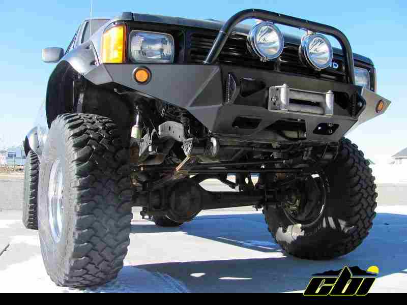

Lately I've been looking over a bunch of parts for the near future plate bumper that i plan to build. Still on the researching phase but this project is going to skyrocket once i have all the material and knowledge i need. So far what i have looked into I've found that this bumper is definitely going to be more costly to make and definitely more complicated due to the fact that i want to run a winch and incorporate 4" off-road lights/fog lights into the actual bumper followed by 2 off-road lights on the top center part under the grill guard.
One thing is certain. I can not even begin my project until i have the following:
- Front Bumper Frame Support [because "The factory frame is only .090 wall material. This plate requires welding, but strengthens the mounting surface by 150%"]
- Winch Plate [to build my bumper off of and mount the winch to]
- 4" LED off-road lights [so i know where i'm going to mount them onto my bumper]
- Winch [so i can build the whole bumper around it while still not totally blocking it in in case it ever needs to be removed.
- Center Grill Guard probably wont cost me more then $35(havent looked into it yet)
Pretty much need everything before i even get started.

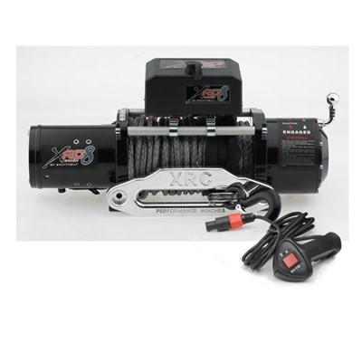

***Winches, i am already set on the Smittybilt Xrc8 8000lb winch with synthetic rope. for $449
The reason i chose this is because Smittybilt has great products. they are durable, proven to last, and they are a bit cheaper then WARN. I am choosing Synthetic rope over steel because i don't want the line to start rusting over time. Not to mention it is so much lighter then steel braided line. It cost about $140 more but just that weight difference is enough for me because I already have a ton of weight on my truck. With my whole rear bumper/tire carrier combo and a loaded roof rack. And then another plate front bumper. I am gonna be so heavy. It would definitely be nice to cut back on unnecessary weight

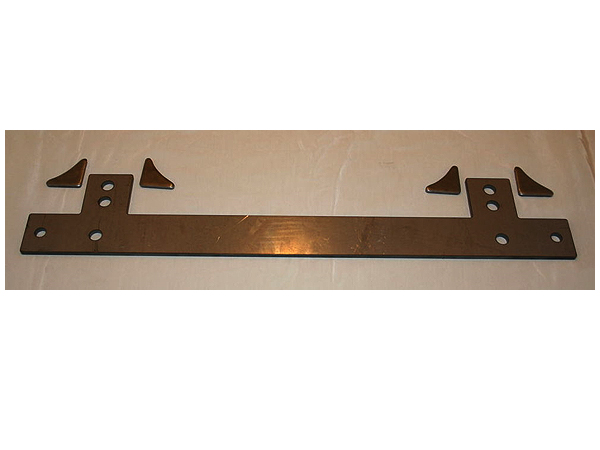

***Frame Support is a must have. Dont want my bumper flying off as i try to winch myself out of something. It's like i mentioned "The factory frame is only .090 wall material. This plate requires welding, but strengthens the mounting surface by 150%." Here are the couple of choices i have.
- 4xInnovations for $30 http://4xinnovations.com/p-1106.html
Or
- Scotty's AddictedOffRoad for $45
http://www.addictedoffroad.com/index...products_id=73

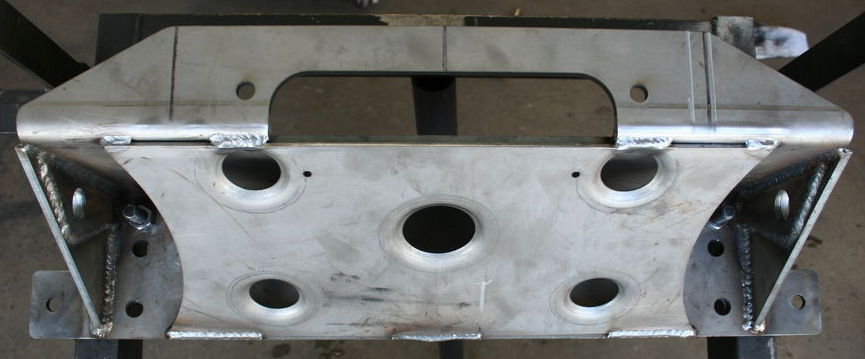

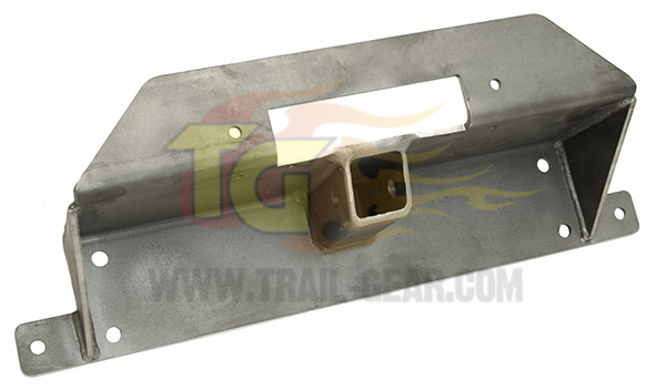

***Winch Plate. I have a choice between Trail-Gear's and the Addicted Off-Road one.
I really dislike the front look of this winch plate. I dont plan to run a hitch in the front. i dont plan to tow my truck anywhere so it is pointless. It's just ugly
Here it is for $145.95 http://www.trail-gear.com/front-bumper-winch-mount
Now the Addicted Off-road winch plate has much better craftsmanship. I love the way it looks. It looks clean and has style. Has holes for D-rings AND it cost $139 http://www.addictedoffroad.com/index...roducts_id=456
(The Picture link on the website is broken So here are more pix on Ttora.com)
http://www.ttora.com/forum/showthread.php?t=146998
In the end i might just end up going for the Addicted Off-road one.

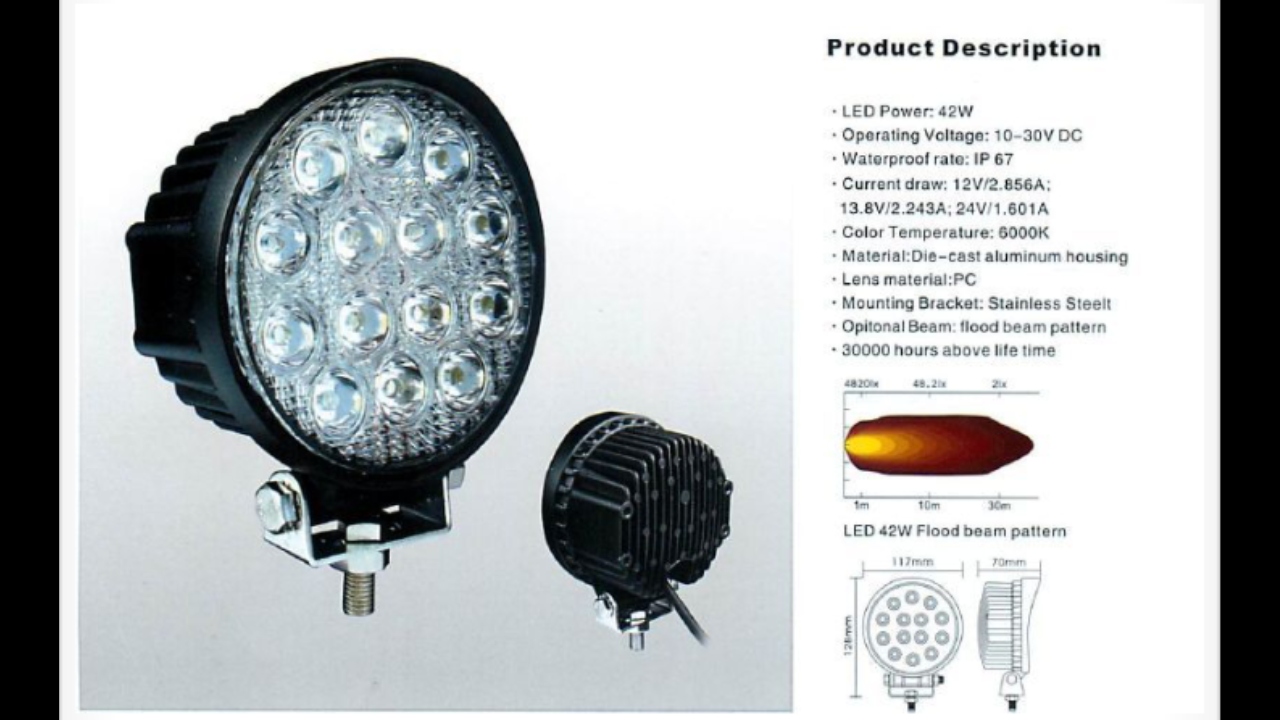

Now as for my LED lights that i want to incorporate into the bumper i was thinking of going with either of these.
***42w, 2090 lumens, waterproof, and 14 LED's and they are 4.5" So i would still be able to incorporate them into my bumper. They run for $59.95 each. I'll be needing 2 of them so roughly $120 for the pair. And they are located in Anaheim Ca which is super close to me so it would definitely arrive within the week.
http://www.ebay.com/itm/290961829325...84.m1423.l2649
Here was another choice but this is a pack of 4 and each is only 27w. These are also 4"
http://www.ebay.com/itm/4pcs-27W-Off-Road-LED-Floodlight-Jeep-Truck-Snowplow-Outdoor-Racing-Spot-Flood-/290913446785?pt=LH_DefaultDomain_0&var=&hash=item43bbcaeb81
I'm thinking of buying the ones in the first link. Mainly because i like the fact that they are that 0.5" bigger. but also because they are almost twice as bright. It seems like a much better deal.

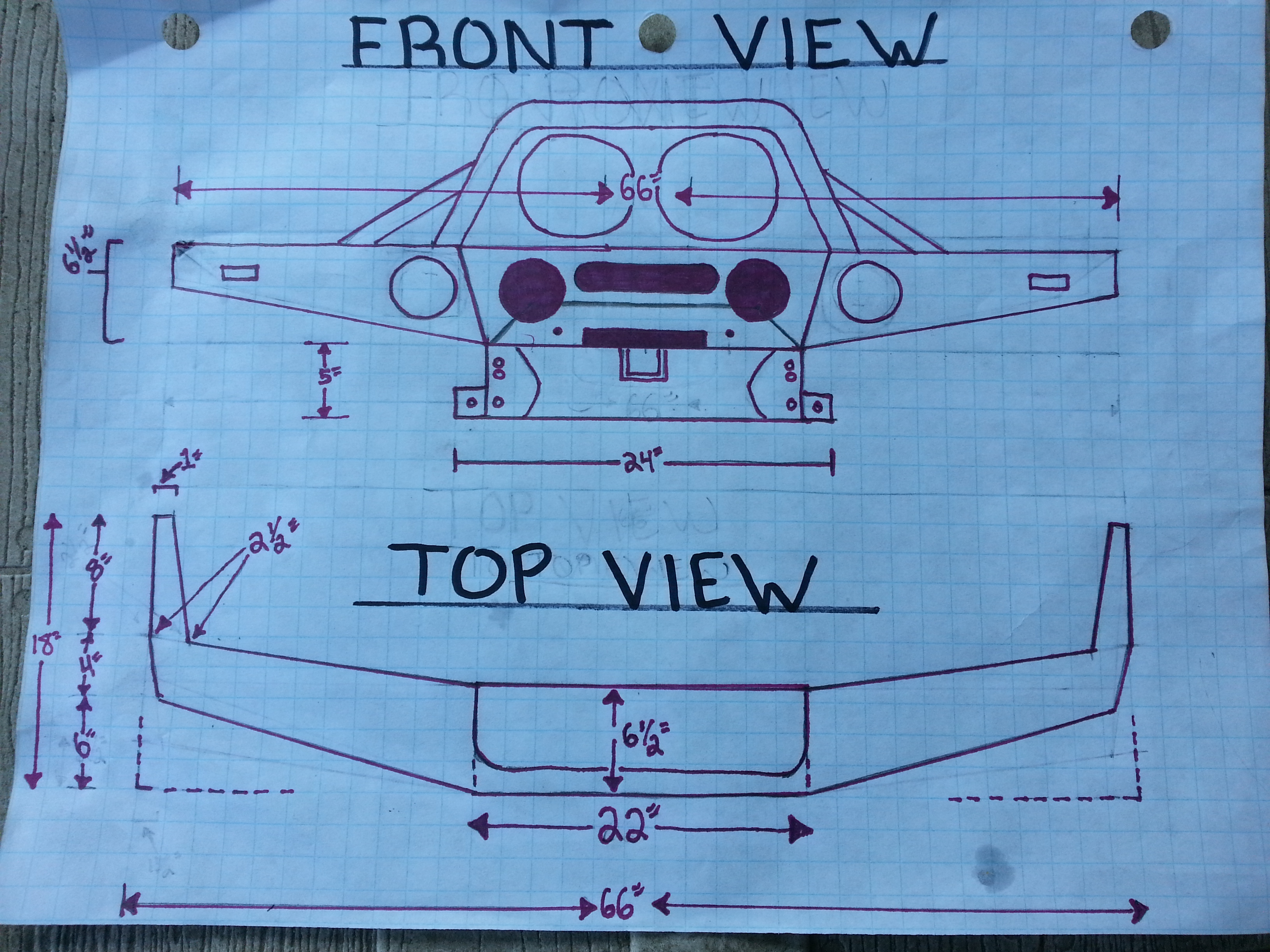

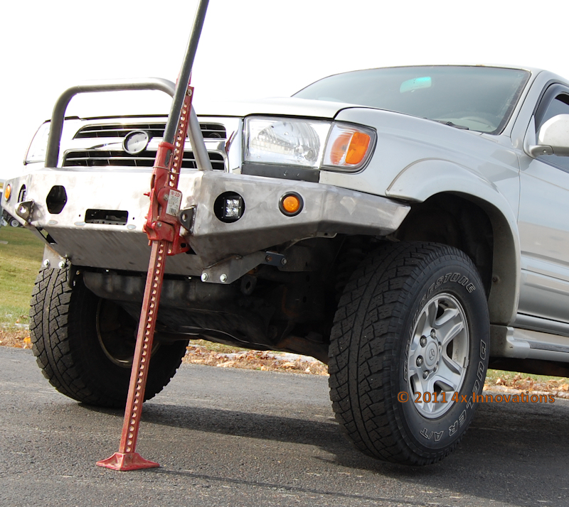

BTW this is what i mean by i want to incorporate the lights into the bumper. I want to go for something like this:
http://4xinnovations.com/p-FB1140.html
but with a bumper style more like the CBI offroad bumper:http://www.cbioffroadfab.com/product...y-front-bumperName:  729CBI4.jpg

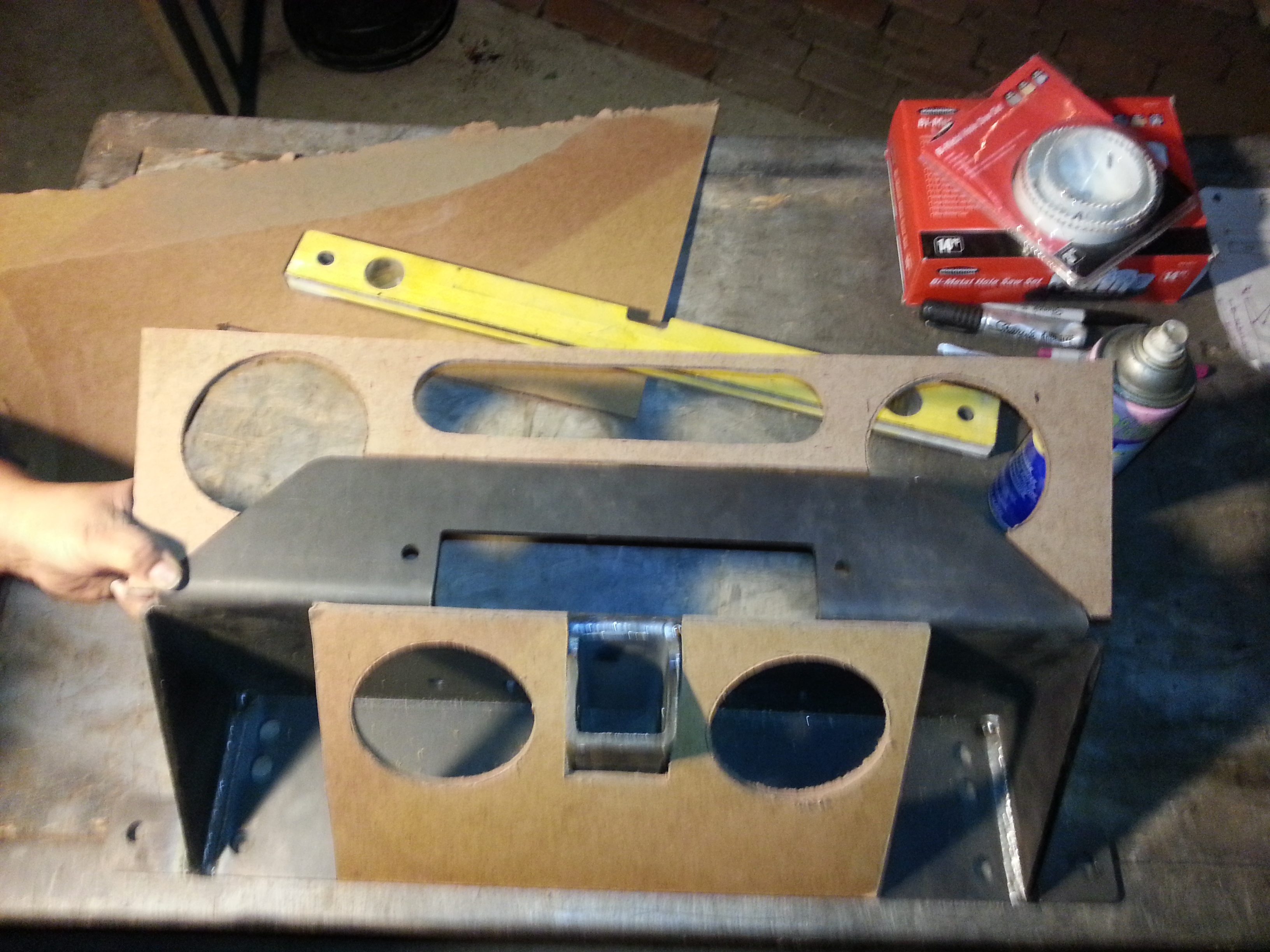

I also plan to have those center lights in the center of the grillguard. What i had in mind was to buy the ones i link off eBay and choose the flood light option and put those in the actual bumper. Then go out and buy Mark's 8" Dick Ceptic Spot lights and place those in the center.
I'm telling ya i have tons planned for this bumper. It's gonna be hella expensive to make. but its still gonna be cheaper to build myself then to buy a CBI DIY bumper or have one custom made for me. Either way in the end i will be getting a bumper exactly how i want it to come out. No buts, ifs or anything.

I'm going to start drawing up a few designs on some graph paper soon; like i did for the rear bumper. But once i get the winch plate and lights i am definitely gonna have a better idea of how to make this work. I hope getting these parts in doesnt take too long though. im really anxious

I also like the 4xinnovations plate bumper.Nice score on your new parts!
The plate bumper by 4xI is pretty sweet. but they dont make one for 1st gens. most fabricators dont. The only one ive found is the CBI one. But it doesnt have everything i want to include in that bumper such as the lights. Plus it cost a lot so i would rather make my own.

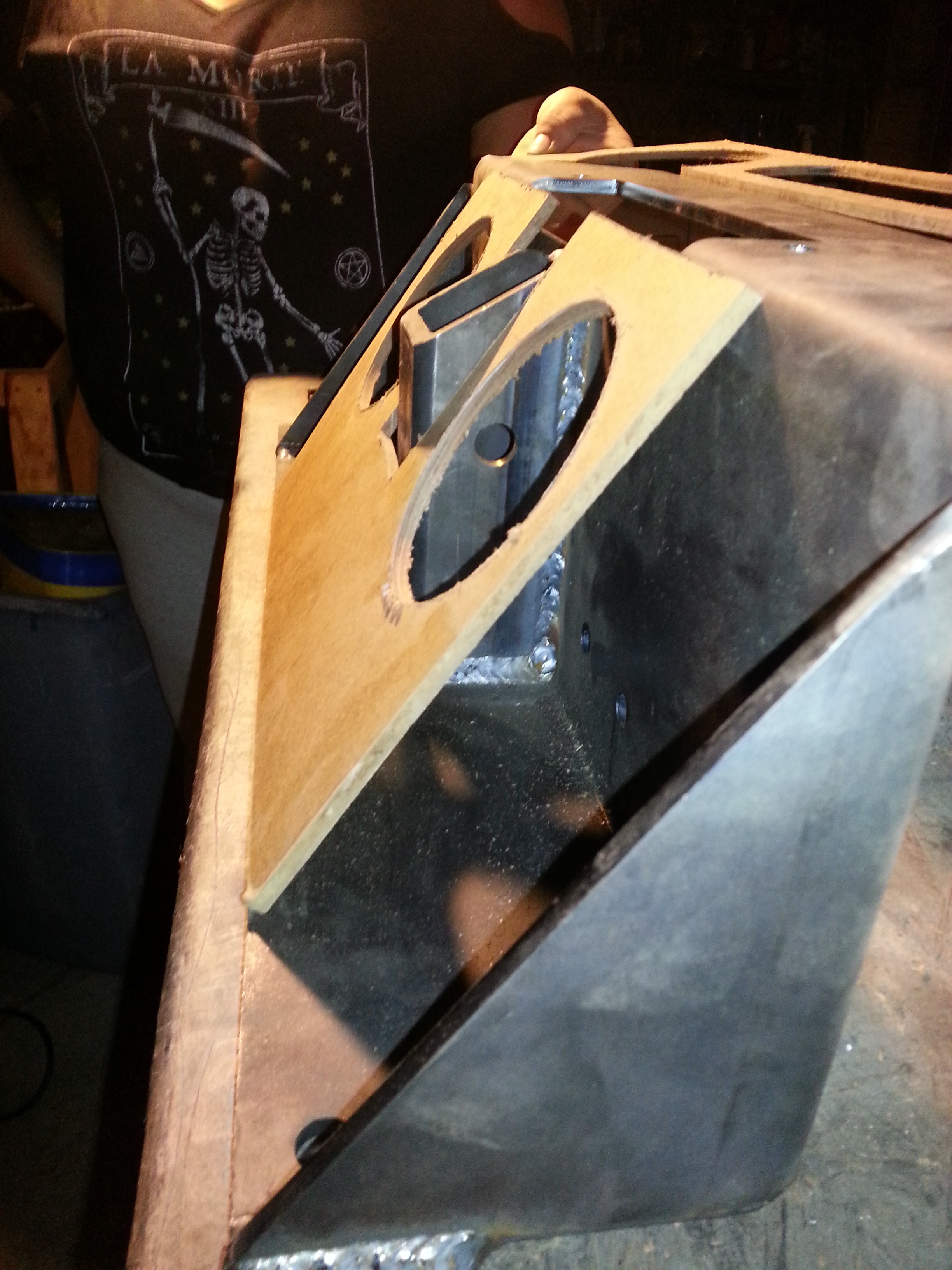

Wasnt planning on it but i guess i can add a couple.
This is my design. Mostly copied from the Relentless offroad bumpers with a bit of other bumpers
Began cutting my Masonite board last night. i finished the air holes and made a possible skid plate.
