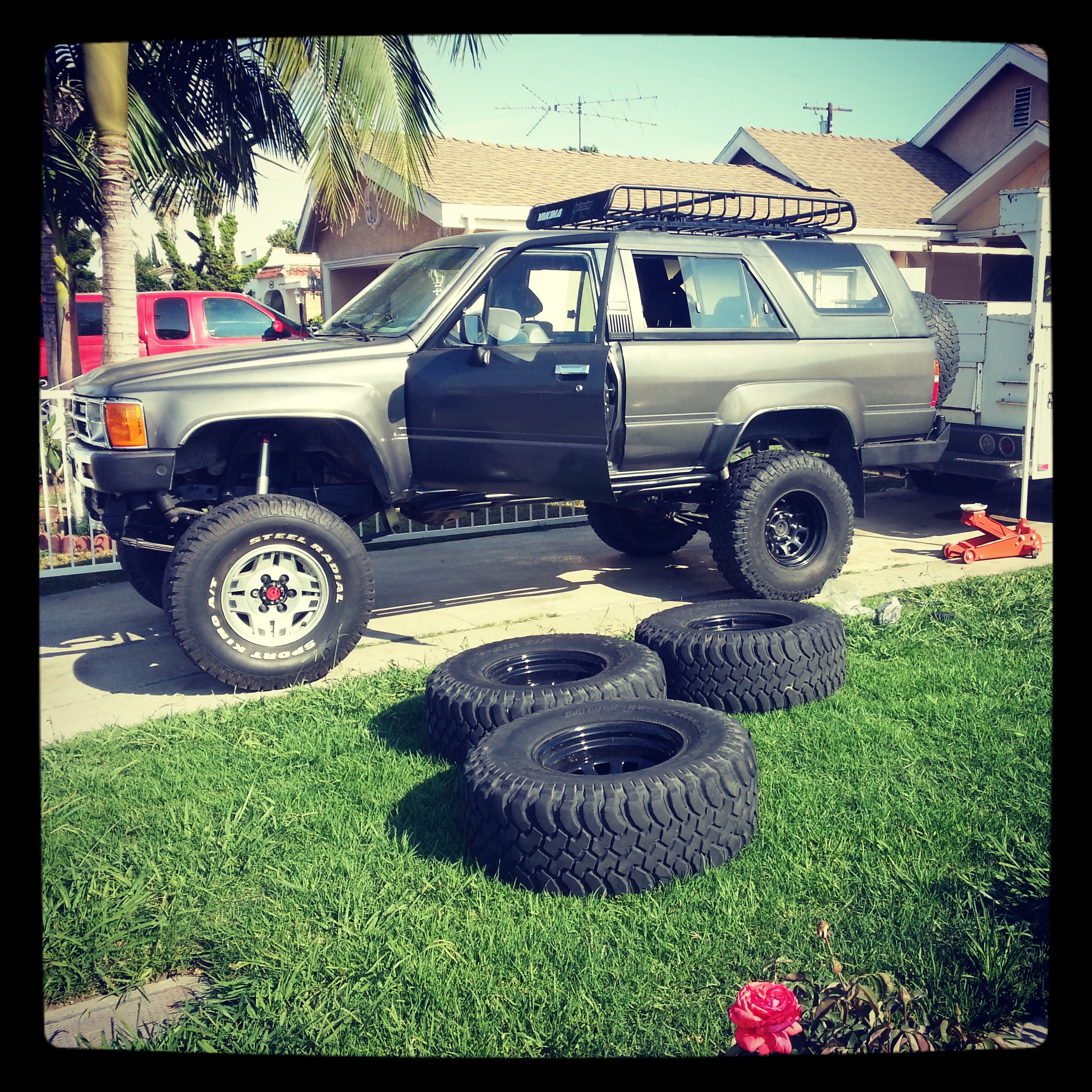

So this past week my Neighbor and I Decided to take last minute labor day weekend trip. Called Mark up earlier in the week and he's coming too. Originally we had planned to hit up a couple of Angels Crest National Forest trails satirday. Then on the day of labor day go to Big Bear. Due to there being a few trails closed at Angels Crest, and the ridiculous heat out here in Los Angeles we decided to just only do the run to BigBear tomorrow.
There was rain and thunder storms going on out there today with flash flood warnings. Supposed to cool down to approx 78* out there. But I can only imagine how much hotter that humidity will make it feel.
Either way I'm still anxious to go. All 3 of us are locked front and rear. Ruben and Mark's trucks are both running Dual cases and winches. So they are definitely set. Alao they both running 35's and to my 33" tires. But we all have armor. Ant I really really hope we have what it tales to handle the trails in case it gets nasty out there. Never wheeled in the rain. I'd imagine it sucking so hopefully it doesn't. But if it does I hope we get some awesome pix. Charging up the camera battery so I can snap a bunch of shots. For you guys.
So I threw on the good ol' off-road BFG m/t tire/steel wheel combo. And went grocery shopping and bought some spare motor belts in case something ever happened. Plus I should have one in my truck at all times anyway.
Definitely not gonna be able to sleep cuz I keep thinking about it.
