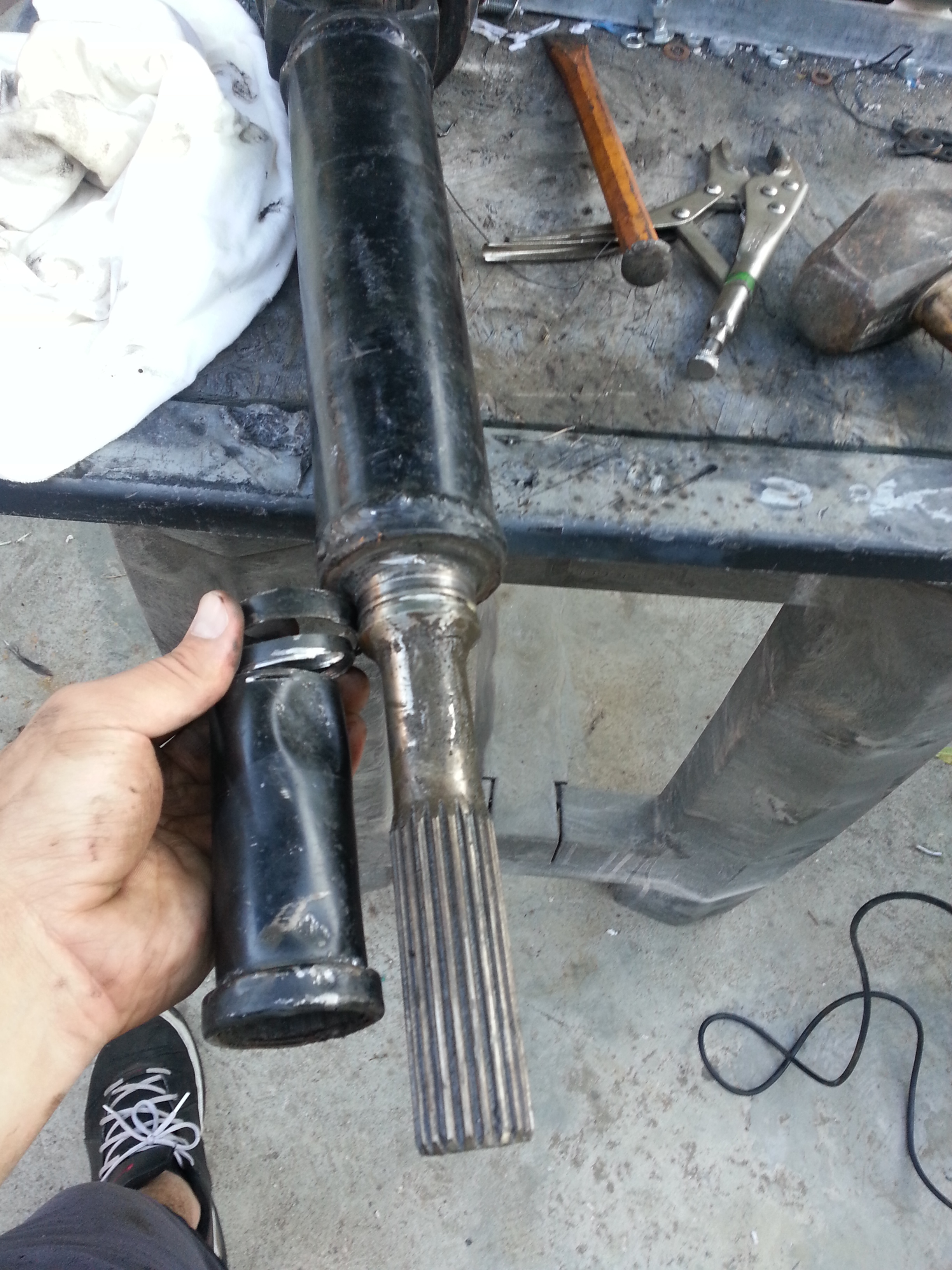

Today i picked up my driveshaft from the shop. I really dont like this new driveshaft guy. He is really lazy. Each time ive met with him for these past 3 days he has that attitude. That "i dont wanna work/be here" attitude. Anyway. He bent up my spline cover A LOT more then how it originally was. Completely left it unusable. He told me if you have the tools you can go ahead and take it off yourself to save yourself a couple bucks. I'll only charge you for changing out the flange. He charged me $10. I seen how he did it and i watched a few videos and i now know how to work on drive shafts. it doesnt seem hard at all.
Anyway i went ahead and took my unfinished driveshaft back. Left kind of mad. but glad i didnt leave the work to him. Here in the picture below you can see how he left it. i used the metal cutter to cut a thin layer off the very end of this thing.

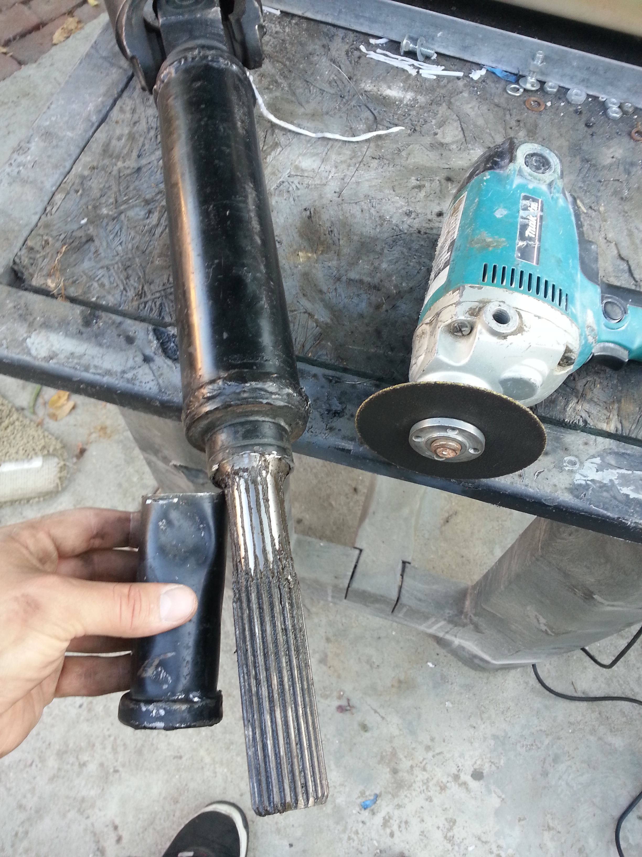

Apparently there was more to get cut.

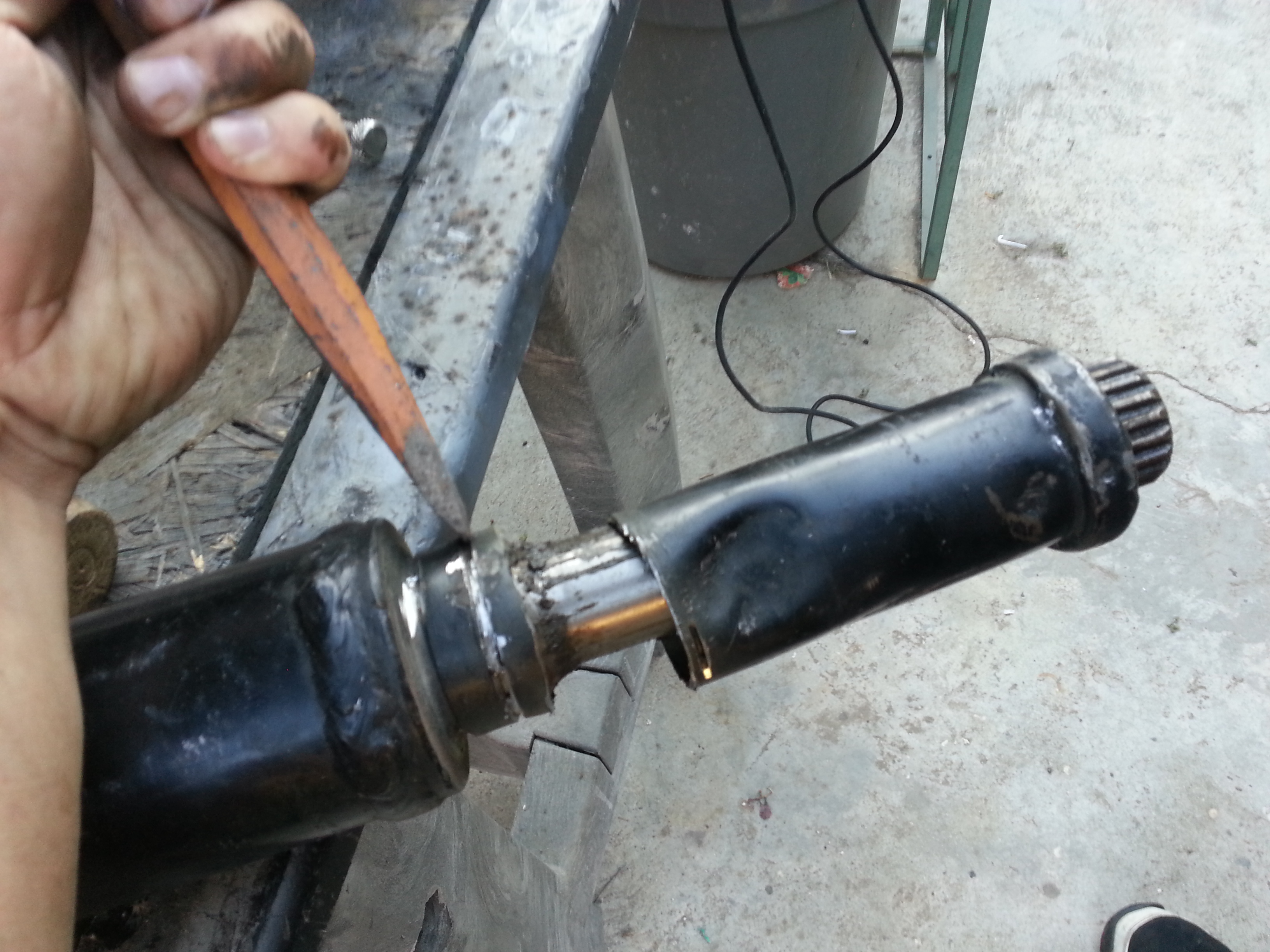

I then found that these driveshaft sleeves are supposed to be able to be removed with barely any trouble. but mine was ridiculously seized on here that it might as well had been welded. After finding this out i decided to take a chizzle to the area i grinded down. But i still needed more to push down on that sleeve.

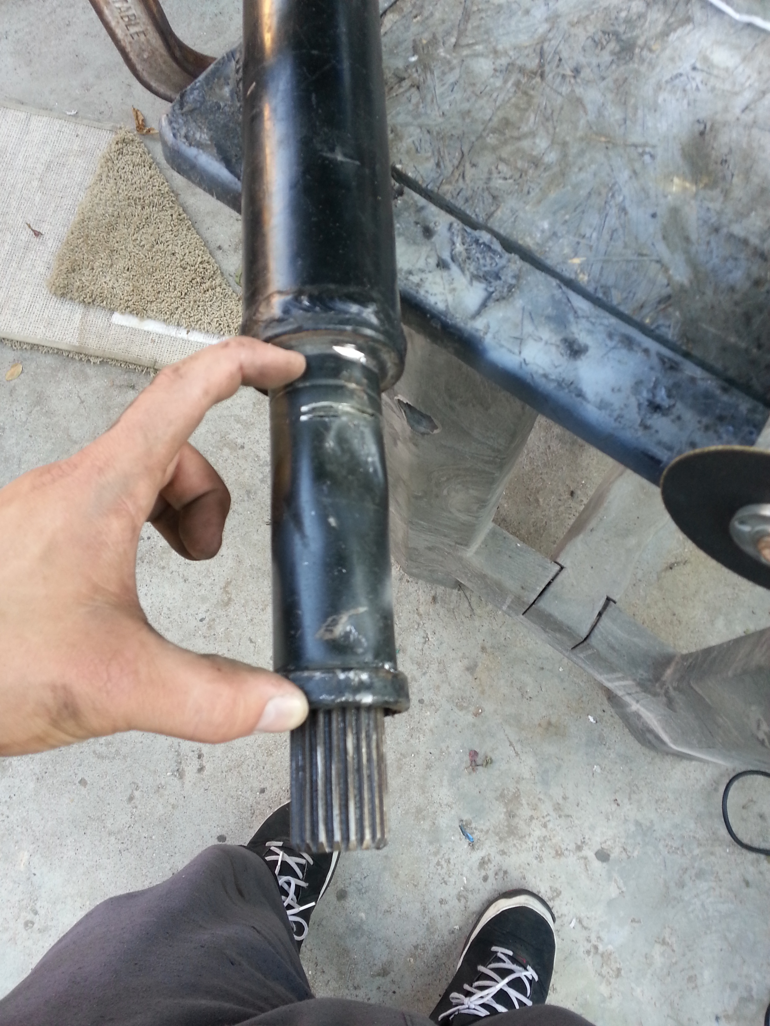

So eventually i got the pieces of that sleeve off and this is how it is supposed to look when off.

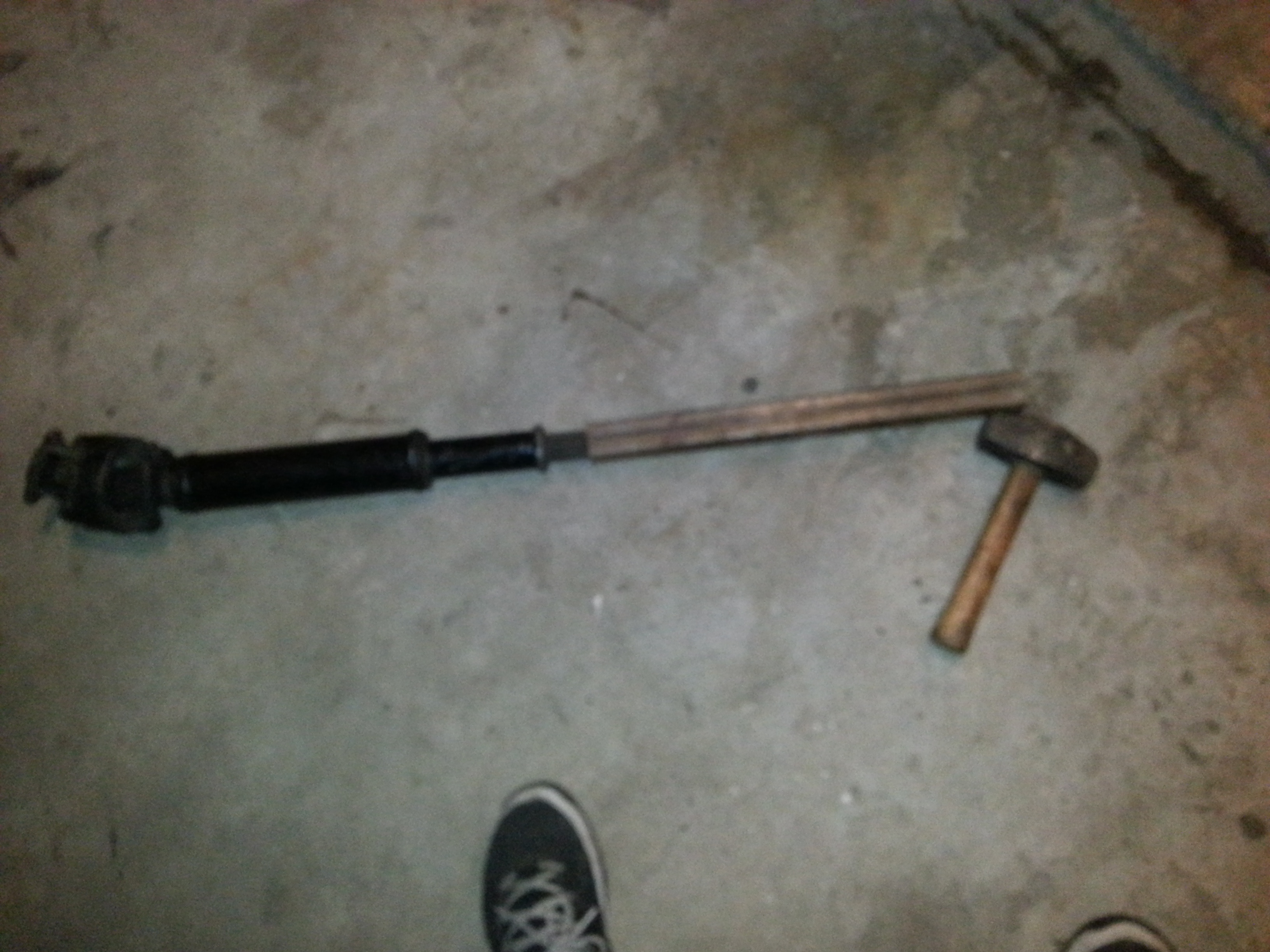

I took off the sleeve to my spare the same exact way but this time from the very top. Then about 60 smacks later its off!
