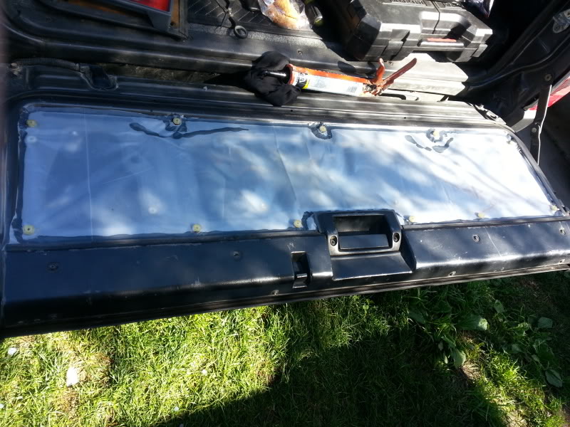

Originally Posted by Co_94_PU
Well done sir! Hope you greased it all back up well, bit of a squeek there.
I just wanted to remind you the plastic liner tucks into the slots at the bottom to direct the water to the drain holes, and you tape that bit at the bottom. It just poped into my head when I saw them at the end of the video. I need to redo the seals on my doors still. Knew there was a reason I didn't put the clips back on the window handles yet!
Thanks for reminding me on the drain holes i did end up covering those holes while i was at it. Here is how it turned out: Name:  20130217_102828_zps8fd074bf.jpg

Which adhesive did you wind up using there, the chaulk gun, what type or brand ect? I saw the stringy stuff that comes on little strips the shops use but I'm still not sure if it's worth the price vs a 2$ silicone tube.

I had extra chaulk left from when I put the window trim around my windshield. So I just used that.
The window motor off the tailgate and on the driver passenger side are supposed to be identical motors only difference is the connector. I noticed a speed difference but only because my motor was old and had already started to go out.
Only reason it seems to be stronger is because driver side passenger windows are far less used and abused then a tailgate 4runner motor that needs to be opened for everything. Ur pretty much getting a very little used and good quality used motor if u go this route. Definitely worth every penny.

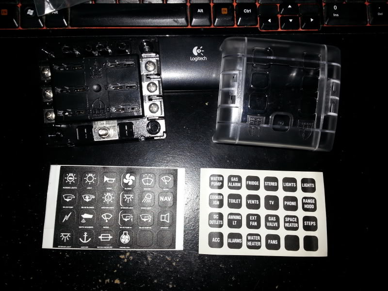

Hi guys, I bought somethings very much needed today.

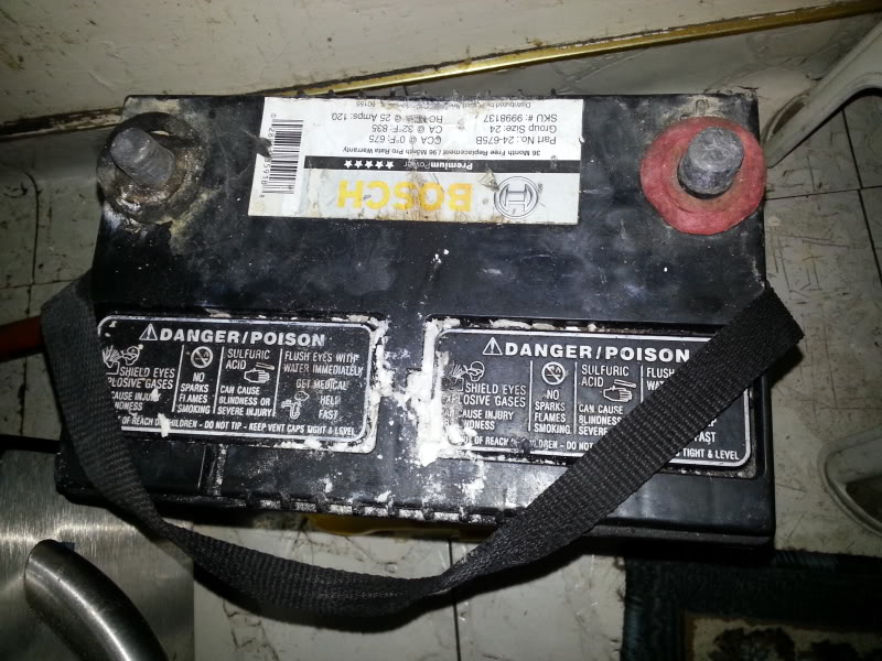

I really wish i would have taken a before picture before i semi cleaned up the battery so you could see the shape it was in. oh well, i forgot.
Out with the old:

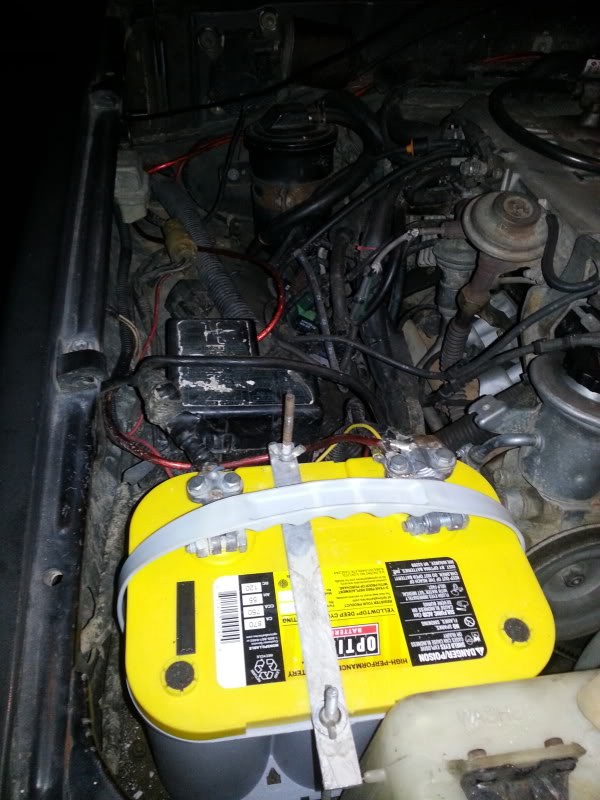

In with the new OPTIMA High Performance Yellow Top Battery:

This one is much better then the Optima Red Top i have in my corolla powering my massive sound system. But i figure with everything i plan to get on my truck it is gonna be very much needed. "for lights, winch, and sound system" yea it's gonna need it.
Here is a video i found. These guys explain in depth what sets this great battery aside from the rest and what each color is for if you are curious to know why i picked the yellow one.
Tomorrow i will finally fix my cluster of random wires leading to my battery. I finally went out and bought myself a "Del City Fuse Block" Thanks to Chefyota4x4's recommendation.
Here it is right out of the bag. It has spaces for 6 fuses. You can also get some that are 12 fuse size if you really need that much. And like Mark said the BLUE SEA FUSE BLOCK is much nicer. This one will do the job for what i plan to use it for though.

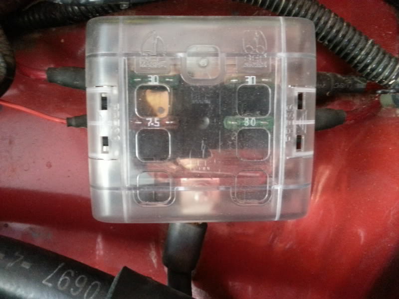

Here is a picture of Chefyota4x4's Fuseblock already installed.
