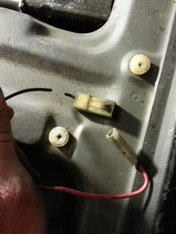

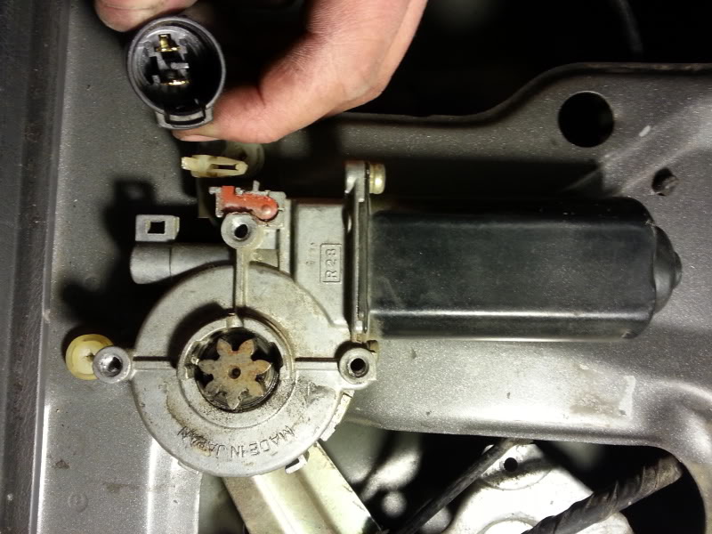

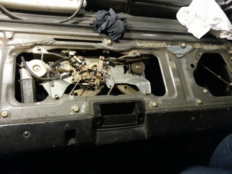

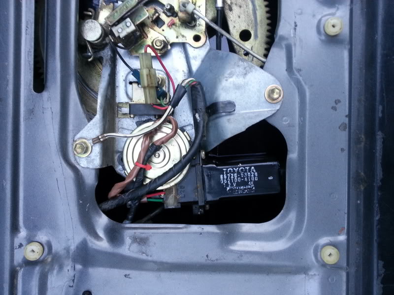

Last night my girl and I decided to take a look at the tailgate window motor for ourselves to see first hand what it looks like in person. This way when we head to the junk yard we arent 2nd guessing ourselves if it is or isnt the right one.
Anyway I removed the carpet and metal panel and this is exactly how I found it. With absolutely no plastic. Stupid last owner. Everything in here was pretty dirty.
I went ahead and checked the voltage like some of you had recommended me to do. And its obvious that power isnt the problem here.

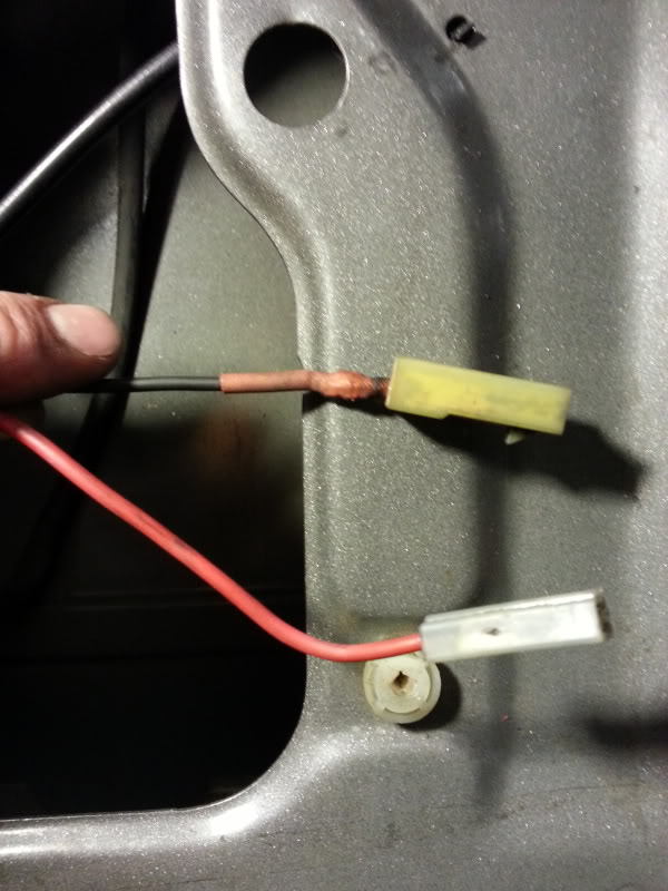

A random loose wire I found that had been cut. I'm guessing with probably the window up/down movement itself.
So I soldered it as best I could with the tiny bit of slack I had then shrink wrapped it.

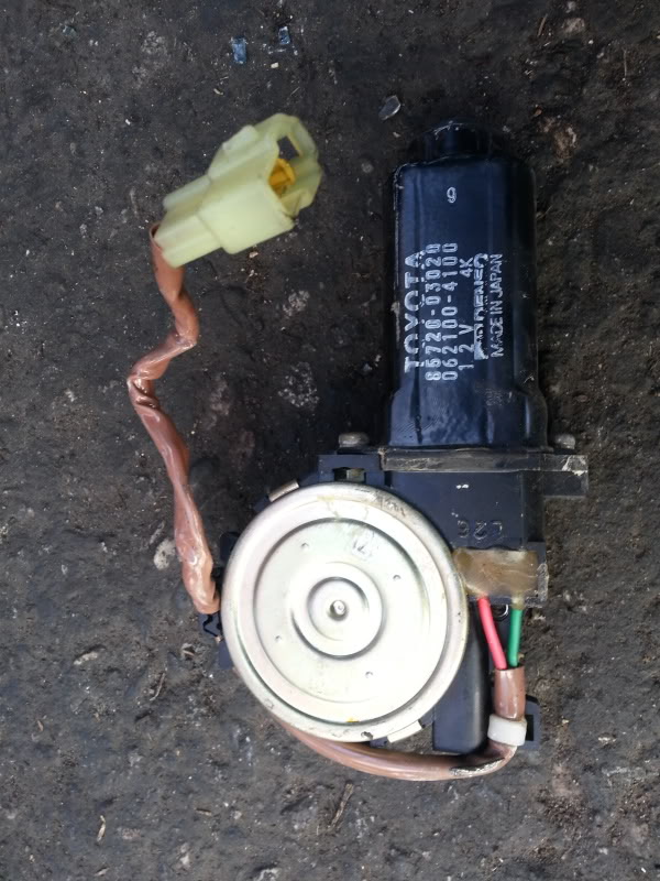

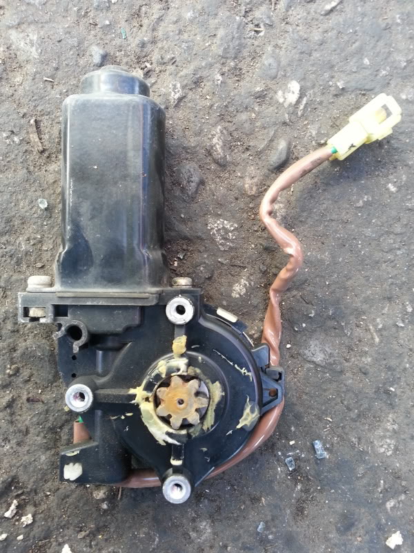

Some pictures of the motor I took so I can refer to at the junk yard.
Its amazing that such a small motor moves this huge window back here.

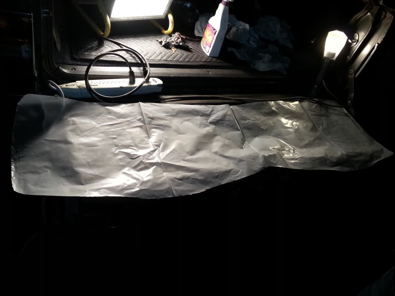

I havent replaced the the motor just yet but I figured id go ahead and get the new plastic cover cut, prepped up, and fitted to the tailgate. I used a product widly used in construction sites. Used for many trades. I chose this over a plastic heavy duty bag because this product is so much more thicker then those bags can get. My dad usually uses this for his tile/marble/and granite work. And it usually takes a lot to pierce it unless its something sharp lol. Here it is:
All cut to shape and ready to be siliconed on whenever the time comes.
After we did all this I took some Purple power and cleaned up a lot of the dirt and grime that was inside the tailgate being careful not to remove the grease that is supposed to stay in there. Did pretty good. I think. We're all ready for a new motor install. We just need to find one.

thatrandom loose wire looks like the defoger plug redeth this is how i found mine
an yes mine had no plastic toprotectthings either thus why the inside is so freaking dirty

William thanks so muvh for your reply. That really explains why my defroster never worked. Lol.
Mark, yes I am planning the camry motor install for the tailgate window. I'm actually at the junk yard now looking.

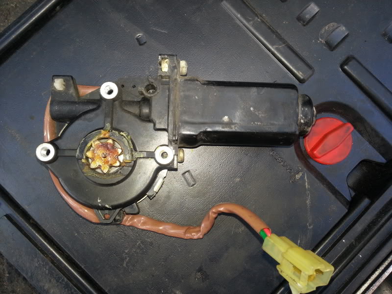

Here is one I just found. It had plenty of grease on it still. Anf its off a 04/90 toyota camry.
I'm about to look for a few more. Then just pick out the one in best tip top shape.

sorry redeth i didnt see the picture of you reconnecting the wire to the end

Finished the Camry rear driver side wibdow motor install. Perfect fit. And its so fast!
Uploading a video right now. Ill post is as soon as Its done.

Better late than never I guess. You can take those gear boxes apart for R&R.. Clean and relube. As long as they still activate the brushes are intact. The door window motor looks to have a c-clip on the shaft, but I couldn't make out the rear motor. Those camry ones are just held by the folded over tabs.

New Camry Tailgate motor swap video here. Wooot works like a charm!

Well done sir! Hope you greased it all back up well, bit of a squeek there.
I just wanted to remind you the plastic liner tucks into the slots at the bottom to direct the water to the drain holes, and you tape that bit at the bottom. It just poped into my head when I saw them at the end of the video. I need to redo the seals on my doors still. Knew there was a reason I didn't put the clips back on the window handles yet!

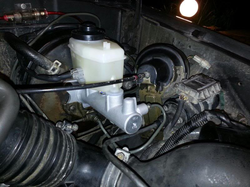

Sweet. Today was very productive. Got my new tailgate motor and then my girl and I headed out to marks place where we then installed and solered everything up to work. Works like a charm. After that we worked on bleeding Mark's master cylinder and last but not least we installed my new Master cylinder. I gotta say I definitely feel the difference now that I have driven home. Way better brake response. Its just a bit stiffer. But a good stiff. Not a ridiculously amount of rock hard stiff. It pretty much feels like a new car brake. It feels great.

Its kind of funny, that booster and reservoir is the newest looking piece on my whole motor haha. Kinda makes the engine bay look sexy!

No worries dude, I'm just happy you answered my question. At least I know my defroster should work now! Woot!
if not conductive paint is easy to apply to the lines to make it work
in my case i suspect that the tint they put on the window had a conductive metal layer an caused the fuze or something to blow which is why they cut the wires off at the connectors
