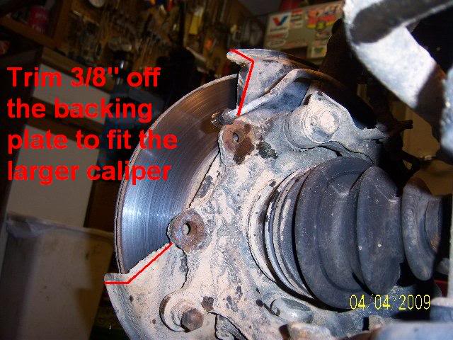

Corax said, "So the only real difference is thickness and overall diameter - if you saw the "height" is also different, that's only because the rotor is thicker and the height needed to change to keep the rotor centered in the caliper.
The calipers are a simple bolt on affair, the only thing necessary is little bit of trimming to the backing plate."
YES, I read that as well^^^ , ........... I just, again, thought it applied to his SUPER-T100 CALIPERS!...... which it turns out, as mentioned, are the same as my Before 10/95 4Runner Calipers.... haha. OH WELL... Live and learn.

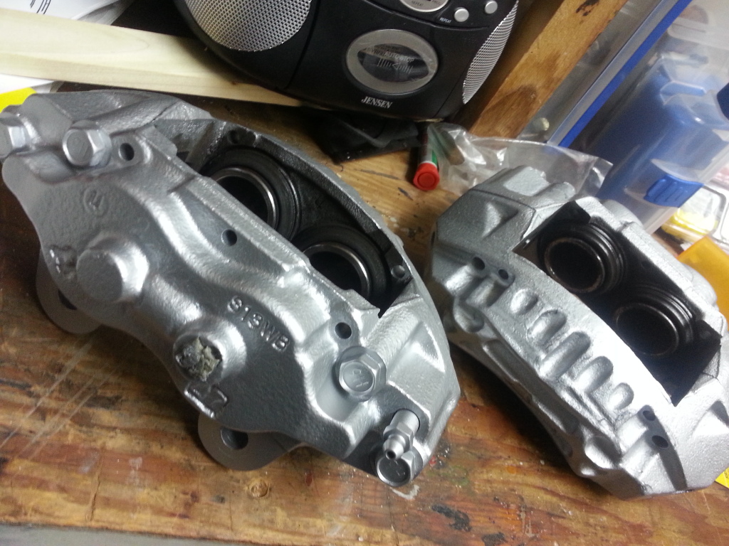

1. S13BW Calipers from the Low Mile 95 4Runner(Will have all new Seals in them) 20$ for the pair at PYPart 50% off day.......
^^^ ( Some Rebuild Stuff's for the S13BW Calipers ....... http://www.napaonline.com/Catalog/Re...Keyword&Nao=10 ) ^^^

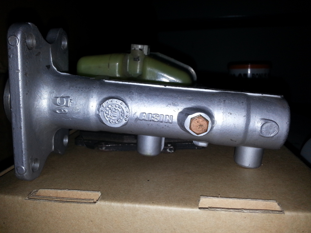

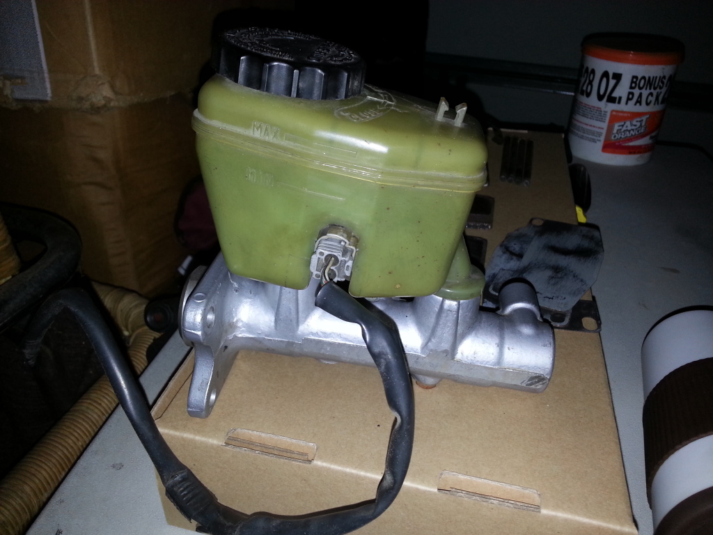

3. OEM-Aisin 1" Bore Master Cyl from 93 V6 Toyota 4Runner (Appeared Brand new, as did the fluid coming out when I removed it for 10$ at PYPart 50% off day) WAS Told to grab the Connector and wiring.... so I did.....
(^^^ The Reservoir IS NOT from that Master... That master-reservoir was nearly brand new... BUT, PYPart staff puncture every one of them they can with a screwdriver and force them off the screw to drain... I FOUND ONE that wasn't, ... Cleaned it the best I could... And while it's a lil stained in there, it's very clean compared to how it was)...

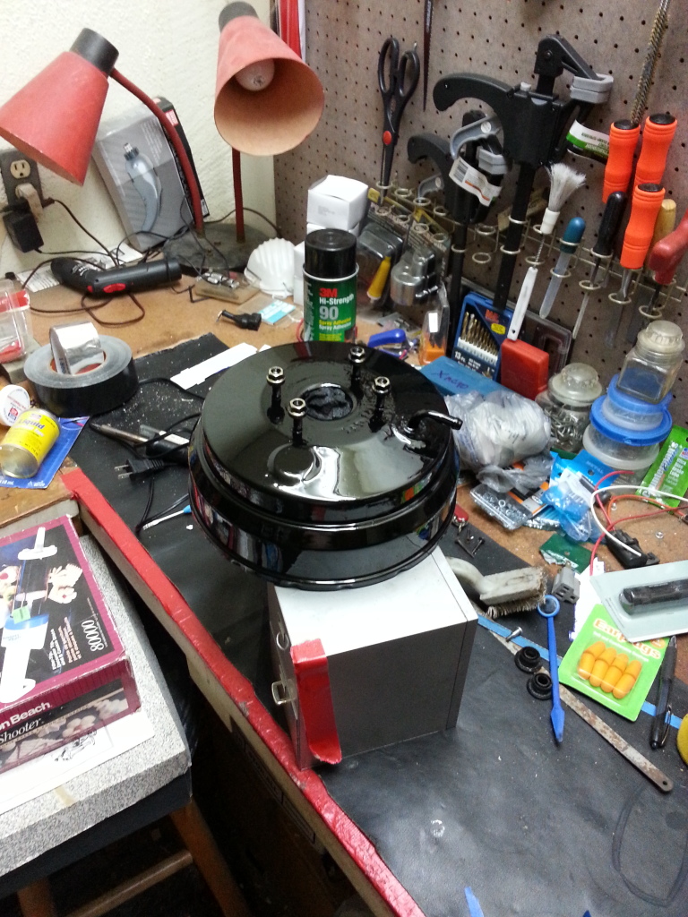

4. OEM 2nd Gen 6/91-8/95 Dual Diaphragm Brake Booster (From what I've read, which is now making more sense, the larger demand from the Larger Calipers and Larger Master Cyl. required a Larger, Dual Diaphragm Brake Booster[Also found on the Turbo 22RE's and many other Toyota Vehicles] 16$ at PYPart 50% off day.........

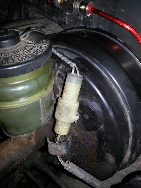

Ohhh ok I see what cha meant. Lol this was a recent post lol. Thanks a lot for digging through your huge 292 page thread for this lol.
So i will need an OEM-Aisin 1" Bore Master Cyl˟and an OEM Dual Diaphragm Brake Booster˟both off 2nd Gens from 6/91-8/95 correct? Is this the only thing I will need for this mod? I wanna call my girls uncles parts store to pre order this so theyll have it in stock for when I get out of work.

The master cylinder should work fine, as well the booster would, but the booster is likely going to run you around 200 dollars even after market. I don't think you need to do the booster for now. Many people find the 1 inch master cylinder upgrade at least a decent improvement, and you can do the rest of it later. Just my humble opinion, but I would save your money for now and just do the master. My master cylinder is off of a 95 4 Runner. But, I mentioned 94 only because at 95.8, or somewhere around there, they change to a 2 bolt master cylinder, which is not compatible. Obviously your uncle's would know the difference, unlike many of the morons at the part stores in the stories I've read, haha. But, just to be safe, right? I also know that ABS comes into play at some point, because when I looked on the Toyota sites, I noticed 2 different part numbers with a small description stating, with ABS, or without ABS. Can't remember the year that started, but I think it was a couple years before 95. I'm not even sure that makes a difference, or how much of a difference, in regards to this swap, but I know that the connector is probably different. I believe that both of the pig tails and connectors that I got were 3 wire, but I haven't been able to go out and verify that just yet. I will soon, within the hour, okay? Even then, I figure you could probably use just the 2 wires that are for the dummy light in the dash, just like ours had. to be honest I'm not even sure if my first gen 87 has 2 or 3 wires. how about your 89?
Old Feb 12, 2013 | 10:48 AM
  #985
Redeth005's Avatar
Joined: Apr 2012
Posts: 2,817
From: Los Angeles CA

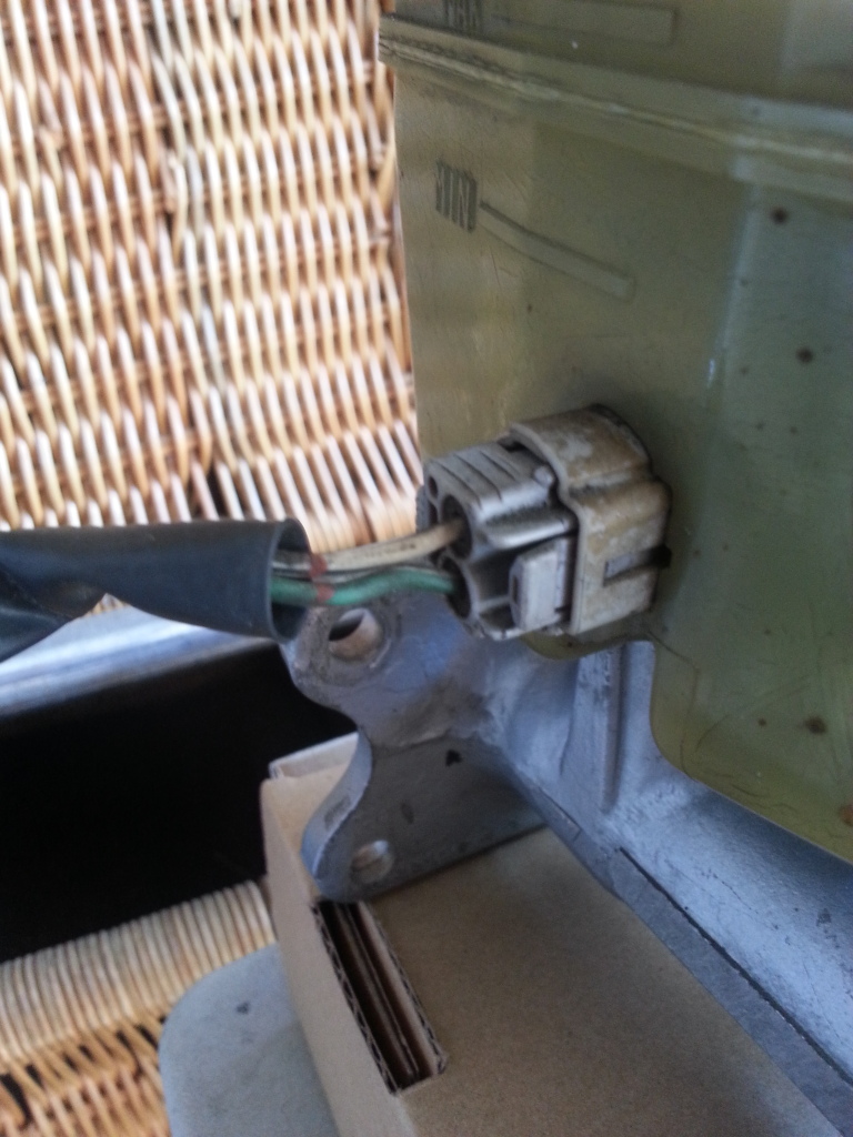

I have 2 wires on mine
Old Feb 12, 2013 | 11:23 AM
  #986
ChefYota4x4's Avatar
iTrader: (5)
Posts: 19,281
Likes: 21
From: Lake Havasu, AZ
Yep, New one is 2 wire as well

OH, WAIT, WHAT'S THIS? ..... a gift for my homie? >>>
Old Feb 12, 2013 | 11:32 AM
  #987
Redeth005's Avatar
Joined: Apr 2012
Posts: 2,817
Oh nice! You had an extra connector?

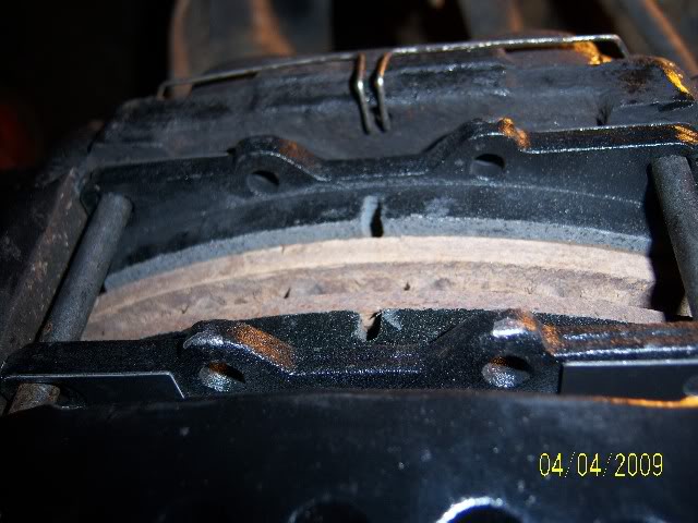

A little bit of ssheet metal fab and you could close up those holes, almost completely, just don't forget to put in a few drain holes.
Damn sorry I got long winded again. I really just wanted to say that bubble stuff is available as a duct insulation
