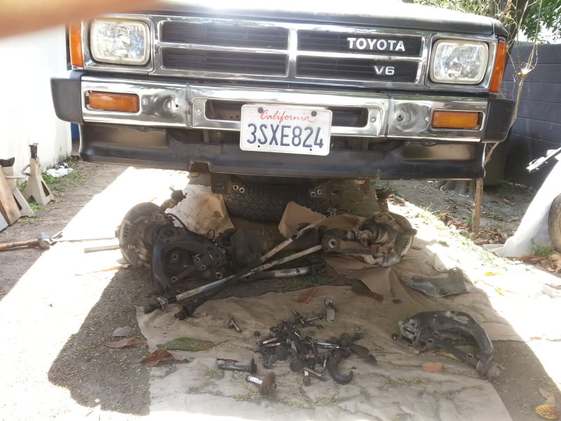

Here is some of what my Neighbour and I did yesterday and today.
We unbolted the everything that had to do with IFS suspension and smacked the pieces with a big hammer to unsieze it all.

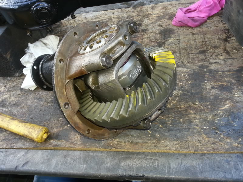

Made the trip to YotaMasters in the city of Corona California to pick up my front 3rd member. I also bought a spring scale off them to check my bearibg preload on the 54mm nuts.
We spoke toyota talk for a good hour. Erick was one realky cool dude. He knows his stuff well. And while I was there I figured I might as well buy some Diff armor to protect my investment. So I bought my front axle this heavy duty plate and the long piece that mounts on top of the axle. Erick was kind enough to also let me have one of the cheaper diff armor plates nobody wants and leaves at the shop. Threw that in the package for free. All trail gear pieces. Gonna use the cmaller plate for the rear axle.

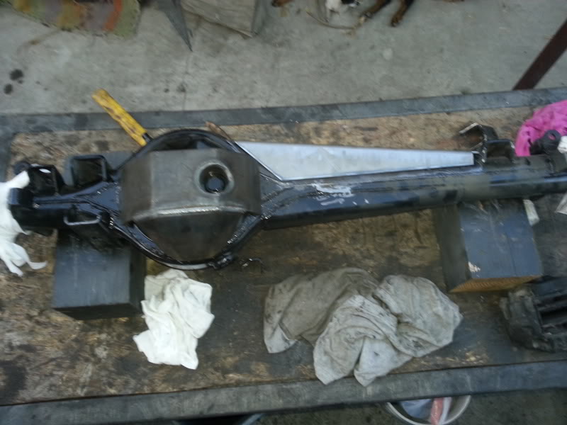

This ain't welded yet. But I thought I'd throw I'm a picture anyway. I still had to grind down a few of the extra parts from the stock axle to get it to fit. All good all those extra parts aren't needed anyway since I'm gonna have Hy-Syeer.

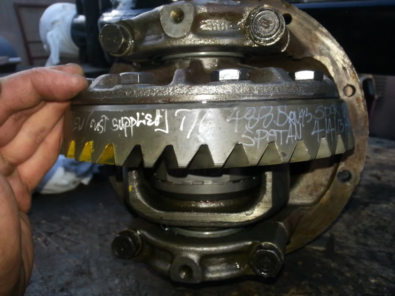

Here's the picture of the front 3rd
And some of the engraving he did. That is one way for me not to forget when this work got done. Byw just realized he misspelled "Spartan" locker. Lol. All good. It's the work that counts.

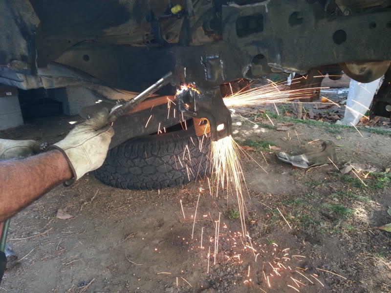

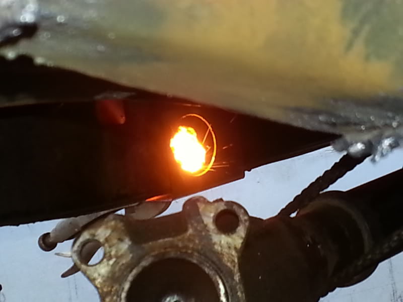

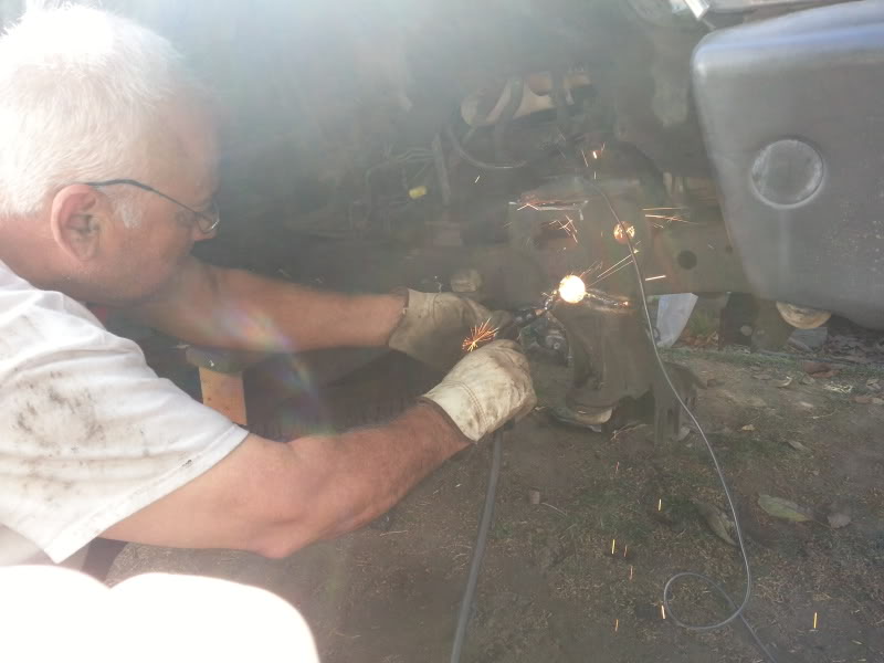

Today we picked up My neighbours plasma cutter from work. It was a small one that he eventually clogged the small tip where the torch is so we had to take it bsck to his job and get the big guns lol
Gotta tell ya its a white vs black difference having this in handy vs trying to use a grinder for taking it all off. This thing melts the metal like butter. Definitely saved us a few hours having that thibg available to us. Wooot!
Here are the pix of Ruben in action.
Using the small plasma cutter.

Using the bigger plasma cutter.

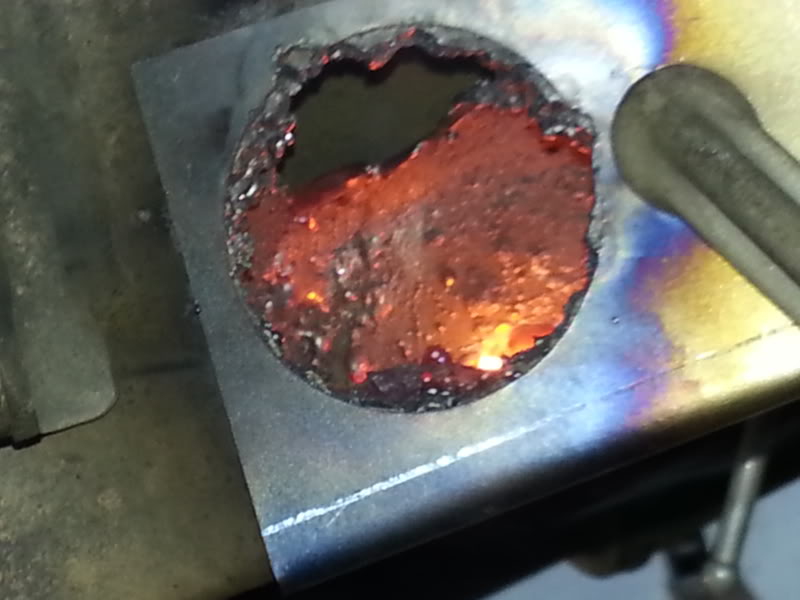

Making the hole through the frame.
Another

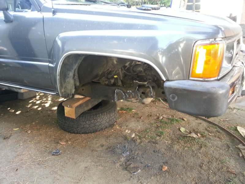

There's no looking back any more

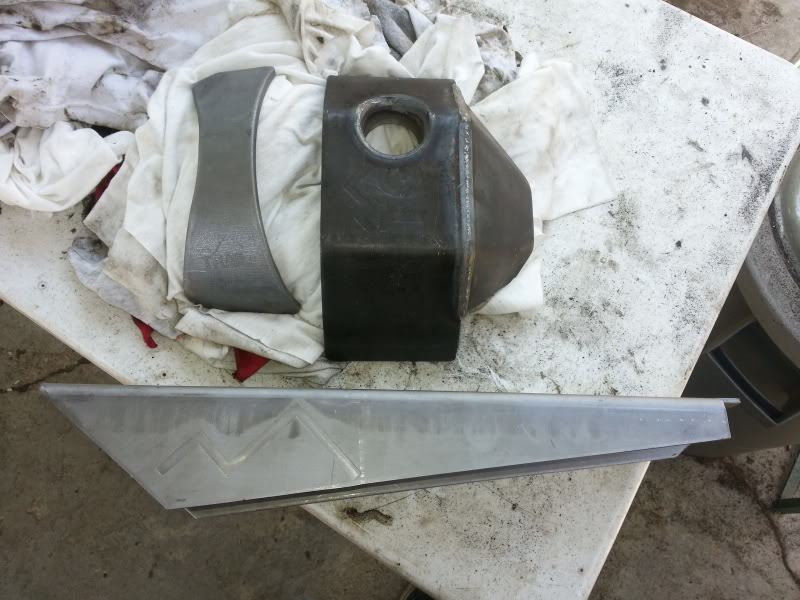

Hey guys quick question.
WHAT ARE THESE 4 SMALL PIPES? and WHAT ARE THEY USED FOR? WHERE DO THEY GET INSTALLED?
I called AllPro and forgot they are closed on weekends. The online instructions dont specify what they are. And my neighbour doesnt remember what they are used for.

I'd bet they are sleeves, bubba. Probably for inside the bushings for the front hanger of the rear (?) pack u bought?
When u install new bushings in the new front hanger. ..... that bolt slides through a sleeve. Same with the front hanger bushing of the front pack. The rear one, with the shackle, that can use them as well if a kit. Probably so, if u have one pair of leaf packs and 4 sleeves?

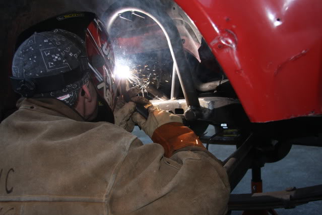

Those 4 pipes are for your shock hoops. Two per hoop. You weld them to the back side of the hoop and tie it to the frame. It's for extra support
You and chef should look into getting double Cardin u joints done. At least for the rear since it turns all the time

As you can see, i think? Hoop in and the short braces go on. PS A friends 82
