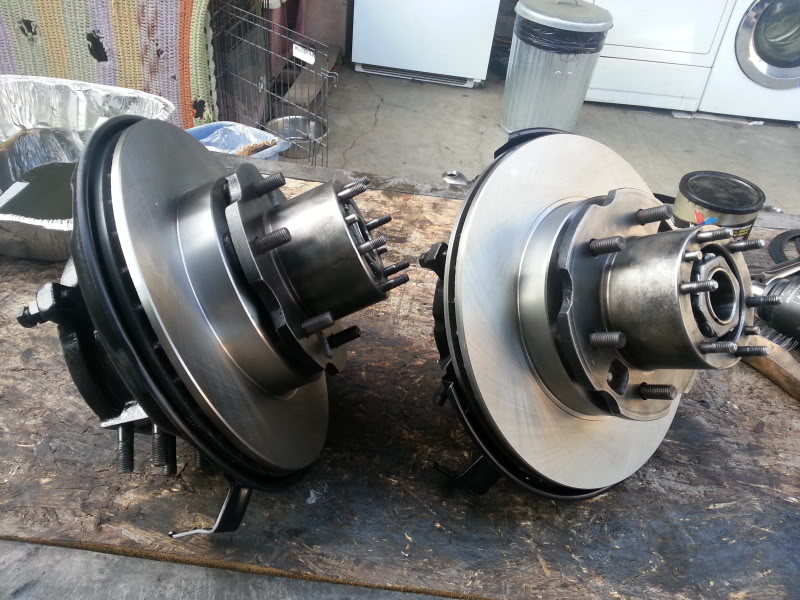

hubs look nice!!

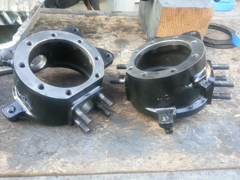

And here's how the knuckles came out once they dried.
Definitely gotta say I think I did a swell job and doing these. This was probably the dirtiest part of the whole axle.
Today i greased up the knuckle bearings then my neighbor and I installed the knucle rings, bearings, and seals. We only did one. And I didn't take any pix. So ill try to take a bunch for you guys tomorrow when I do the passenger side.
these babies are coming together very nicely! I can see it already. Once this axle is done ita gonna look extremely clean. Too bad its gonna be the cleanest most new looking thing on my truck lol

hubs look nice!!
Thank you man probably gonna have them powder coated in the future. These hubs won't last with that paint job for very long with rocks and off road trips.
Originally Posted by Teuf
Its not that bad now, just crooked. Its stopped hurting this morning.
Dude today I began to run toward the end of my work table to save my hub from falling and in that motion I slammed my pinky toe into the old metal rotors I had on the floor. And wtf...... first time I ever wear sandals in over 3 years and what happens? This happens! What rotten luck. It Instantly swelled up and nail went blue. Damn. Thats the last time I ever wear those again. Lesson learned.

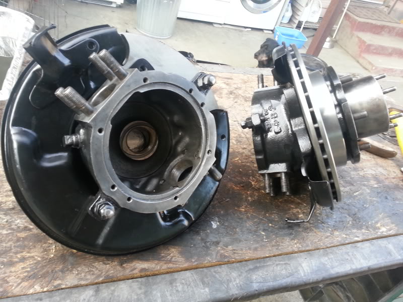

What got done today.
Nicely greased
Then goes the bearing and seal
New axle seals for where the birfields go in.
Make sure to grease before trying to install.
Now inside
Removed and installed the new bearing seats. (I think that's the name. Just guessing at it lol) again make sure to grease before u install. And use a block of wood to it on to get it inside.
And in case you're wondering what kind of bearings come in the MarlinCrawler kit these are them. Yulon Gears FTW!!!
All put together nicely

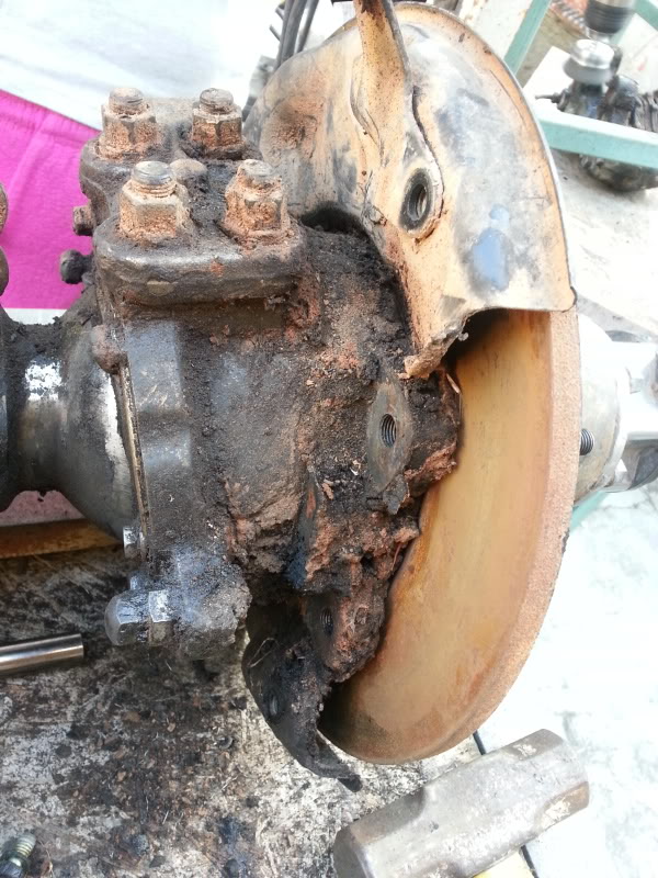

What a transformation. I still can't believe this is what they used to look like.
I think I've done a great resto job on these.
And I even got time in to grind my shackles and prime them then paint black which I did not get a picture of.
Once again thanks for keeping up guys. Will be working on taking apart the Aisin hubs tomorrow to grease up. Ill post some shots of that tomorrow as well.

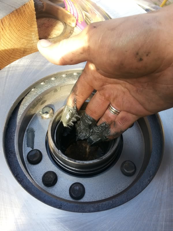

Old Apr 4, 2013 | 09:05 PM
  #1220
Redeth005's Avatar
Joined: Apr 2012
Posts: 2,817
From: Los Angeles CA
Originally Posted by Cyberhorn The Dragon
if not i hope you did the scrape the palm of grease type packing where it packs it in till its oozing out the sides
This is the method I used. And it was really packed in there. Exactly how u said. Till it comes out of the sides.

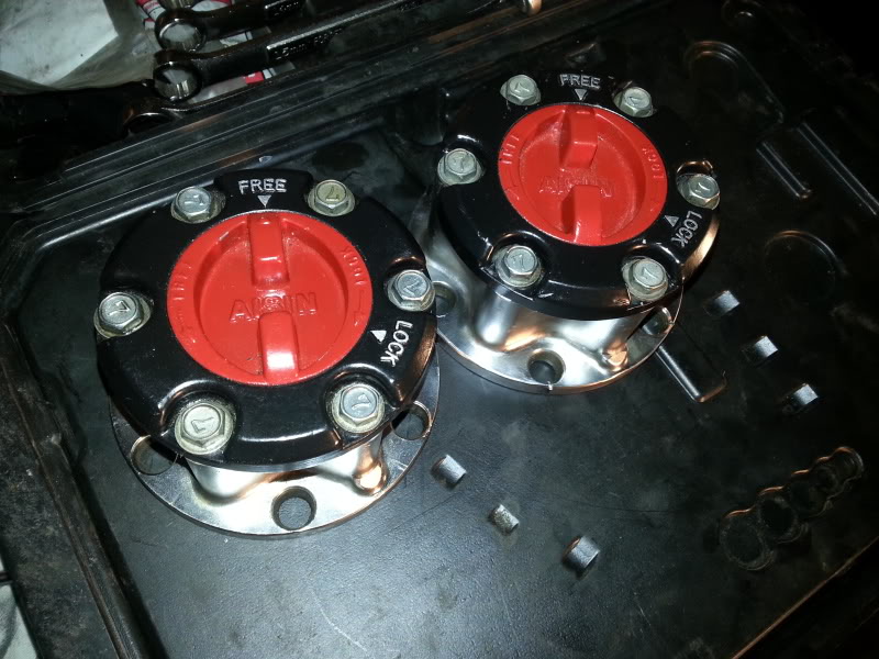

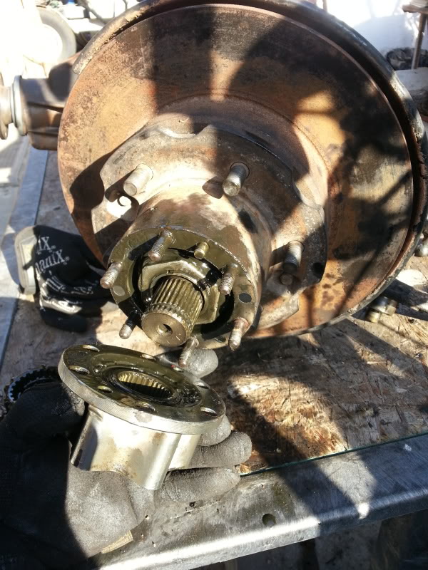

Finally finished greasing my Aisin hubs. All I need now is to install them once I get that 3rd back.
