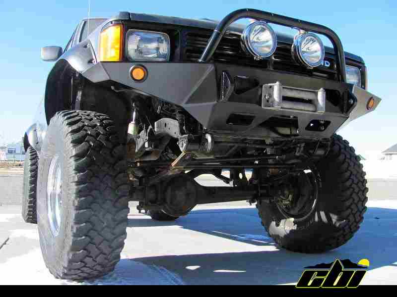

CDN yea man that is the bumper i keep talking about that i want. It's so freekin sexy! and its different. Everybody has ARB or warn and mostly tube bumpers. I like the CBI one cuz it looks sharp, different and has a new look to it vs the competition. not to mention nobody has it. well that ive seen so far.
I'll look through my photobucket and see if i can find some more pix of it. CBI sent me a few other views in an email a while back ago

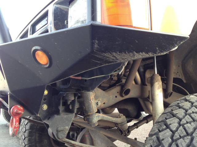

Hey CDN here are the pix I told ya about yesterday. This is the same set up I want mine to look like here.

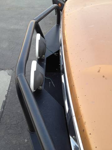

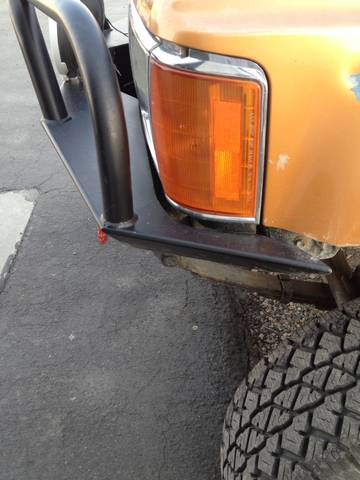

Here is the extra, optional, tubing to protect your fender and lights.

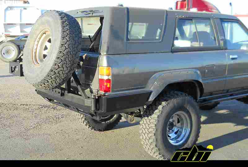

Thats all I got for the front bumper. And this is the CBI bumper that I really wanna buy. When I decide to upgrade my bumpers. I think I'm gonna go for this rear tire carrier first before I get the front one; I need it more. I have to have my bed space on the inside of the truck and a tire that size takes up way too much space. So tire carrier will definitely be next on my list. Only bummer is that you need to supply the swing part and the lock hardware separately.

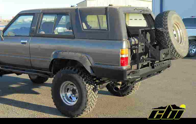

CBI makes some great looking rear bumper/tire carrier/jerry can holder all in one. You should see the ones they have for newer generation 4Runners those look sick!

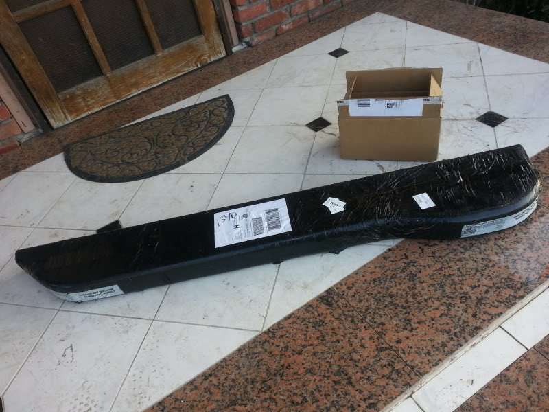

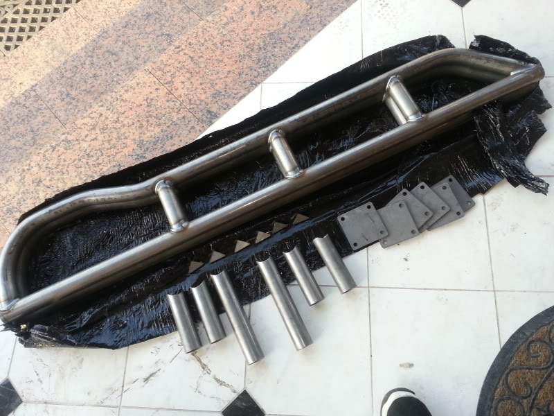

Look what I arrived yesterday.
Everyhing that's included in the order right here.
My dad said he would like to help me out with welding these on. He was taking a look at Rubens welds and said yea its good but he thought Ruben would have done a better job then he could have but he said he is sure he can get better welds in. I figured Ruben helped me with my entire SAS so I can get help from my dad to help me with my welds on the sliders.
We'll see when we install them. I need to find some installation instructions for it first.
Old Apr 26, 2013 | 10:09 AM
  #1405
ChefYota4x4's Avatar
iTrader: (5)
Posts: 19,281
Likes: 21
From: Lake Havasu, AZ
Nice!
W/out a body lift the pipes need to be cut at an angle opposite the arch cutouts..... this way u keep the frame side end of the pipes near the center of the mounting tabs..... , and then your slides will be a slight hangover and write up to the bottom of the door, minus around 1 inch in case they get slammed really good... I mean, you want to be able to open your door if that happens. Awesome! They make a nice stuff, don't they?

Gotcha and thanks for sending me the photobucket album. i have a better idea of how to install them now.

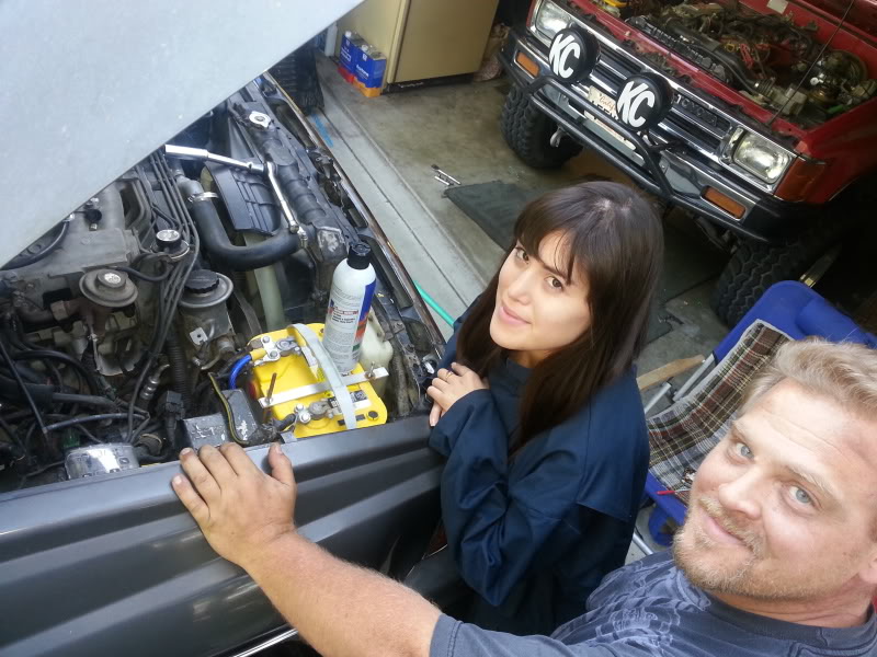

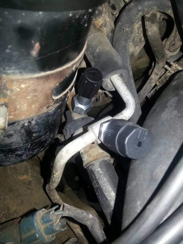

Spent the day with Mark and my girl Faby. Delivered all my 89 IFS stuff to him and the extra Napier Sportz SUV Tent. Went to Lowes to get some washers and new stainless steel hardware for my roof rack. The steel ones I have started showing signs of rust already. We didn't get to installing that stuff today but we did check out my AC system. With summer around the corner and the high temps already reaching California I wanted to at least troubleshoot this so I don't die of heat stroke this year hahaha!
Here is my girl suiting up for work with Mark's jump suit.
Mark teaching her and me a few things of Air Conditioning
We retrofitted the stock R12 fittings for the newer style fittings.
We also troubleshot the compressor and found that it wasn't seized. So that was a good thing.

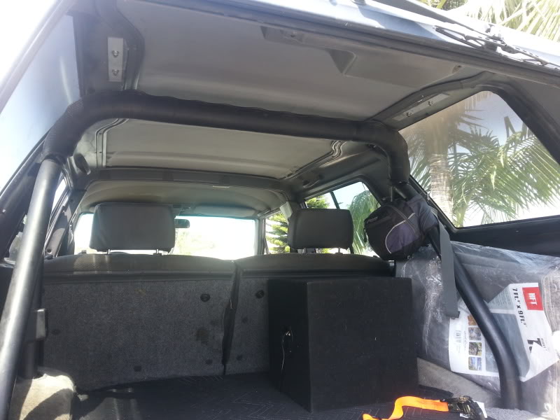

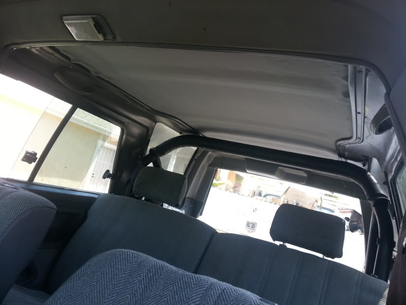

Sorry i didnt take pix of the today's progress with steps but I removed the roof rack and drilled out the holes bigger through my roof to install some plastic spacer washers so I can tighten the bolts that go through my roof as much as I want with out destroying the fiberglass hard top. Thanks Mark for that idea. It really works.
Anyways I used some new headliner material from Pepboys. And used some 3M 80 Adhesive Spray bought from Home Depot. I love the way it came out. It is pretty clean looking. With the exception of the little bumps where the bolts and nuts tie down into through the roof. But other then that. Yea it came out pretty clean.
