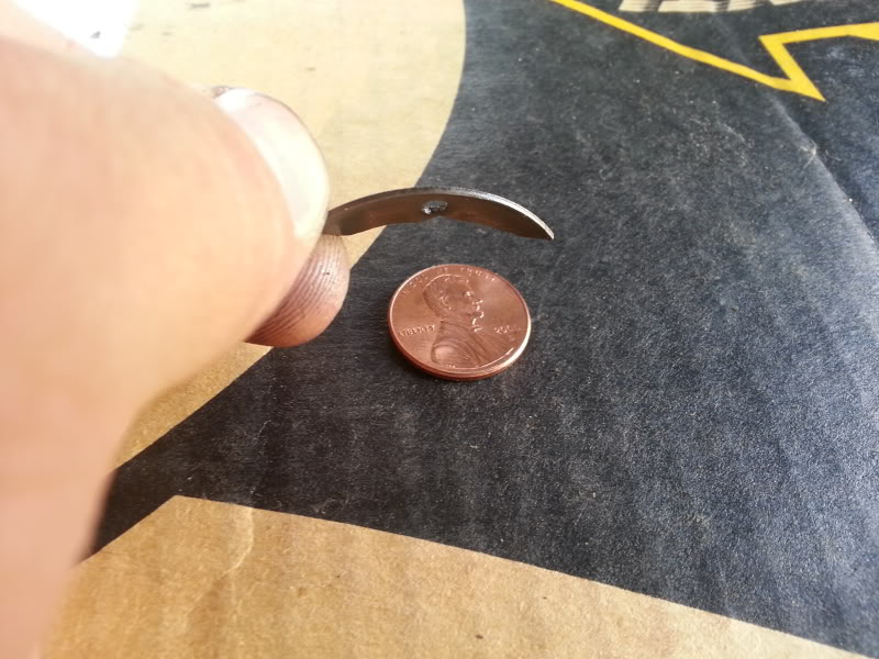

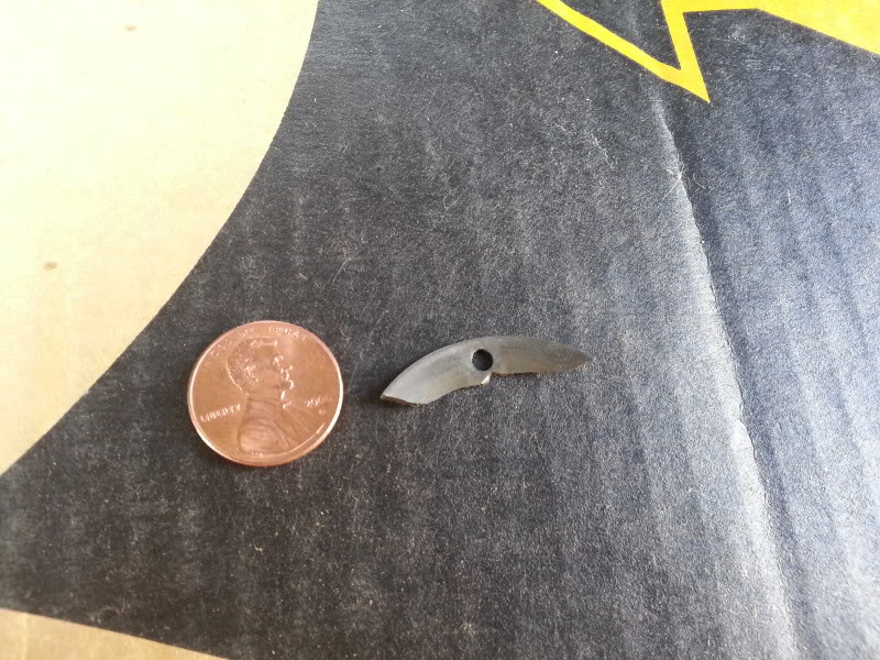

Today I drained and changed out the rear diff fluid. and look what i found attached to my drain plug
I really don't know what it goes to. I checked the pix i took of my locker and gears and it is obviously not chipping off any of those parts. I've been driving it around all day yesterday and today and it drives out fine. I just hope it wasn't anything bad.

part of a shim?
good ya had the magnetic drain plug (reminds me i need to put the magnetron ring magnet on my oil filter to catch any powdery metal in the filter)

Could be a piece of the baffle... The inner one that the axle last goes through b4 entering the carrier. I'm sure u got a good look at the front outer one when doing the seals?
Jay will likely know.... I'll show him the pix tomorrow when I over threre if you want.

I was just messing with the spring pack. It's how they make super flexy springs and still be able to maintain a certain ride height. Just look at Deaver springs made mainly for pre runners. They have monster 10 leaf spring packs or more but super flexy
That is an odd metal with a hole drilled into it. Only thing I could think of would be from the locker as nothing else I could think of would have a metal with a hole in it
Don't the baffles have holes in em? I'm not sure. .... hmmm
now that you mention it a second time. maybe. ill have to check tomorrow. i have a few extra axles i can check hehe

This is s Master 7.5 R&P high pinion reverse geared rebuild kit... But largely the same. .. And I don't remember seeing anything like that in there... But still not sure.

Finding metal like that is always scary. Hope it isnt something that can turn into a major problem. It does look like a shim, but I dont know gear very well and what all is involved with them.

Sent an email to Eric with YotaMasters this mornong about that metal chip I found attached to my drain plug. I asked if he had an idea of what it could be and this is what he replied to me.

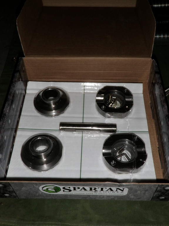

Hey Richard. It looks to me to be a piece of one of the thrust washers from
the stock diff carrier (the part the spartan goes into) I would recommend
pulling that diff out and bringing it in so we can take a look at it.
Eric Hansen
Yotamasters.com
951-279-0220
Darn I was really looking forward to that Big Bear off road trip this weekend. Dont look like that'll happen. But all for the better. Better get it fixed right now before I really mess something up. Or damage my locker and or ring & pinion.
