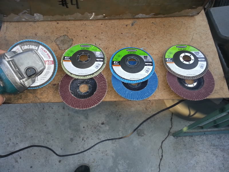

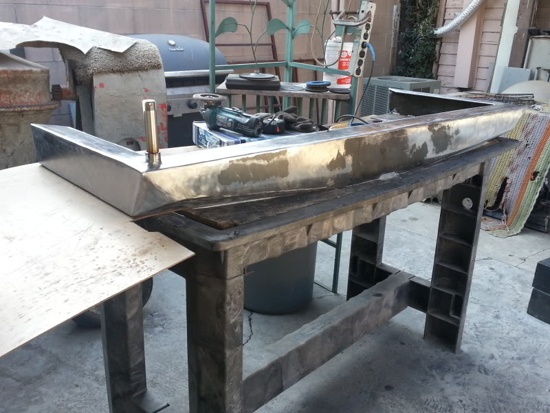

Made a trip to Harbor Freight today and bought some sandpaper for metal in 40, 60, 80, and 120 grit.
You can really tell here
I only had time to pass the 40 grit through the whole bumper today before it got dark out. and even with a 40grit i can already see the massive difference. It feels smooth to the touch and shines very nice. can only imagine how smooth its gonna be when i get to 120.
Well.... You guys already know what i'm gonna be doing tomorrow. Cant wait to get out of work

Yeah booooeeey! Told ya the flap disc's rock!
The Emery Cloth Metal pack,(fine, medium & coarse) from Home Depot? I think you'd really love that stuff as well, buddy. It helps even it out when you want to really smooth it out in the last stage. It really helps to have that cloth in your hand right against the metal/to feel lil imperfections that get difficult to see as it gets shinier. Then finish with "building" primer....you basically "build it up" in layers. You dont really want to go SUPER smooth as you need some texture to get the paint to stick to. If you powdercoat, you dont primer at all, so you end up saving lots of prep time and material/in exchange for cost of powdercoat, ya know?
It would probably be best to have swing out portions how to cut it separately. Don't have it all put together when you take it to them. And if you want I will call them let me know okay? I'm positive I can probably get you a little better deal.

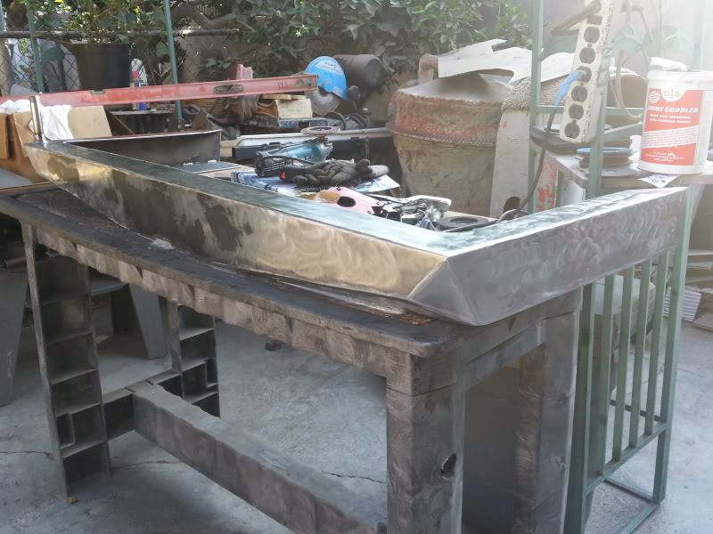

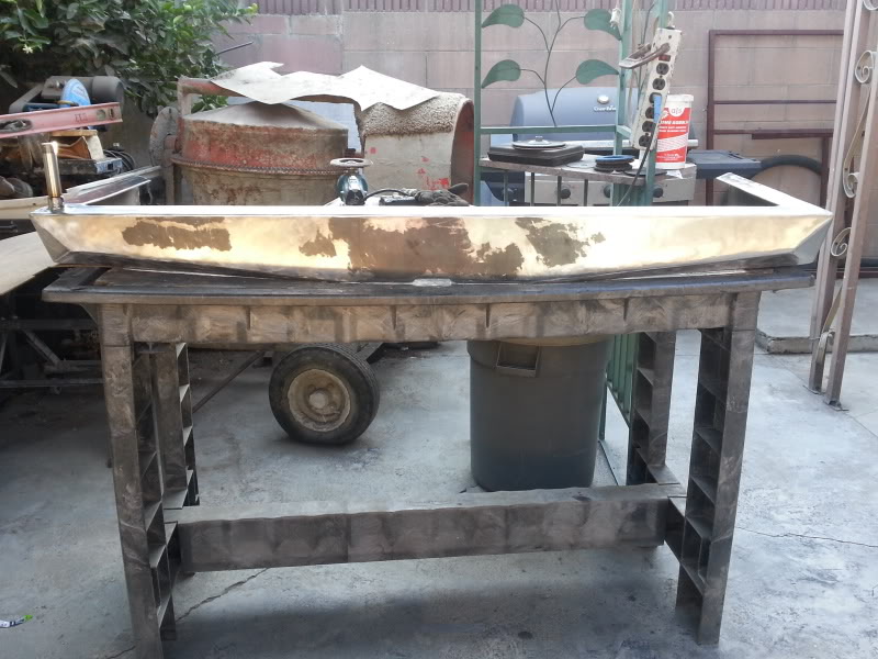

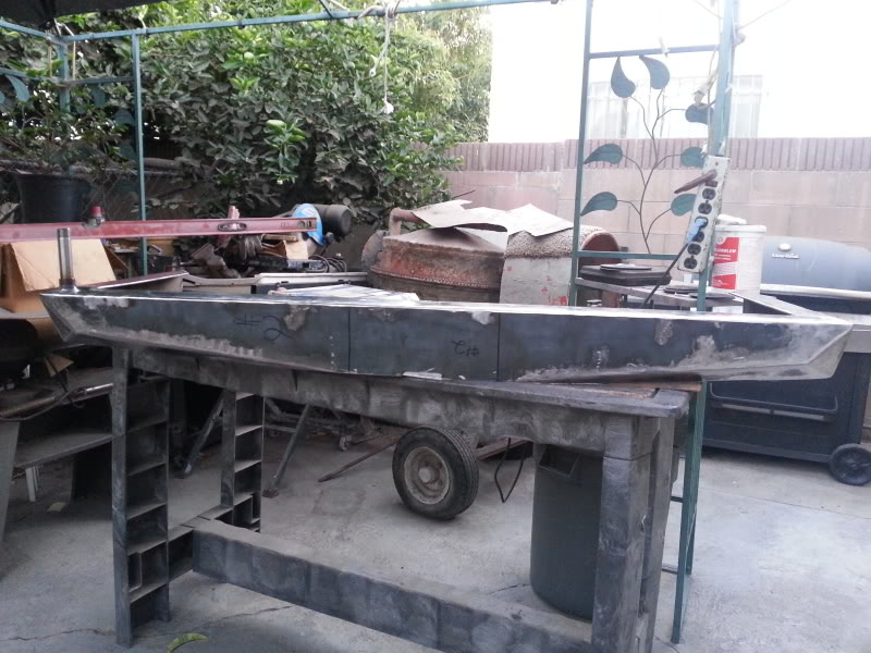

All done with sanding the bumper down. This thing is super smooth now. I took about 1hour on each of the sand paper grits that I bought. Here is how it sits right now.
Now I just need to check out those prices on powder coating. Mark, I don't know if its possible for you to get a quote without having the shop actually see the bumper in person but if it is can you please try to see how much they will charge me? I'm really thinking about grabbing some paint and giving it a bunch of coats of both primer and paint. But I know powder will hold up hits to rocks much much better then paint.
