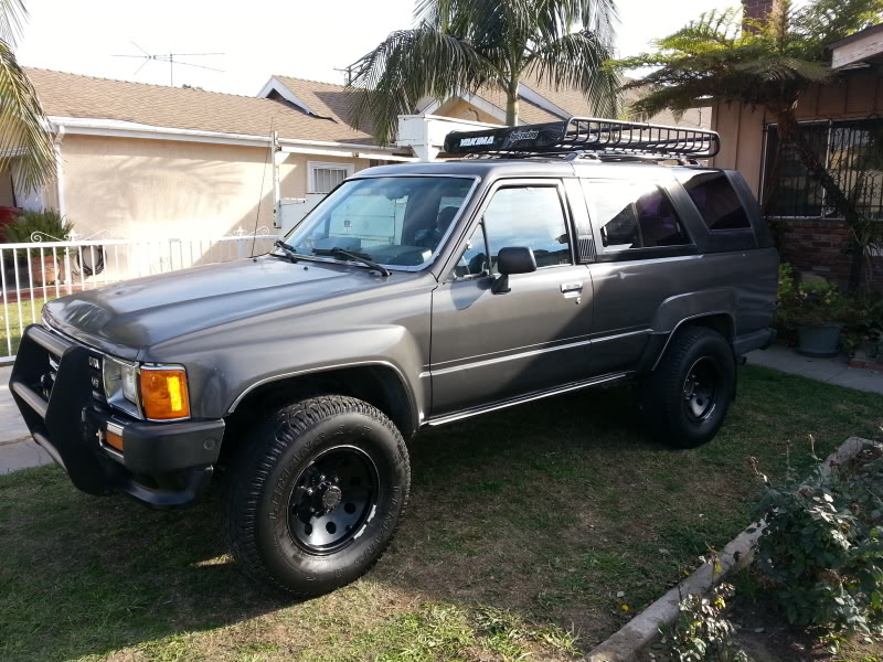

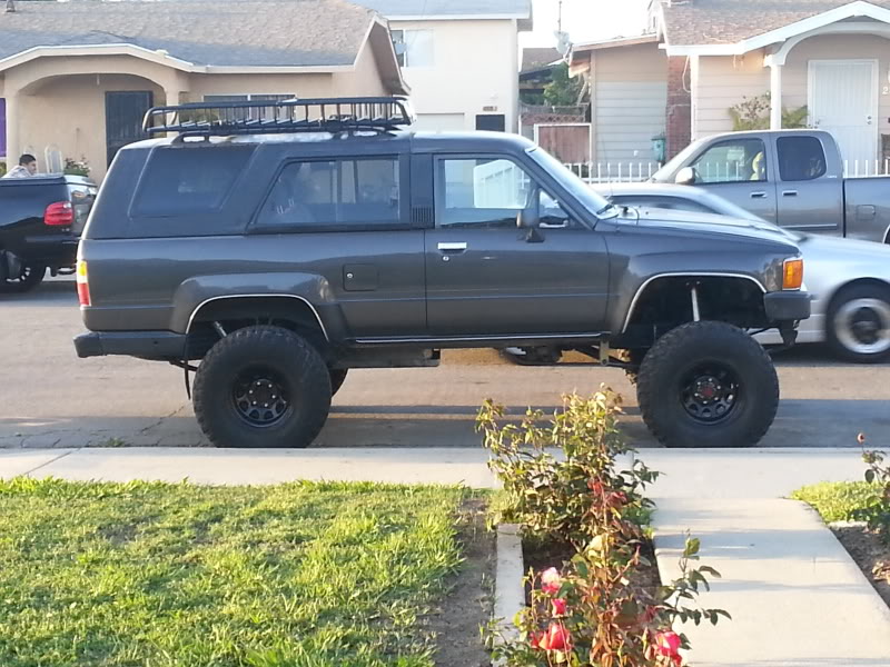

I'm selling a few of the things i took off of my truck once i went the SAS route and Higher 4" lift. If you guys are interested please send me a Private Message and i'd be happy to work out a payment via Paypal or local pickup for ya. S&H will all be on your Tab. and i'll try to wrap everything up as best as i can.
Like the Ad states i am in the Los Angeles CA area. I'd prefer to work with local pickups only at least for the tires/rims, valance, and might possibly ship out the leaf springs. Send me a PM and we'll see what we can work out. (I WILL ONLY SHIP ITEMS OUT ONCE PAYMENT HAS GONE THROUGH! via PAYAL)
If you want a specific zip code to my location it is 90255

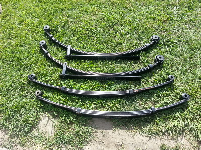

2-3" lift kit(front and rear) for a SFA or SAS's truck/4runner $250 They are used and are settled. Still work fine only reason i'm getting rid of them is because i upgraded to a real 4" AllPro lift leaf springs. These dont require new welding of spring hangers for the rear. It will bolt right on to your stock ones. Will not separate. $250
Note: not sure if it will sag for a pickup, but it did have a slight sag on the rear of my truck due to the hard top, tire in the bed, roof rack and cargo in the rear. I'm sure this problem can be quickly fixed by adding blocks or another leaf in the springs like i did to my current leaf springs to even it out.

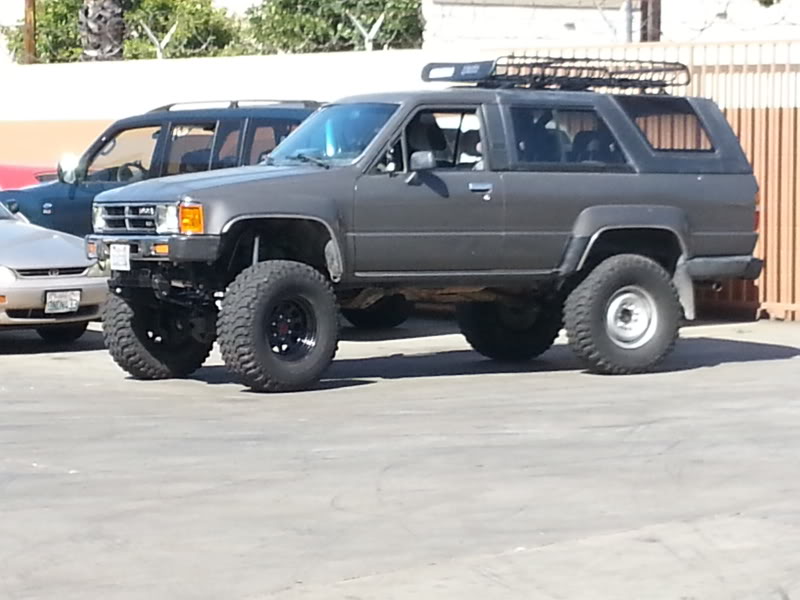

Here's how my 4runner looked with these springs installed(on 33" tires)

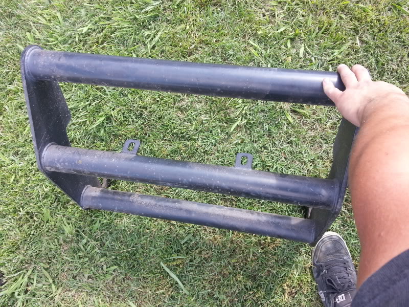

Bull bar. With light tab. No mounting hardware $80
bottom part mounts onto where the skid plate mounts to and on the front you will need to drill 2 hols through your bumper and use a nut/bolt on each of the 2 holes to mount the front part to the stock bumper.

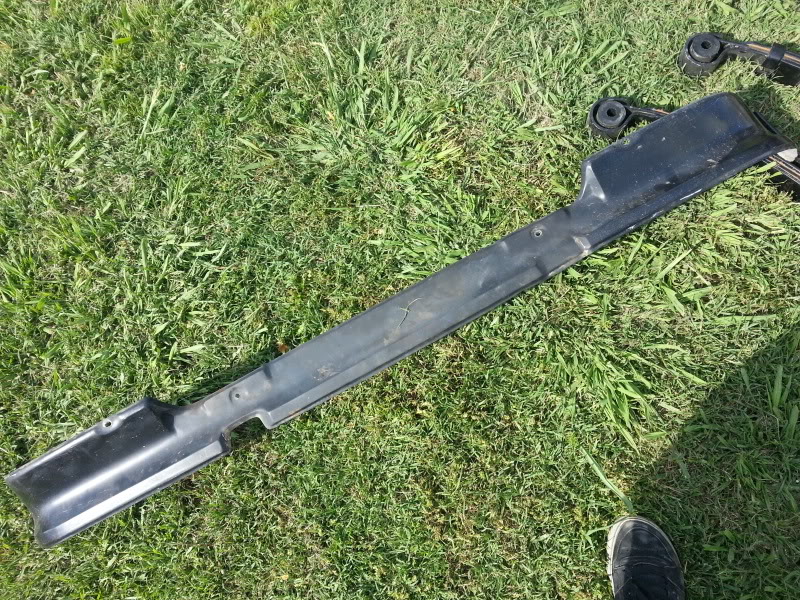

Valance. It's not to my original truck. this one is off a black 4runner. I do have mounting hardware for it as well.
I'm still debating on this piece though. The metal is so thin i don't know how i would go about shipping it safely so i might only make this one available for local pickup $25

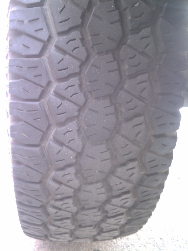

And last but not least my old black aluminum 15x7 rims with 31/10.5/15 LEMANS A/T tires Still have plenty of tred left including a spare tire on a stock Toyota spare steel rim. All black rims with Lemans are balanced already. Selling these for $200 for all 5. Will not separate from the rim.
These are all old pix of the tires, but they more or less have the same exact amount of tred left. Approx 1/4" deep on all tires and spare is almost brand new. I'll get current pictures of the tires uploaded with tire to Dime or Penny ratio as soon as i get home from work today.

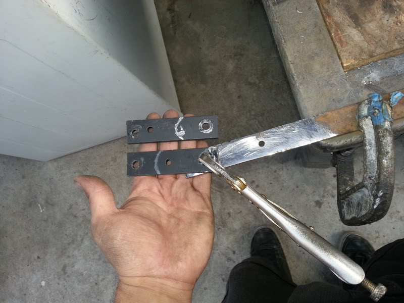

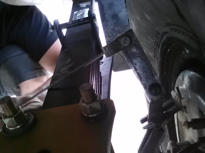

A little something I'm working on right now. I think it might work.

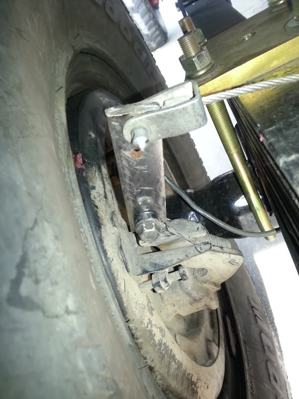

My hand brake extension. Hook up to the brake drums to the steel plate extension then to the brake lines.
I'm hoping that if I I tighten the bolt with a lock washer tight enough on the drum brake that it won't move either way when I pull on the brake. This is just experiment #1. Lets hope it works.

it might work it'll certainly give you a huge leverage advantage on pulling it tight

Nice idea on the cable... Curious to see how that works for you... good improvisation man!
I might know someone who wants to Springs Richard... Let me give him a call!
Hi Mark, Well it wasnt much of a double date. the other girl in the first picture is one of Faby's best friends(married to a US Marine). My Friend's date was the small skinny girl sitting on the couch with him in the big group picture.
About the springs Thank you Mark, let me know what you find out. sooner i get rid of this stuff the better because i gotta pay off this SAS/Lift ASAP!

Note: There are some adjustment complications with having such a long leaver arm. Its difficult to get the cable length dialed in correctly. On the plus side when you do not much pull force is needed to really lock down the brakes.

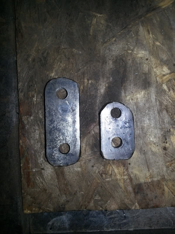

BTW I also realized that they were too long in those previous pix so I actually had to cut them a little more then 1/2.(pix in the bottom comment)
Alright guys I found that the bracket was much too long. It stuck up way too far and it was about 1" away from the inner tire wall. Not to mention those nasty points on the corners of the brackets. For better adjustment capabilities and fear of popping my tires when i air down for off road i decided to just play it safe and shorten them and also round off the ends and leave it more or less in an oval shape. After this i think it should work perfectly.
Not the best grinding job for rounding off my ends but so long as it works i cant complain!
The reason i made these different sizes was because the passenger side seemed to have much more slack in the emergency brake line. When i first tested out the previous "longer" version i noticed that only the driver side would tighten while the passenger side would still be a bit loose. So i eyeballed it more or less to see where i need to make my next holes and this is what i was able to come out with. This didnt cost me a thing. I just used some rusted scrap metal that my dad had laying around in the back yard and cleaned it up. that was all so if this one ends up messed up i can just make another one or do what BlazeN8 said and order one of those extension kits.

this ad i think was built by a shop to flip at a profit. anyways it reminds me of yours
http://fresno.craigslist.org/cto/3783248858.html

Holy cow that thing is sexy! Reminds me of mine too! Really diggin those rims. Thats not a bad price for what he has invested into it. Dang.... wish my brother had the money for that truck lol
Just checked out the fresno Craigslist. Wow you guys got some sick looking rigs out there!!! AND FOR MUCH CHEAPER THEN US L.A GUYS CAN GET! I think i'm gonna have to keep a look out for a good 4door 4runner with a bunch of mods for my older bro. That is what he is searching for. but his price range isnt too too high. IF we find something in his price range i definitely don't mine making a road trip to go pick it up!
