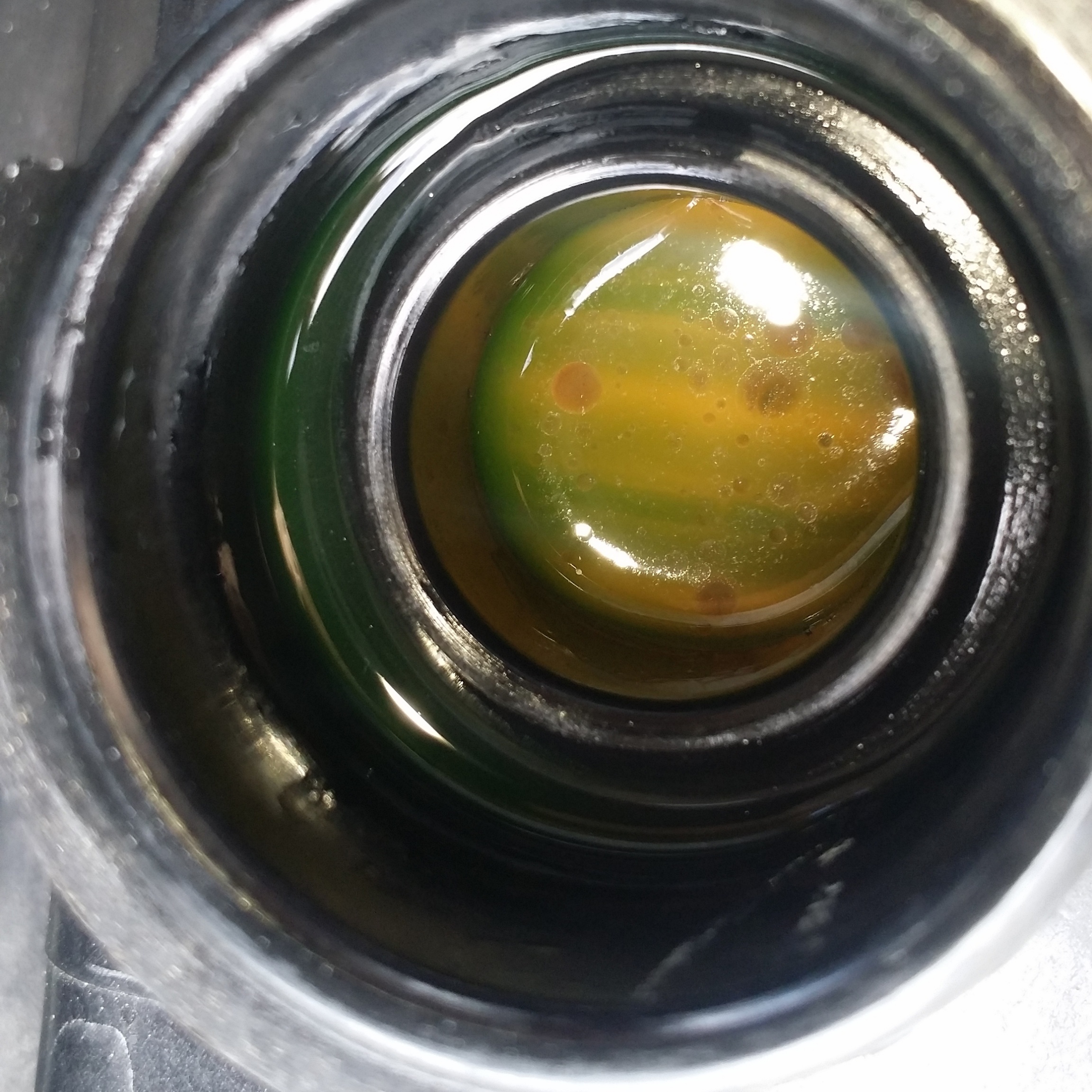

Upon removing the radiator I found this
(VIDEO)
I just assumed it was where I had been leaking from. Then it dawned on me. DUHHHH ATF fluid is the only thing that should be in there and if I don’t have an auto transmission then there isn’t any way I could have been leaking from there.

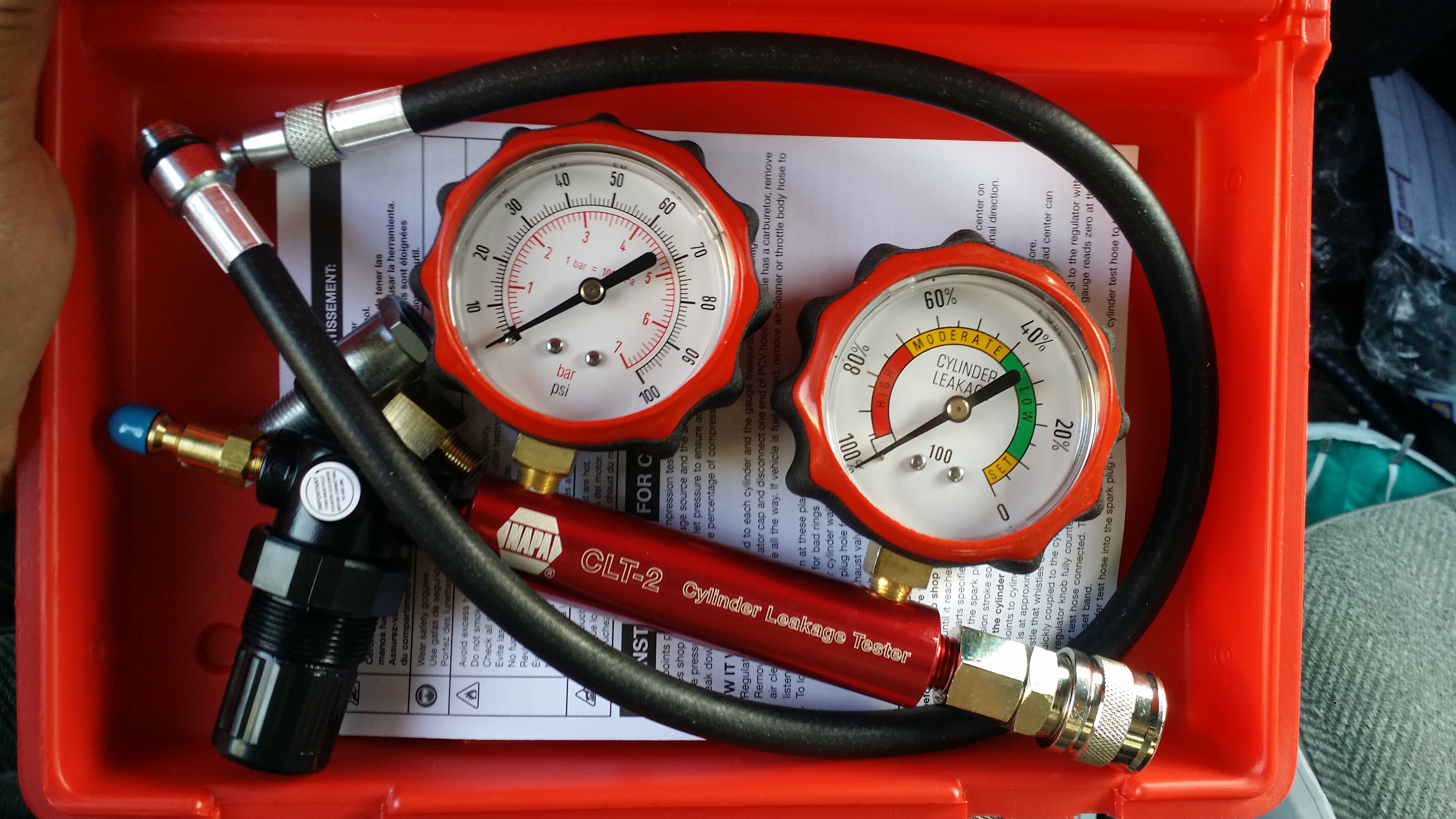

I ended up buying a Leak down tester which I soon learned was the wrong decision to make. DON’T GO CHEAP WHEN IT COMES TO A SERIOUS TOOL LIKE THIS! IT AIN’T WORTH IT!

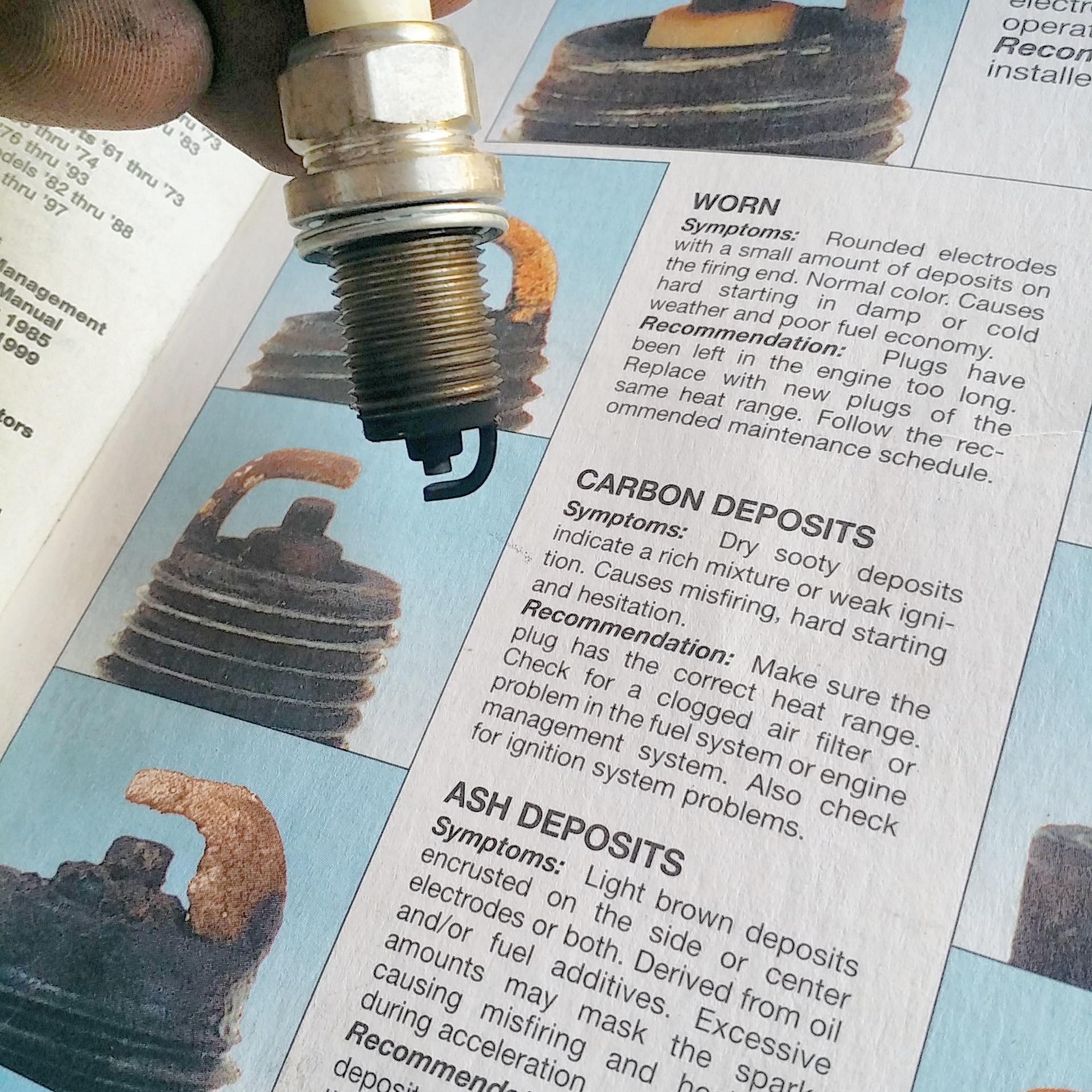

So I removed all 6 spark plugs and all 6 were covered in carbon build up. None had less than the other. My Haynes Manual pretty much described my engine symptoms perfectly. Misfire, hard start, rich mixture or weak ignition. ---- I dont know about weak ignition but everything else sounds like what im going through. ---- the Haynes manual recommends to make sure if the plug has the correct heat range. I don't remember gauging these plugs but they were supposed to be the correct distance another recommendation says to check for a clogged air filter or problem in the fuel system.
I mean you guys can read for yourselves in the picture.

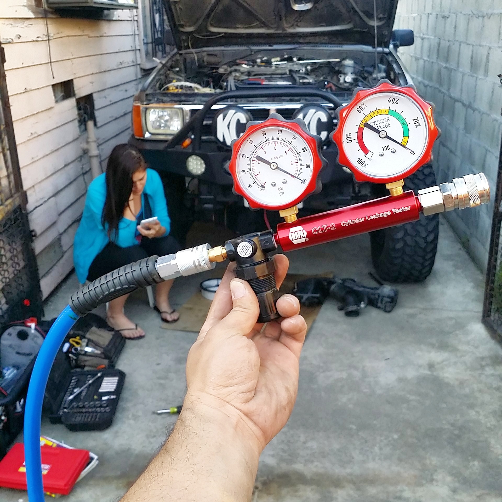

I ended up doing the leak down test on all six cylinders with the Harbor frieght tester. And came up with the conclusion that Cylinders 1 2 3 4 & 6 we're all ok. Number 5 on the other hand ended up being the defective one. You can clearly hear air coming out of the tailpipe. According to the instruction manual sound of air leakage from the tailpipe indicates a burned, stuck, or worn exhaust valve that is not sealing correctly. And yeah it was some crummy news at the time. But on the good portion about this news, none of my adjacent cylinders, such as #3, were affected. if that were the case I may have had A damaged head gasket. but since I only had air leakage coming out of cylinder #5 the chances were most likely going to be the exhaust valve was not seeling properly.

The next day I returned the cheap harbor frieght tester and BOUGHT THIS NICE NAPA AUTO PARTS LEAK DOWN TESTER. I Figured I might as well spend some good money on a quality tester So I did just that. $130 later I had myself a decent tool that would read correctly and be accurate in doing so! I figured if I was gonna have a tool tell me I have a busted head gasket or worse I would rather pay the extra money to make sure I wasn’t getting incorrect results.

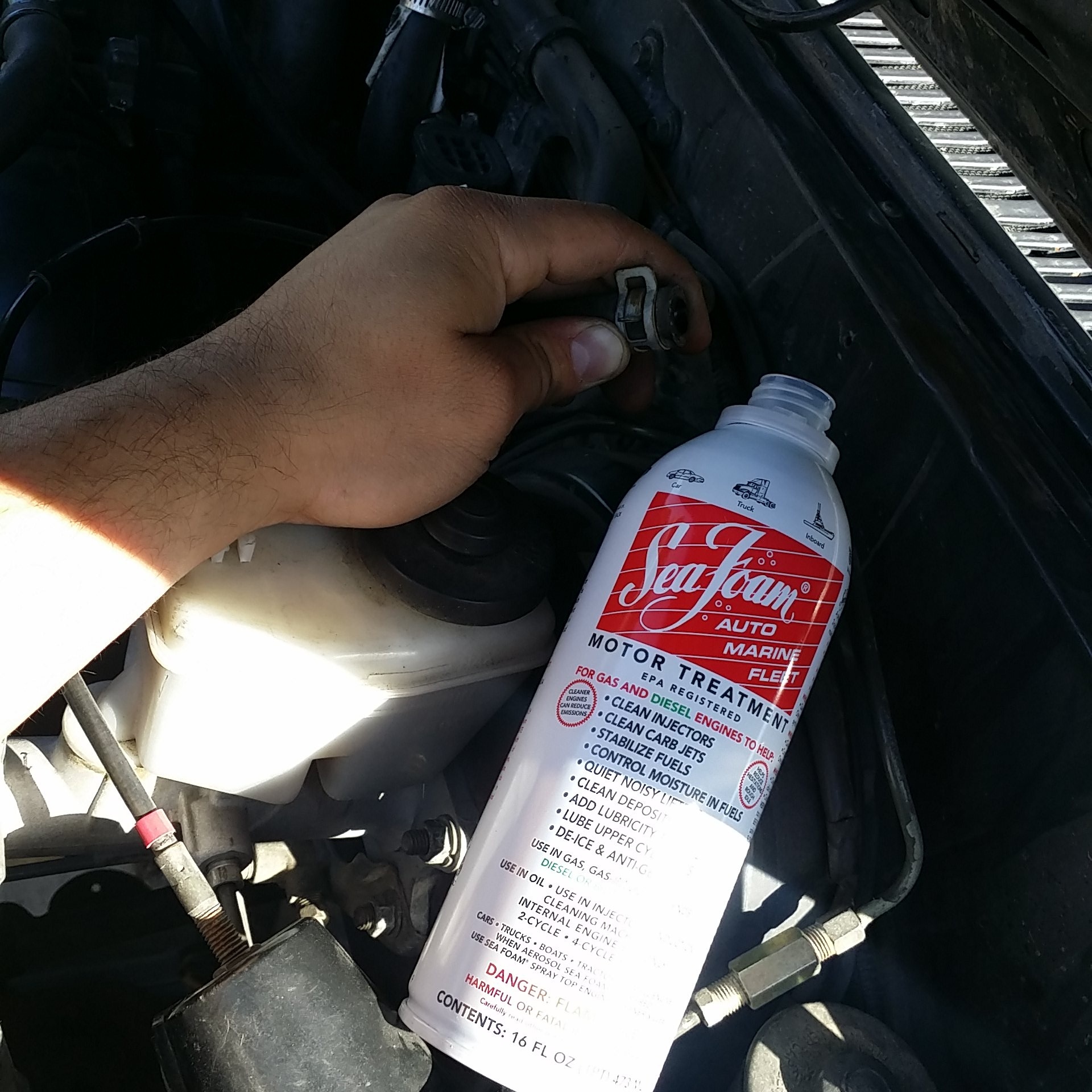

The following day I read that one of my instagram followers suggested I do the SEAFOAM treatment on my intake. He suspected it could be a sticky exhaust valve after seeing the picture of my dirty spark plugs. So I went ahead and did what he suggested.
Insert sea foam into vacuum line that leads to intake plenum.
After I did the seafoam treatment I figured I would do another leakdown test.

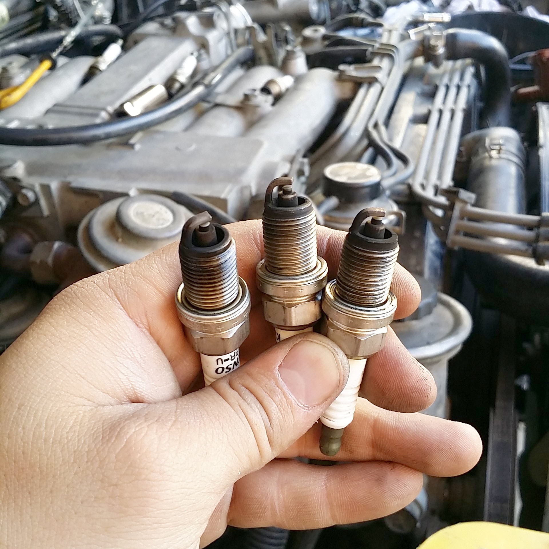

Here are sparkplugs for cylinders 5, 3, and 1. You can see they are much cleaner this time that I pulled them out after using the seafoam can. Not bad. That stuff really does work. I can’t believe I had never tried it before.

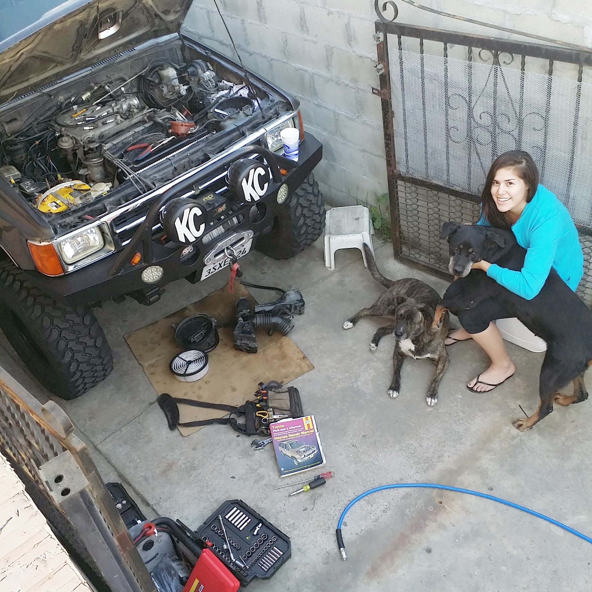

My girlfriend Faby came over to help me do my test since a Leak Down Test is more of a 2 person job on this particular vehicle. I can’t tell when each cylinder is on Top Dead Center while turning the pulley from under the truck and checking the screwdriver going upward from the top of the engine.
Way bigger quality difference on this NAPA Leak Down Tester vs the Harbor freight brand. This is definitely one tool you dont want to be cheap with. Do yourself a favor and pay a bit more to get yourself a quality tool because the cheap ones are just gonna give you bad readings and make you think youre gonna have to replace your entire engine like it did with me. Haha

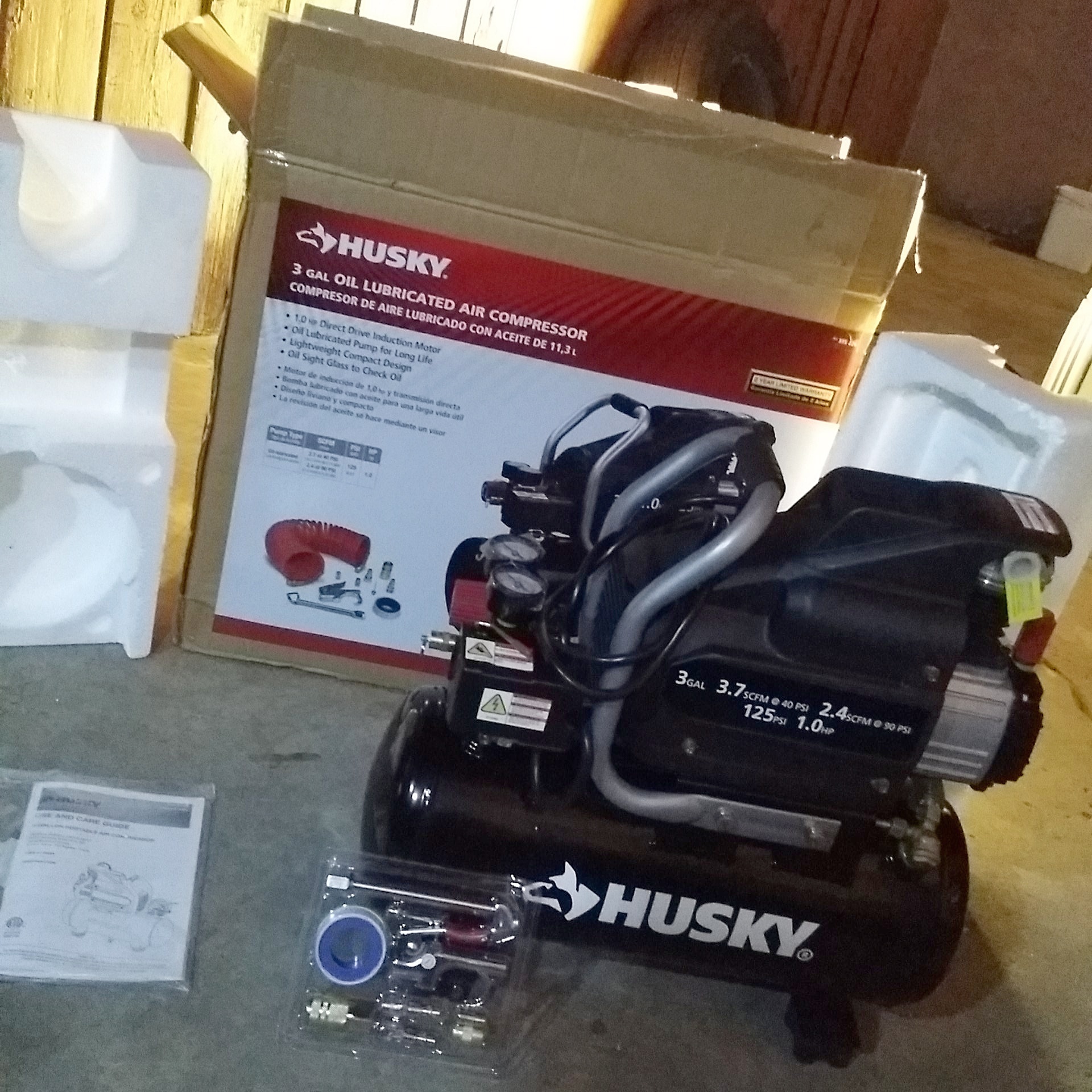

Dads air compressor took a dump on me. And won’t pump past 60psi. And his larger air compressor wouldn’t pass 65-70. So I had to buy one of my own now.
The unboxing of my new toy. I chose this one at Home Depot because it was pretty compact and I can actually strap this one down on the bed of the 4runner for off-road trips so I can air up the tires. And have it out if the way so the rest of my stuff can fit in the bed. I almost went with the porter cable brand. It was 30 bucks more and I know it is worth the difference but this one was more compact and is the reason I chose this one. It ended up being plenty strong enough to air up my tires. And to hold up 125 PSI for a good compression test
After 1can of seafoam on 2 different days. I re-tested all 6 cylinders and everything looks great
. I tested each cylinder 2 to 3 times each. And every time the cylinders came out to be within 10% difference of leakage from each other. Which is normal range. The manual states that if a cylinder has anywhere from a 15%-30% difference from other cylinders that I do have excessive pressure escaping. But mine are reading perfectly fine. Heck yea! Almost made me want to cry out of joy to get this news. Lol jk. But I was super happy! Here are the results to each test:
#1 @ 86psi was at 16% leakage
#2 @ 90psi was at 14% leakage
#3 @ 90psi was at 15% leakage
#4 @ 86psi was at 18% leakage
#5 @ 85psi was at 20% leakage
#6 @ 85psi was at 24% leakage.
At least now I know that I don’t have a head, head gasket, exhaust valve or any other major fix ahead of me.

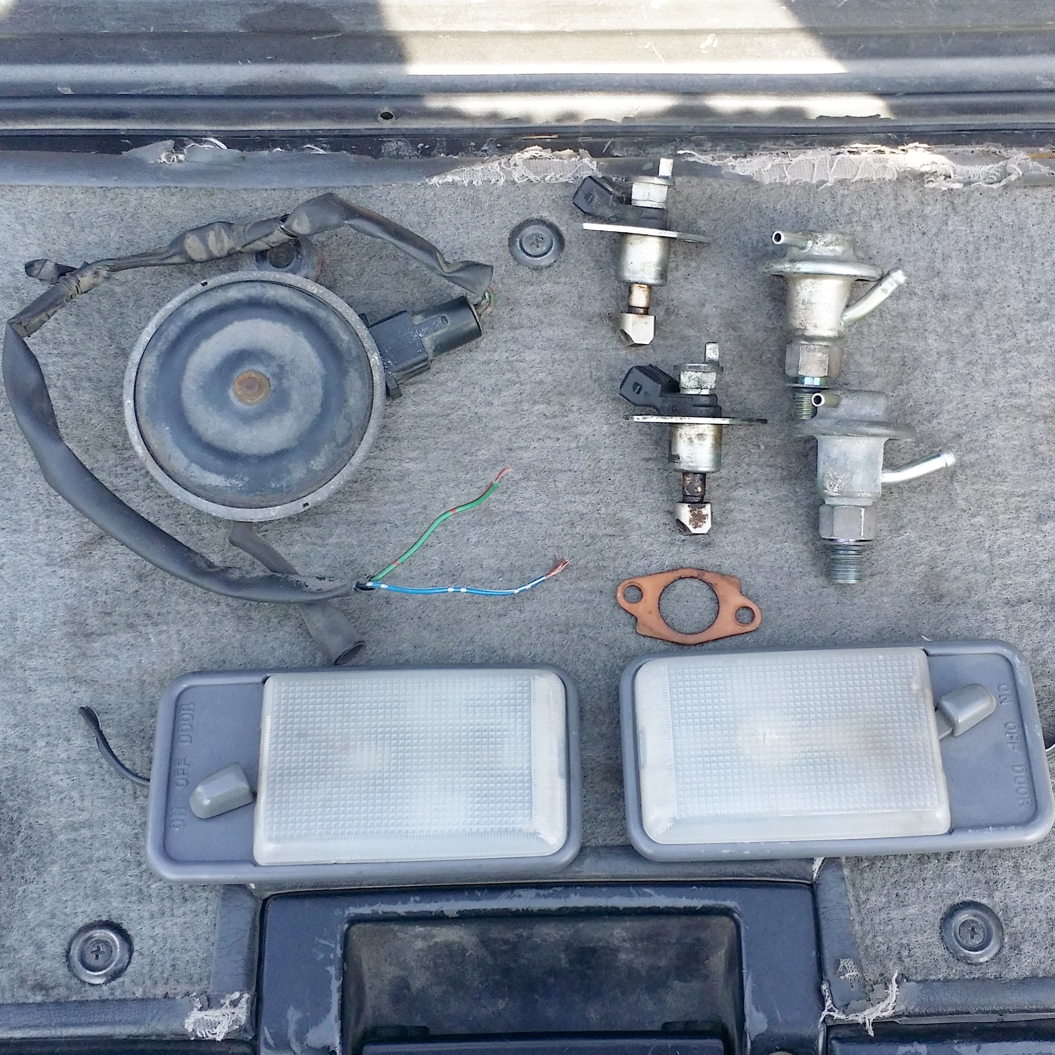

After treating it with the 2nd can of seafoam I went to the local pick your part and got a huge find.
I found about seven 1990-1995 4runners. So I took off 2 fuel pressure regulators, 2 cold start injectors, and 2 interior dome lights for the future bed LED lighting modification that I plan to do to replace the weenie light that I currently have in the back there. And a replacement horn that has the 2 wires vs 1 like the majority of the newer vehicles have.

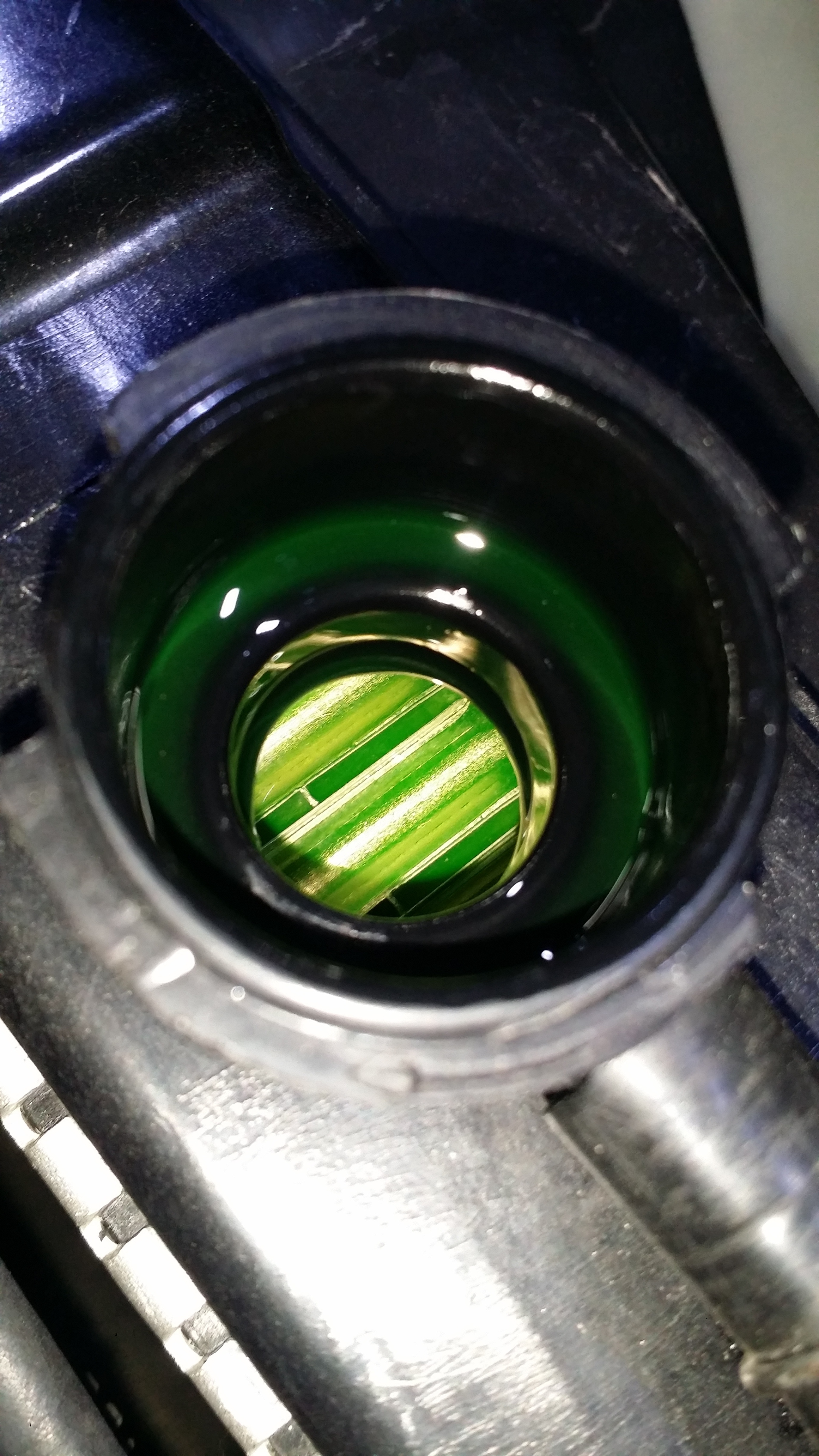

Hey guys. IT has been quite a while since the last update and i'll have you know that everything seems to be up and running well. Whatever it was im guessing the seafoam unstuck. but it runs much better again and my MPG is back up to normal.
Here is a picture of the radiator fluid after all these weeks. It looks nice and clean. and I haven't overheated at all.
