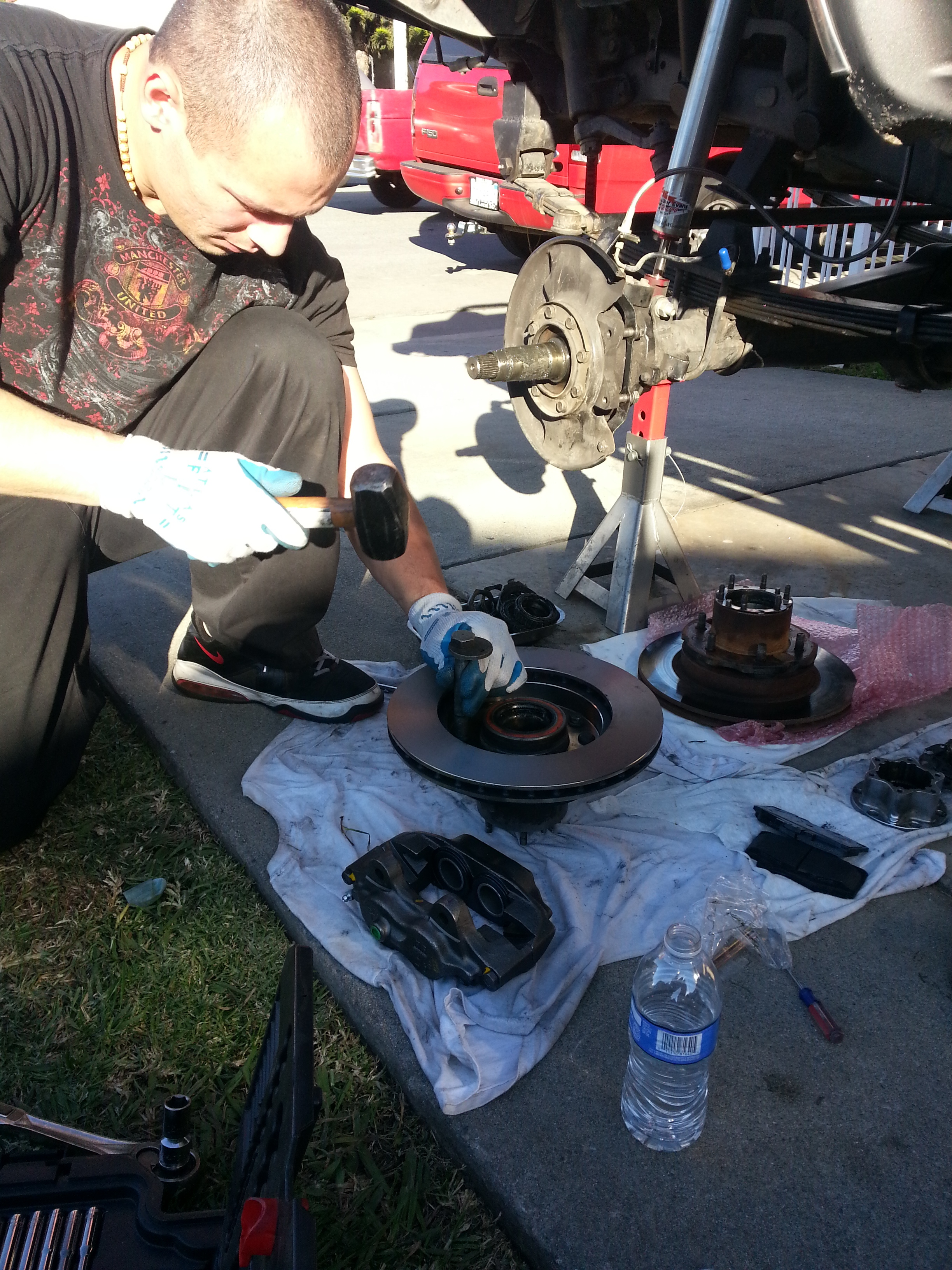

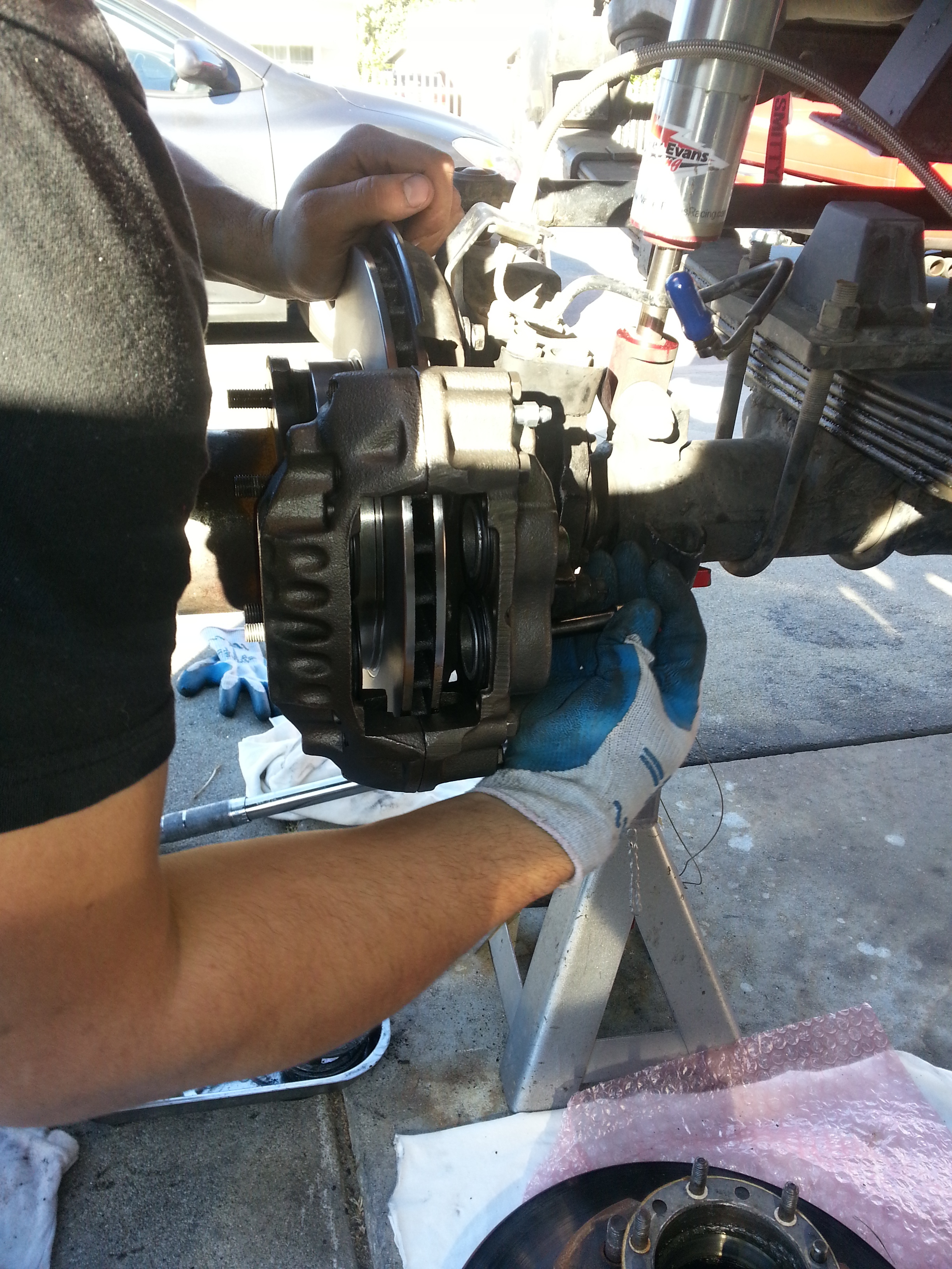

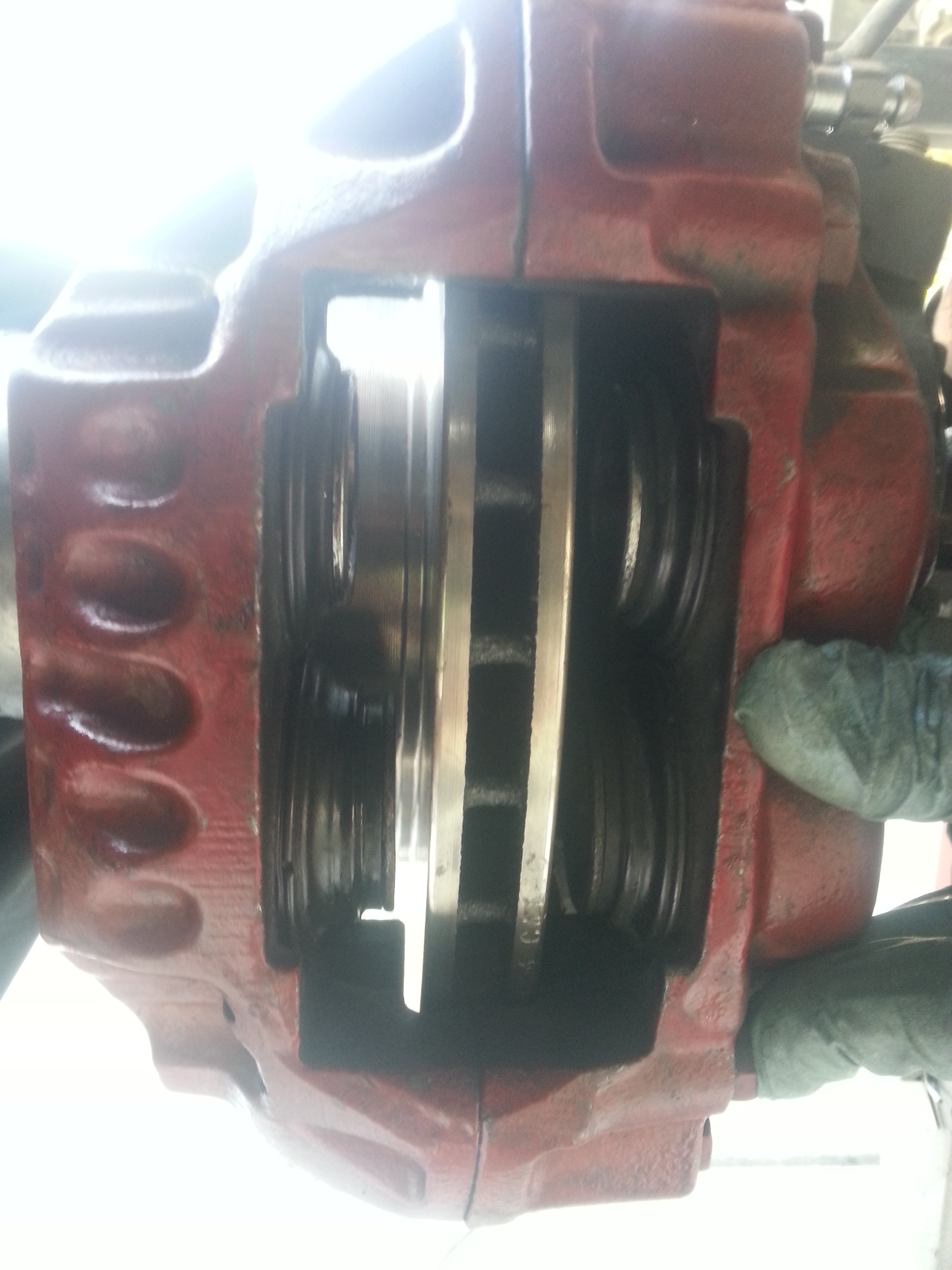

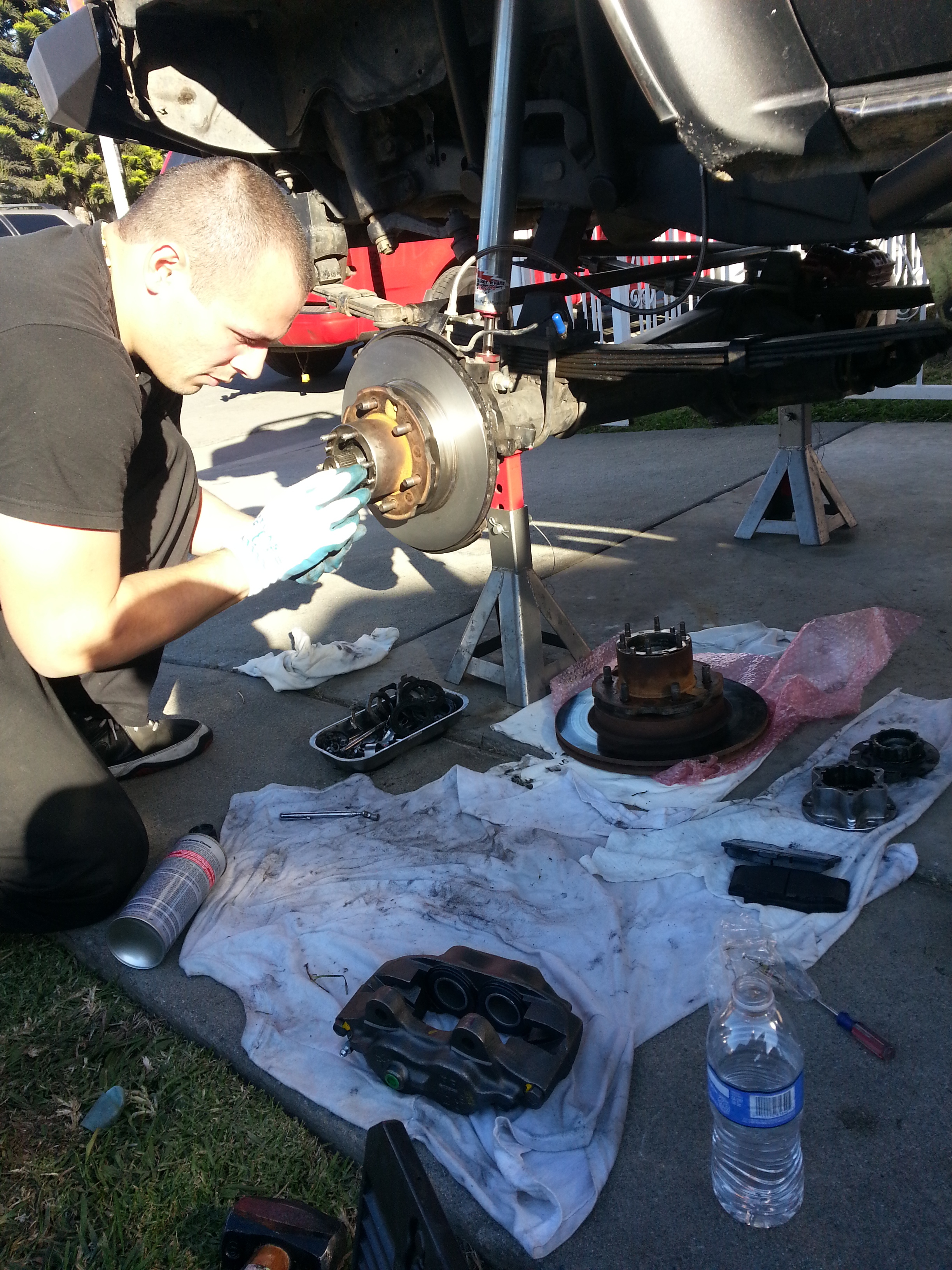

Remember where i left off on with my troubleshooting post. i replaced the rotor on the driver side. But there was still a grinding noise was still there. That is pretty much where i left off at. When i got home from my school orientation i ran into my friend who was checking out my truck. He worked for Toyota and was recently laid off. and i asked him to take a look at my brakes and we found that the Inner wall was scratched now. (remember before the outer wall was completely scratched on the last rotor) but this time it was on the inside. and we found that my rotor was actually rubbing on the caliper itself. NOT THE BRAKE PADS. This was odd because i didnt have this problem with the old rotor. So I now had 2 problems on my hands. 1) the rotor rubbing on the wall of the caliper, and 2) irregular wear and tear on brake pads.
I jumped on Yotatech and after reading your replies and Toyotech's recommendation to remove the caliper and check all 4 cylinder I did that. I removed the caliper and pressed on the brake pedal 3 times but i couldnt really tell if they were off with the brake pads there. So i pushed the cylinders back in, removed the brake pads, then put the caliper back on. When i pressed it 3 times i noticed that all 4 cylinders were off. None were in sync with each other.
As you can see one of the pistons on the side that was causing all the wear in my rotor is still pretty much pushed in. The other 3 are all pushed out at different lengths. So this confirmed Toyo's theory. The caliper was bad. Considering i didnt want to bother with rebuilding the caliper i decided to just swap this one out for an Autozone one. when i put it back together and bled the line i found that the rubbing was still there. i didnt even have the brake pads on at the time. Then as i turned i saw that the rotor was rubbing on the same area as the previous caliper.
Here is where it rubbed:
There isnt very much space on either side of the rotor to the caliper walls but either way it should not be rubbing. So I call called my girls uncles shop and explained to the them that i must had gotten the wrong rotors because these definitely wern't the same as the ones all-pro provided to me in the kit. So they told me to come in saturday morning and they would help me out.

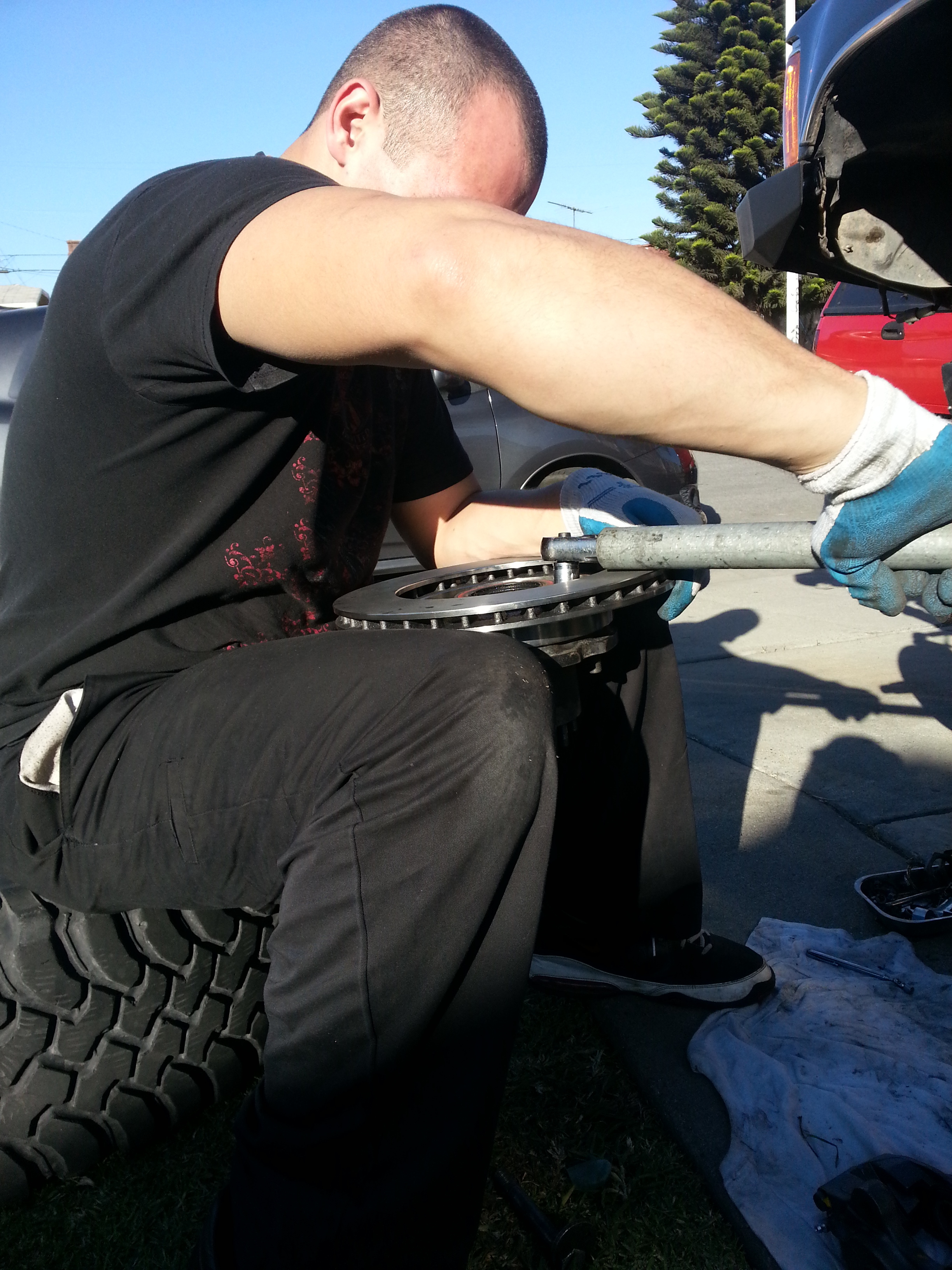

So i removed the driver rotor and took my passenger one to him as well. Considering the rotor was only rubbing against the caliper wall about half of a 1/16" we just machined the inner wall of that rotor(obviously at no cost to me because this was their fault). After Machining the rotor i brought it back home and installed the rotor and It fit like a glove. It was still close to the caliper wall but it didnt rub at all anymore.
Actually here are some pix of faby took. Just for the hell of it. She kind went picture crazy but i think thats what made it fun. Gotta say that 75 degree weather that we had yesterday was pretty nice too. perfect weather to work on the truck.
tightening the 2 rotor to hub bolts

setting the torque rating for the 54mm nut in the hub. and Faby making a funny face! lol

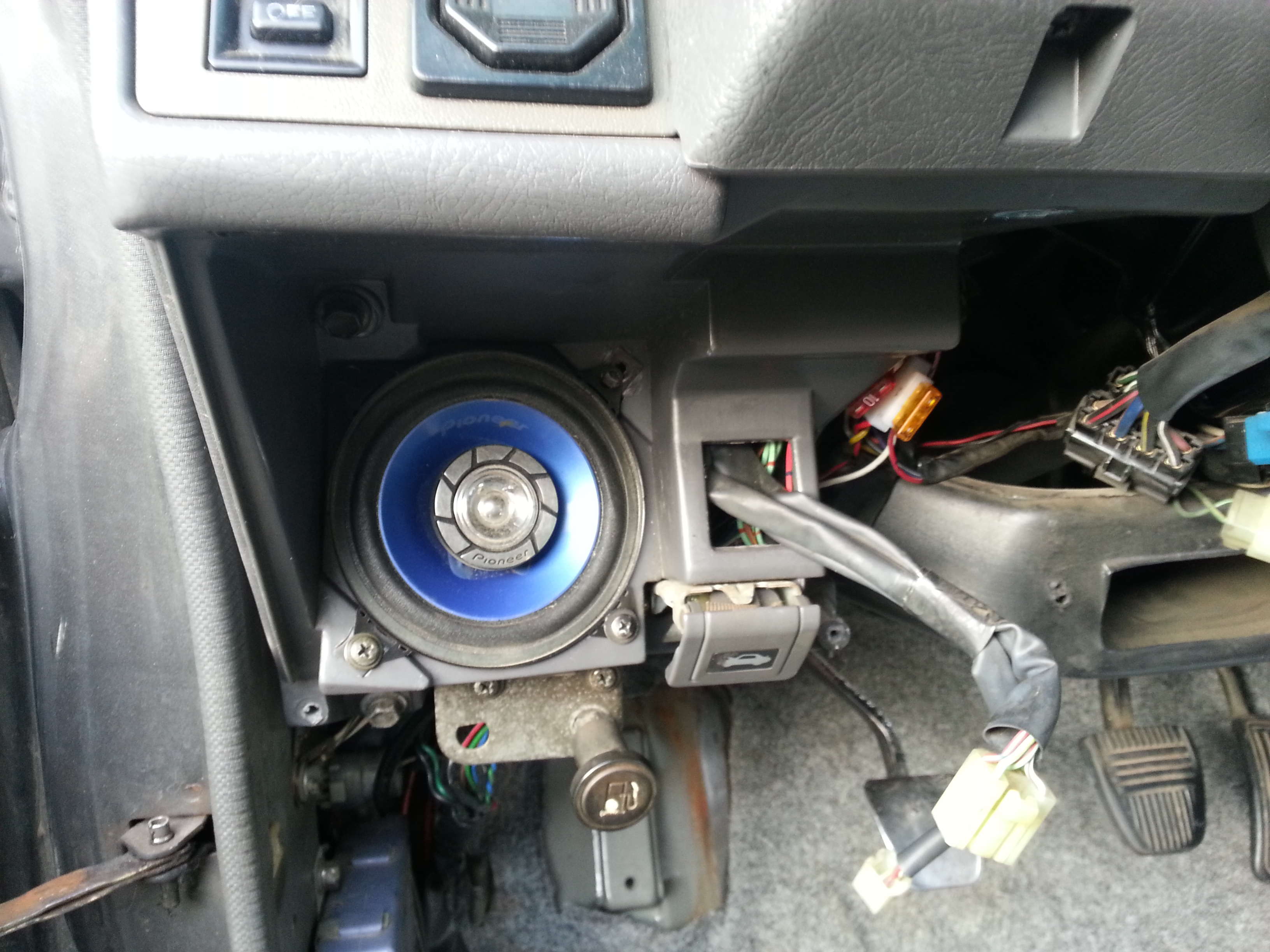

I cant believe what i have been missing out on man. I had been so conservative with my $$$ due to upgrades, and repairs to the cars that had totally forgotten about getting the truck a decent stereo system. The thing sounds awesome. And best of all NO cracking sounds at high volume! woot. Now i can tune out those A-holes that pull up next to me with their annoying rap music and tone them out with my heavy metal/hardcore music! Nothing better then a big ol' monster truck pulling up next to your low car blasting some loud metal!
Best part about it is that this stereo has color changing oprions. So i was able to match the color to my White LED dash lights. Woot Woot!
Here is the finished job.
