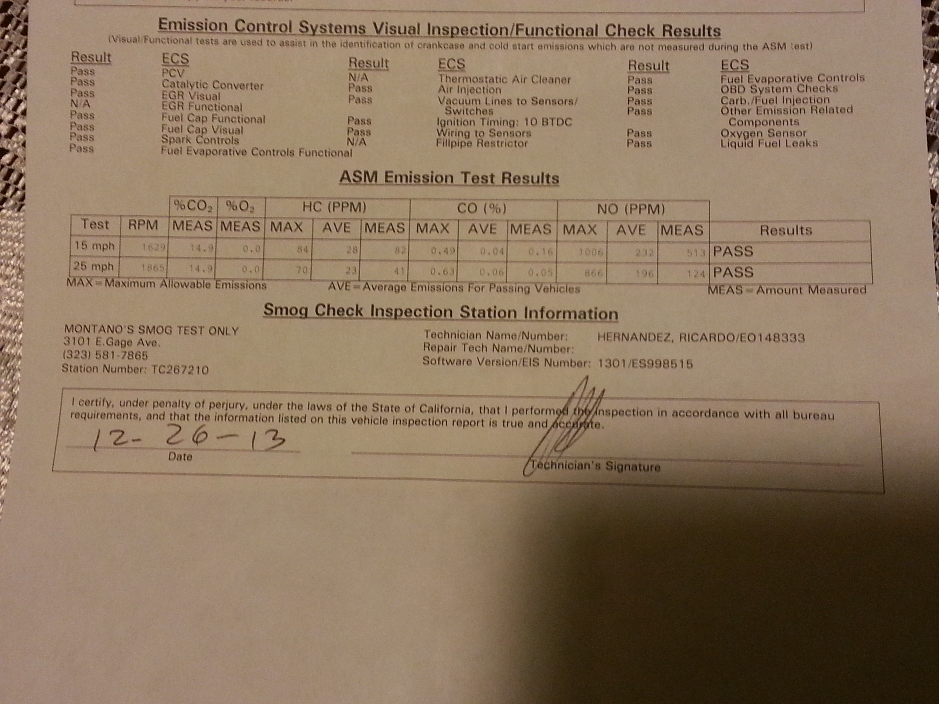

I drove the truck around for about 40-45 miles since sunday and i havent had any problems at all! no Check Engine Light has came on either. I had planned to get my catylic converter, muffler and piping done all over again. but i figured id give it a chance before spending $375 on all that stuff again. So i took my truck to the STAR smog check location(my usual guy) taking a chance that it might not pass. I figured if it doesnt pass for smog reasons then i can always get he cat, muffler and piping afterward and pass it on the retest but apparently my 1.5year old exhaust stuff was still working properly enough to pass the test on the first time around! WOOT WOOT! This news made my year! lol It was actually funny. i saw the 3 guys looking at my truck puzzled. and i asked them "whats wrong" they replied you have a vacuum leak somewhere and were trying to find out where from. I got up to see what they were talking about. then i saw what it was. It was my clogged steel vacuum line. i bypassed this line just by using a longer rubber vacuum hose. and explained to them why it was the way it was. they looked at me wierd then i explained to them that i have done everything to my truck. and previously had a code for improper vacuum lines n stuff. then took the vacuum pumper to the lines to find out it was clogged. anyway they took my word for it and it passed on the first try. I didnt lie to them. It wasnt passed illegally either. I just bypassed one steel line and connected it directly. I explain this on the first vacuum hose video if you watched it. Anyway Here are my results if you're curious to see.

Anyway Good night everybody. I'm definitely gonna sleep well tonight now that this STAR smog check nightmare is over with!

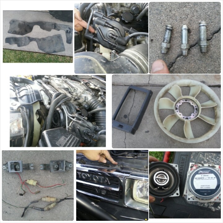

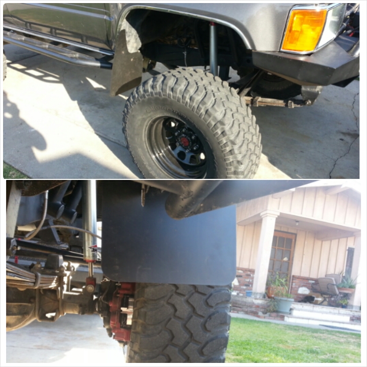

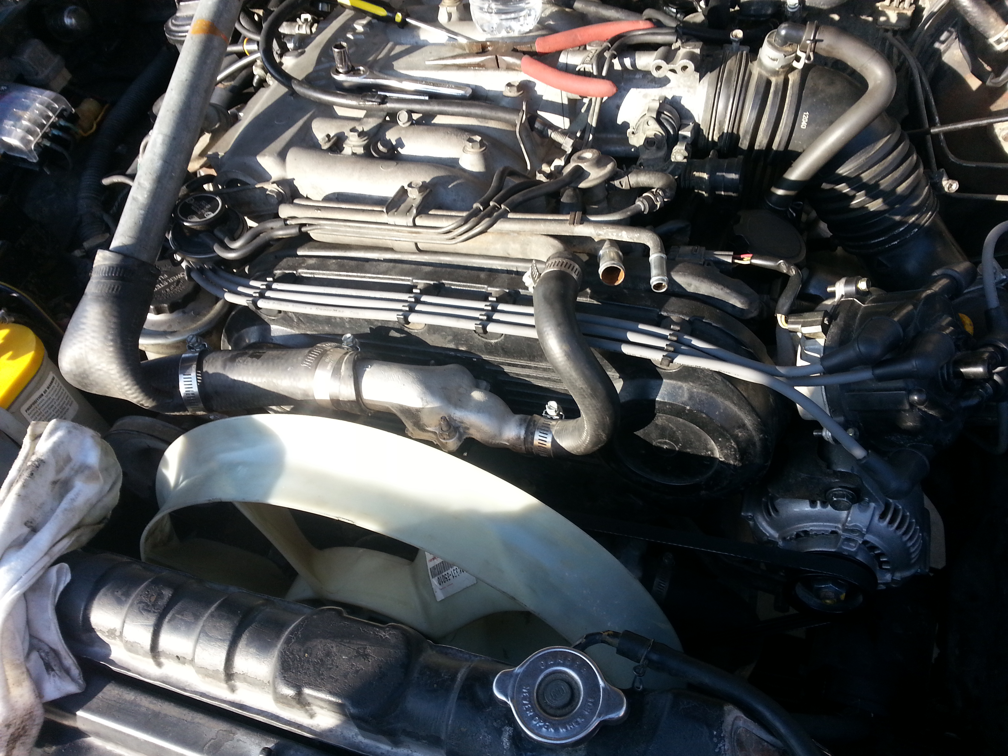

Had a busy day today. I wanted to make sure i was able to get a few things out of the way before our Angeles Crest off-raod trip this weekend. Not gonna be a hard trip, but i just wanted to a couple of things done that i had been sitting on for a while.
i first began by finally getting the front mud flaps cut to shape and installed. I Have been lucky so far not to get any tickets for not having any(especially with the wider wheel base due to my spacers) These crappy plastic mud flaps were bought from AutoZone for about $6-7, They are very cheap. I actually wish i would have returned them and just removed some thicker rubber mudflaps off a junk yard truck, but these will work for now. I'll use them till they break or rip.

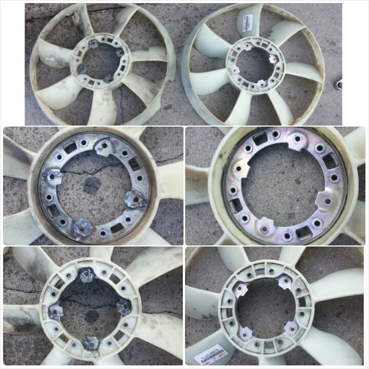

2nd thing and probably the most important replacement was my engine fan. As you read in my Knock Sensor write up i mentioned that 2 of the 4 metal tabs broke on my original fan. I had my dad weld them back on. But the fact that the metal has a bunch of small brackets that hold onto the "PLASTIC" fan i was really worried about the plastic fan strength being compromised where the center metal ring and plastic are held together. I didnt want to leave it to chance. With my luck the fan would probably shatter in the engine lol. Also the fan was already broken since i bought the truck.
Old fan on the left and new fan on the right. You can see where the tabs were welded back on.
Installed the fan. Then the fan shroud.

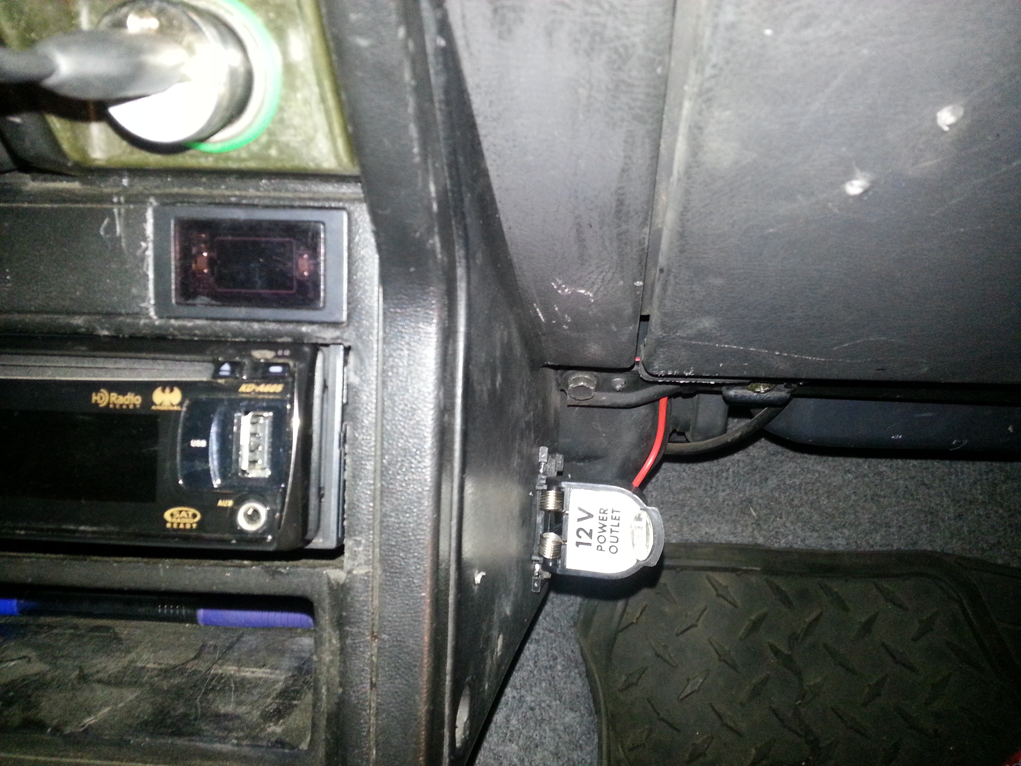

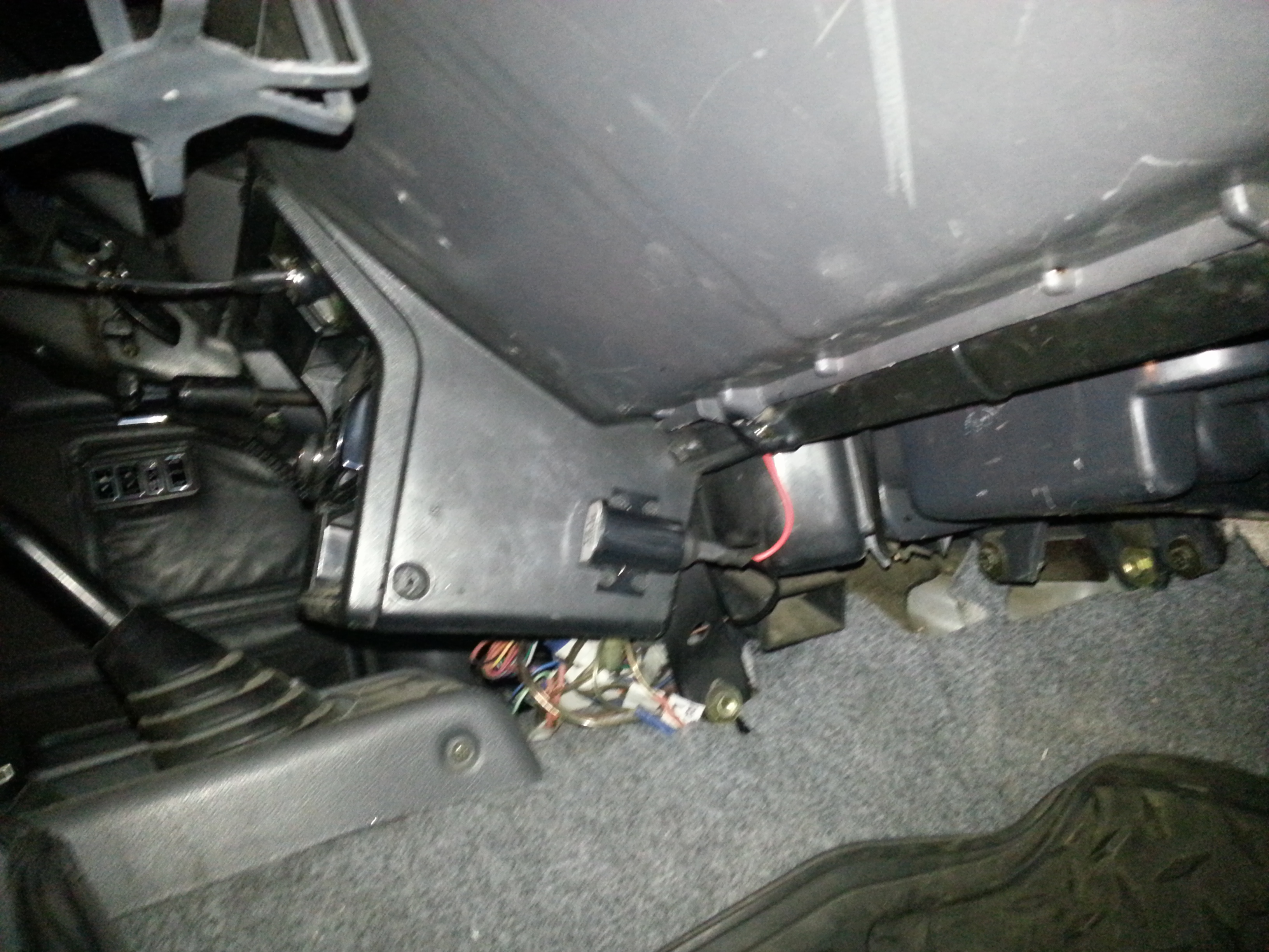

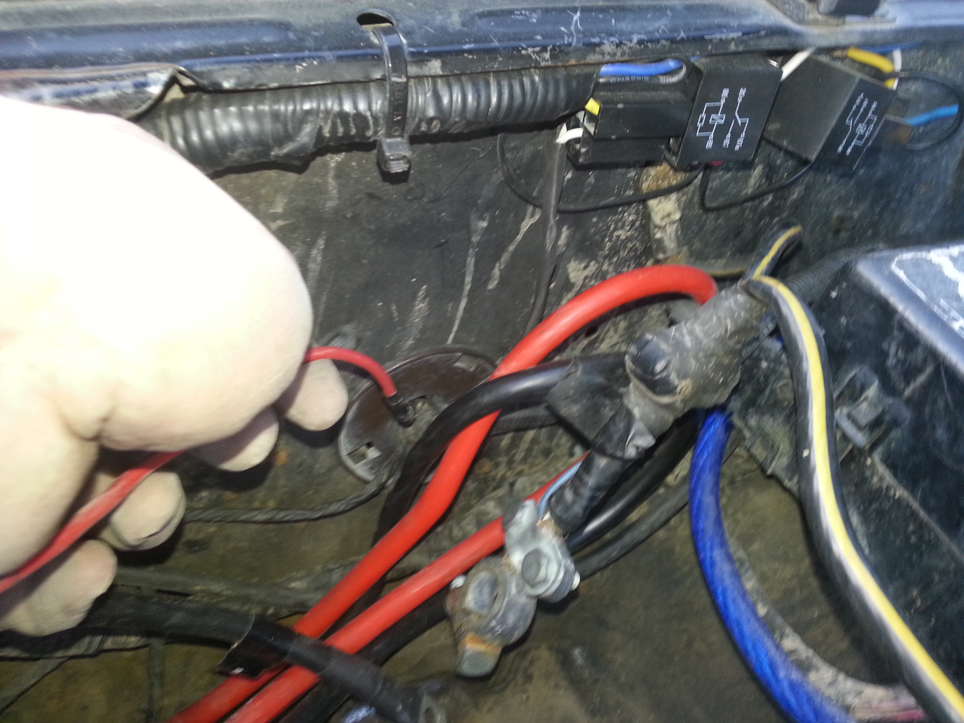

Last thing i did today was finally get to installing my "constant hot" extra 12v outlet! I have been wanting this done for a while but i never got around to it. This is one thing i absolutely need for my camping trips. with this i can now keep my truck turned off and still use the outlet to charge my phone while i sleep at night. Woot WOOT! I didnt only want this for camping reasons though. I use lots of electronics and i only have one 12v outlet. Now that i have this i will be able to charge my own phone, my girls phone and my iPod on the stereo usb port all at the same time. This one is definitely a mod worth looking into for anybody that hasnt done it yet.

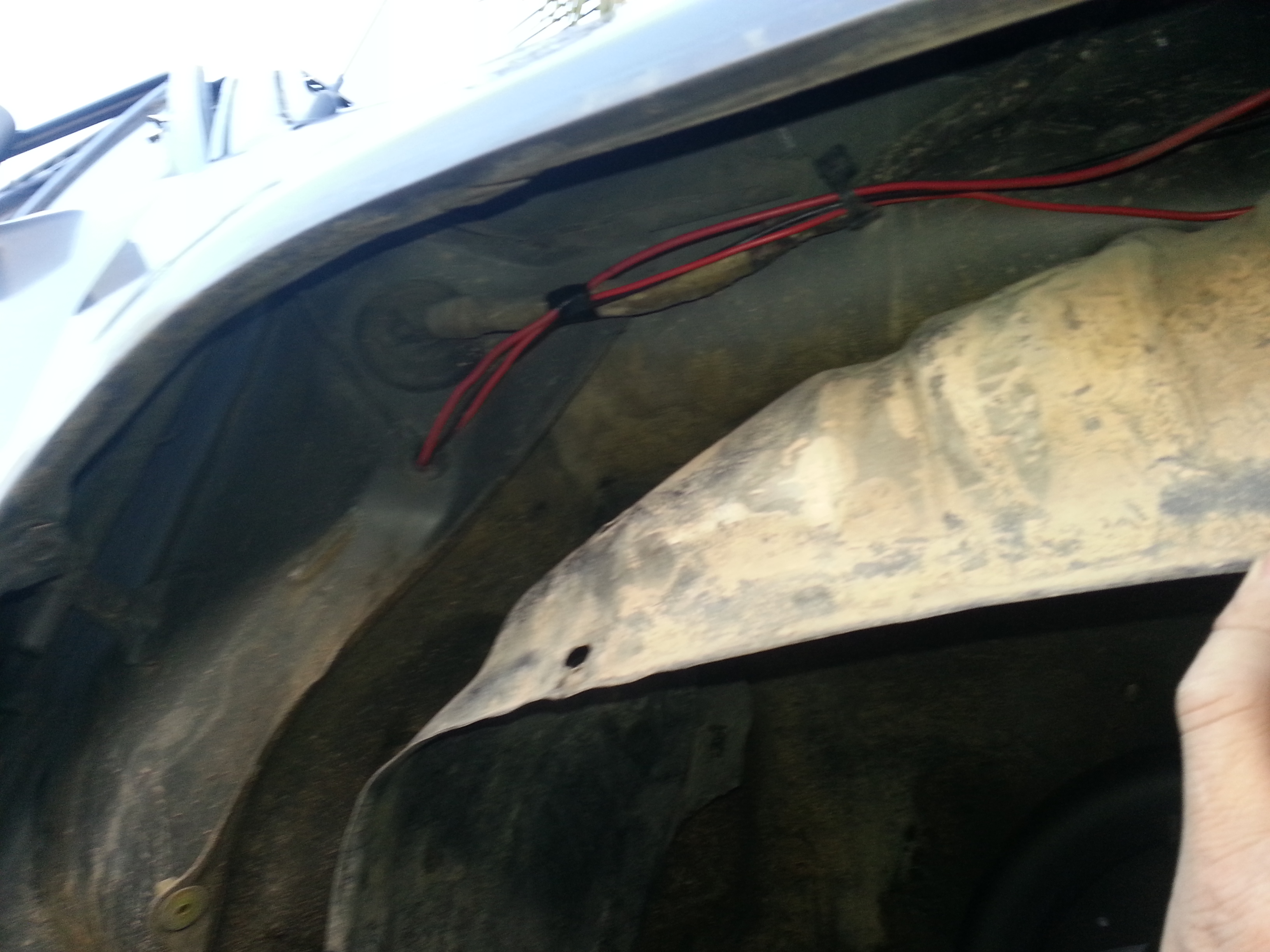

I ran a red 12 gauge wire from my extra fuse block on my engine bay. Ran the wire through the passenger fender wall where the battery sits at.

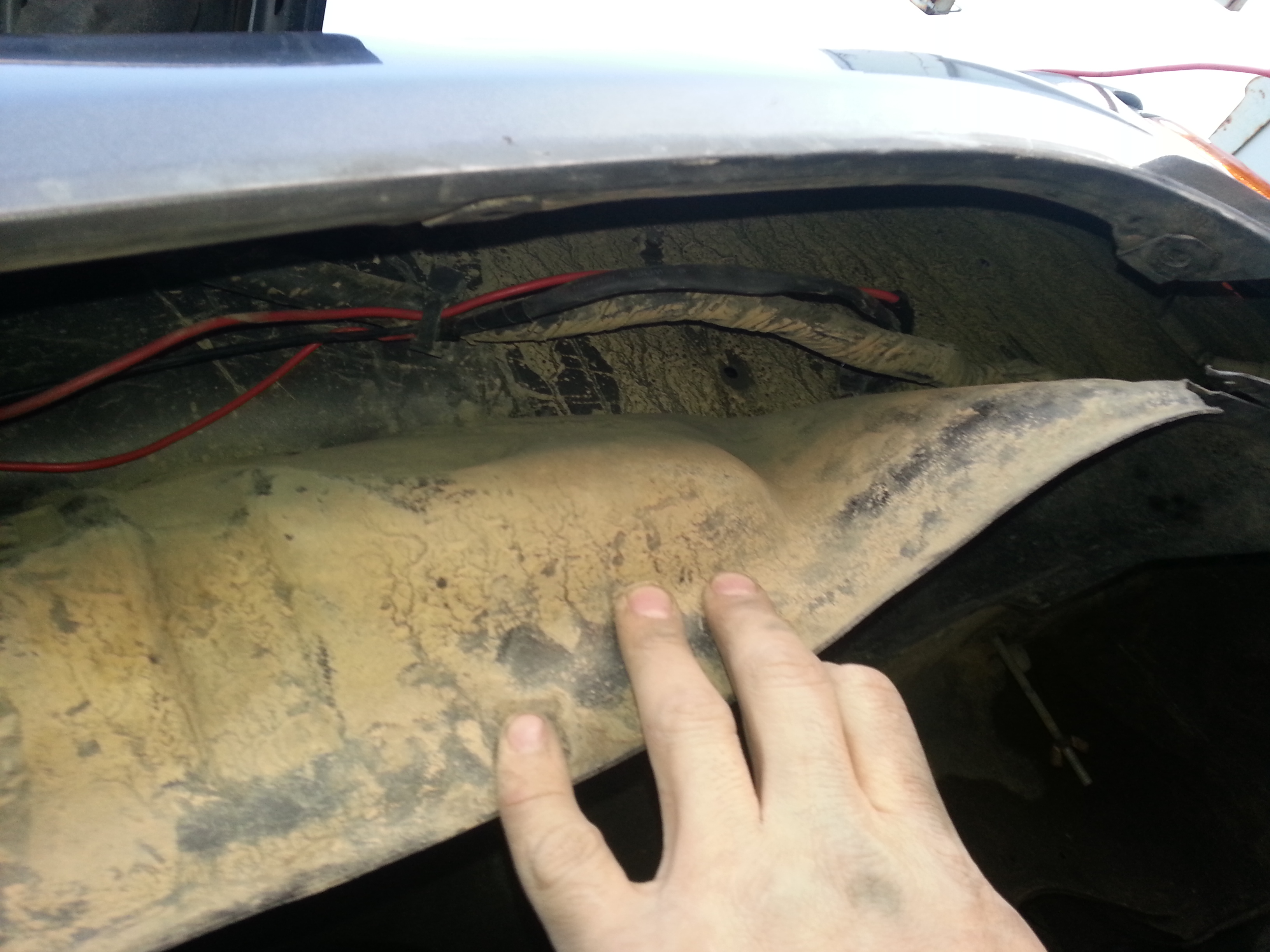

ran the wire through the existing plastic loops that hold my headlight/turnsignal lights up toward the top of the fender.
Across the fender and into the cab using the same hole where the antenna goes into.

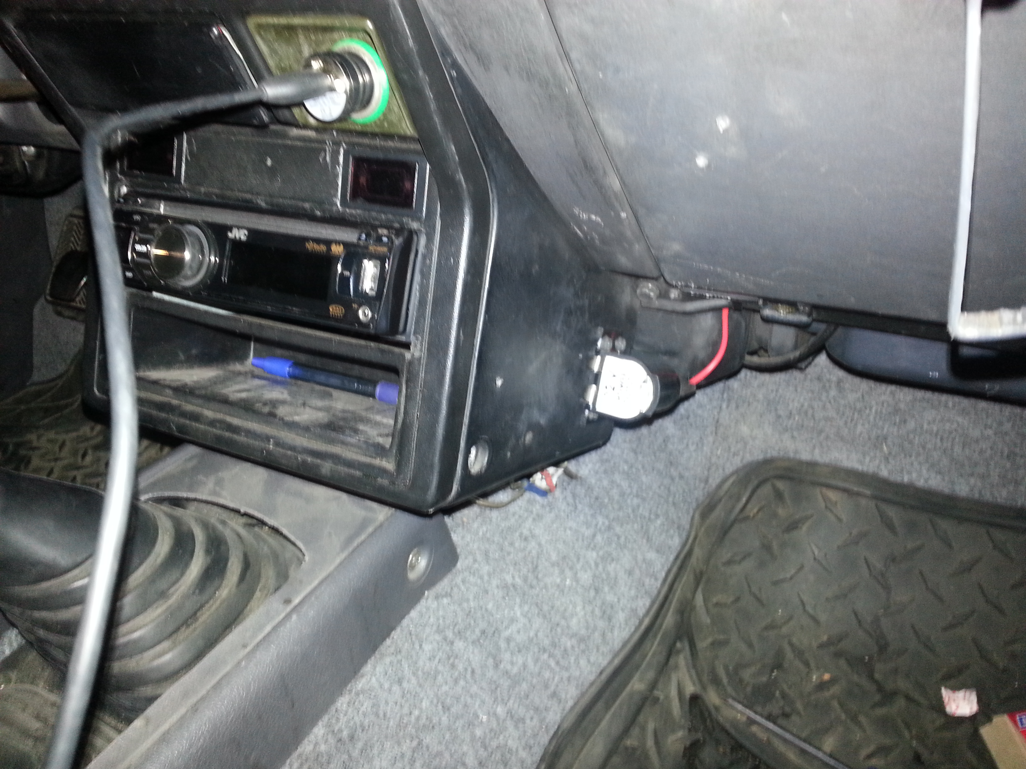

Ran the single wire across the bottom metal rail where the glove compartment box screws into and mounted the new outlet to the side of the stereo bezel.
