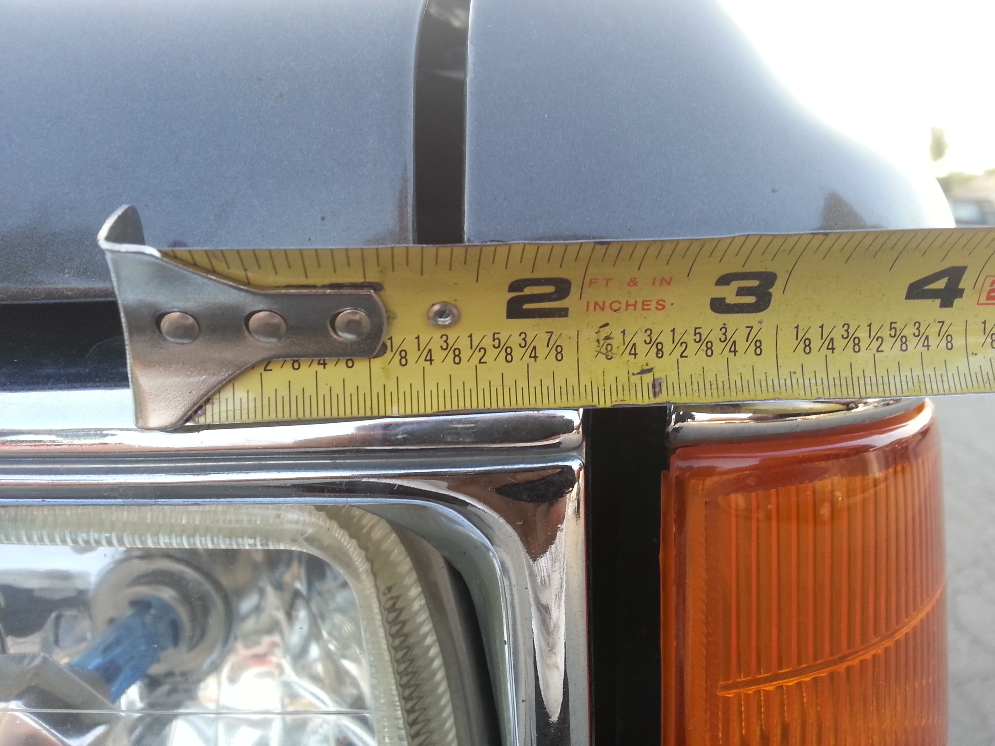

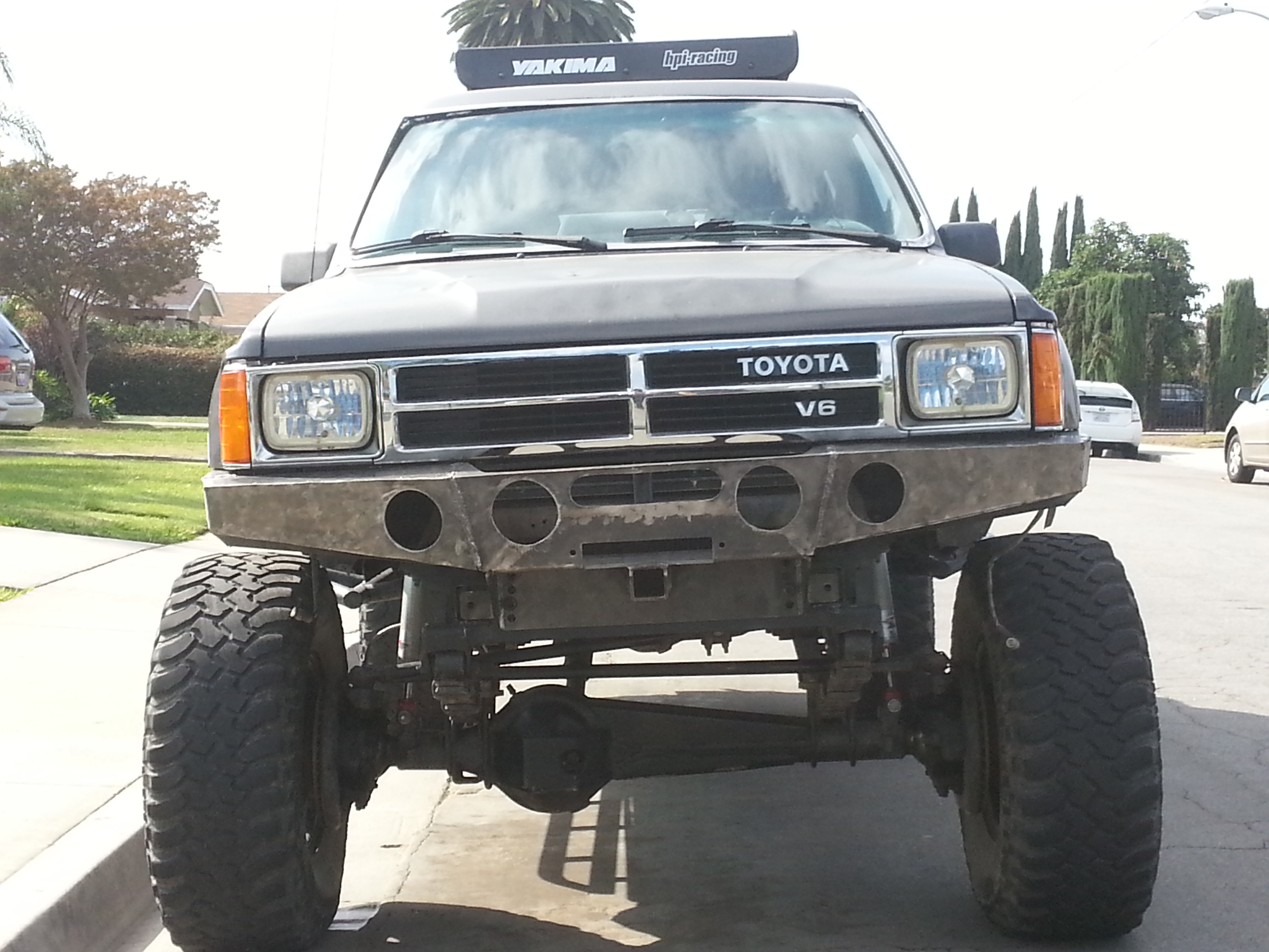

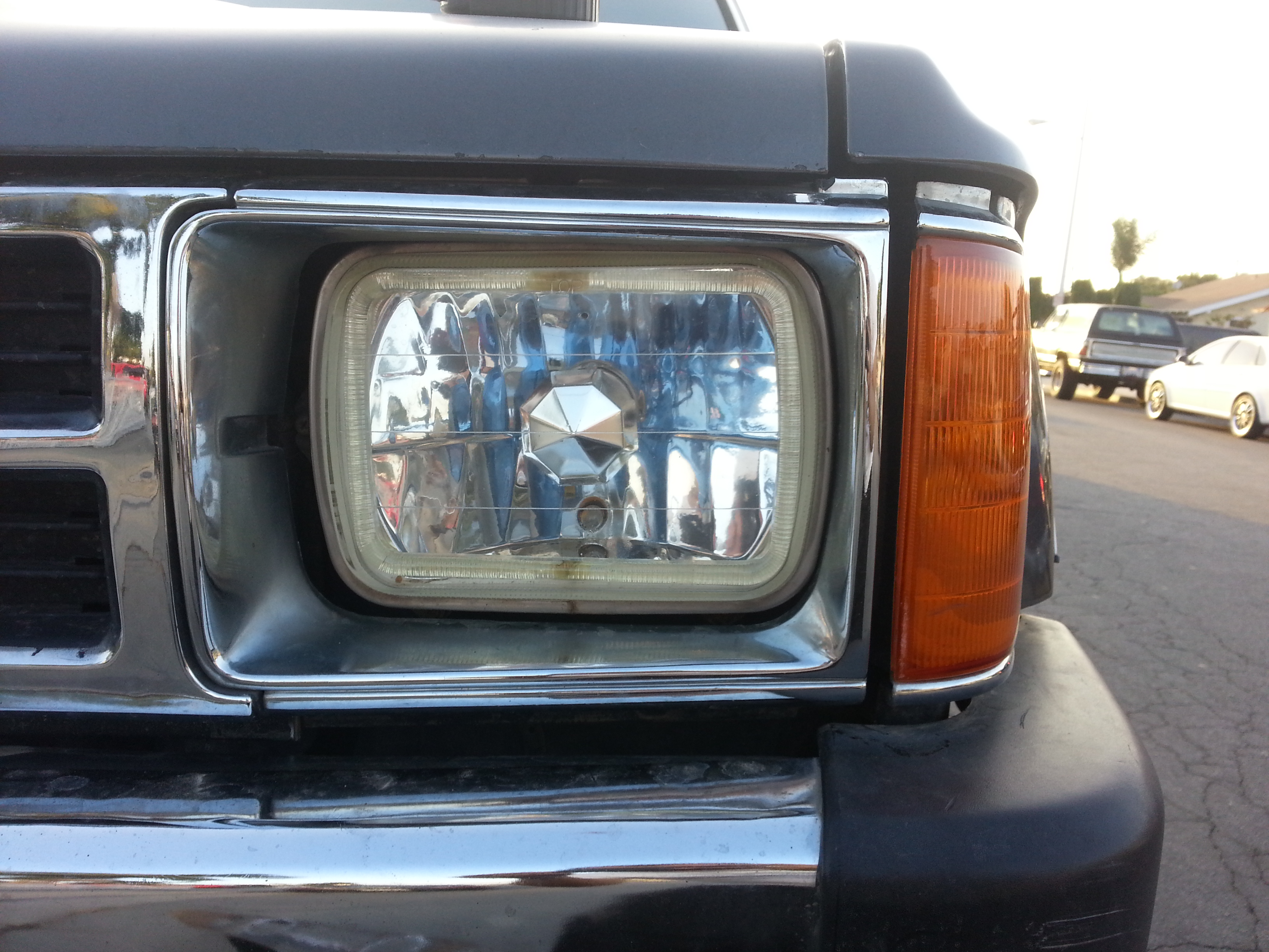

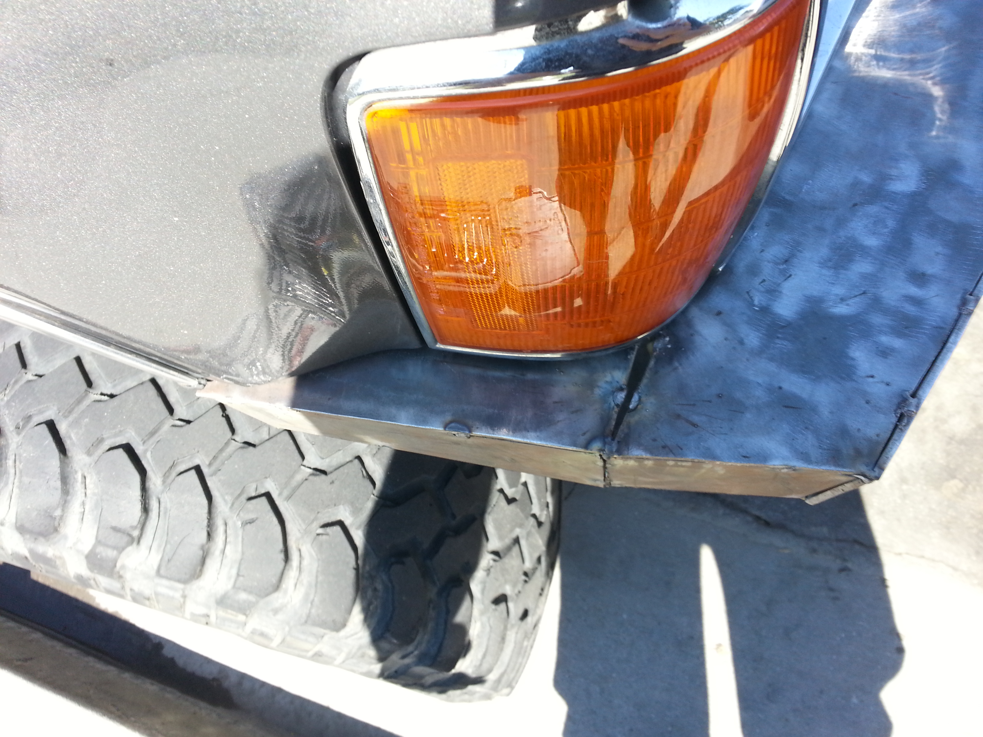

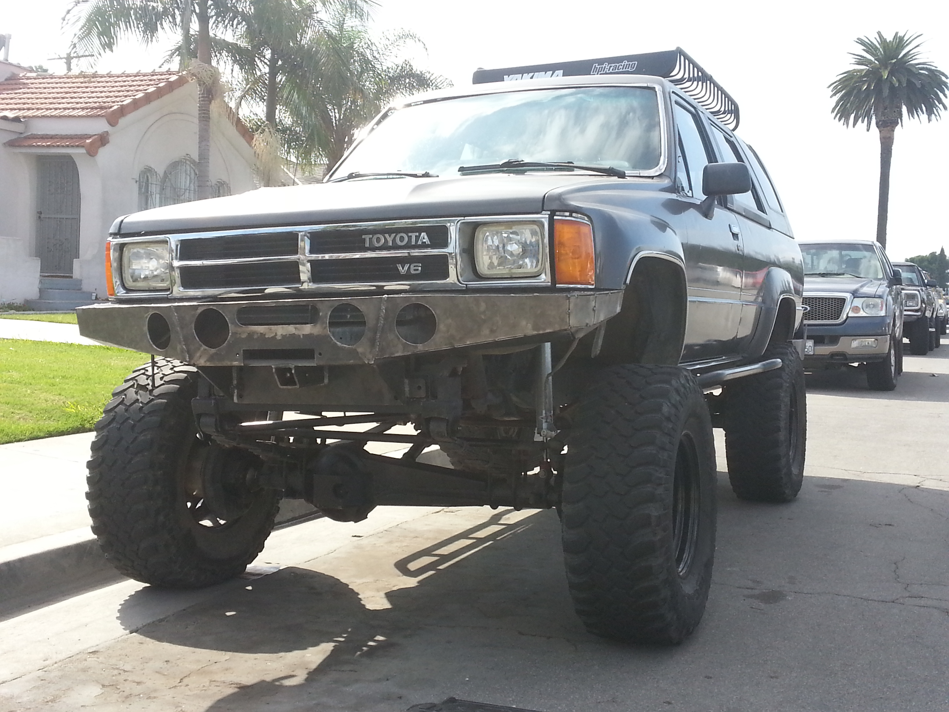

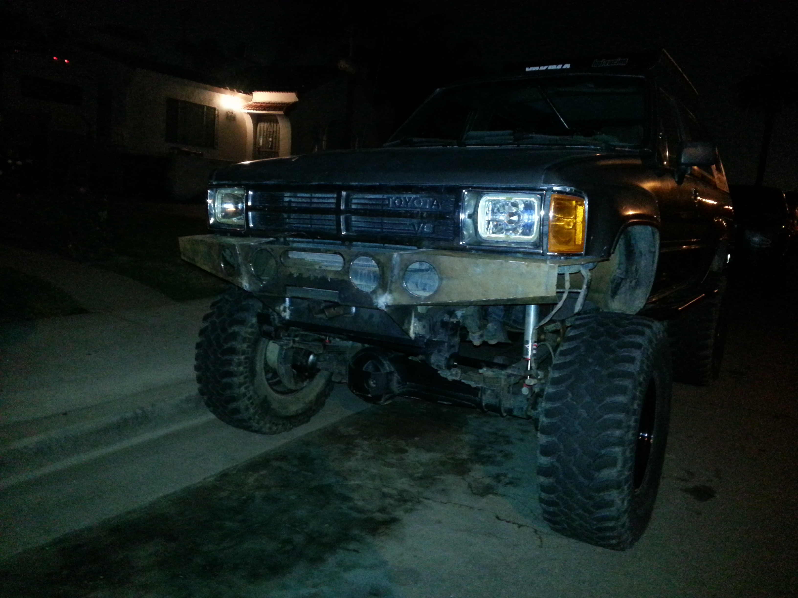

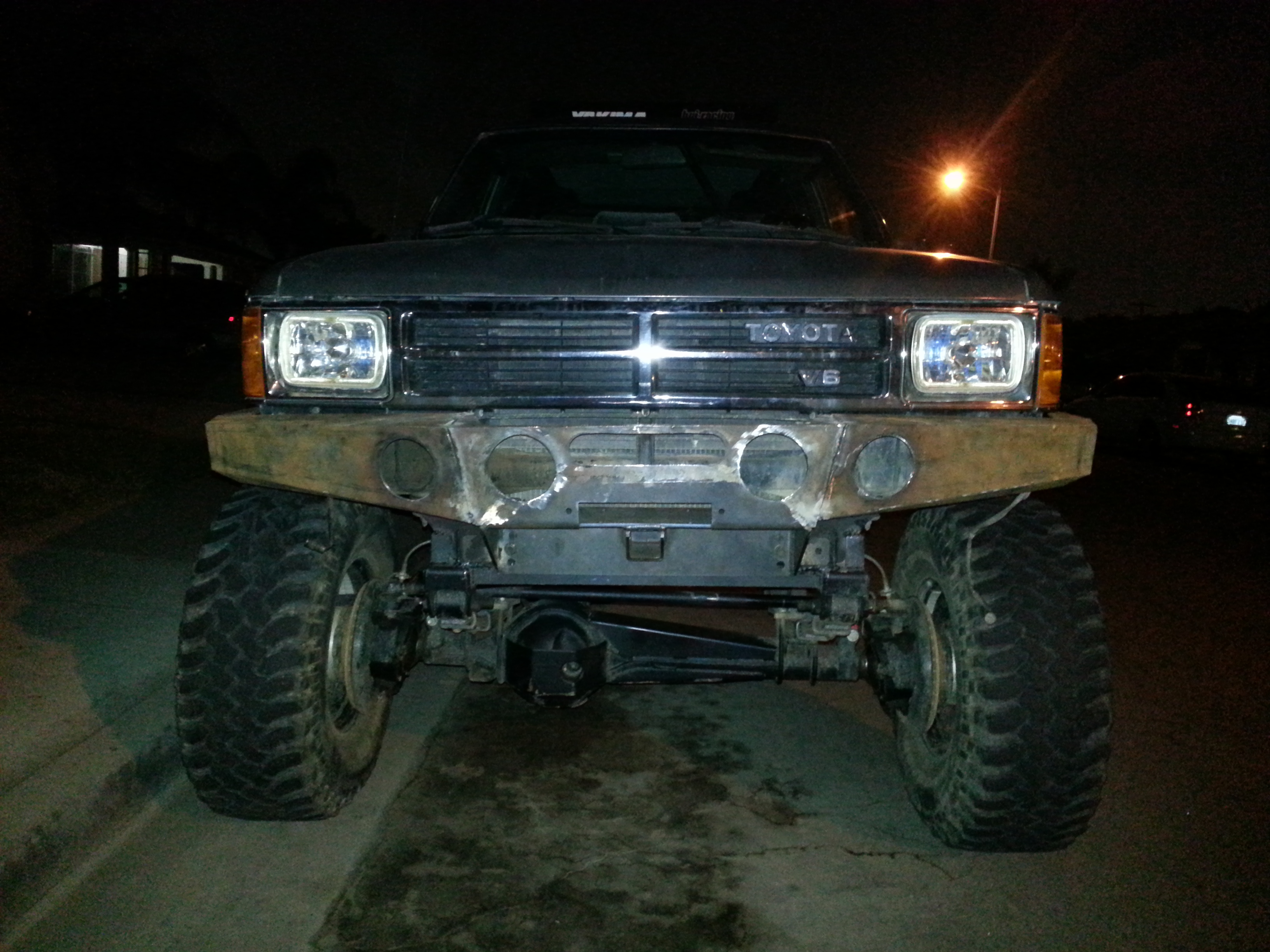

I went ahead and checked my front grill and it seems to be centered vertically, but horizontally it isn't. Check it out.
3/8's gap on the Driver side.
and the grill is right up against the light on the passenger side.

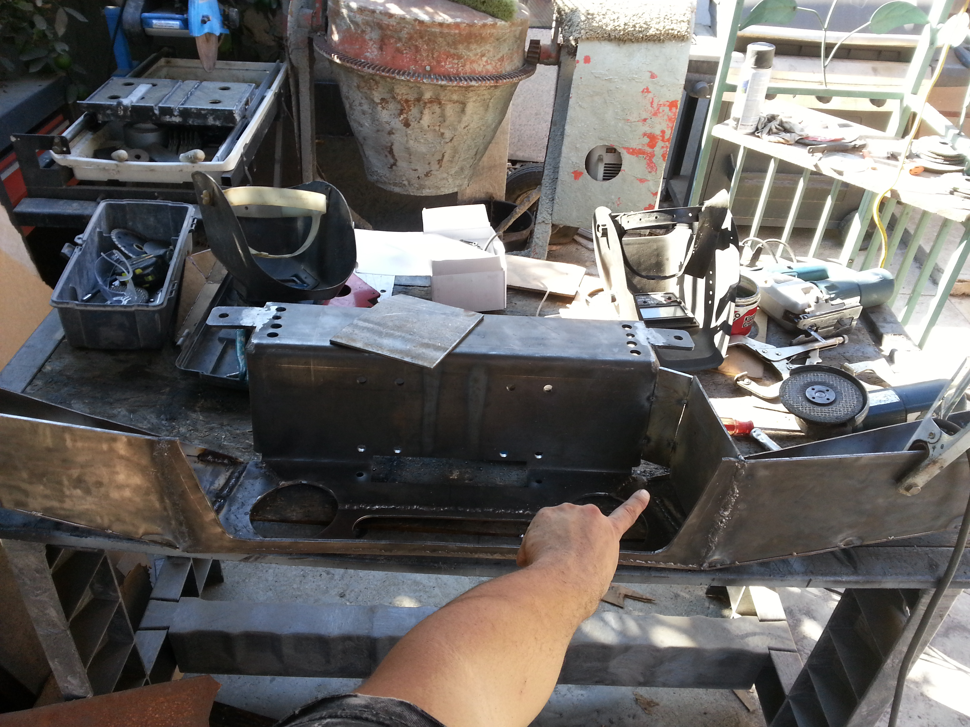

One reason my bumper was off was because the top screw holes that mount the bumper(circled) we off. Apparently the truck had to have been in a minor car accident on the front end because the those 2 tabs were both pushed off to the driver side a few millimeters.
Also bought a 4" grinder wheel and rounded out those torched edges and made nice n smooth. still have a bit more to go but it cleaned up a heck of a lot.

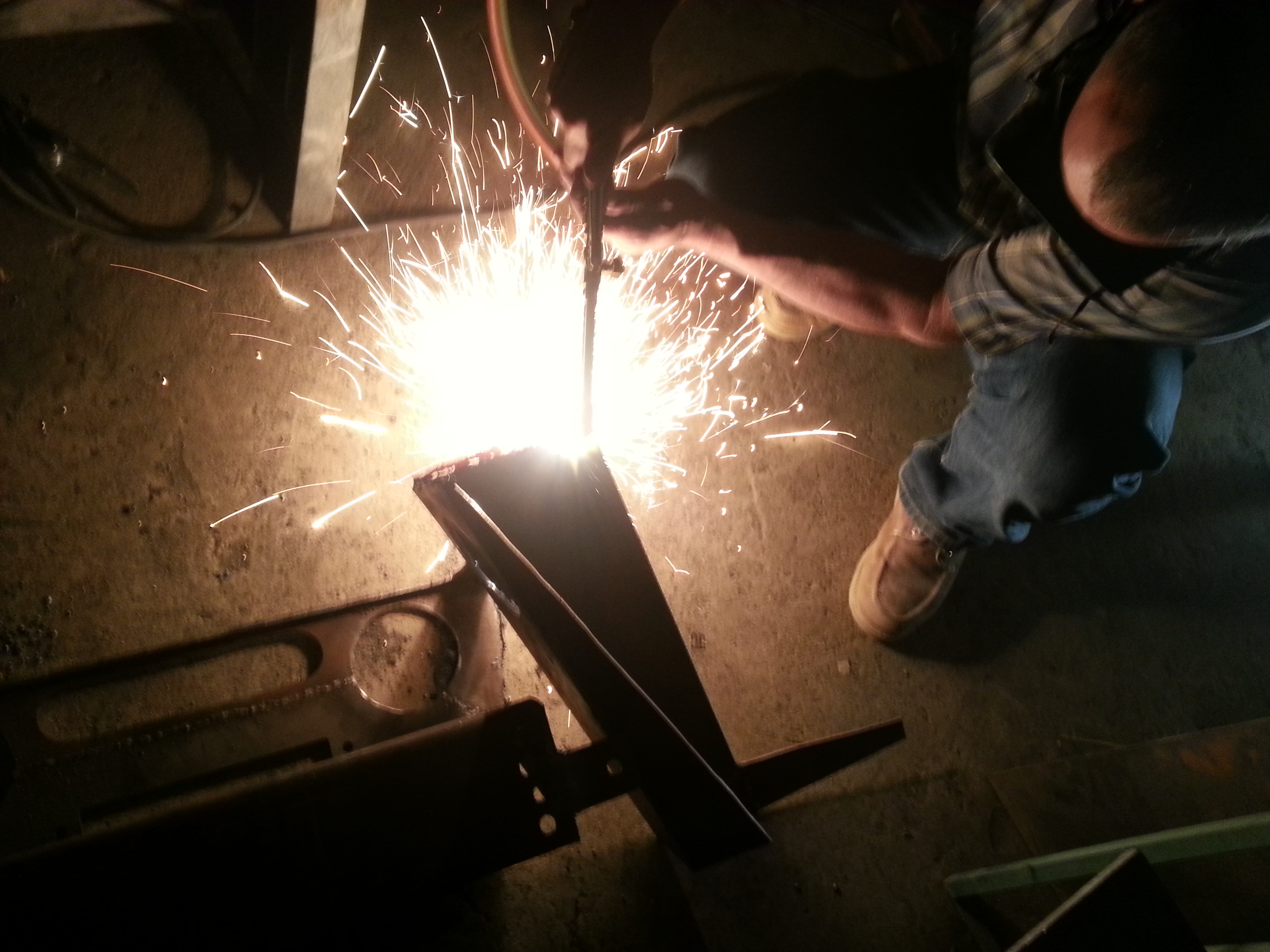

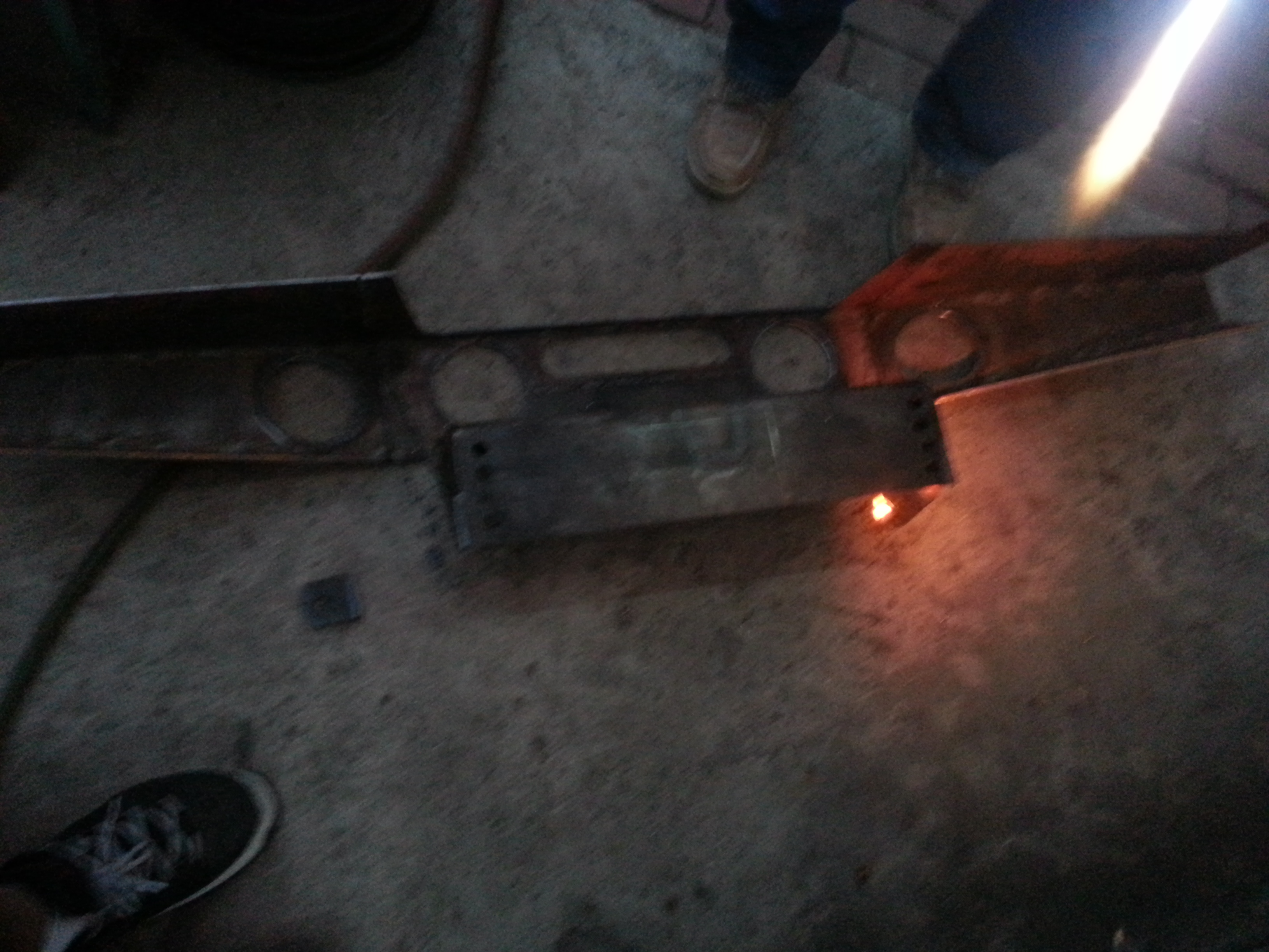

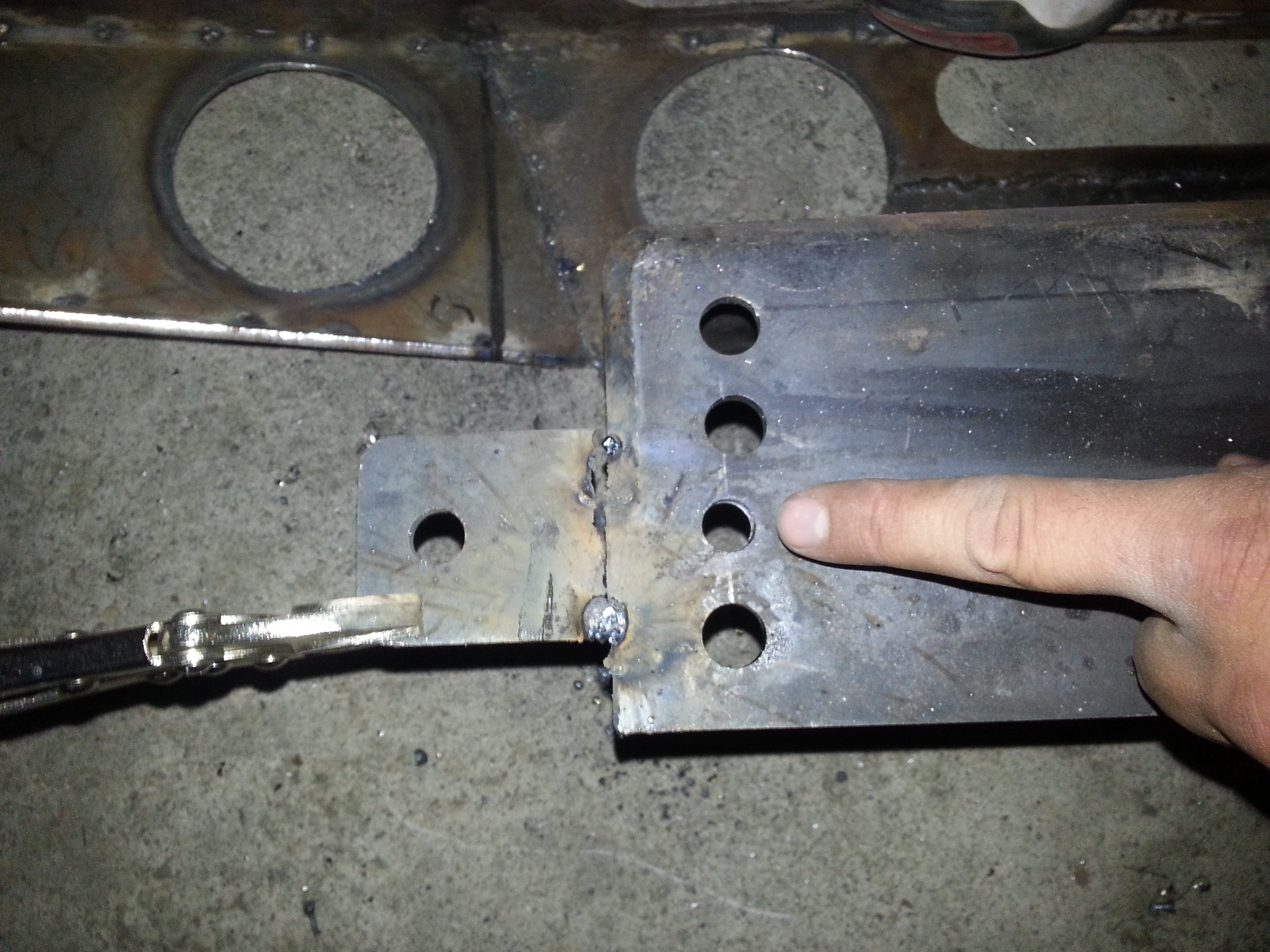

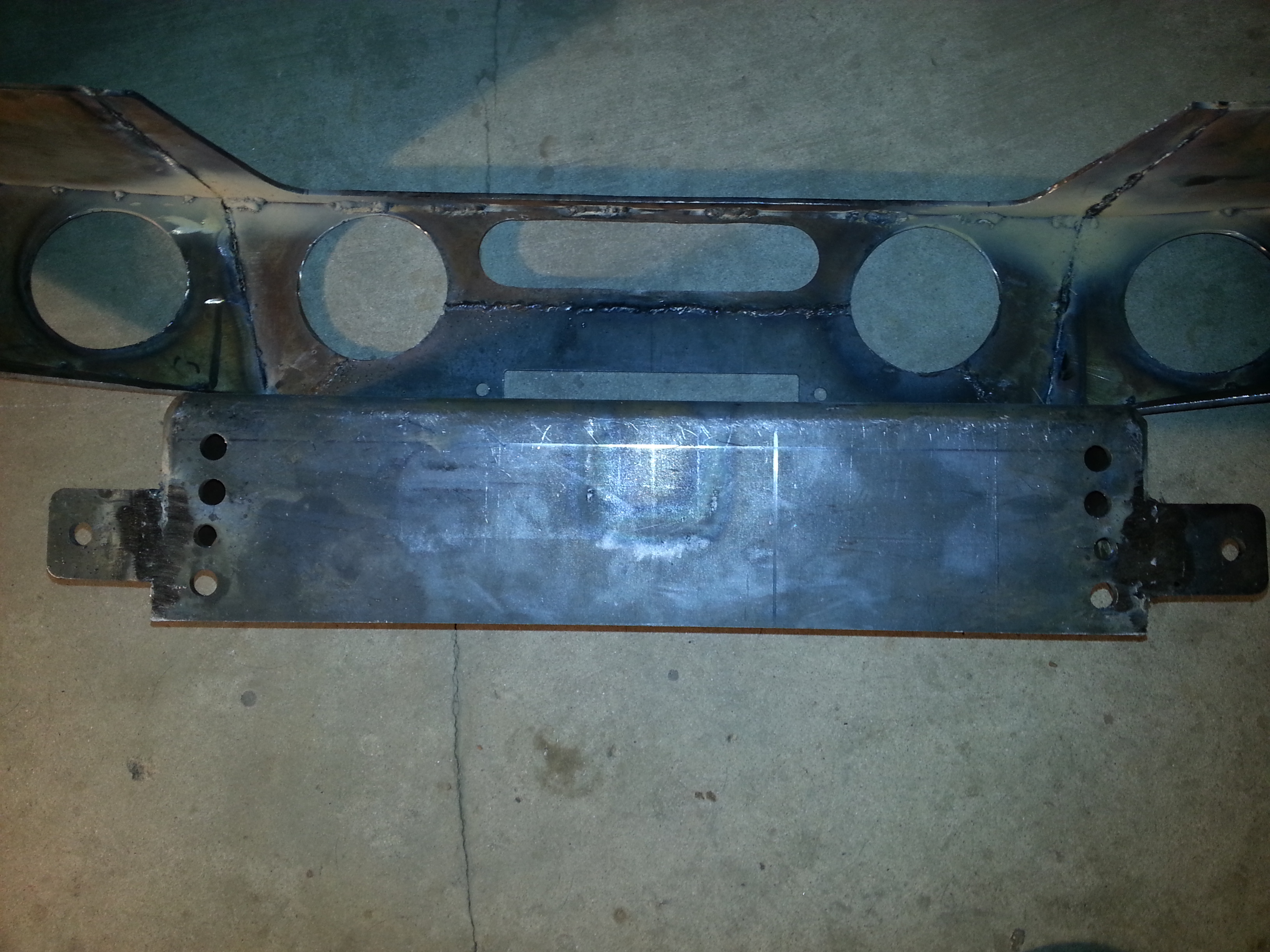

So RBX gave me an idea. he mentioned that the trailgear winch plate should be adjustable. and although it is. it wasnt adjustable enough. So we had to add our own holes 0.5" above the bottom hole and move the 2 tabs up 0.5" too.
Here we torched off the tabs
aligning with the newly drilled holes

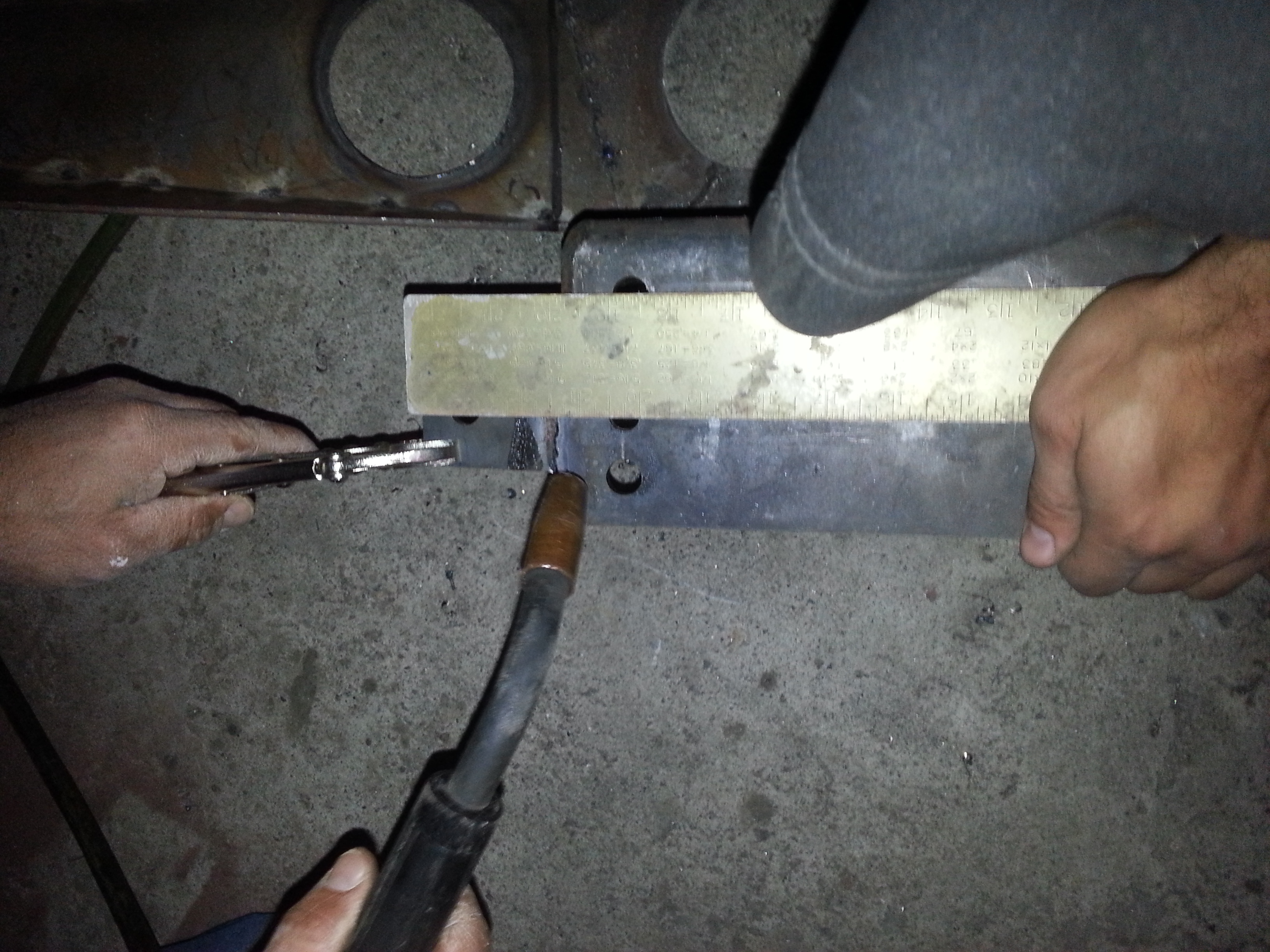

tab is tack welded on and im pointing to the new hole.

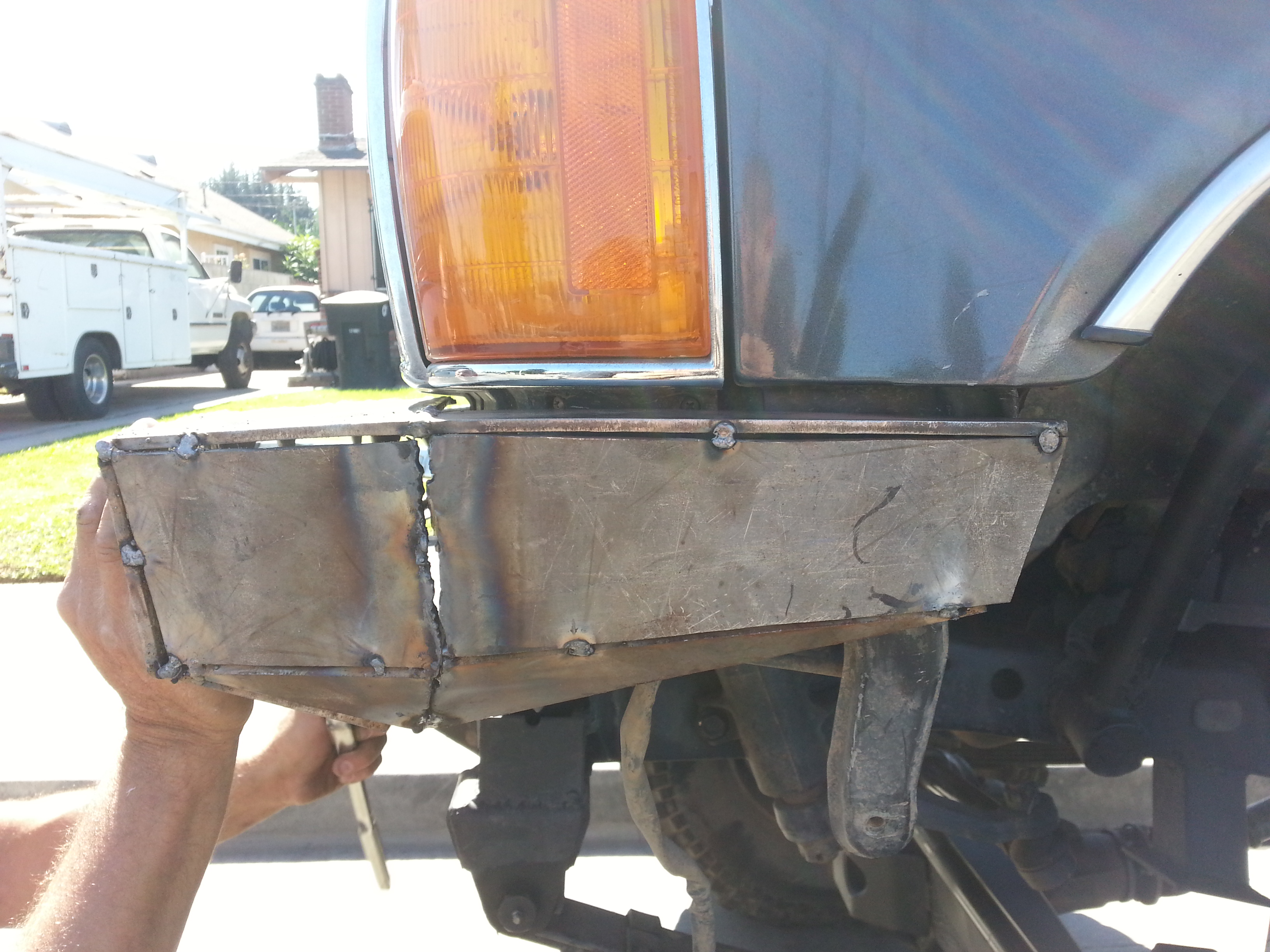

As for the nasty slope on both sides goes. I told my dad i wanted to straighten it out and make it level because RBX had me thinking. YES ITS TRUE, I'm definitely going to look at that every time i see my truck and wish i would have fixed it when i had the chance. So This is exactly why i chose to drop the entire bumper 1/2" and the bring up the sides again.
Here is my dad using the Acetylene torch to remove the sides again so we could grind down and then we weld.

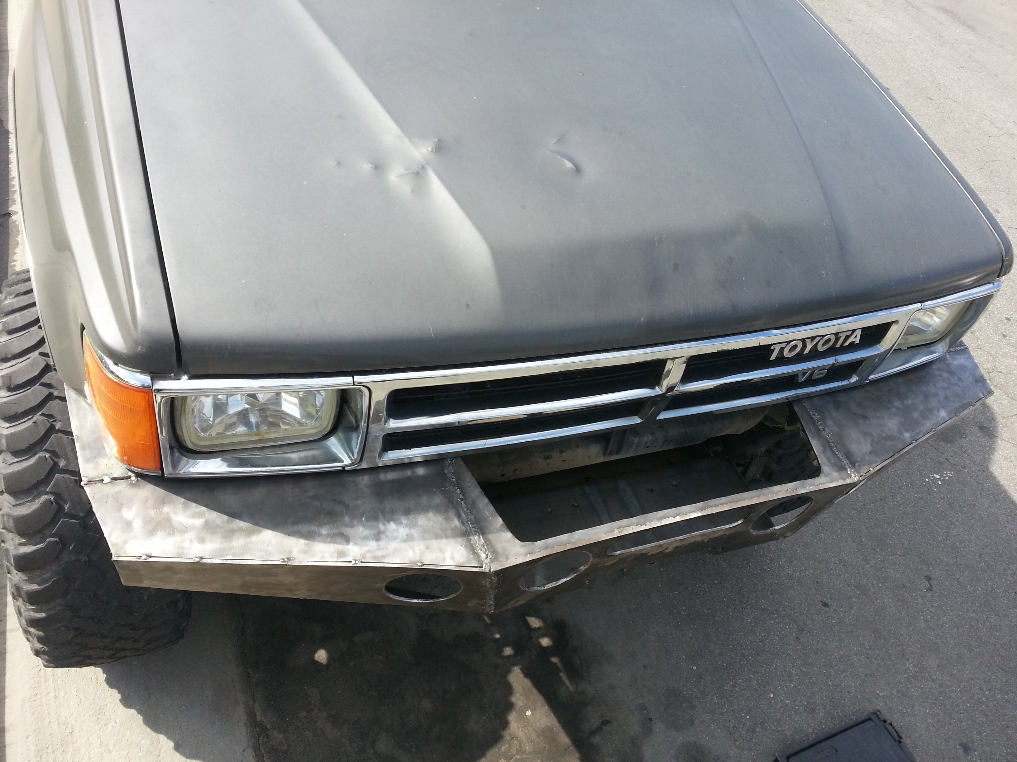

We re did the tack welds and adjusted the bumper perfectly to my truck. Now we fit the grill and wont need to trim the whole bottom of it like i had planned before. definitely happy about that. The sides still had to be sloped a tad bit. but very minimal; im talking about less then 1/4" maybe about 1/8" or so. either way. This looks a hell of alot better then what it was sitting at before.

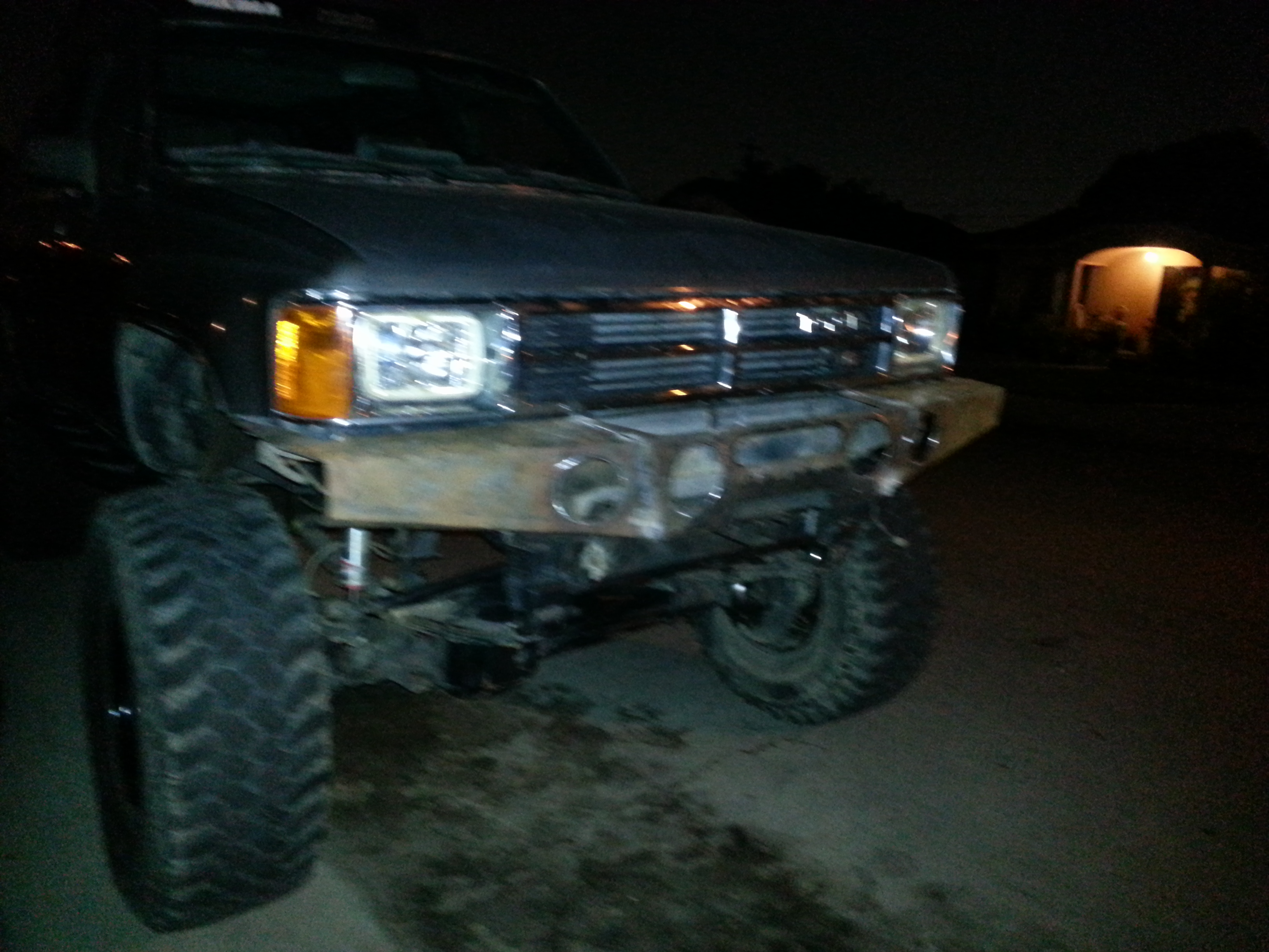

Alright gentlemen here is some extra progress to my bumper!
We made the welds on the tabs final now that we knew they fit.
And we fully welded the front side of the bumper as well because now it sits perfectly while still having access to the grill in case i ever needed to remove it.
Look at that sexy bumper! oh yea!

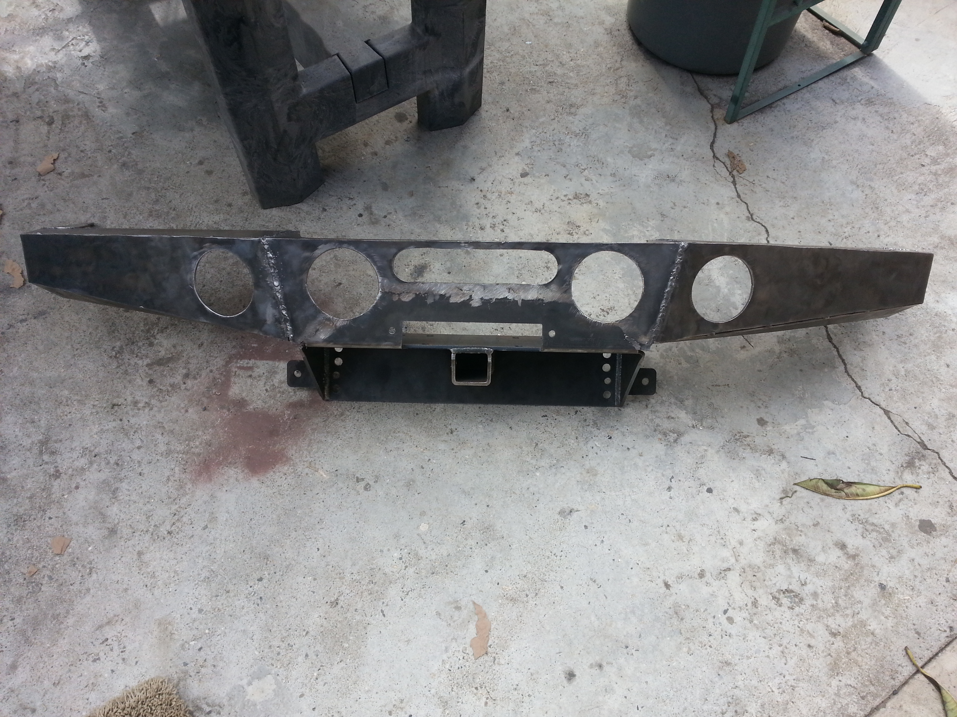

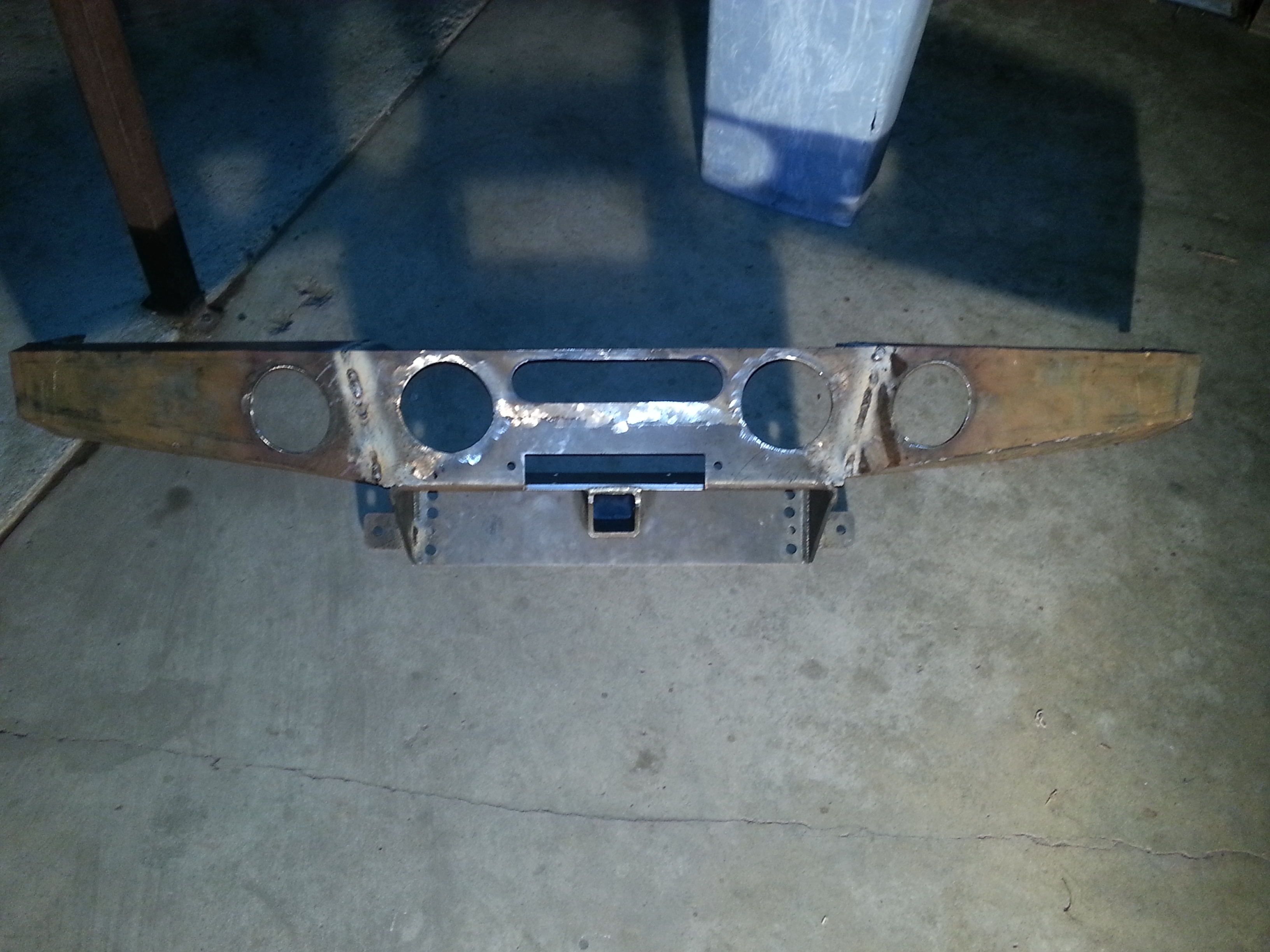

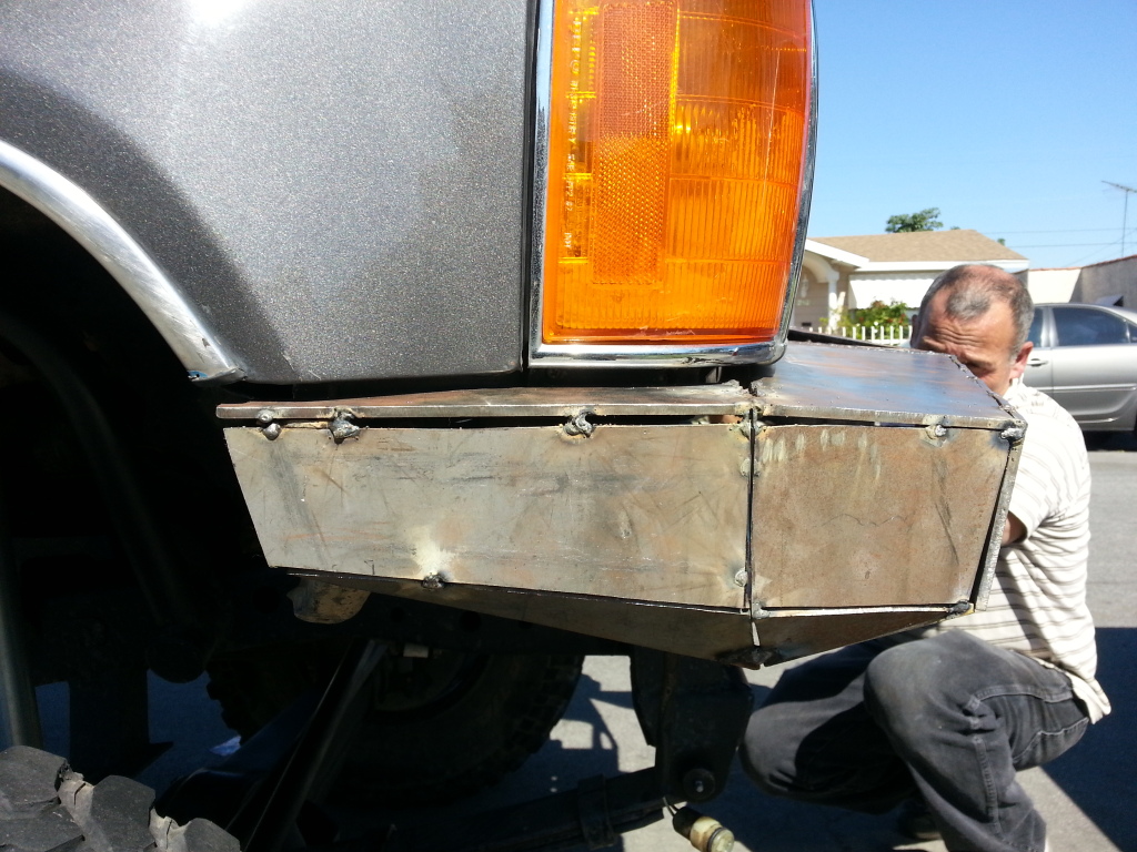

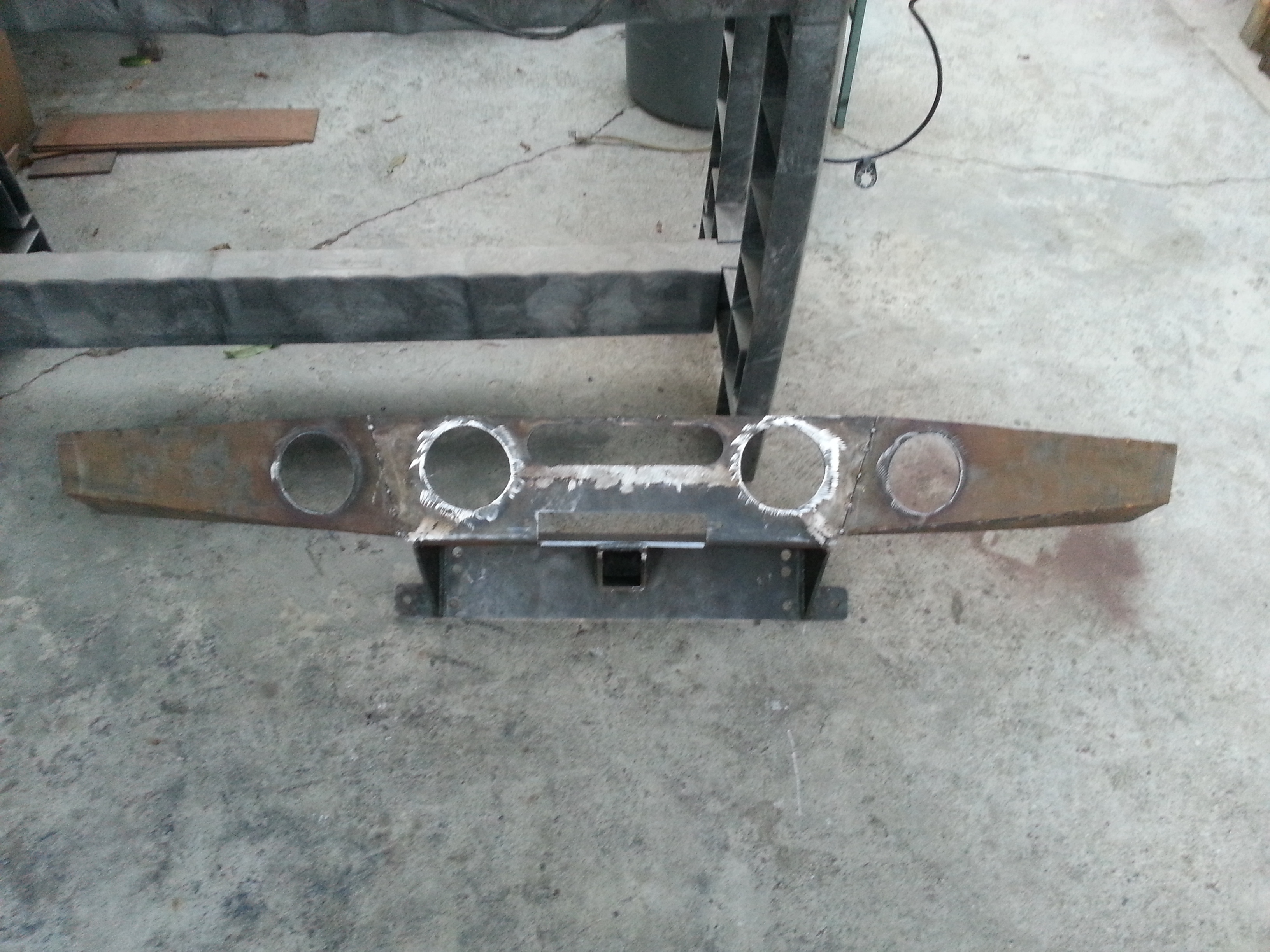

Copy and paste off my Bumper thread:
Didn't get much done this week. Had to go back to Mexico for my follow up appointment for the dentist so I didn't do anything yesterday. This morning I realized I had a lot of surface rust throughout the bumper. So I took the grinder wheel to the whole bumper and cleaned it up again to prep for new welds.
Nice n clean:

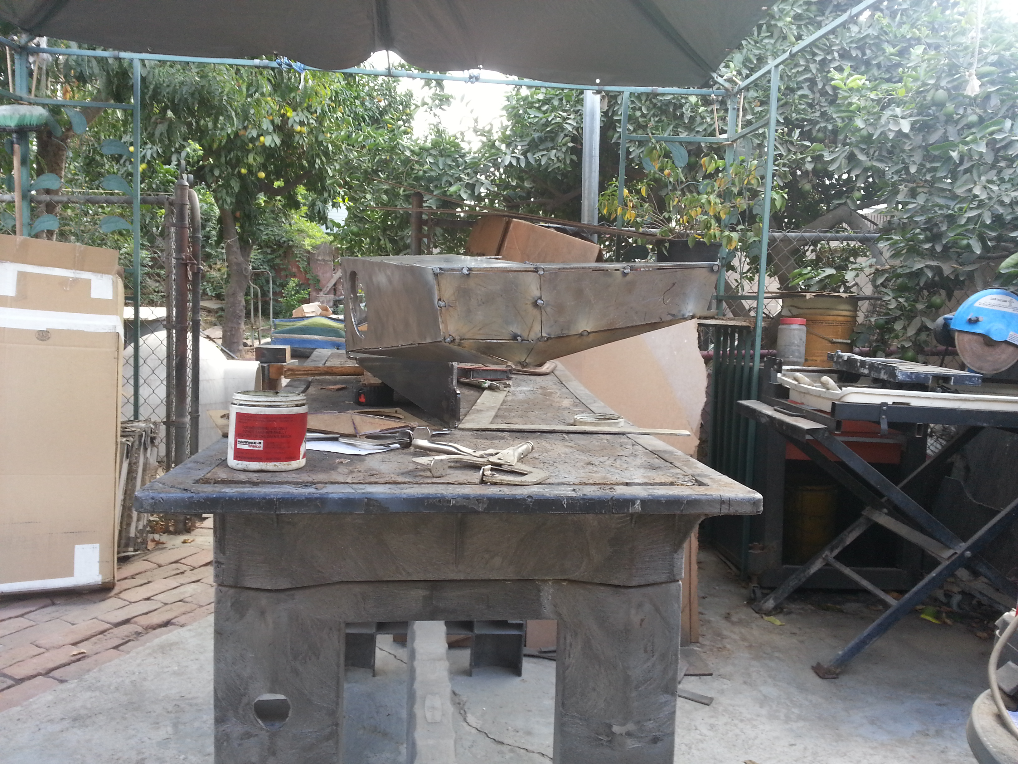

I tack welded the side corner pieces.
Time for fitment! I think it is looking great!
Here is my favorite shot.
I need to pull that passenger corner piece about 1/4" to make even.
Other shots.
You can see right here in this shot that the bumper sides go up and touch the bottom part of the fender. So I need to grind off the tack welds and re weld it tighter to pull away from the bottom fender then it'll be left perfect.
Bottom view

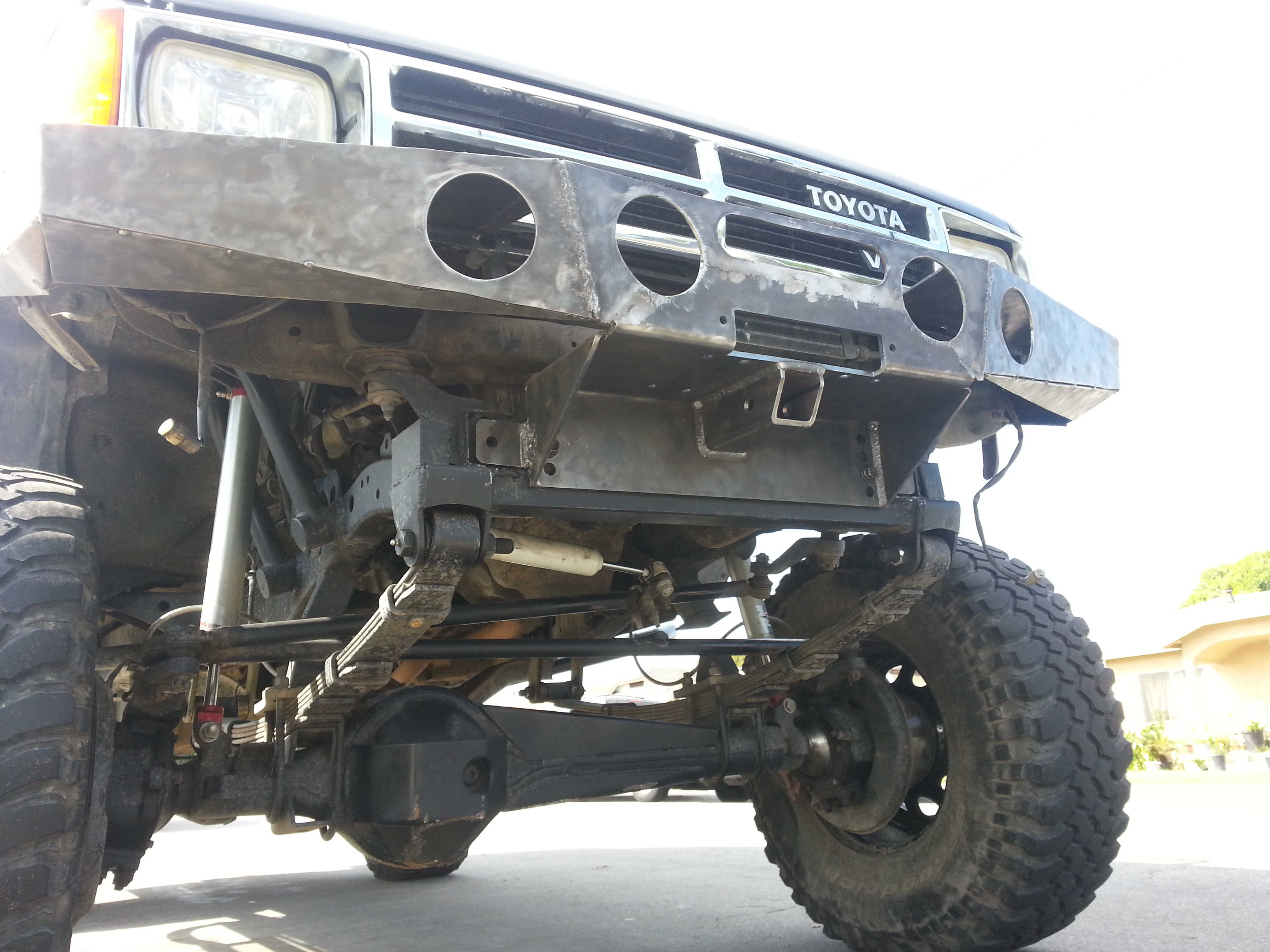

Got some decent progress in today guys. We cut off some of the tack welds. and re adjusted the corner pieces. Now it sits exactly where i want it.
I know the picture codes arent working from photobucket due to lack of bandwidth. I'm still going to upload them anyway for when the bandwidth does kick in. But im also gonna attach the pix to yotatech. Just delete them after my bandwidth resets i guess.
Here are the pix of the fixed sides/corners of the bumper.
Driver side doesnt rub the fender anymore.
Passenger side isnt rubbing either
We added the reinforcement that i wanted to the center part of the bumper. Here is the first shot i took.
Here is the full view of the back of my bumper. Both center reinforcements finished.
After this picture was taken we did all the final welds throughout the entire bumper. and silly me forgot to take pictures lol But the entire bumper finally got the full welds. The only thing it is still missing is to add 2 circle or square tube from the corner pieces of the bumper to the winch plate too support the sides. I also began grinding some of the welds down to make look nice and neat. but i didnt finish. I'm not sure i'll have time to work on this tomorrow. but we will see. im crossing my fingers and hoping i at least get 3 hours of grinding in.

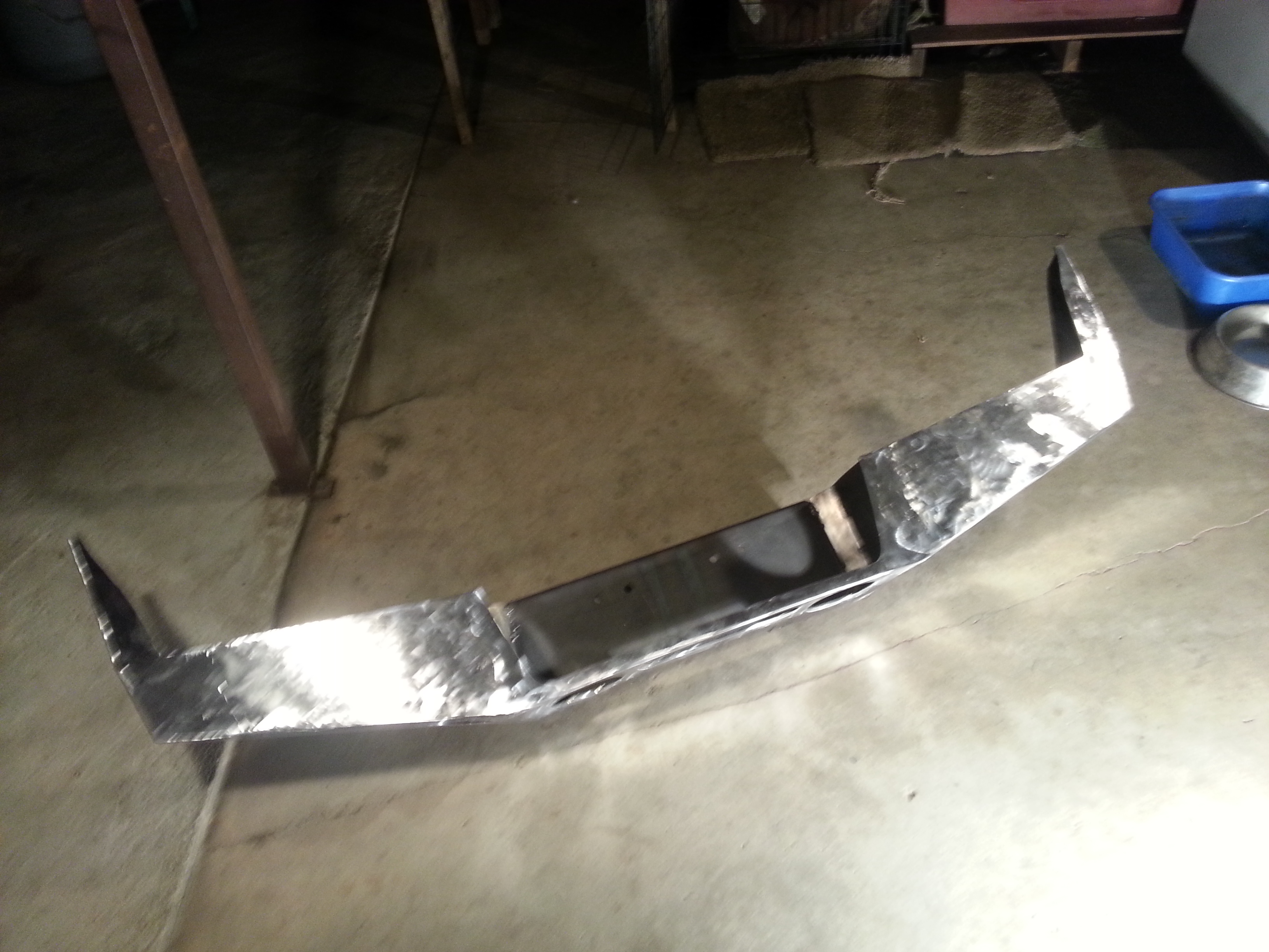

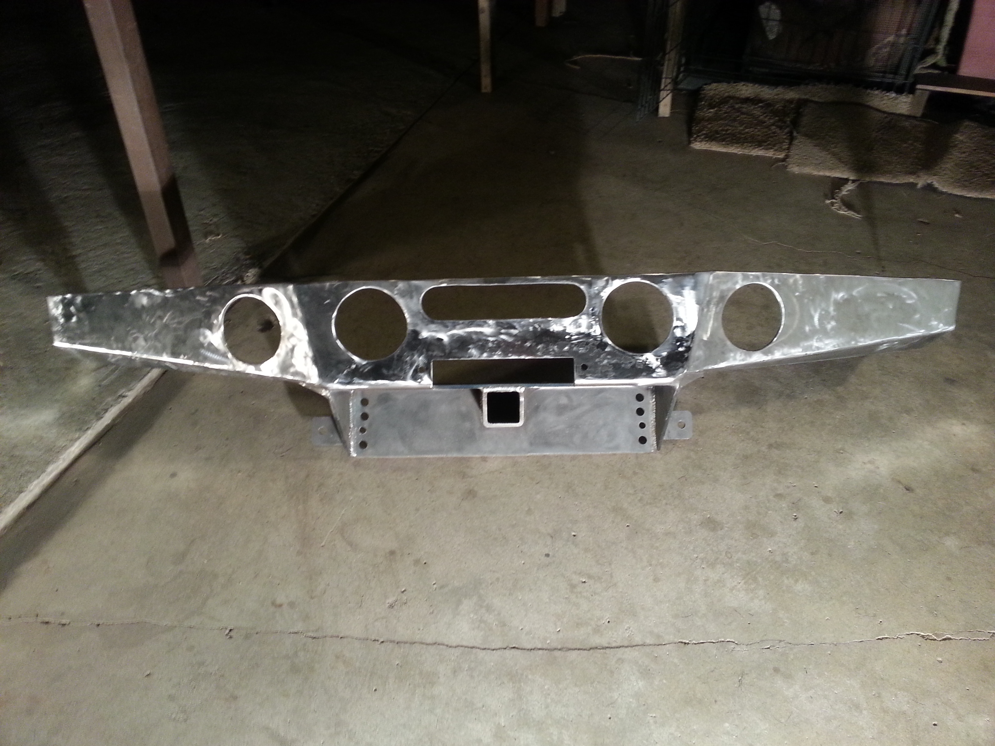

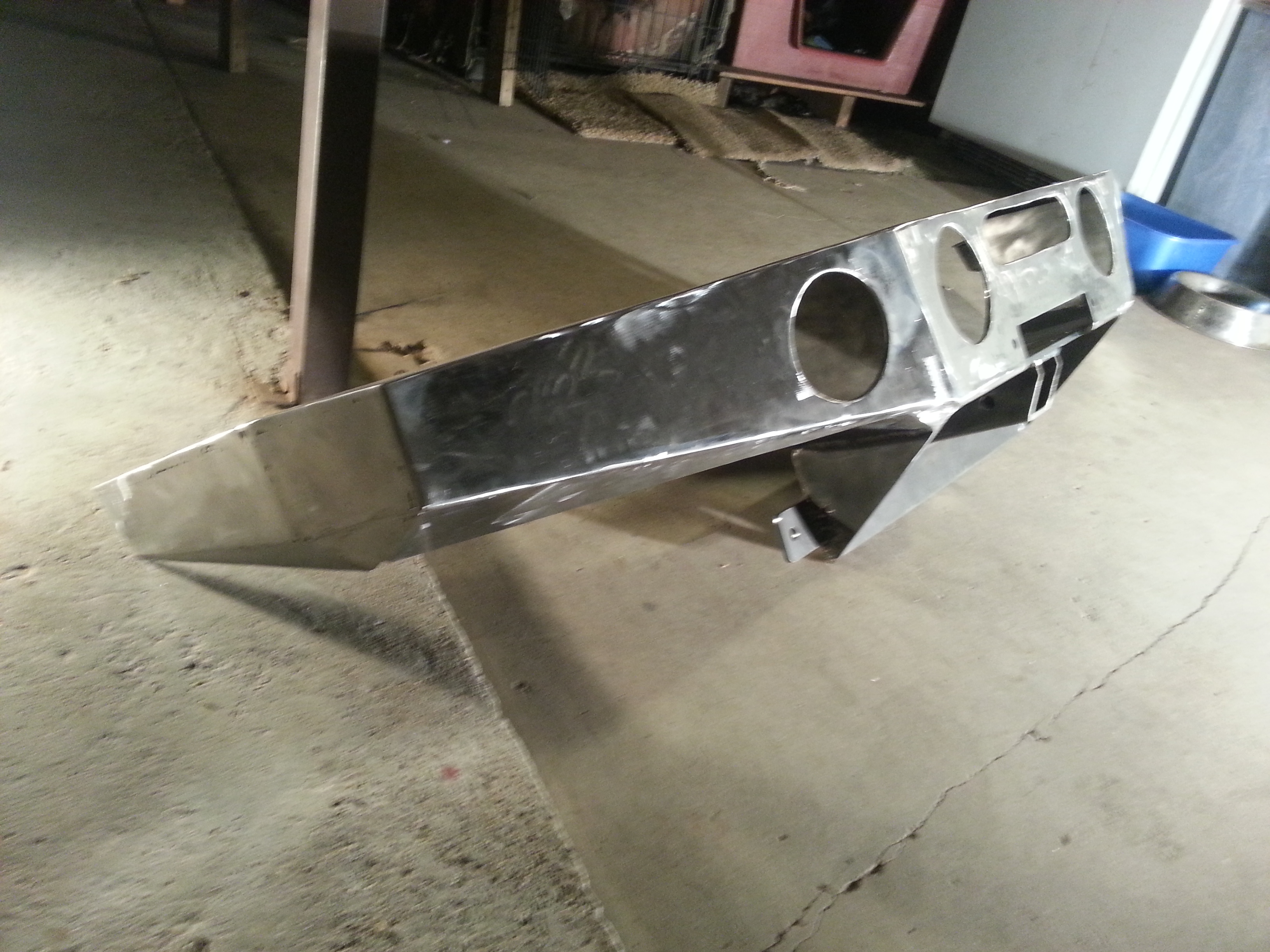

Alright guys I have a quick update before i head to bed.

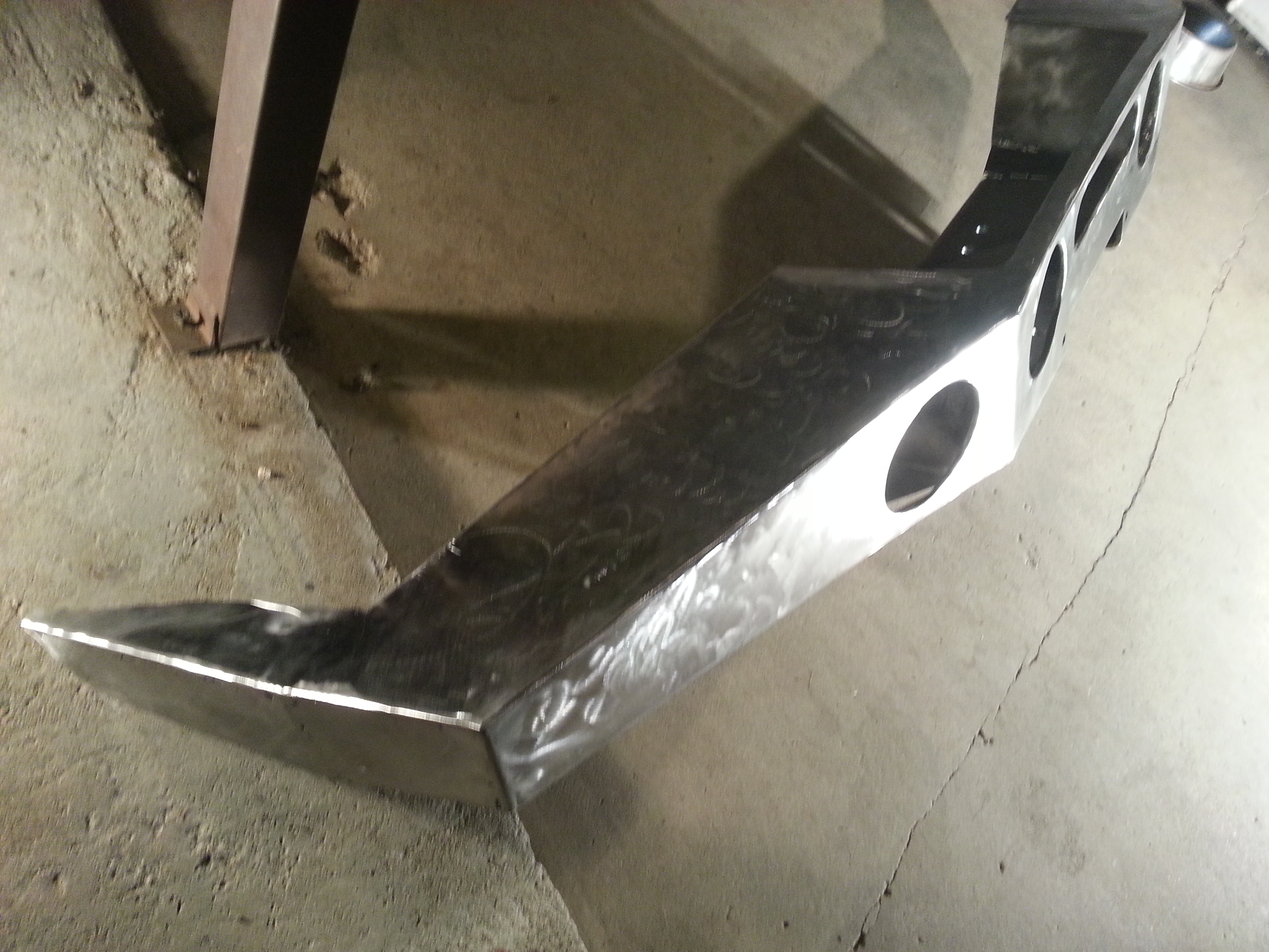

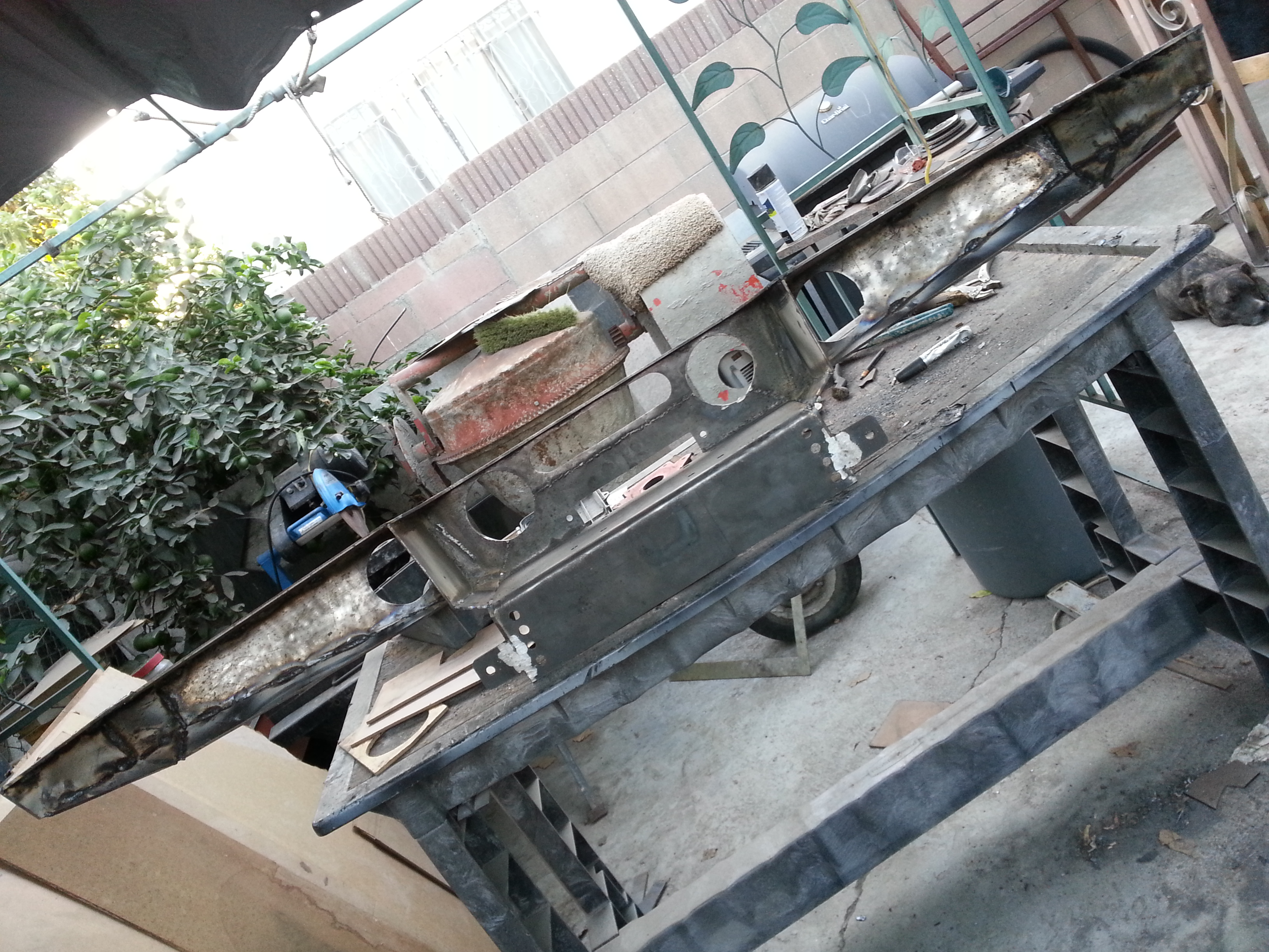

Today i spent approx 3 hours grinding down all my exterior welds and sanding down all the exterior surfaces of the bumper.
I KNOW THE PIX WONT WORK TILL MY BANDWIDTH RESETS! Just go ahead and click on the pictures that photobucket replaces my pix with and you will be redirected to my photobucket account where the picture is at.
Front View
Top Corner
Bottom Corner
Top View
And in case you're at a computer i made you guys a video showing all the details to my bumper. Posted it on youtube. hope you guys like.
