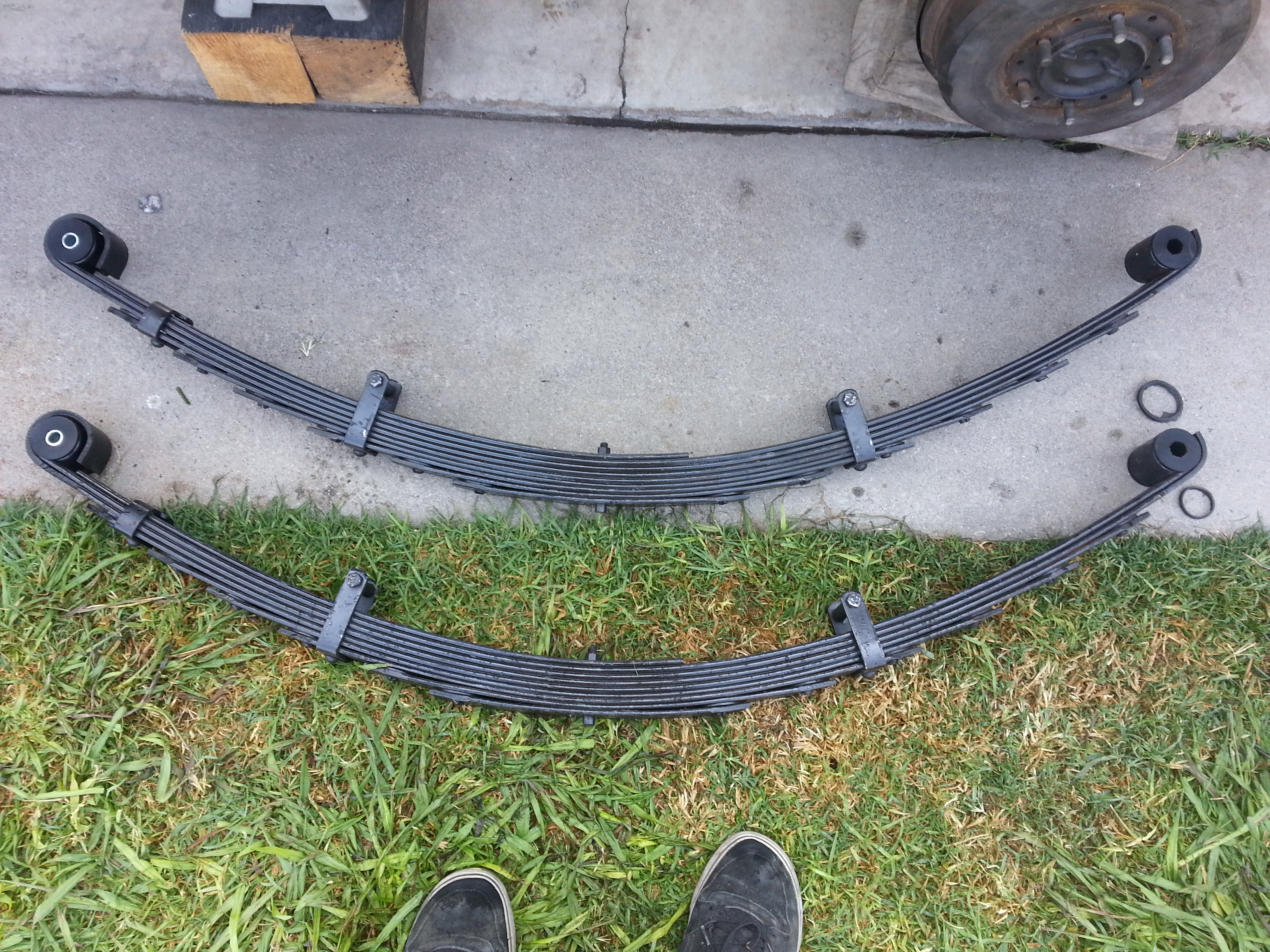

Alright guys it began. Went to All-Pro. New location actually located in Perris Ca. So its a few miles closer. Round trip was anout 155miles or so and a total of about 3.5 hours for a round trip. Anyway I really am satisfied with these guys. I exchanged my leaf springs for the 6" lift. And I was gonna exchange the 4" shackles for 6" ones. But he said it was fine. Just to go ahead and keep them in case i ever wanna go lower. And for me to keep the 6" ones.
I'm telling ya I love this place. Just really wish it was closer.

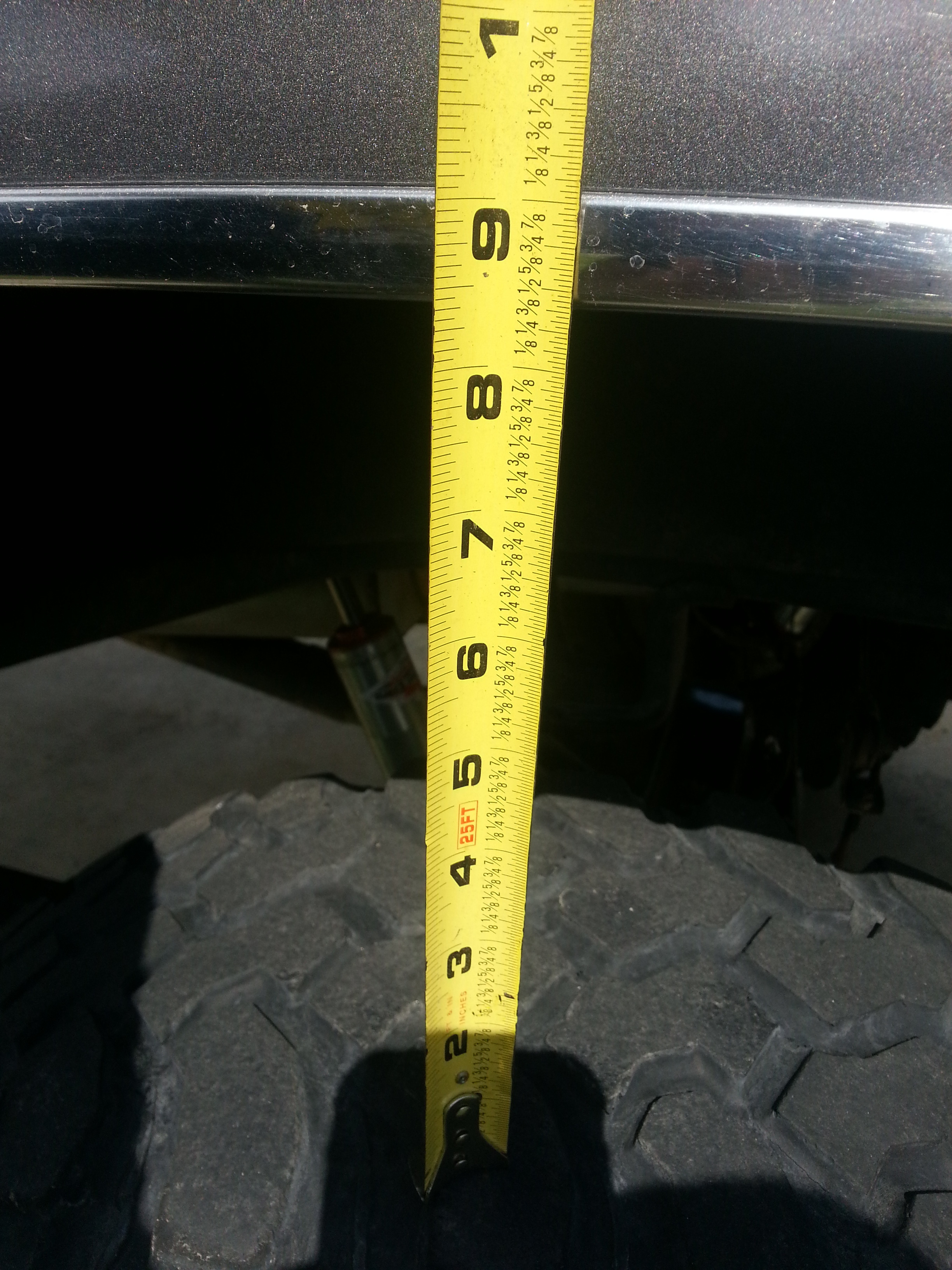

Started off with measuring the current heighy with al the weight on the bumper and tire swing loaded up. Sitting at 8&3/8"
New rear 6" lift leaf springs. Has 9 springs.

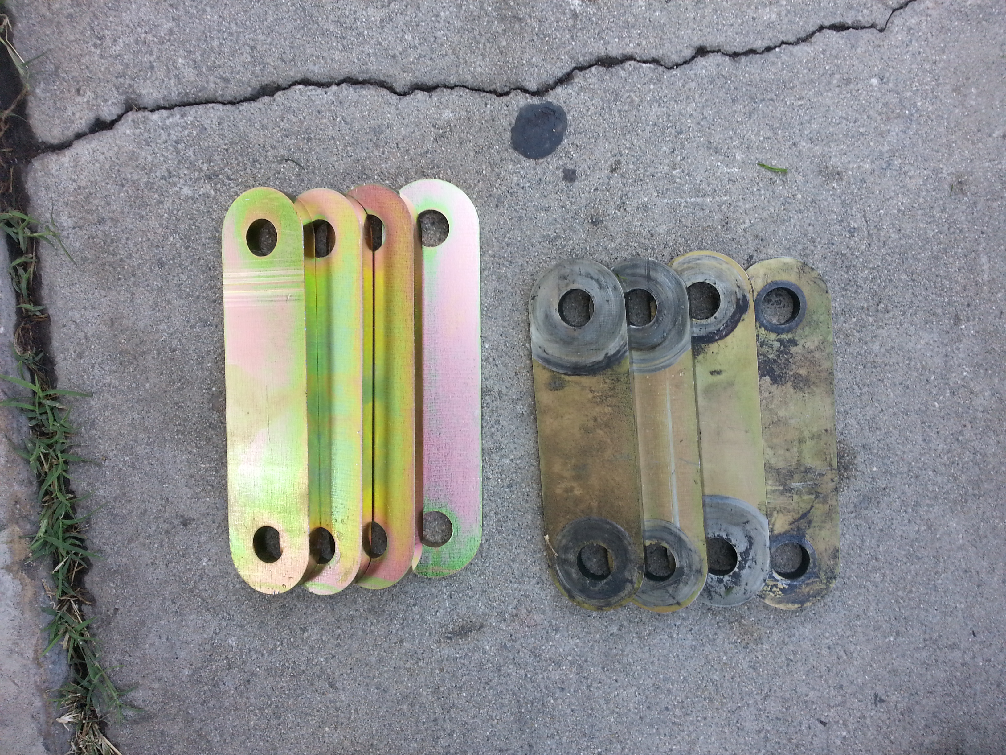

Shiney new 6" shackles next to the 4" ones.

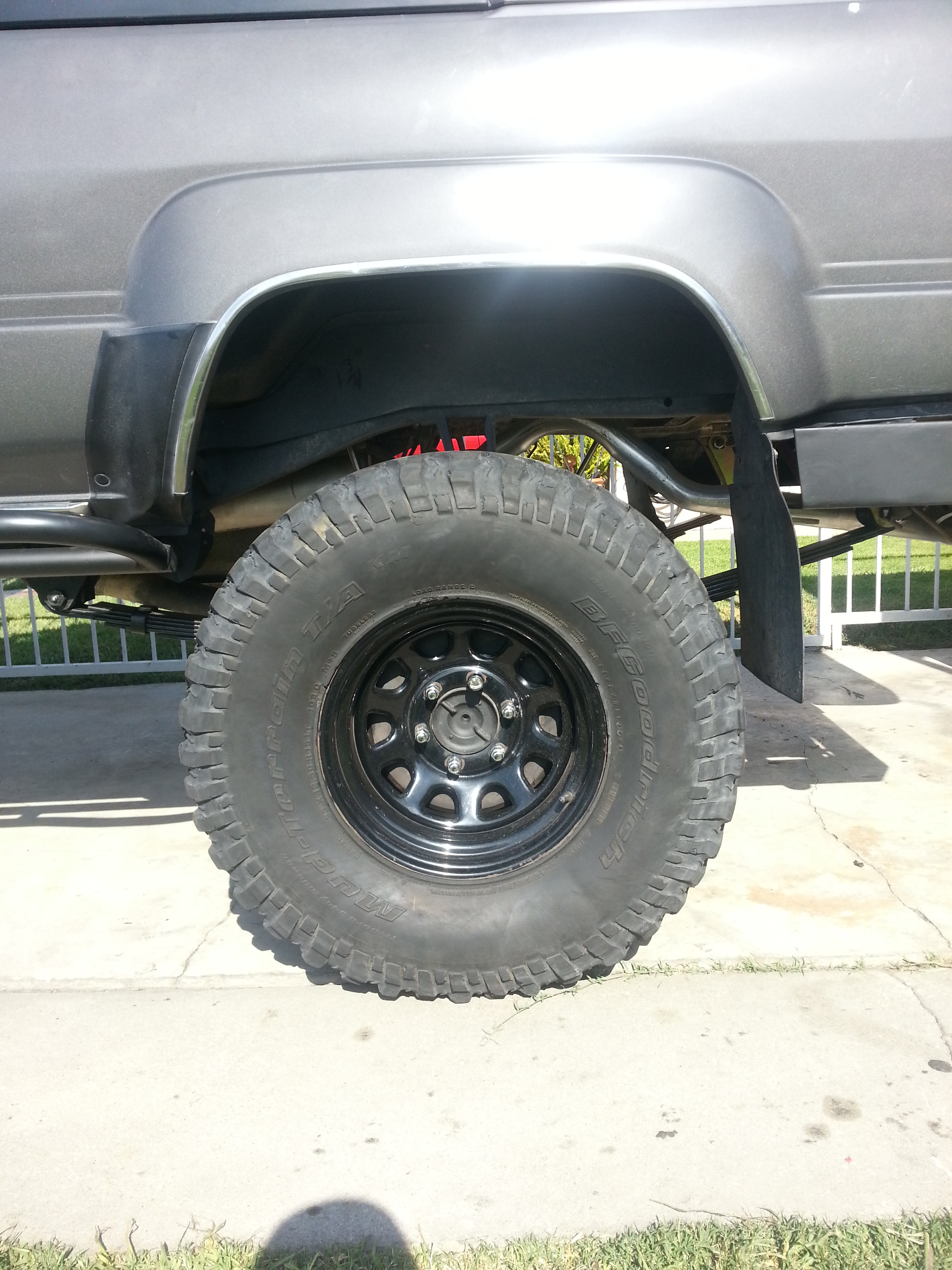

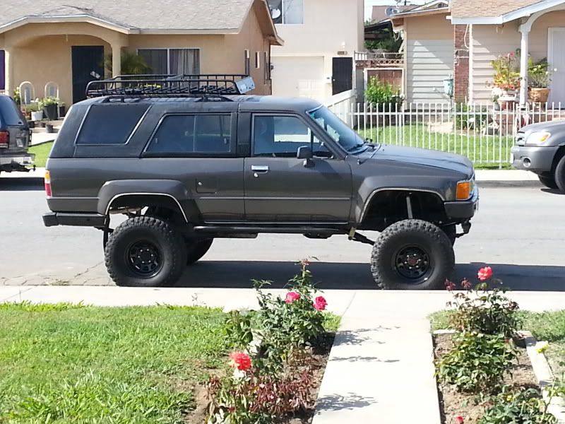

Alright guys here we go.
33" tires with my massive load in the rear end and 6" lift rear leaf springs came out to
9&3/8". So i got one more inch of lift after the rear bumper made my rear sag. not bad.
good thing is i didnt have to use the extensions for the ebrake.
Truck sits evenly now.
But the rear seems to be moved forward slightly. I'm wondering if maybe i need to turn those leafs around.... It's not horrible. Maybe just 1" more forward from the center. if i turn them around im gonna have the tire further back like i had in my last set.

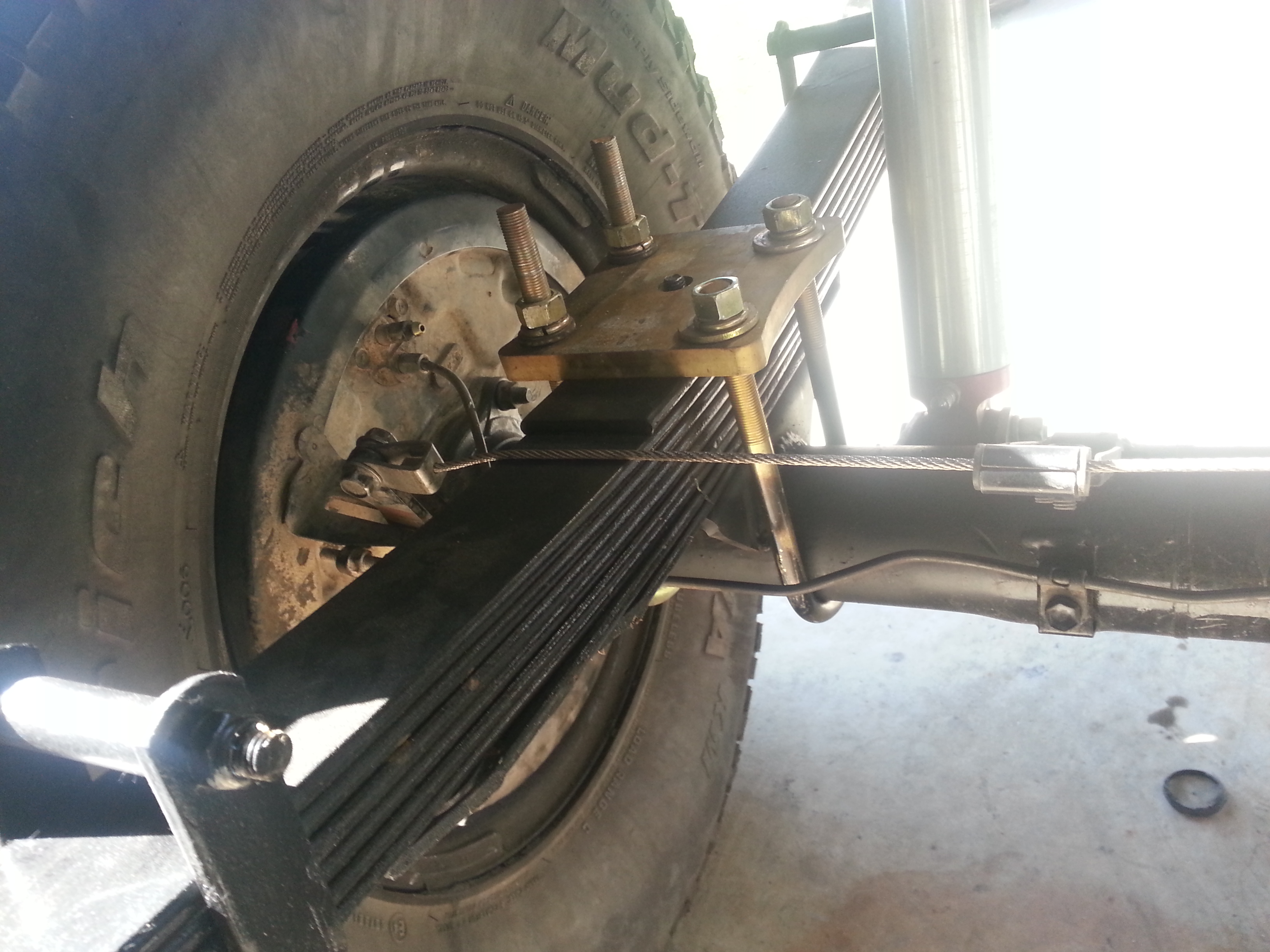

See this is the old 4" springs that i had. see how the rear is slightly back.
I'm wondering if i should just leave the springs as is. or if i should move them 1" closer to the rear. either way the driveshaft wont need altering.
I think this is like this because i never installed the rear 2 hangers for the rear. we only put the 2 that go on the front side for the rear leafs. I believe they are installed correctly. they just never got the 4 rear hangers positioned correctly.... jeez.
EDIT:
Yea that's what it is. I have them installed facing the right way. We just have the hangers a bit too far forward. I installed the last leaf springs backwards purposely because of how far forward they were. But whatever looks like its gonna stay this way.
Btw these springs feel so freekin smooth now that I don't hace those extra leafs in the rear. The last ones made then feel stiff. And these feel great!

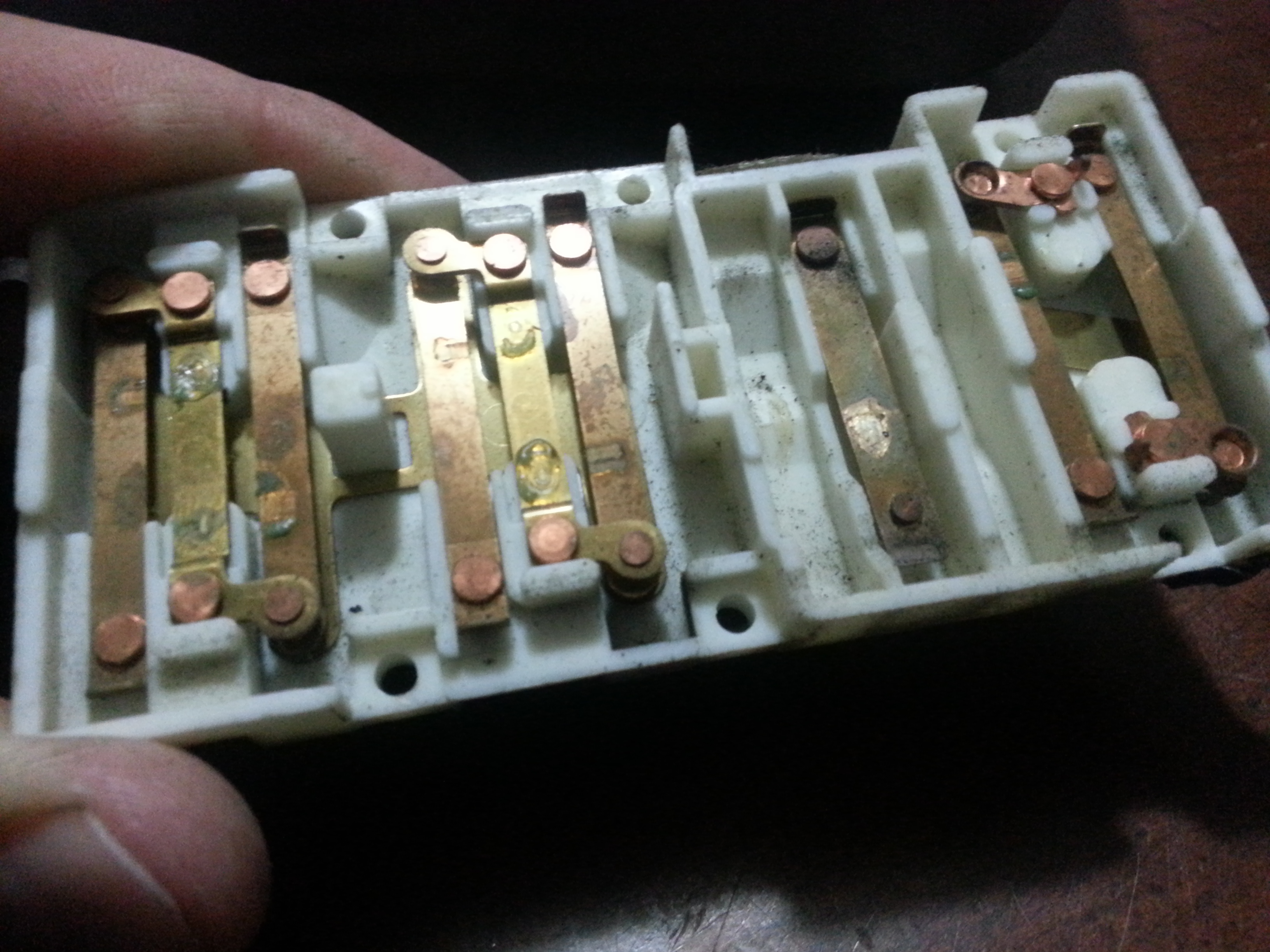

On the bright side. My good news is. That my next and only project for a while is going to be my Power Windows/Mirrors. I have everyhing I need to do the install. So this will be at no cost to me.
Anyway. I picked up this newer, better conditioned power window master switch from Mark who recieced it from Eric of YotaTech to give to me. And I decided to test all the contacts with my MultiMeter. And when I opened it I was amazed at how clean and shiney it looked compared to the one I had lol. And good news is that all the contacts work great! So power window/mirror mod coming soon!
