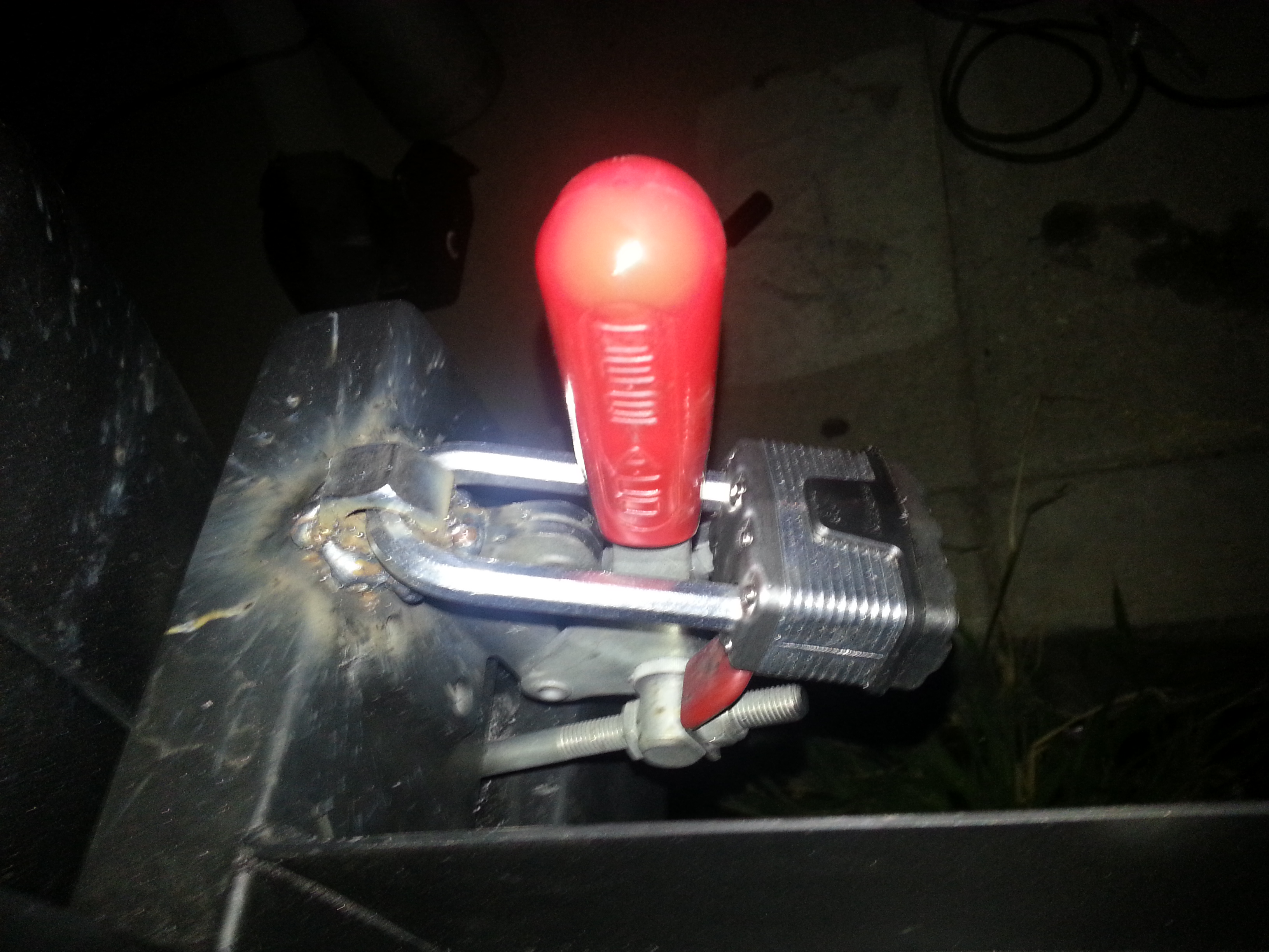

By the way. i wanted to share with you guys that the latch from EMS offroad doesnt hold too well. Either that or my installation(or positioning of it) was off. I had a scare this sunday. I drove about 6 miles on the street to pick up a friend to drive out 15miles out to San Gabriel Ca. So i got out to say hi to his family and on the way back to the truck i seen the latch was in the downward position. This scared the crap out of me because just the right amount of bumps and jumps would have probably made that latch come loose and there would have gone my tire swing opening on the freeway at 65-70mph. I temporarily used a tie down strap to hold the bumper shut but thats something that i wanted to fix for sure.
This was a big eye opener in a major flaw my tire carrier had. and it had to be addressed immediately. So i bought yet another lock. One that was longer to wrap around the latch. to hold it closed. So i secretely "borrowed"(lol) one large nut from work with a hole big enough for the lock to fit through and i welded it to the swing and the latch.
I totally messed up the welds on this. I forgot to open up the CO2 tank so i welded the nut on all jacked up at first. once I realized the tank wasnt open i ended up giving it another pass with the welder. So you'll see in the pix the welds look pretty thick and crappy.... but oh well. its on there now and it aint going anywhere now haha

Now this limits the play that the latch has. It definitely wont open up anymore.
Now im just gonna need to buy some paint and primer and clean this up some.

when looking at leaf springs, depending on who is selling them. like all pro says 4" LIFT springs while other companies like TG just says 4" Spring. i think the TG just have a 4" arch in it.
its possible someone might have been messing with your latch. the lock is a good idea

excellent idea on the lock n nut

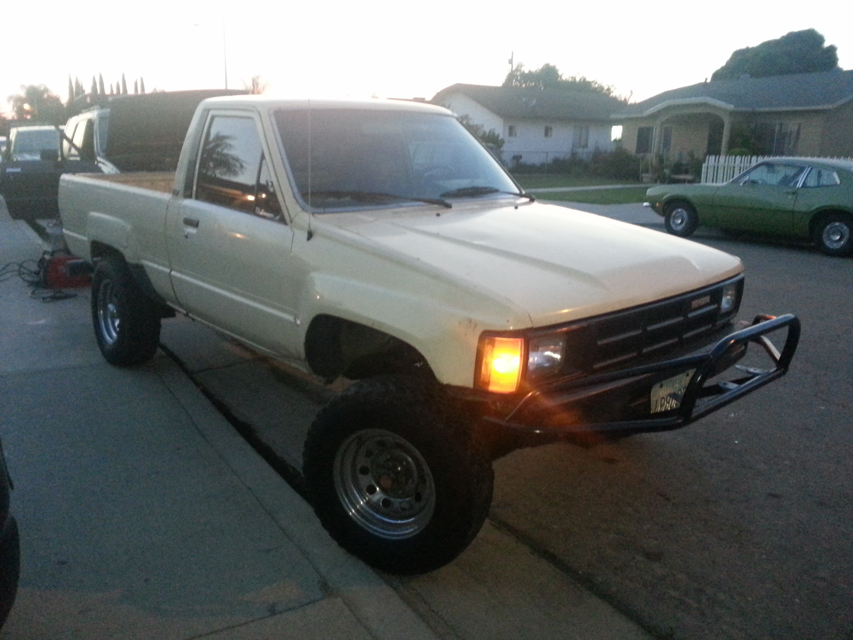

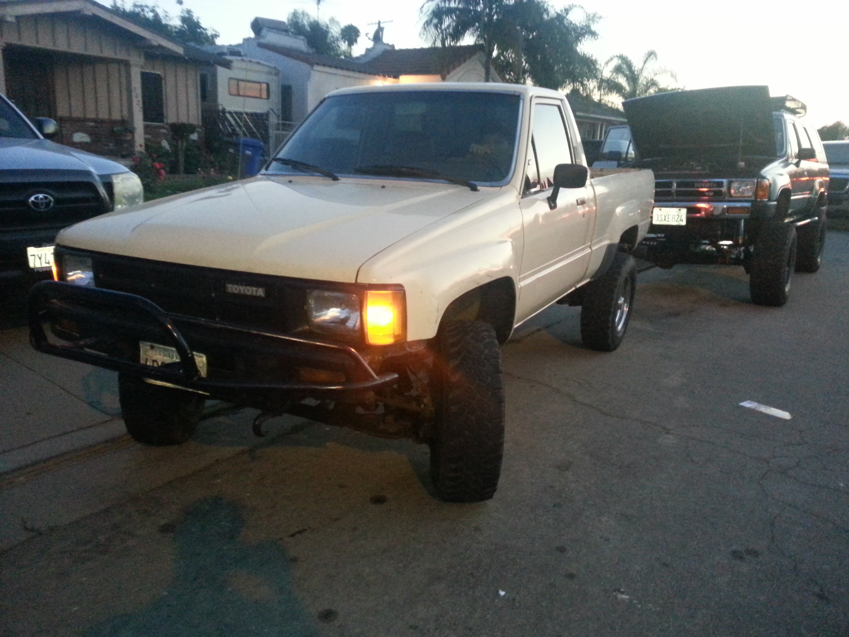

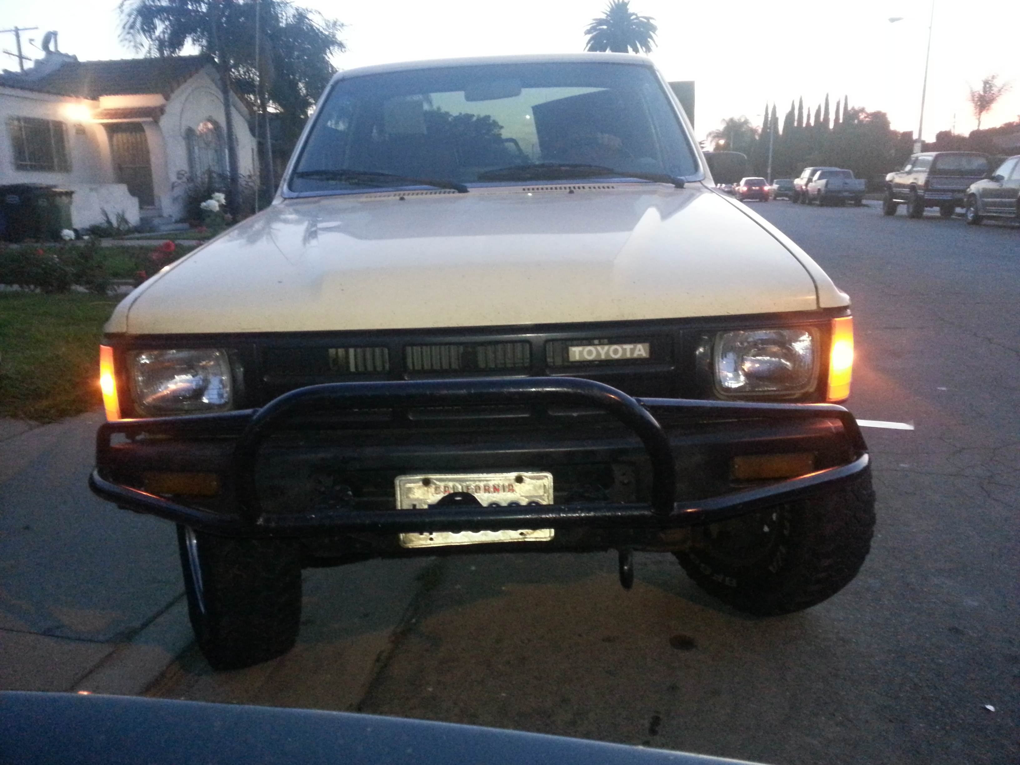

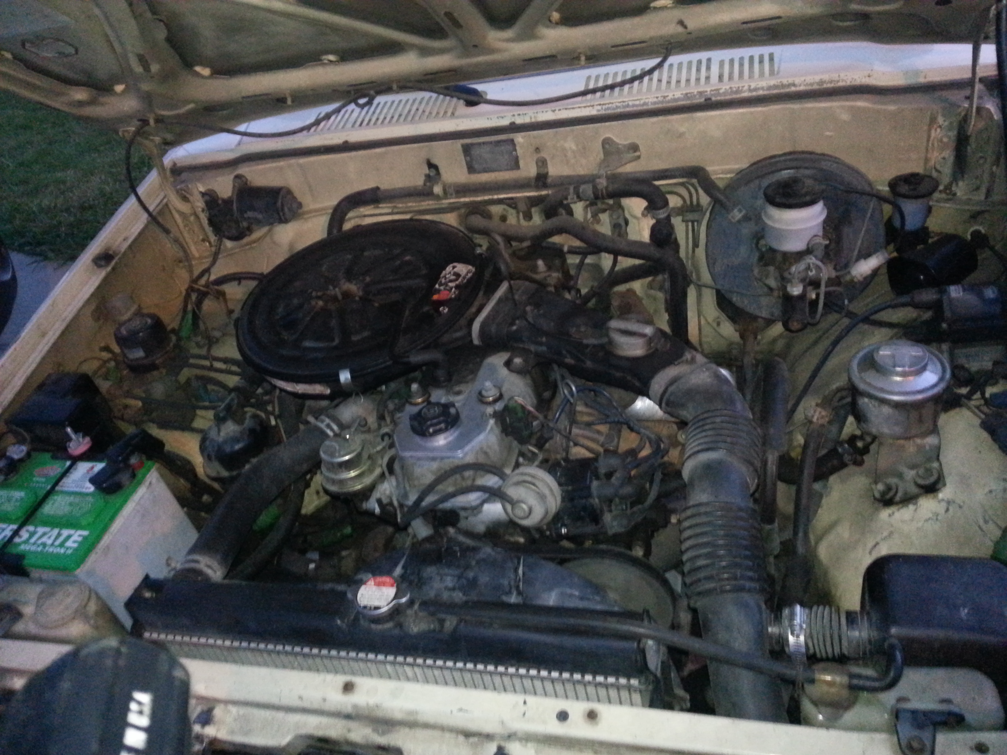

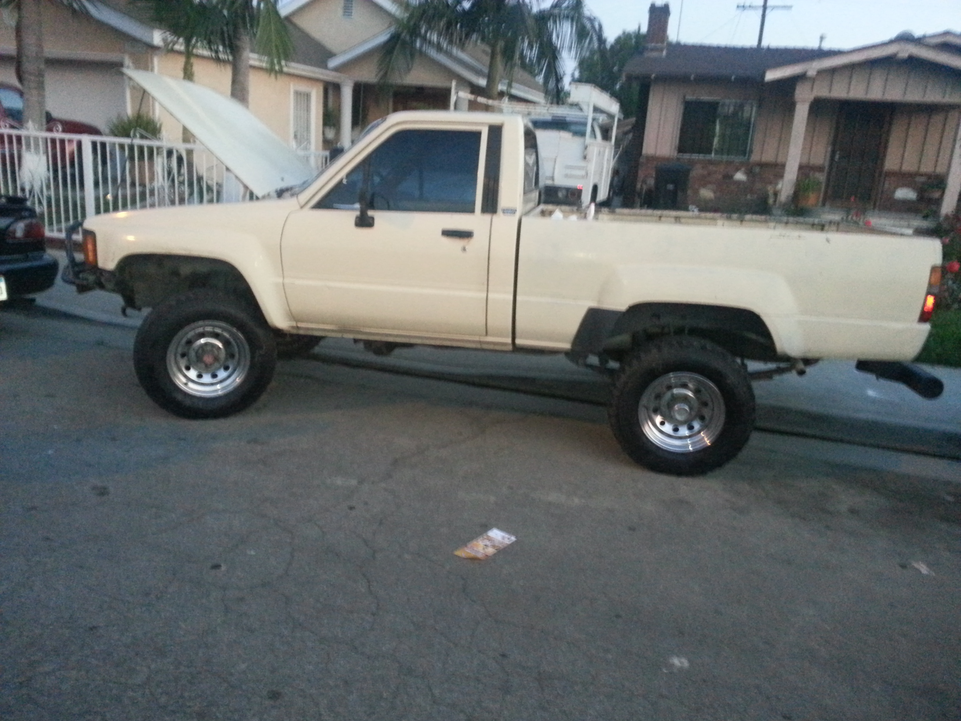

Also, My friend bought this truck a week ago off a co worker.
I have to say this thing was an absolute mess when i went to look at it with him. I needed some MAJOR work done to it. It is an 86 IFS toyota 4x4 regular bed pickup. interior is completely trashed. Foam on the seats are missing chunks, the entire engine was covered in oil. aisin hubs are hard to turn, 29"/9.5 bald tires, horrible extended bed roll bar. and ridiculous looking front and rear bumpers. Tons of miles on the odometer. i believe about 324k. rust on the bed. a few small dents, a couple big dents. 22r motor. etc etc.
Anyway the guy was asking for $1800. and my friend brought him down to $1100 My friend gave it a couple of washes. Degreased the heck out of the engine. and had a family mechanic friend change out the water pump and some seals on the engine that were leaking really bad; the friend did the work for free. In total he has only put in $46. and the truck is already running strong. He installed a brand new battery that he had laying around, and the radiator was apparently brand new. it was just dirty lol. So thats another thing out of the way. He said hes gonna do a full tune up, rebuild the carburetor, possibly injectors, and hes gonna do the timing belt. (assuiming with Marks slightly used belt) anyway here are the pix. I'm really happy i got one of my best friends getting into the yota scene lol
My friend plans to buy Mark's/chefyota's old 31/10.5 BFG A/T tires at the end of the month. My friend removed the ridiculous sized roll bar already.
Here are the pix of his rig.
He was also saying that he wants to do an axle swap vs fixing up his ifs set up. He would rather go all out vs spend money only to replace it all. So he also wants to buy Mark's extra solid axle.
Keep in mind my friend is a Big rig trucker. and the place where he parks/stors his truck at provides a maintenance service to their renters and my buddy made friends with the guy that provides welding service and apparently he's going to build him front and rear bumpers. Similar to the warn bumper look (for the rear) and some rock sliders like mine.
IT was funny because when i met the guy i had taken my truck and this welder guy also drives a lifted 91 extended cab 3" spacer lifted 4x4 pickup. its clean. but man did he go crazy on my truck. he loved it so much. taking mental pictures from every angle gettting under my truck to see how stuff was welded and such. i felt like my truck mustve felt violated lol anyway My truck gave this guy a ton of ideas. and he wants to experiment with my friends truck first before he works on his own. So looks like my friends pickup is gonna be his guinea pig lol this is also the guy that is gonna do his SAS. They just need multiple pictures or in person views on how its all done. so i'm guessing theyre gonna need to see my rig in person a few times.
Oh and btw He was telling me today that he thinks it has a locker in it because when he peeled out yesterday the tires both in the rear went off together. and he said he hears pops from the rear that are felt throughout the truck. I told him it may be possible. but i'd have to take a closer look at it. either by lifting the truck on a jack and turning the tire and seeing if they turn together. or by removing the 3rd.
Anyway i'm really happy for him. Glad we've added one friend to our offroad group.

Wow, what a great find. .... looks pretty salvageable! Glad to hear it's running great too!

its carbed the aircleaner is the telltail
nice little truck rust is no biggie tell him to go look at terry's projects!
if he were in ANY state but socialist republic of calif id say upgrade the carb to a weber 32/64 better idle systems, performance and MPG
but rebuilding the carb isnt hard on the asian ons just the wear on the throttle shafts thats the pain if they're worn theres no fixing them he'll either have to get a new carb or go to a machine shop an get the shafts removed bronze bushings put in an then the throttle plates reinstalled with the shaft ive got 3 dead carb bases in the shop due to the worn shafts
just something he needs to know bout the carbs

As for somebody messing with the latch. There wouldnt be any way for that. because when i left my house i had closed the tire swing and latched it upward then drove to the friends house. and we were talking to his brother about 4-5 feet away from my truck. i would have noticed somebody mess with it if they did.
Thank you. I'm brilliant aint i??? lol jk but it will definitely make me feel more safe about it now
Thanks for that info. I think myu neighbors pick up with the 22r has that kind of a carb. its the small square right???
