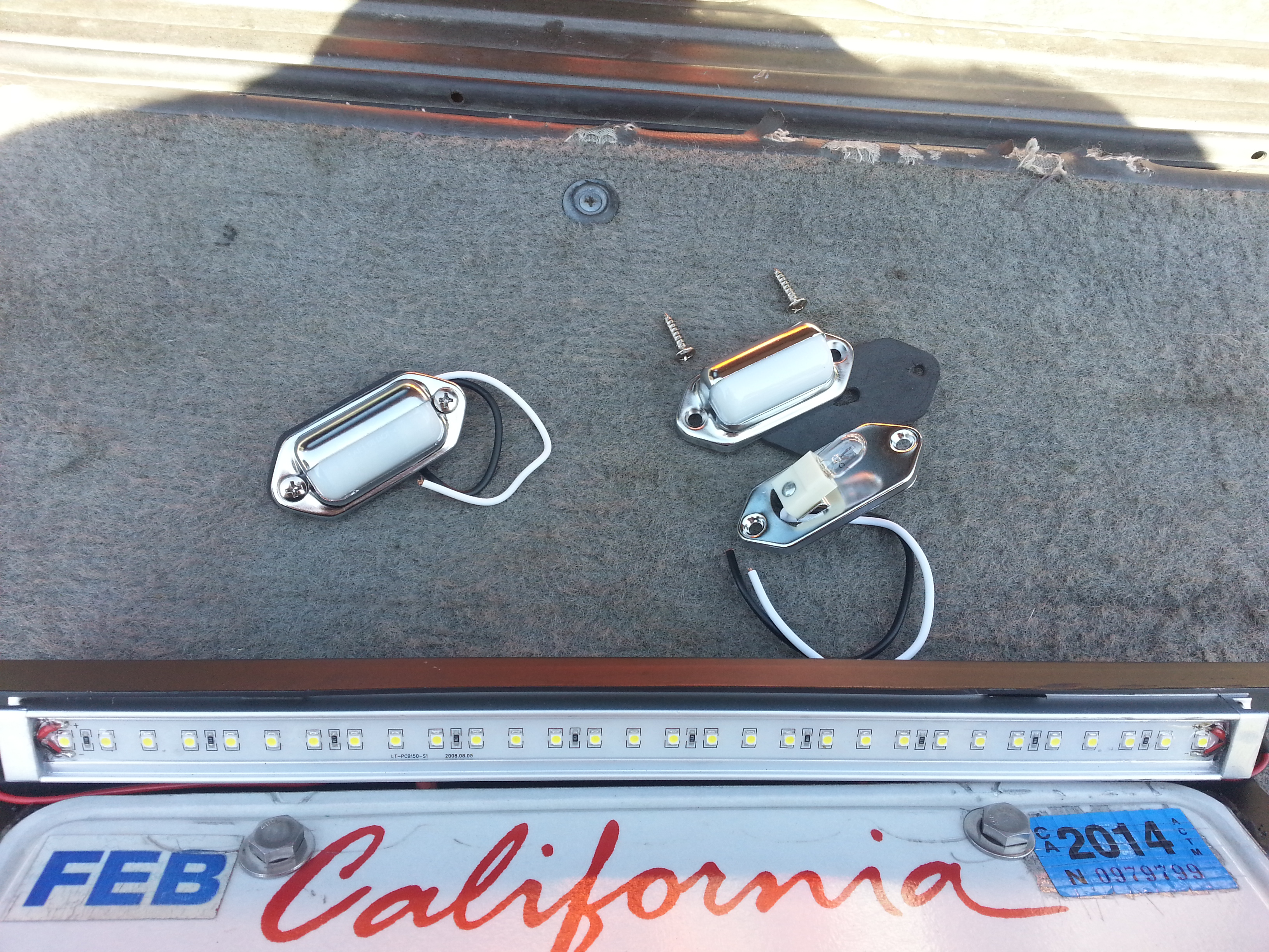

Alright guys. THANK YOU MARK and RAY for your help on this temporary problem i had. Mark i checked out your link today while at work and rather then wait 3 more days i hit up my local PepBoys Auto Prts store and found these! for approx $3.49 each.
you can see the size difference compared to my LED strip.

When i dismounted my LED strip i found that my ground wire, for some odd reason, wasnt making good ground. AND THAT IS WHY THE DARN LIGHT WASNT WORKING YESTERDAY! I honestly have no clue to why it didnt want to turn on because i soldered my wires together but w/e im happy no wires were burnt.
As for your guys's questions about the tail lights being burnt or bulbs as mark asked. That was not what i meant. i had meant the lights on the LED strip wouldnt work. The tail lights would all work fine. but like i said i got to the bottom of this mystery today.

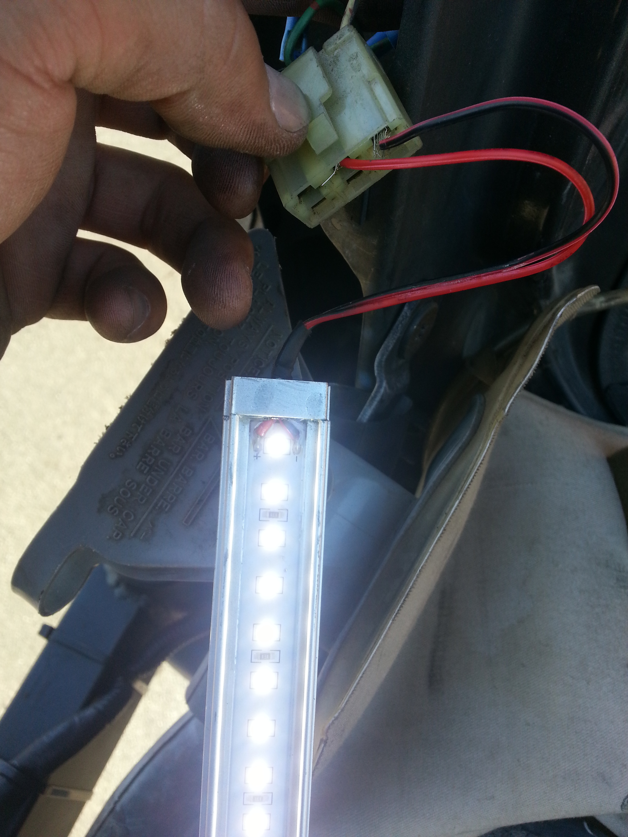

Here is my driver side tail light taken off. I connected my LED strip to the top 2 connectors on the right hand side. The colors were White with black stripe, and green with red dots. In the end these are the 2 wires that i tapped into for the 2 license plate lights that i bought.

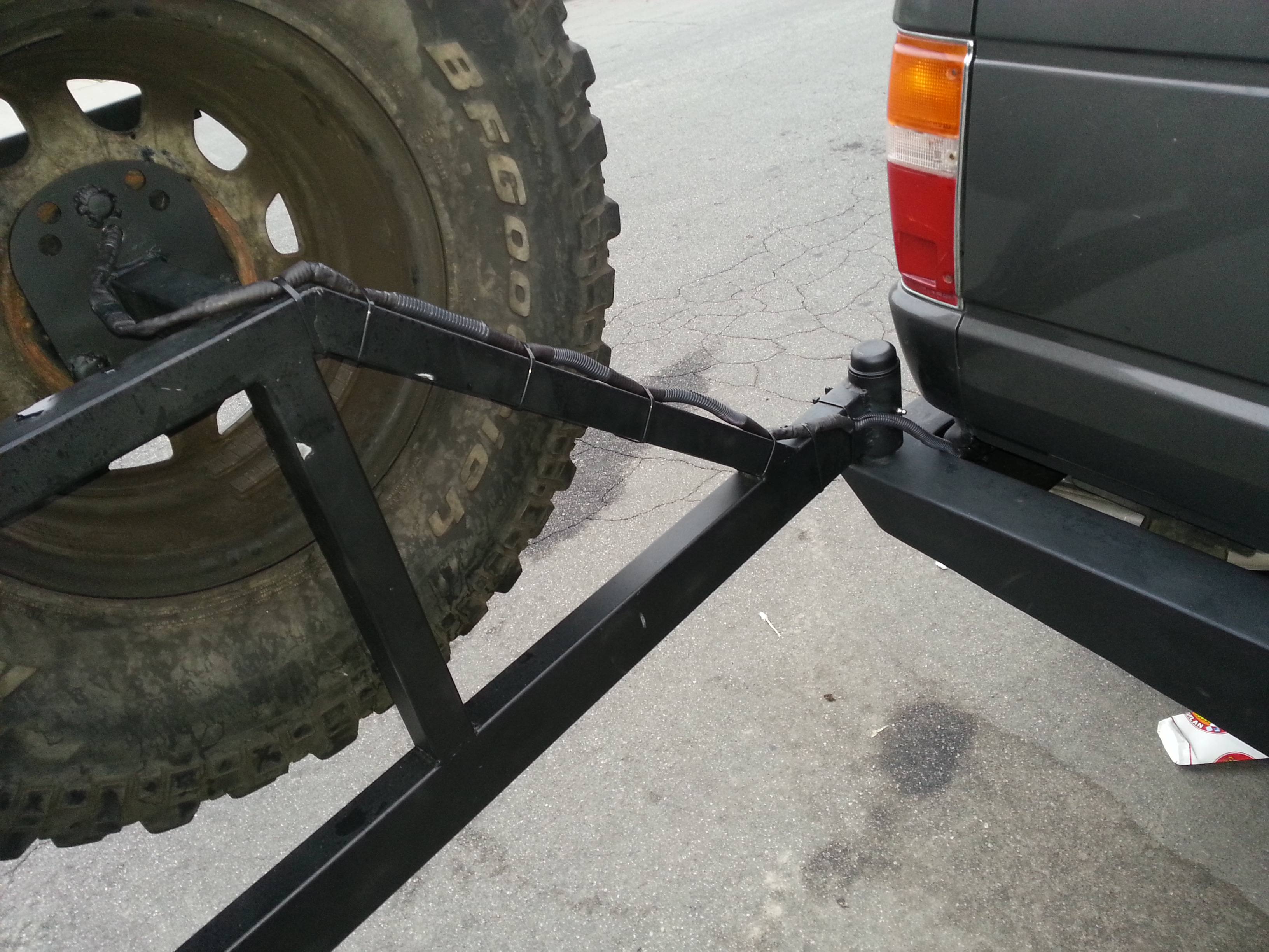

I routed my wiring from the license plate, through the tire carrier back plate hole, down the tire swing, under the truck and into the rear driver side panel. I used that plastic wiring cover wrap whatever that stuff is called, along with some shrink wrap every couple of sections(just to hold it closed)

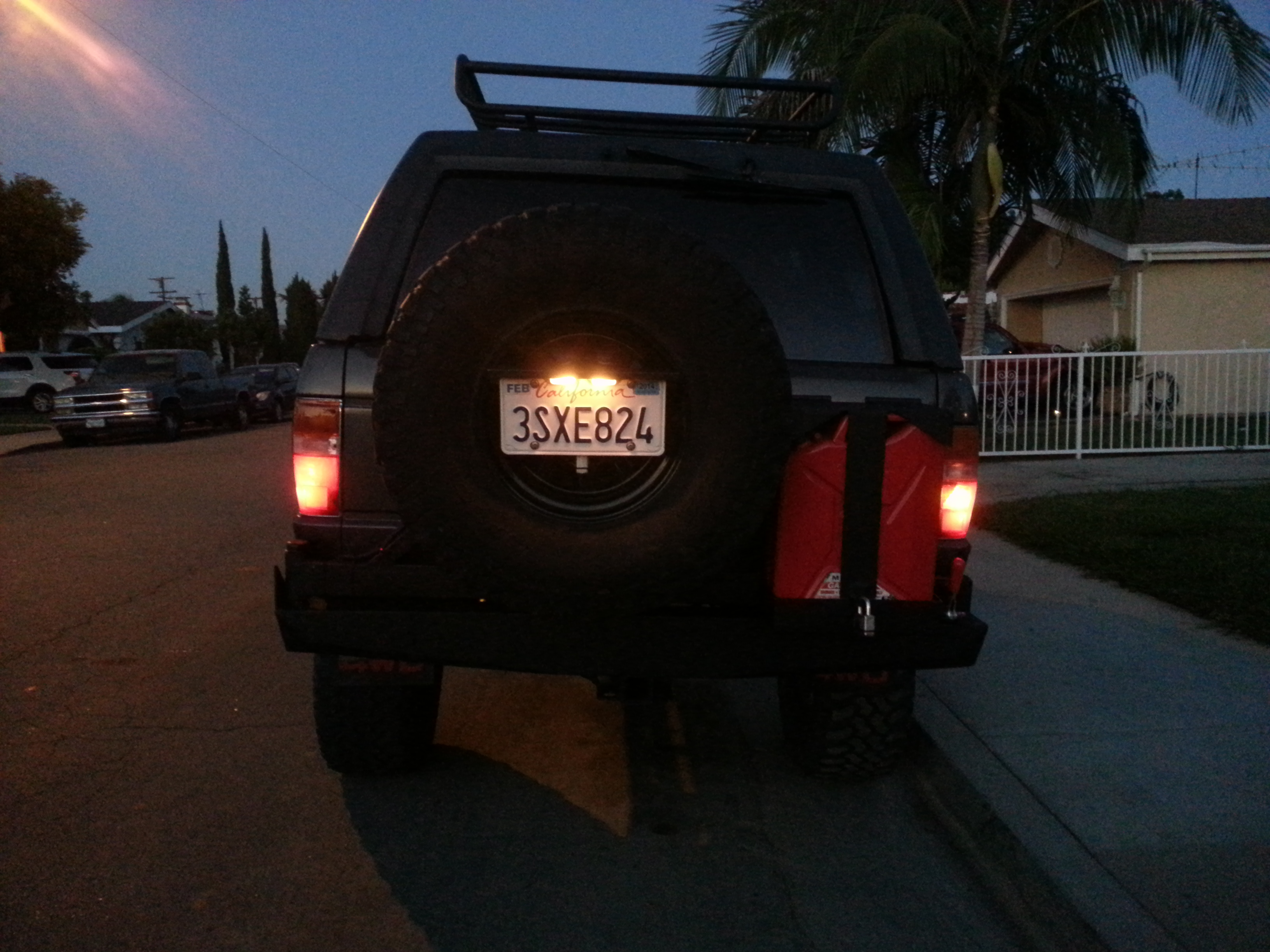

Here is how it sits as of now. No need for special switches or running power and ground wires anywhere. Just tapped into that red light like i was supposed to from the start lol.

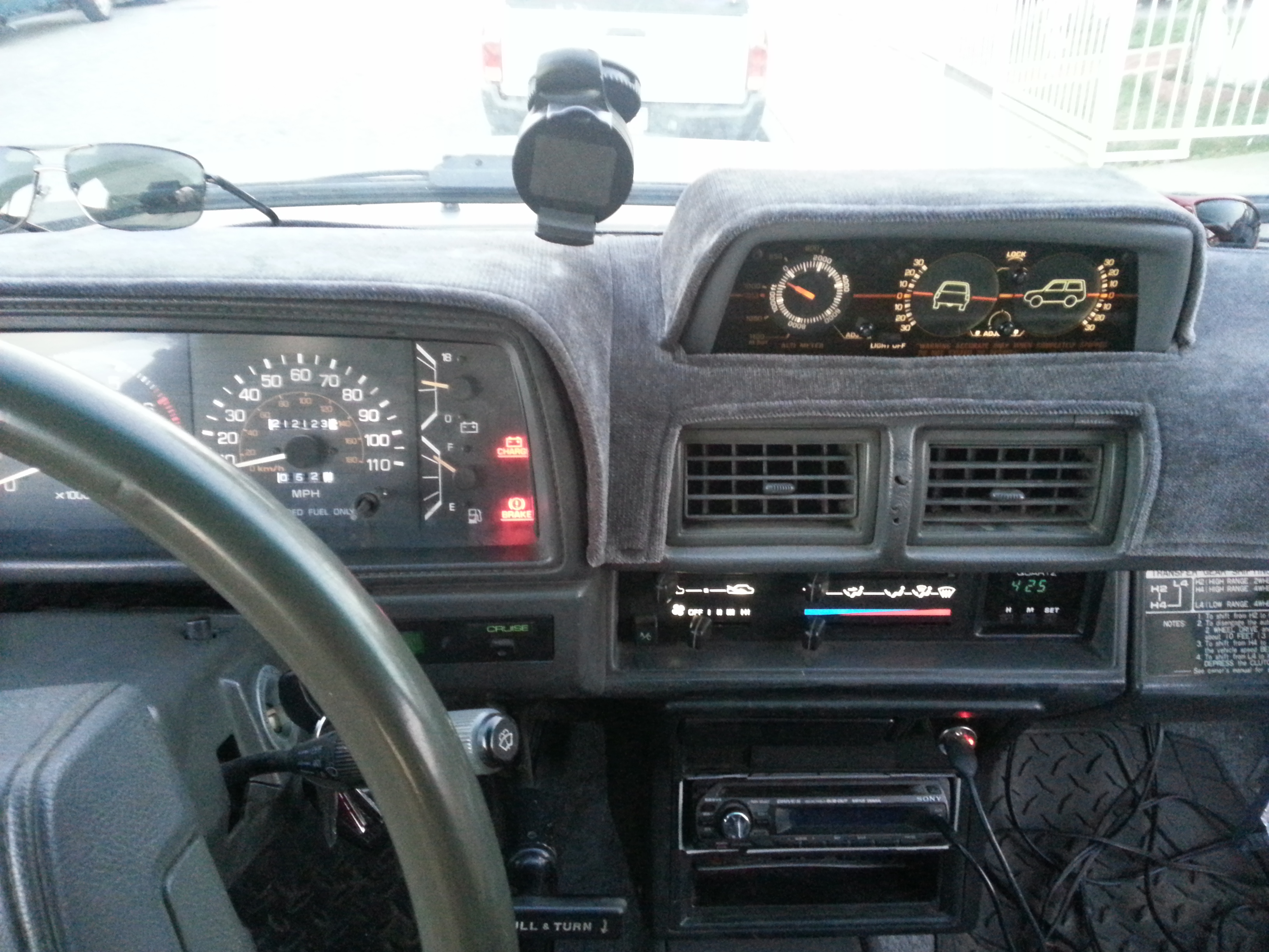

OH yea and i also installed matching LED lights on my inclinometer. Now my dashboard all matches with Cool White LEDS! woot!
