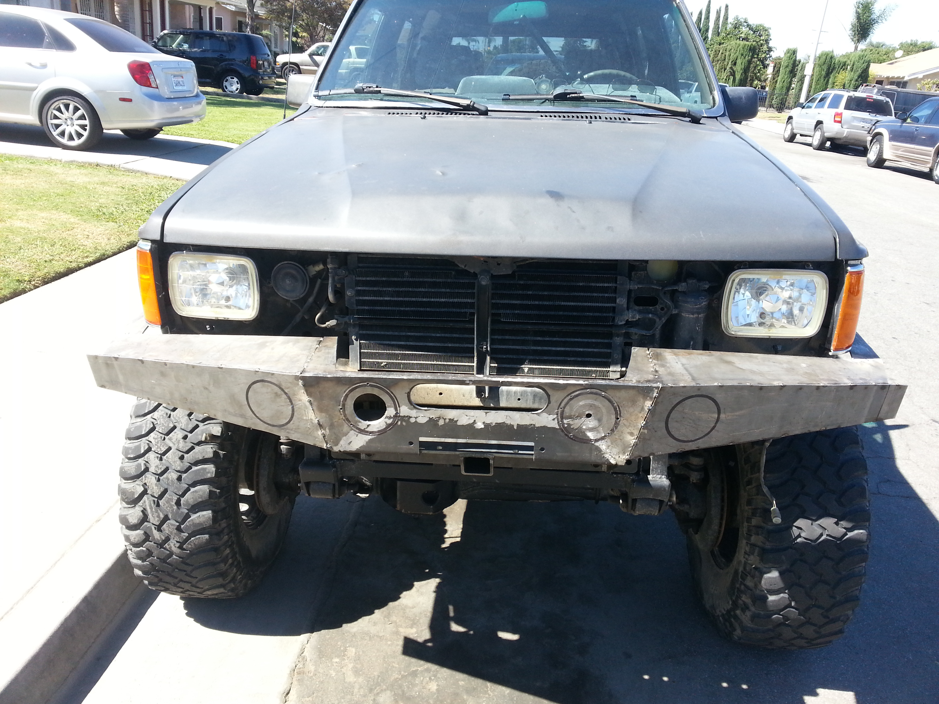

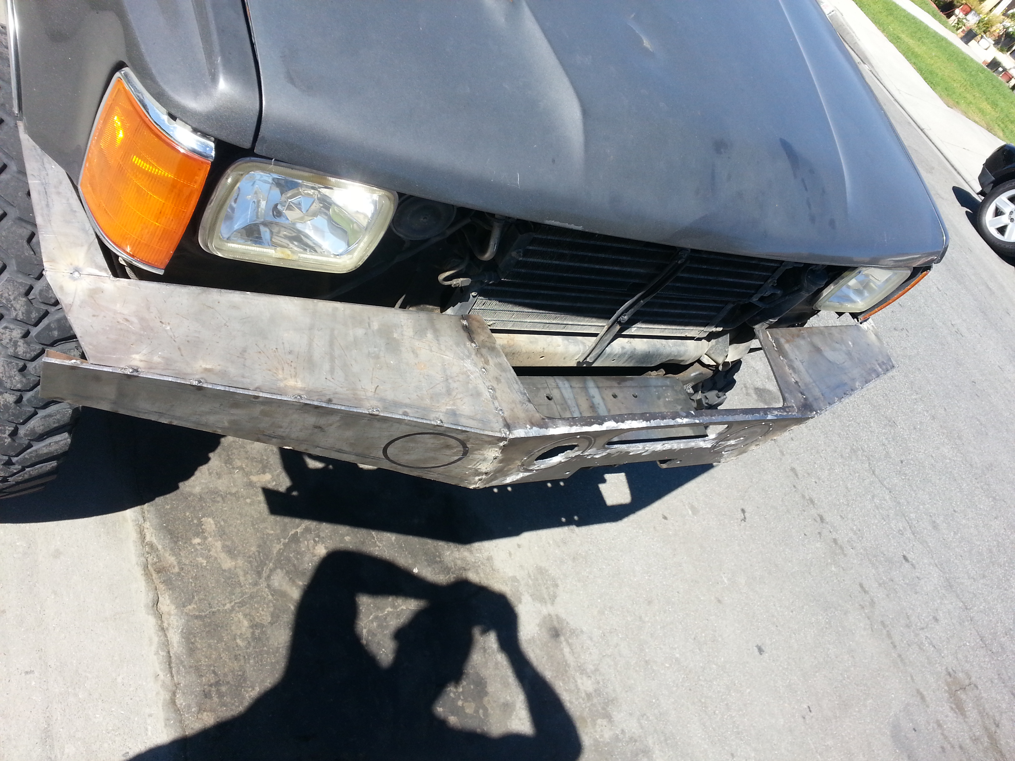

The grill i already know is gonna have to be cut. because at the height that the Trailgear winch plate sits with the winch on top requires trimming at least with that top plate part that goes around the winch. I'm going to have to cut about 1/2" off the bottom part of the grill. plus the shape of the box that sits on top of the winch.
I dont think that the frame was bent. when we looked at it while we did my SAS everything looked fine. but i did notice in the past that the front fire wall or whatever its called "the part behind the grill" that part was bent a while back ago. i had to re bend it to shape about a year ago. It's still sort of bent but that can very well be why this grill sat low. Mark(Chefyota) has also noticed this while seeing my truck in person. the grill seems to lean more toward the passenger side and have a slight gap on the driver side. Ive tried to straighten it out but it will only straighten out so much. I believe this is probably what is my problem here. Tomorrow im going to remove my stock bumper and take my straight edge level and set it underneath the grill from end to end and see if maybe its my front that is crooked.

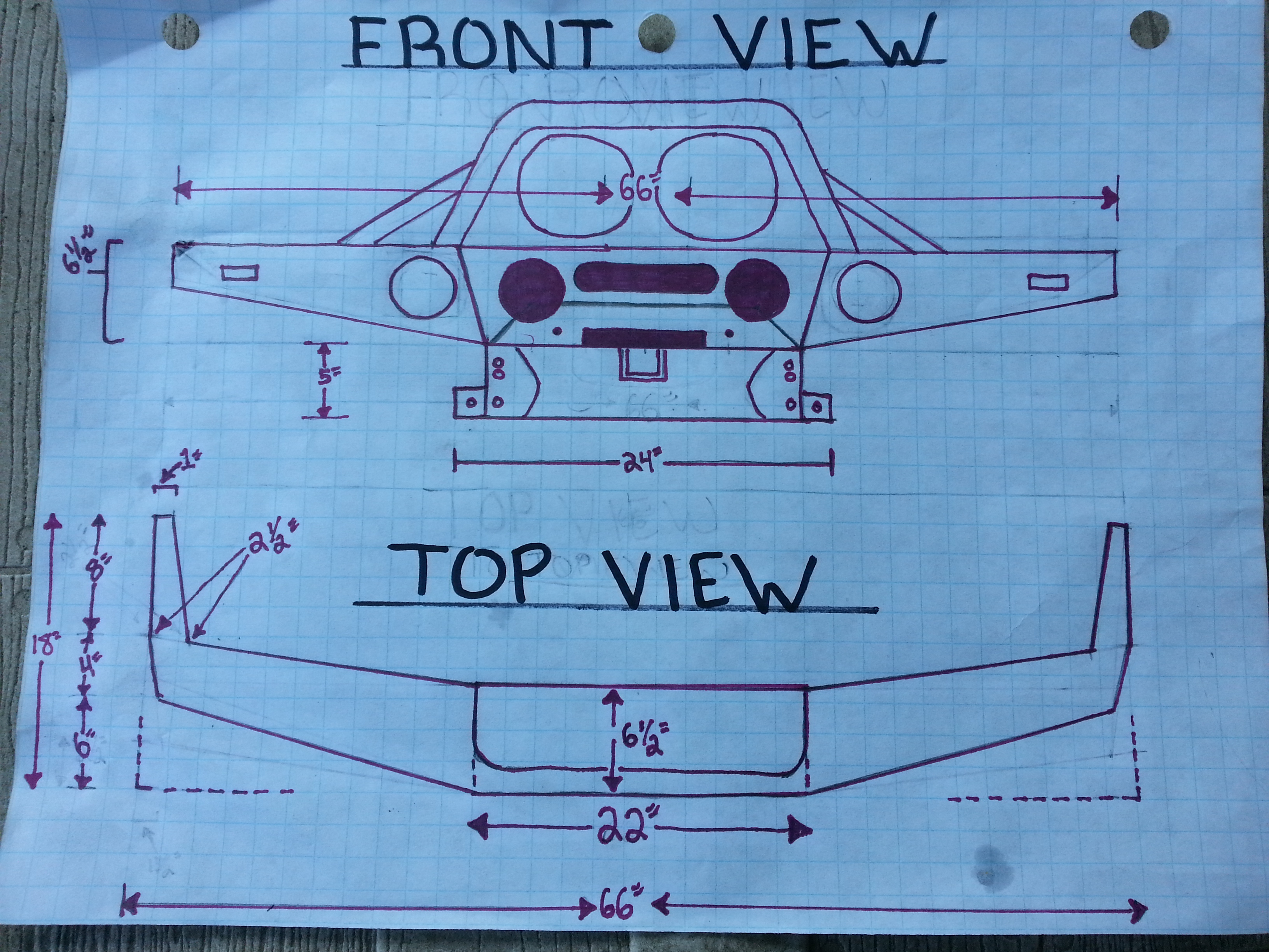

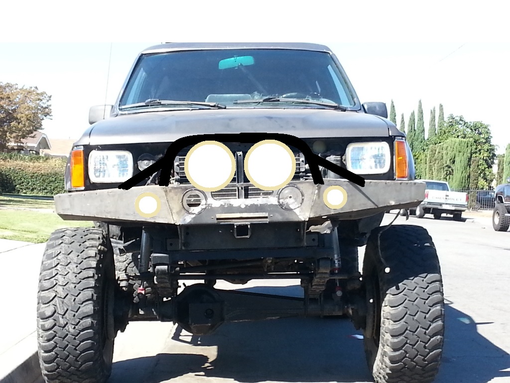

On a side note i drew this up really quick to get an idea of how this bumper would look if i left it as is and added those grill guards with the offroad lights. and this is what i came out with. Once i add the grill guard bars, 4 offroad lights, and the winch i dont think the droop will be so noticeable.
But as of right now I just left it as is. We did manage to get some work done on it. but i don't want to finalize these welds just yet. At least until we figure this crooked problem out. If i end up raising those sides back up the 1/4" that i dropped it then i am either gonna have to cut center part of that bumper horizontally then drop the hole bumper about 1/4-1/2" to make it level. but the problem there is that if i do that then my winch might not fit. The 2nd thing i can do is probably cut the entire winch plate at the mounting points and just bring that down instead. this would bring my entire bumper down without having to cut the bumper or without running into problems with the winch fitting properly. This might be my best bet. But i need to take a closer look at the winch plate again. Either way this winch plate is going to get welded to my front cross-member so it might not be too bad of a choice to go this route.

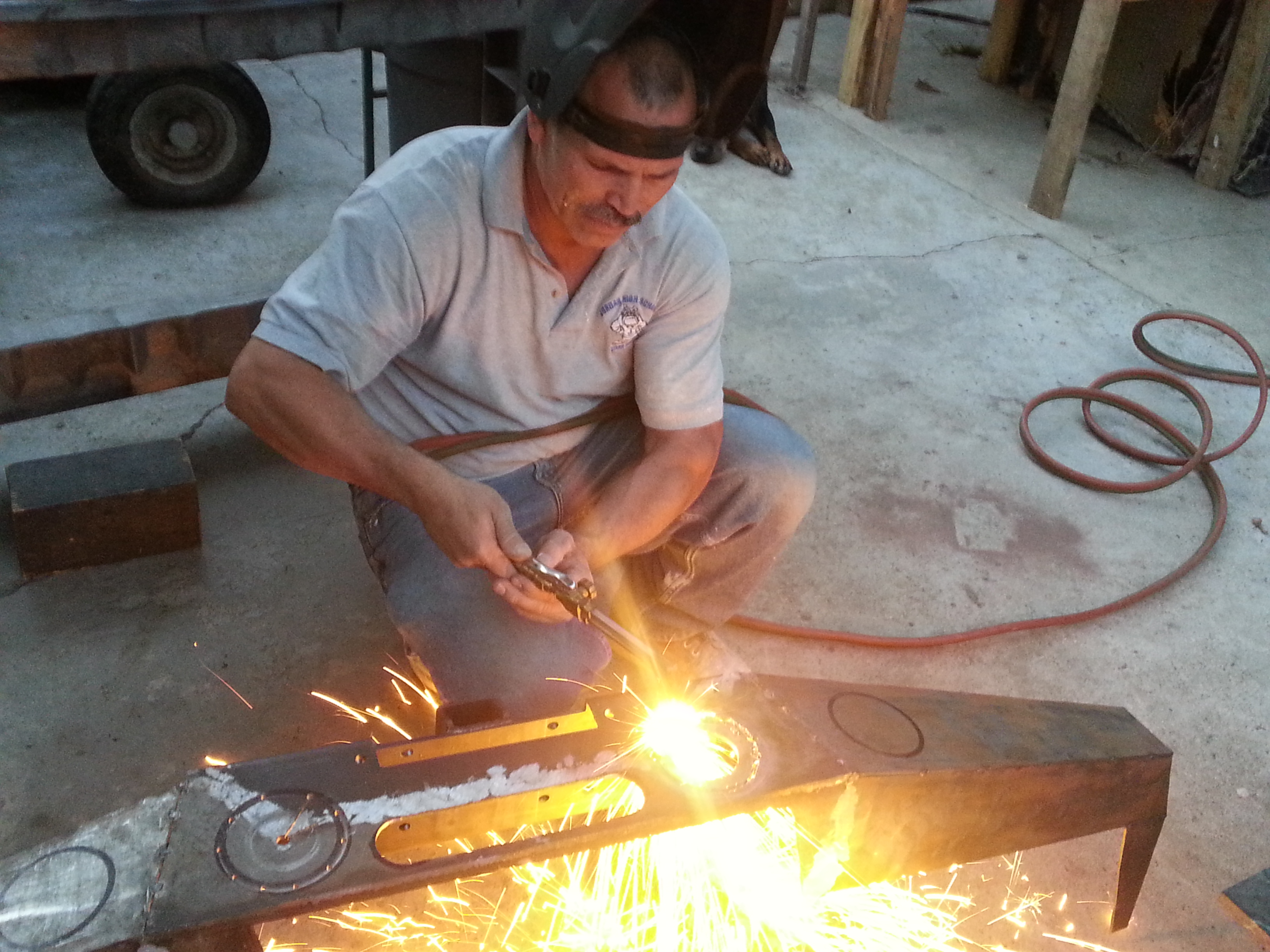

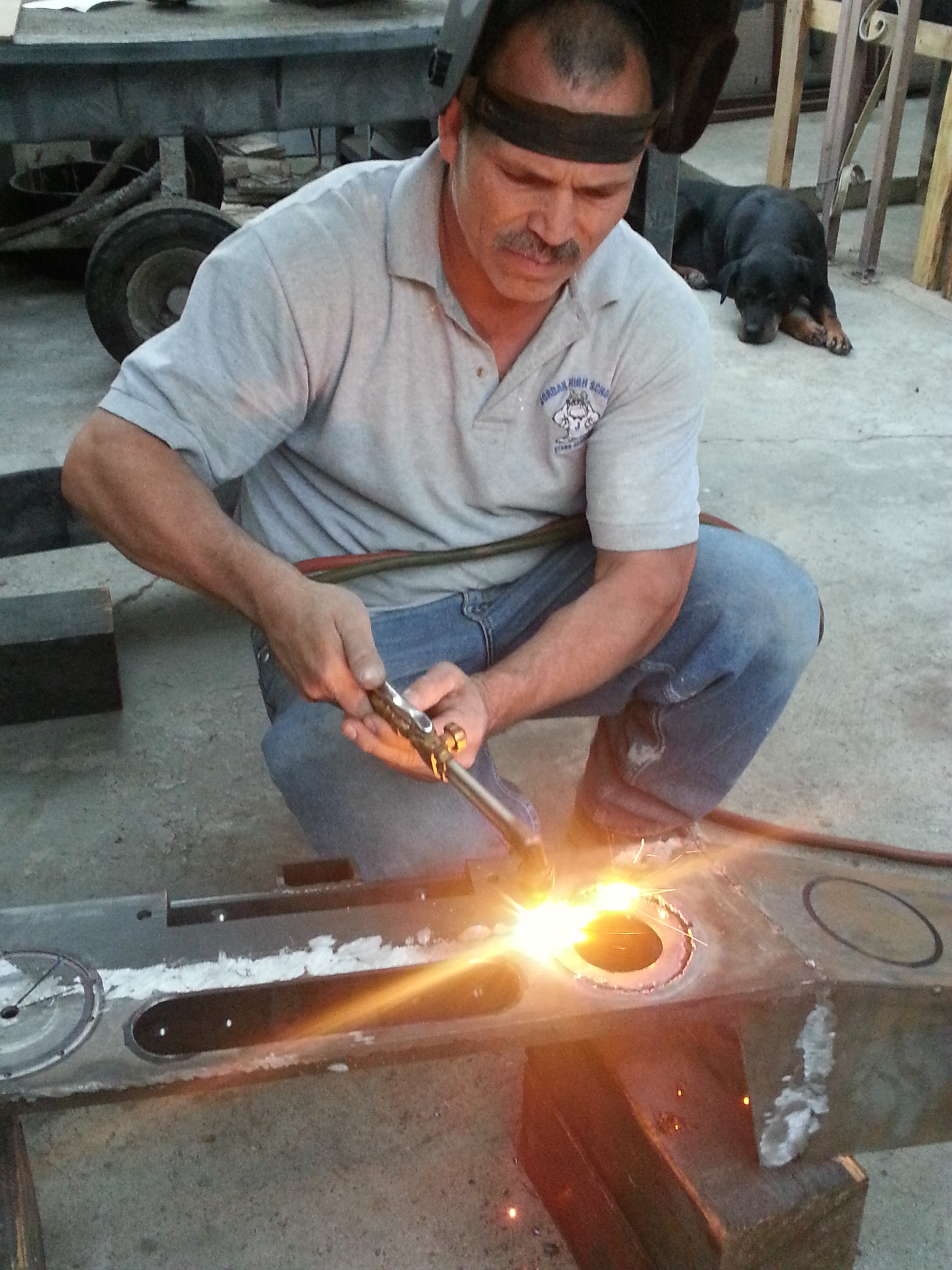

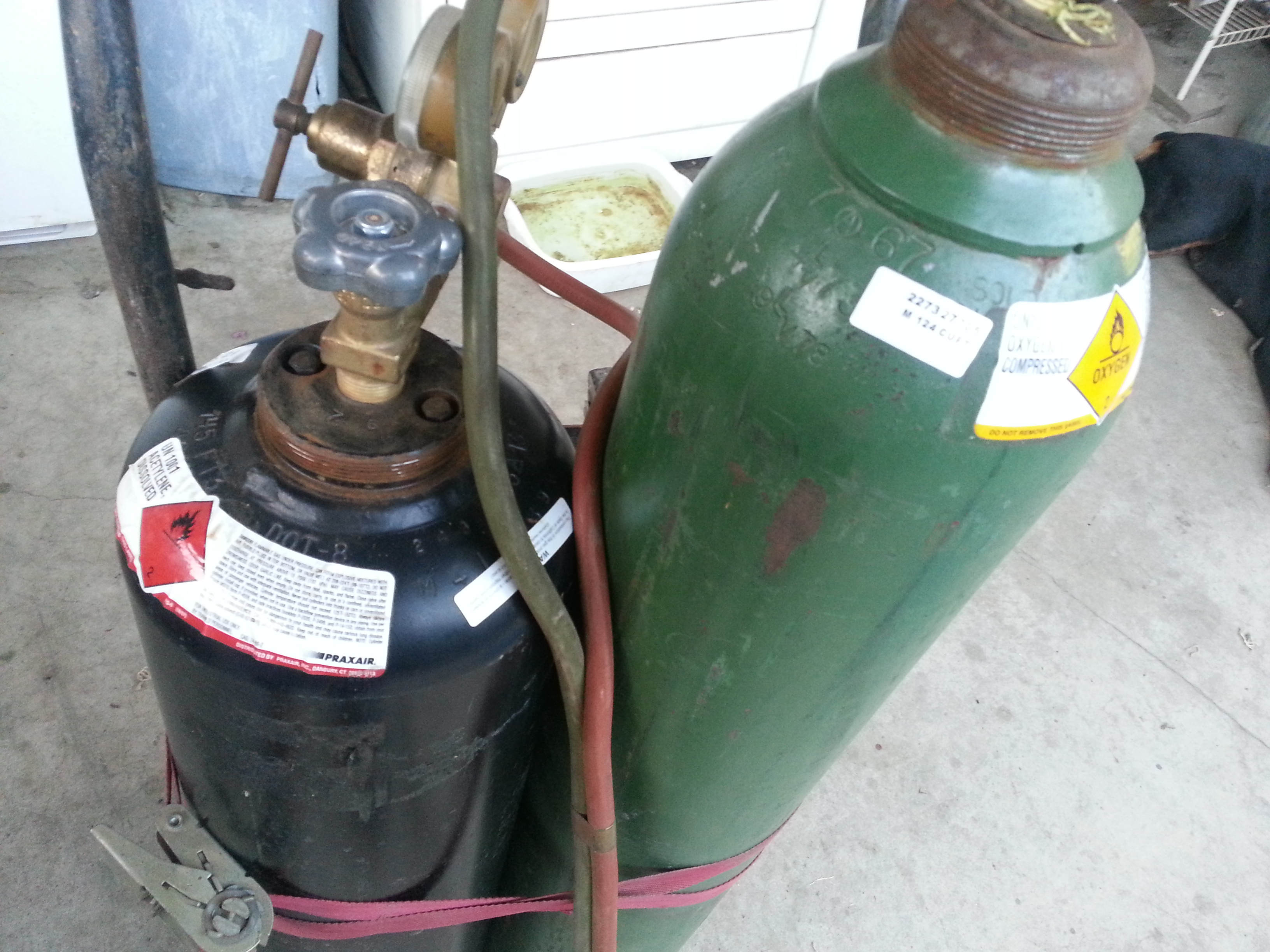

Today i went to the Welding supplies/gas store to swap out my dads expired Acetylene and Oxygen tanks. We exchanged them for some new to us or newly certified full tanks. paid $121. ouch! that one hurt. But i figure i would fill up his tanks on my tab to pay him back for all his help on my last bumper and now this bumper.

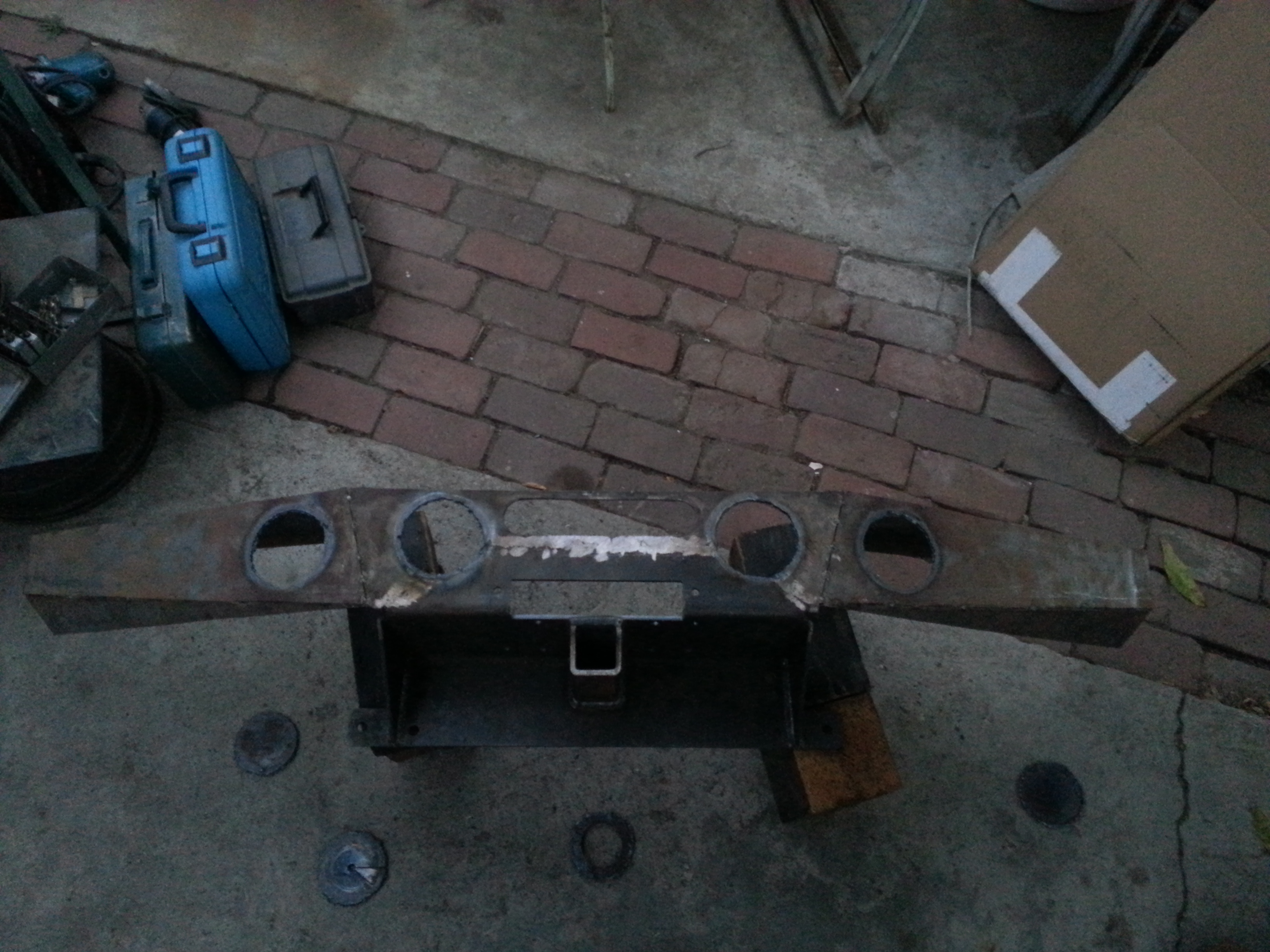

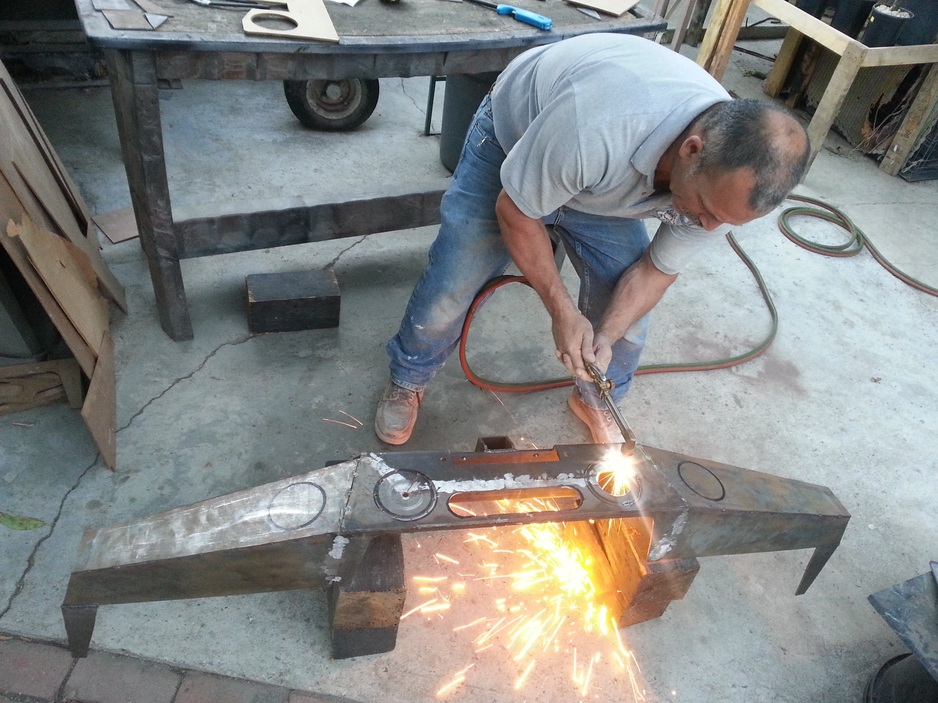

Since we had the full tanks of gas we figured we will just go ahead and cut the air holes and LED light holes already.
Here's my pops working that Acetylene torch
Dont get the wrong idea here. the bumper was leaning back some so the top of the bumper looks like it has a bigger slope then it really does.
Not bad. His cuts came out much better this time vs the time we did my rear bumper. Tomorrow, after work, i'll have to head to Harbor freight and buy a hole grinder and sander to smooth out those holes.
