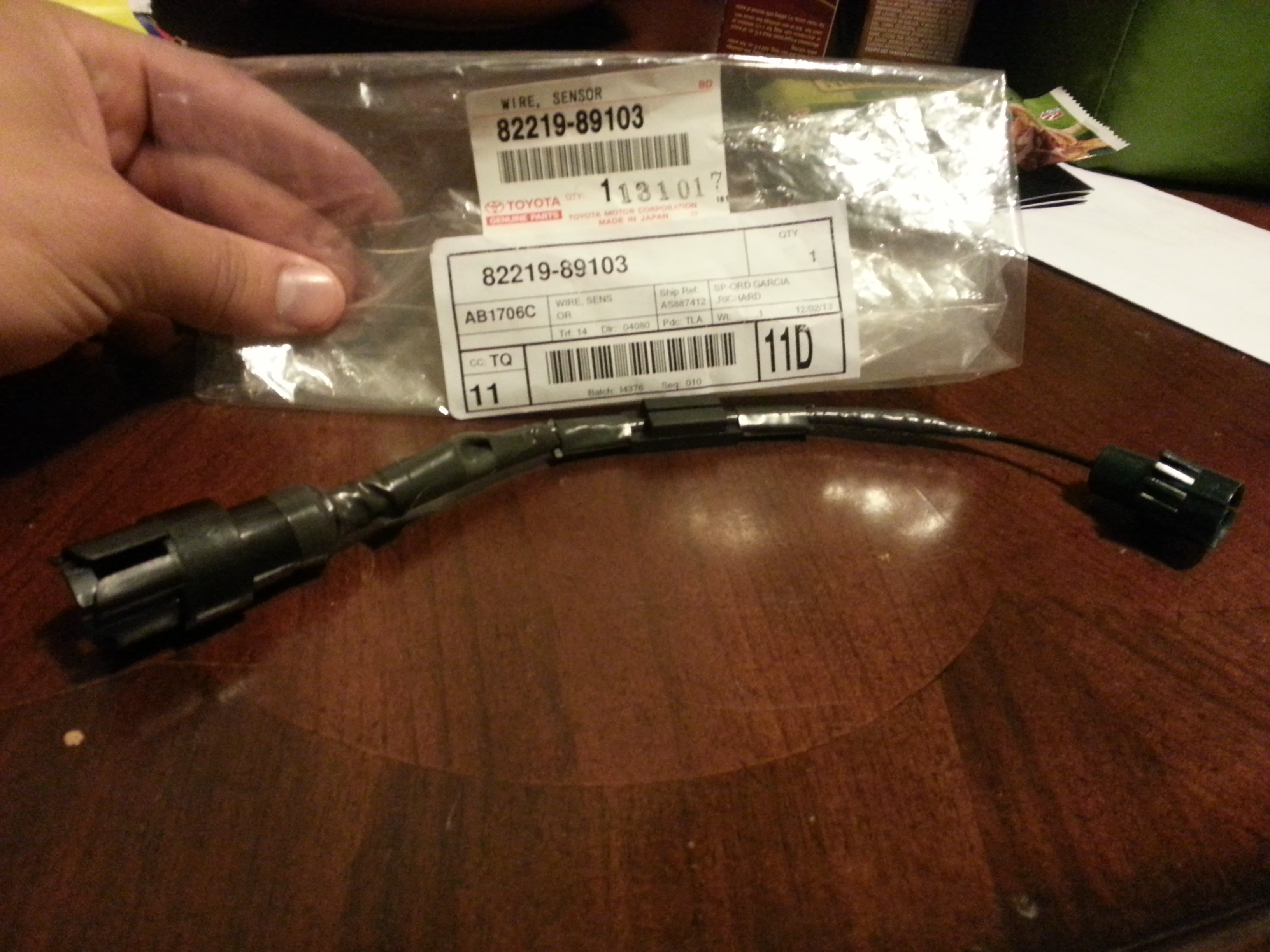

But I did however go pick up my parts!
Knocksensor connector wire from Downey Penske Toyota for $19

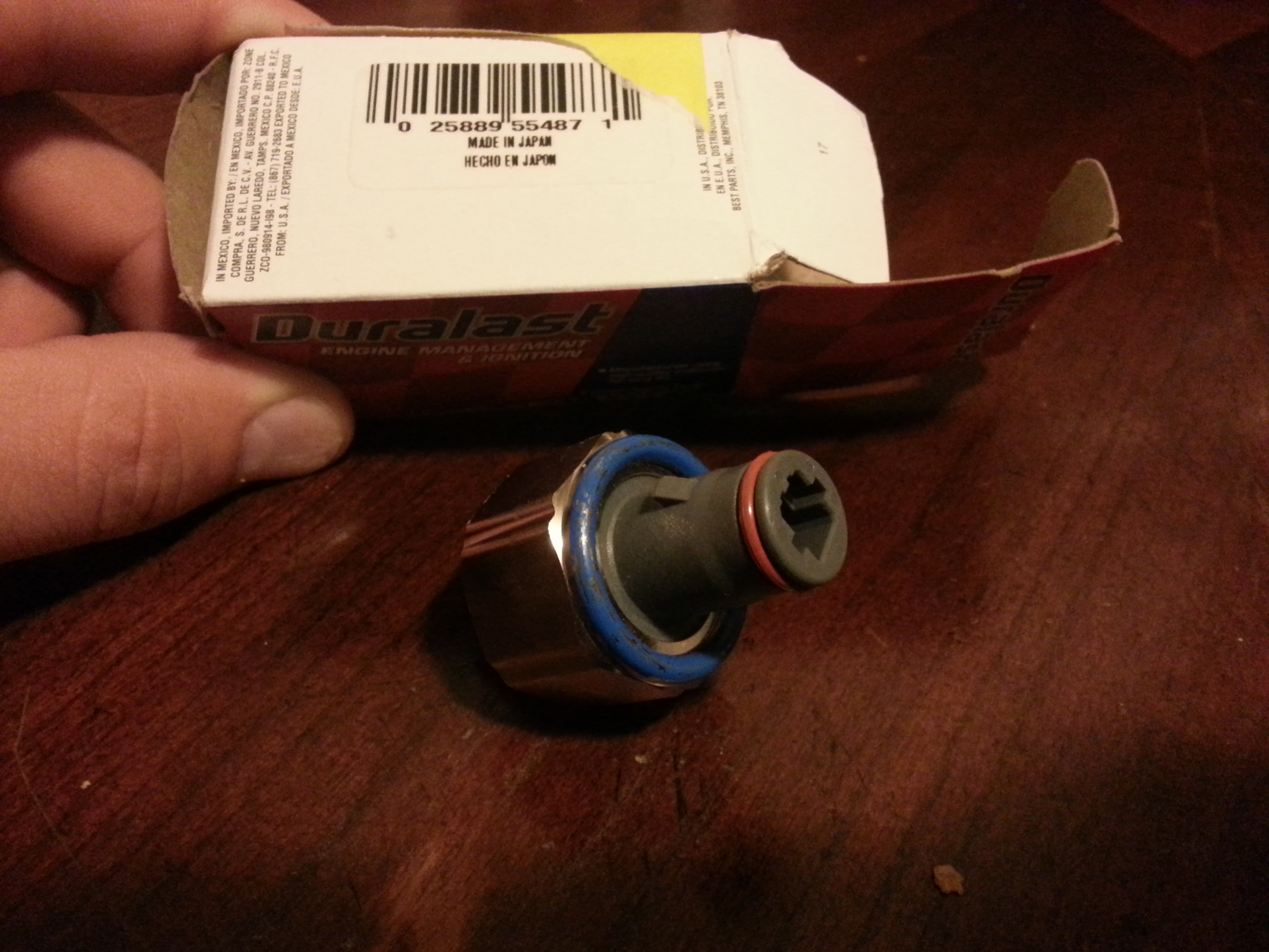

And Knock sensor fron Autozone. Surprisingly made in Japan. Lol costed $259.

all i can say is good luck with that sensor as i mentioned others ive read have moved it from the really bad spot they put it to elsewhere on the engine simply because of how bad it makes things when it fails

Holy smack me in the face and call me Suzy- price! Really? $259 at autozone?... Obviously you checked dealerdirectparts.com and Toyotapartszone.com and so forth... ... What were they asking?
Best wishes on that... I will be praying that it doesn't snap off in your intake or something. I hope you have a trouble-free process we're nothing else breaks and as few parts are needed for replacement in the process. Are you going to replace your intake gaskets? Maybe give your throttle body a really good cleaning( obviously being extremely careful not to get the TPS wet ).... ? At first I was thinking maybe this was causing you're stalling and such... It can't always be the idle air control screw... I was wondering what was causing that... Then I thought maybe it has been retarding the timing for a while. However, if I remember correctly, this code just came up recently, right? So, that's probably just coincidence. The long and short of it is that this is a pretty common one... I just feel bad for you that you couldn't get through the entire life of this motor and then do your swap, before this happened. But I commend you for going down and practicing, you should have it in a breeze man! Might as well change your plans while you're at it... Right?
Best wishes!
Yea its a hotrinle location. But I heard there are bad things that can happen by moving the location to it. Supposedly it won't work properly or something like that. But I do understand why people do it. Totally makes sense.

Yea dude. Toyota stealership and Napa were both over $280. Some of the ones I browsed for online had so so reviews. So didn't have much luck on finding a good deal. And the 3 I found at the junk yard were all in horrible condition.

as for the knock sensor its a microphone tuned for the specific sound of a knock (predetonation) anywhere on the engine when its solidly attached should work as metal is an excellent conductor of sound
