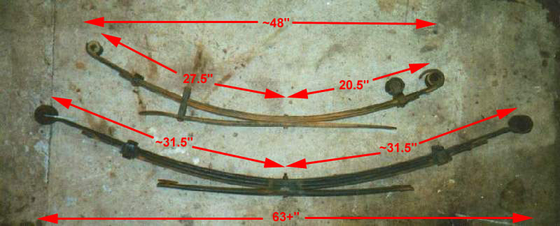

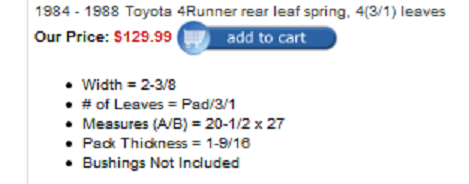

As far as 63's, think of it this way.... our Springs stock were 48 inches, and from the center pin they are I believe 22 inches forward offspring from the center pin and 26 inches of spring behind the center pin. The 63's which are actually I believe 62 inches, Toyo can correct me if I'm wrong, the center pin is in a much different location, where as far as everything I read you are then required to move the rear hanger 12 inches back and the front hanger 3 inches forward. This bring the front hanger lower to the ground causing more lift, because that portion of the frame is angling down words towards the ground as you move the hanger forward, it thus brings the hanger closer to the ground.
I did a lot of this in my thread, but I have some great links for you from a site that pretty much puts all the professional information out... General spring I believe is the name. Let me go get it for you, as it will help explain what I mean by the center pin and where certain Springs have to move in order to ride in their intended center points... Kinda get what I'm saying?

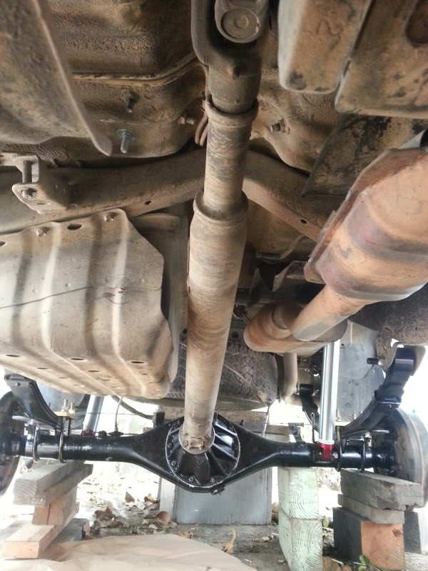

i see what you're talking about. now that i think about it my shocks are mounted pretty vertically Still at an angle but yea they do need to be at more of an angle. I have also seen a few people mount their shocks in an / \ type of angle mounted from the middle of the truck to the shock brackets.
the only thing i don't understand i'd that my shocks are pretty much mounted the same way how my neighbors truck. i just think the only difference is that he actually has a bigger lift. i need to ask him about to his shocks. Need to see if he has smaller ones or bigger ones then i do.
I like your idea Toyo definitely gonna take that one into consideration. like u said. even if i do get a higher lift the shock wont be too much higher then what it sits at now. thanks you!

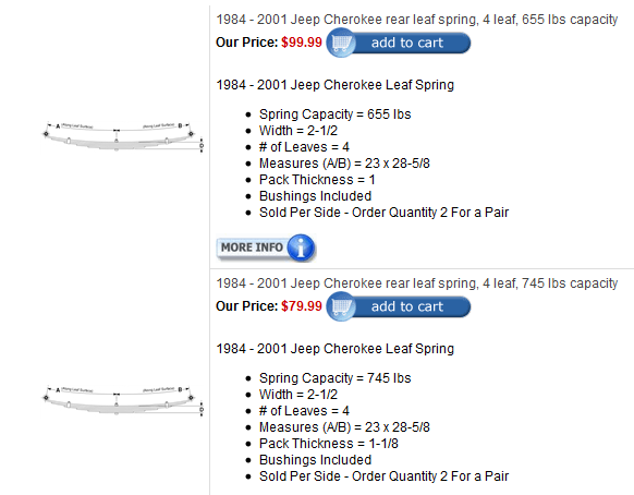

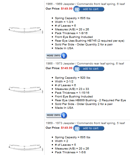

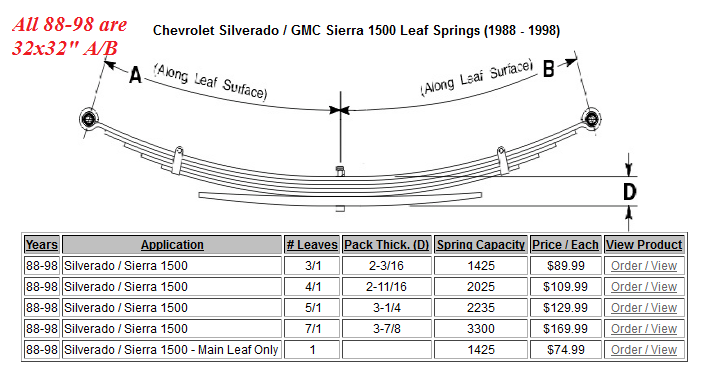

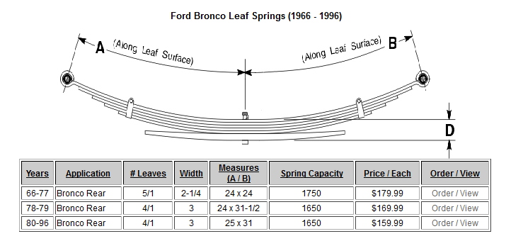

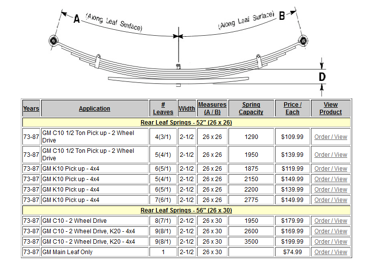

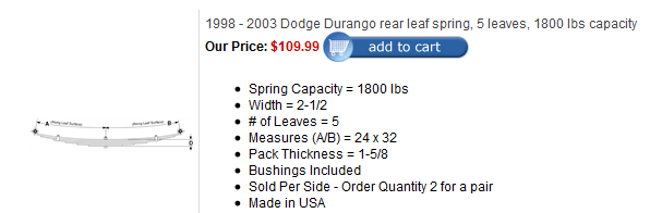

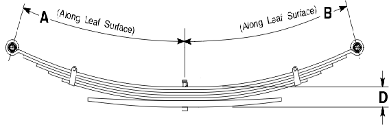

This shows the A/B points and Then D / thickness......

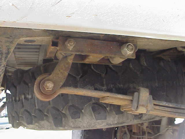

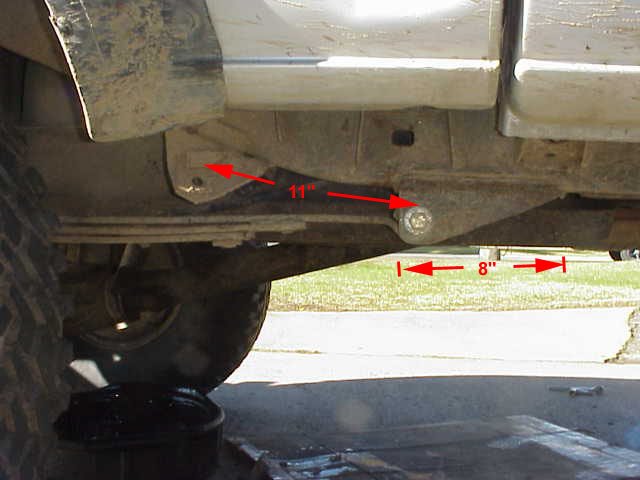

This shows what a dude displayed to explain how u move the front hanger 11" forward on the chevy 63 swap... I think 5" back?....
Now side by side.....

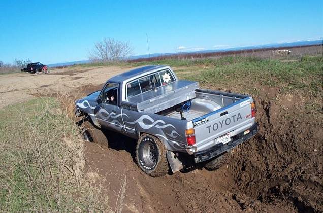

Here he shows his dual shackle set up (which many say are dangerous on this swap and not for the occasional wheeling person? But u can do more searching on that....
Here is his result....

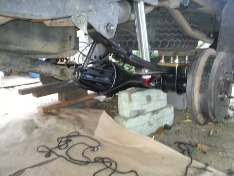

Mark check it out. This is where my shock sits at mounted on the axle.

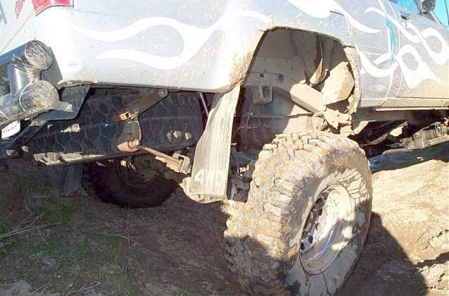

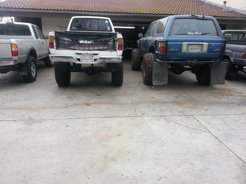

Look at where the shocks are mounted on this white truck. they are much lower then mine. i think i messed up. maybe we should have welded them a bit lower huh
this is the size that Allpro recommended for me to buy. say 10" in the front and 12 in the rear. Im wondering how exactly this is supposed to be with these shocks. Maybe i need all 4 shocks or something and still adjust the rear shocks. idk...

Also note that his fender is dramatically cut out higher? So his droop is not as great as it looks due to the cut out.... BUT, it probably can droop more! Lol. .. and the stuff means he is way beyond the stock lip cuz he cut it, KWIMean?
Yeah, and that's all I was trying to say (Toyo too I think.).... Sorry, I got excited, hehe, but s' all good, it's all good info....
And it's a cheap fix. ... but when u flip the plate u flip the tab, ya know? They're cheap, and maybe u can save these? If u wanna use a grinder/cut disc to shave the welds and then reweld u can maybe? Or 12$ per side from sky? Yeah, that is not gonna work.
Also, some guys just weld the tabs both on the same side, unlike stock

Nooo not the blue truck. the white truck on the left.
