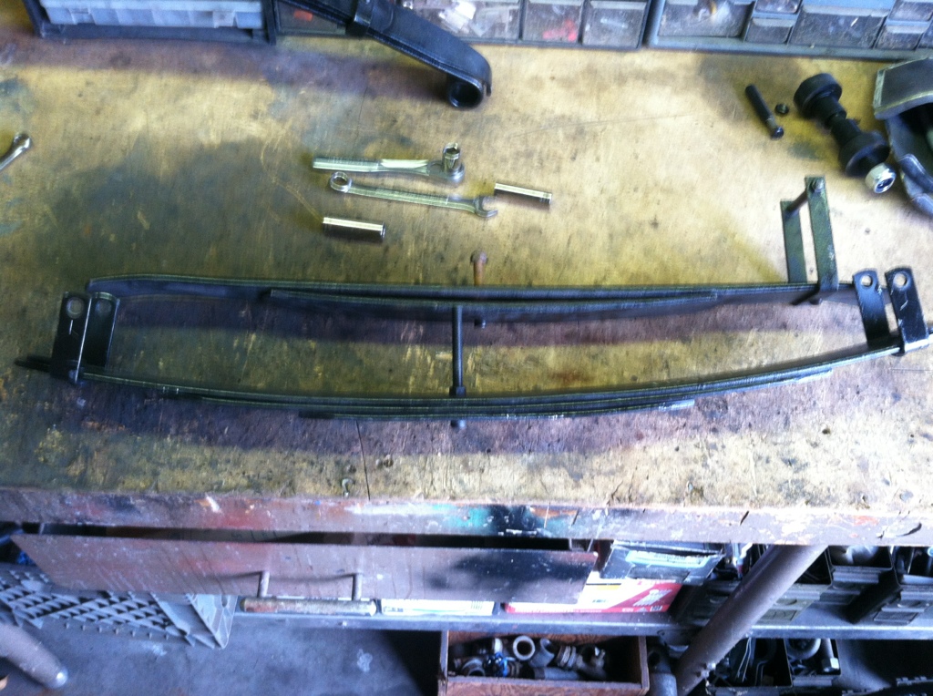

Like you've found already, most everyone who does the 63" springs has to use add a leaves and/or blocks to level it with that much lift in the front. Can't really give you a good review on the setup yet, but give thought to a progressive helper pack like Wheeler's or Deaver's
http://www.wheelersoffroad.com/9504tacoaal.htm
Here's an idea of how much arch they have so you can decide if it'd be enough to help you
Regardless of what spring setup you go for, you're going to need to address the shocks. You definitely should have more compression left in the rear. Been following your build quietly for awhile, looks dang good!

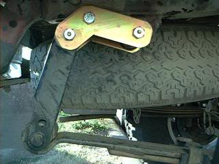

i think this is the way to go.

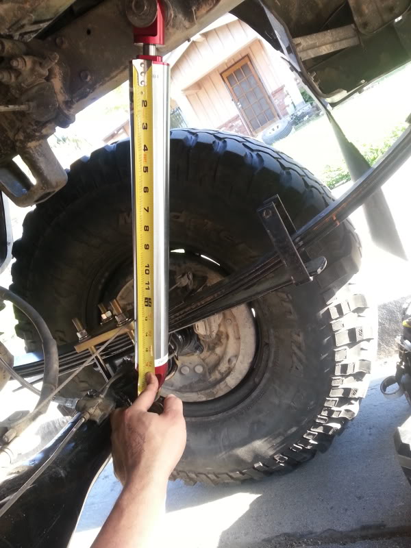

So Ruben and i both had the bright idea to look past the obvious. That being that the leaf springs obviously sag about 1" too much. So With that idea out of the way i know im gonna be upgrading the leaf springs further down the line. But The Sag isnt what bugs me the most its that the shocks are bottomed out. I can deal with the rear sagging 1-1.5" i honestly dont mind it too much. that will eventually get fixed once i get a few more paychecks in.

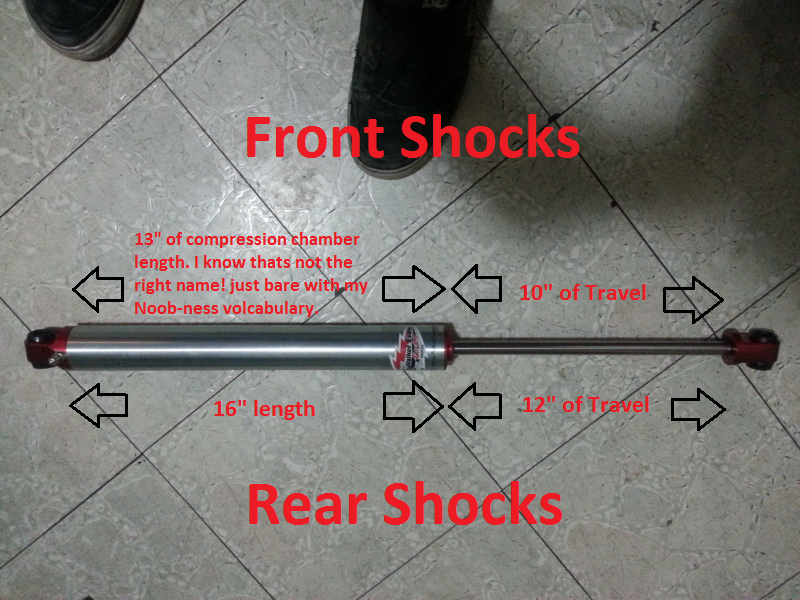

So after looking past that problem we looked toward the shocks. Ruben had the brilliant idea to ask what size shocks did you order? whats the travel. And *DING DING DING!* it was like someone smacked me in the back of the head and said why didnt you think of that! lol
First of all I know on my order receipt it says that i have 10" travel shocks x2 and 12" travel x2. So I grabbed my tape measure and here are the measurements we took.
Our first thought was that All-Pro probably sent gave me the wrong order on my shocks. but that wasnt the case. They were correct. but the compression chamber/reservoir or whatever it is called ( where that shaft goes into) is a hell of a lot longer; by a lot! Check it out so you see what i mean.
Front:
Rear: I honestly dont even think bilsteins are this long.

I know that isnt the part im supposed to be measuring. but something just didnt add up to why they were bottomed out. So look at this.
I dont understand why the shocks were so compressed till i put 2 & 2 together on that last picture. Thats one hell of a difference on length. That Chamber is 3" longer + an extra 2" of travel. Thats 5" longer total extended length. Now i know im still new to all this but i do know, from what i read on here, that you are supposed to get shocks 2" difference. if you have 10 in the front you get 12 in the back. That is what AllPro even recommended for me to get. but when i look at these measurments and other peoples threads i see that they too Used the stock shock mounts on the frame and just welded the axle mounts on more or less where i did; if not there then just a few cm lower. And even with doing that they have about 4-5" of exposed travel.
So what we concluded is that i need 10" travel shocks in the rear not 12". Only because regardless if/when i fix the leaf spring sag problem and get that extra 1" more of height i am still going to be near to bottoming out. That chamber is just too damn long; that is if i were to use the same 14" shocks in the rear.
So i am either going to mount the shocks more at an angle to open up some of that compression and expose some of that travel. at least 4-5". or just see if all pro can exchange these shocks for some 10" ones
For the mean time i just took my Walker Evans shocks off before i damage them and re installed the Rancho shocks i had in the rear. The Rancho ones still fit. They just sit almost fully extended. but they will do for now. And the front walker evans shocks fit perfect just so you know.

Oh wow.... I feel like a freekin' retard haha. I just called AllPro to tell them about the problem i had and they immediately solved the problem.
Yes the shocks should be 10 & 12" travel shocks for a 4" lift like they gave me. but where i screwed up was installing the 10" travel shocks in the front. They told me the 10"s are supposed to go in the rear and the 12"s go in the front. WELL DUH!!! that explains a lot haha I'm going to have swap out my shocks haha! That was a good laugh. I could have sworn i have always read the longer ones go in the back.
and the shorter in the front. Oh well. It was an honest mistake. Just glad I didn't damage anything.
Just in case i still have a problem with my shocks. they said they will definitely be able to help me out in getting them exchanged for smaller ones if that is what is needed. Also they said that a little less then 1/2 the shock travel should be exposed when installed. it isnt a problem having less but it should at least have 3-4" extended out already once they are installed. I look forward to today.
