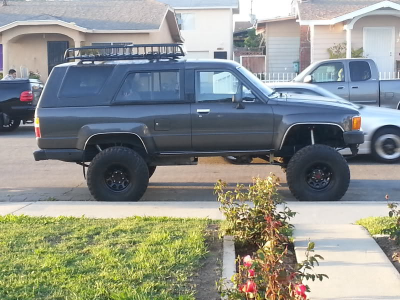

Wow it looks great!! I wouldnt be able to sleep, just look out my window at it!!HAHA!! Im curious to see how your locker works or if you notice a driveability difference. I would like to get a spartan for my rear. Yea that white truck and the runner with dana frontend?? both look sick. Great accomplishment man, and it seems like you stayed pretty steady going and got it completed quickly!! You owe your neighbor some beers!

That thing is sexy dude! I'm really loving the paint color and black wheels. I almost wish I would've went with a smokey grey/gun metal (or whatever have you) color instead of white. Anyway, great job man it looks great.

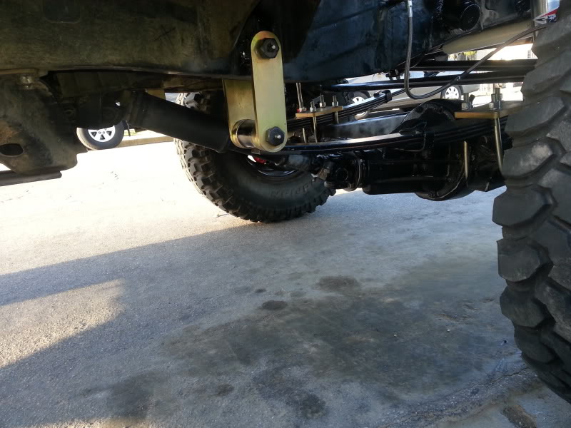

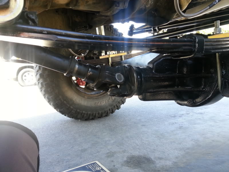

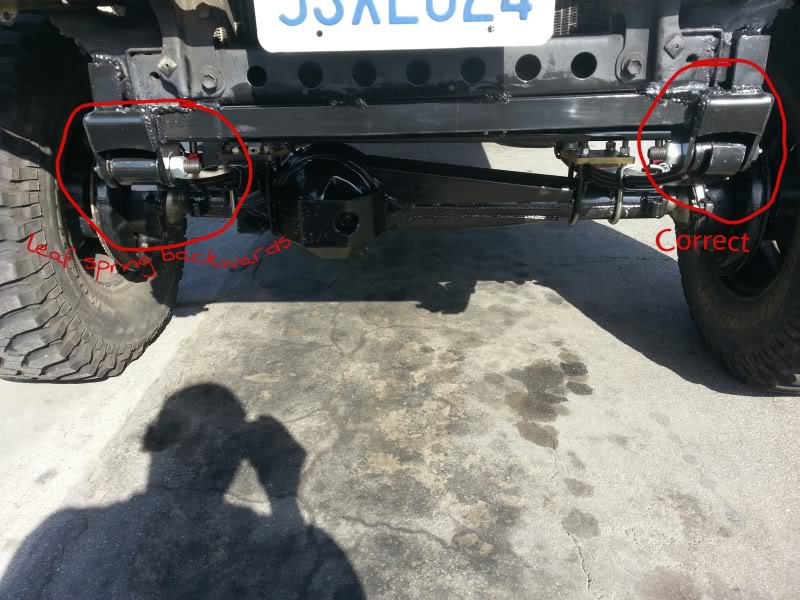

Hey guys. I went to take my driveshaft in yestersay after work. Gonna get it extended 3 inches. And he informed me that one of the joint on the part that connects to the axle was in need of repair as well. He showed me what one is supposed to feel like and then mine and yea I noticed the difference too. So to add 3" to length and repair that joint I'm gonna be paying $150. Honestly I was expecting the total to be somewhere around $250-300. So $150 is a good deal I guess. It will be ready to pick up later on today.
After dropping it off I went home to swap out my corolla for the truck and went to the alignment shop. They were already getting started when the tech came up to me and asked "Where are you getting the work done for this axle? And who is doing it." I told him it was me and a friend. Why? And then he pointed out 2 things to me and said one of your front leaf springs is backwards. And showed me lol. Sure enough it was. I'm sure that would explain why my truck felt a bit wierd when driving. I just assumed it was because I wasn't used to the lift or front axle. Take a look so u see what I mean....
So they didn't charge me anything amd told me to go back home and fix it and just to come back when its fixed. I can't believe we missed that. But I'm sure happy he caught it. The 2nd thing he said was. U see the angle of the rear axle. Obviously how we welded the spring perches to point directly up toward the transfercase. He says look at the front one. And he said. I can still align the steering for you if u want but I suggest u get that front axle at more of an angle or you can destroy your driveshaft. Ruben and I noticed that one last time but we first wanted to see thw angle of the driveshaft first before we tried adding some caster wedges for the spring perches or whatever. The last owner of the axle told me this axle came off an 85 Toyota pickup with a 4 inch lift using those same exact leaf springs. So I figured I would give it a shot and see how the drive shaft sits at once we have it.
So I took the truck home and put the front leaf spring the way it should be. And now that is corrected now all I gotta wait on is getting my Driveshaft from the shop and then make a trip to 4WheelParts and get 2 matching steelie rims. Hoping to get all of this stuff handled today after work. The 4wheel parts store in Compton closes at 6pm during the week. Just need to call ahead and make sure they have the rims in stock before I waste gas on a trip over there.

Hahaha, hey, crap happens! Good he caught that, and still great to have a dude like Roob on ur team! Poor dude is probably wiped out half the time eh? U GUYS ALL WERE I'M SURE!
Good to see u getting it all sorted just right!

nice catch on the springs that likely saved ya a lot in repairs down the road

good catch on the spring. on the drive shafts you dont want a drive shaft that is perfectly straight, it needs a bit of an angle on it so the U joints turn not just spin otherwise you will prematurely wear out the joints. on the sliders get the standered tubeing, on a roll cage our somthing like that DOM is a must but for sliders, bumpers things like that it not worth the extra cost IMHO, spend that extra 50 on some other cool thing.

Dude I had a laugh out loud moment with your backwards leaf. I do stuff like that sometimes and had a few come to memory which made me laugh.
Glad everyone involved is honest so you didn't lose cash.

I'm just happy they did the honest thing and told me about it vs just thinking about the money. Lots of shady places like that around here. definitely showed them i was grateful. and ill definitely be taking it back to them.
Never thought about it that way. Thanks Jason. I get my Drive shaft back today. i'm gonna take some pix once i install it so you guys can let me know if that's a good enough angle or not.

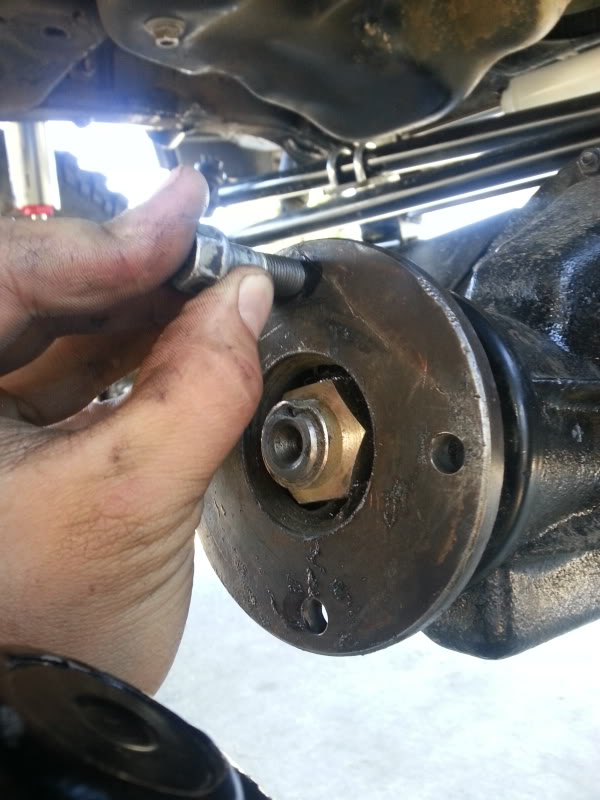

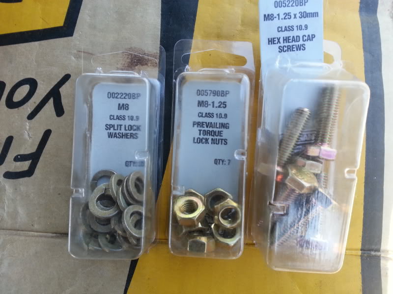

I found a few problems today. the first one was that the drive shaft holes(x4) didn't align with the axle. Why? because this guy(me) is still using the stock IFS drive shaft Check it out.
Looks fine right?
But nooooooo the holes on the axle dont align with the holes on the driveshaft. V6 and 4cyl are completely different! They are thicker they have a different hole pattern. AND THE BOLTS ON V6 ARE THICKER! and will not work with one another see....
Luckily I have both drive shafts. the IFS V6 and the 4Cyl that is paired to my front axle. So here's what i did. I separated both drive shafts. I used my 3" extended drive shaft side for the end that attaches to the transfer case. The other side used the original 4cyl drive shaft end. In the picture below it was what i didn't end up using. but this is just to show you what i did. Once separating we found that the splines inside the drive shafts do indeed interchange and fit in one another. its a perfect fit!

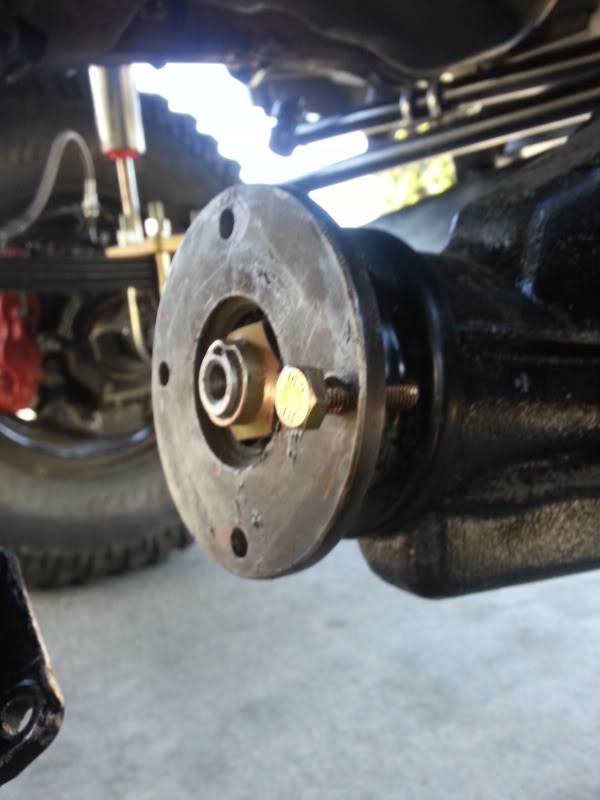

So After installing the new 4cyl drive shaft side my next problem was getting something that would fit the holes on both the D.S. and the SFA.
Ruben told me to go to an auto store and buy some bolts and nuts that are the same length just thinner but obviously not too thin. It has to be something that fits the hole almost exactly. and it has to be GRADE 8 bolts. anything less will just snap your bolts while off roading. So i went to the AutoZone and their employees said they didn't carry them, but they weren't sure how to help me.... so i didn't wanna take any kids word for it when this is my truck we're talking about here. So i called PepBoys, and they didn't even know what bolts were for the drive shaft. i spoke to 2 different people ad neither knew what i was talking about let alone did they even know what grade 8 bolts were lol. Goes to show how much these 2 companies employees know. Last resort i called Penske Toyota in Downey.... and this was the biggest disappointment of all! They found the right bolts and nuts. AND LIKE ALWAYS IT HAD TO BE A SPECIAL ORDER! not only that i so got a kick out of this. He said the Bolts would cost $14 dollars. then he said that's not including the bolts. and then he said the nuts would cost somewhere along the lines of $3.50. And then i said ok not bad, so about $18-20 total right? and he replied. OH NOOOO that is $14 dollars per bolt and $3.50 per nut. I wasn't sure whether to laugh or be mad lol Then he paused and i was like oh shiet! he's serious! hahahah i was like no thank you good bye. After i remembered about the O'Reily Auto Parts near where i used to live. So i drove down there and told the guy my story. He literally ROFL'd and took me to their bolts and nuts section where he fitted the correct size and nuts and crush washers. My grand total came out to $13.05 for GRADE 8 everything. Just goes to show you guys that dealerships is not always the way to go. DAMN STEALERSHIPS make me soo mad sometimes. but its better to laugh about it hahah
So when i got back home i installed to hardware and it was a perfect fit!
Here is the size difference
No fit...
Yes fit

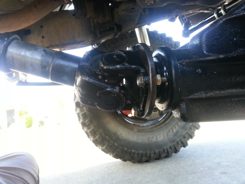

Here's how it all turned out.
And here is a better picture of how the drive shaft angle is. It really isnt too bad. i thought it'd be worse. But i had Ruben take a look at it. and he said his 85 and his sons 87's are both the same angle and theyve been wheeling like that for many years. and wheeling them hard and have never had any problems. So this is how it's gonna stay for me.
