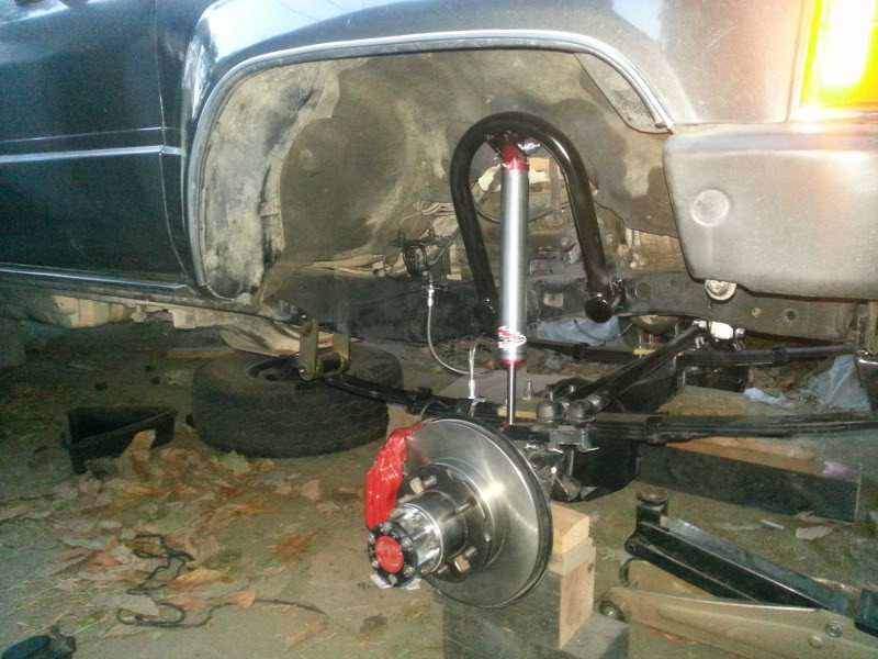

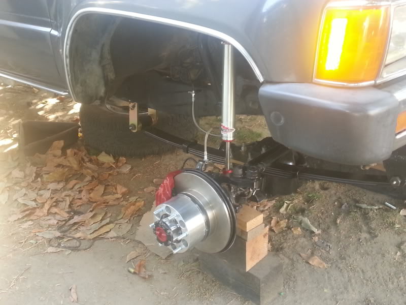

Today I finally got around to painting the Hy-steer bars and axle armor. Not shown here in this picture but we also got the steering stablizer installed as well. Doesn't that look BEAYOTAFUL!?!?

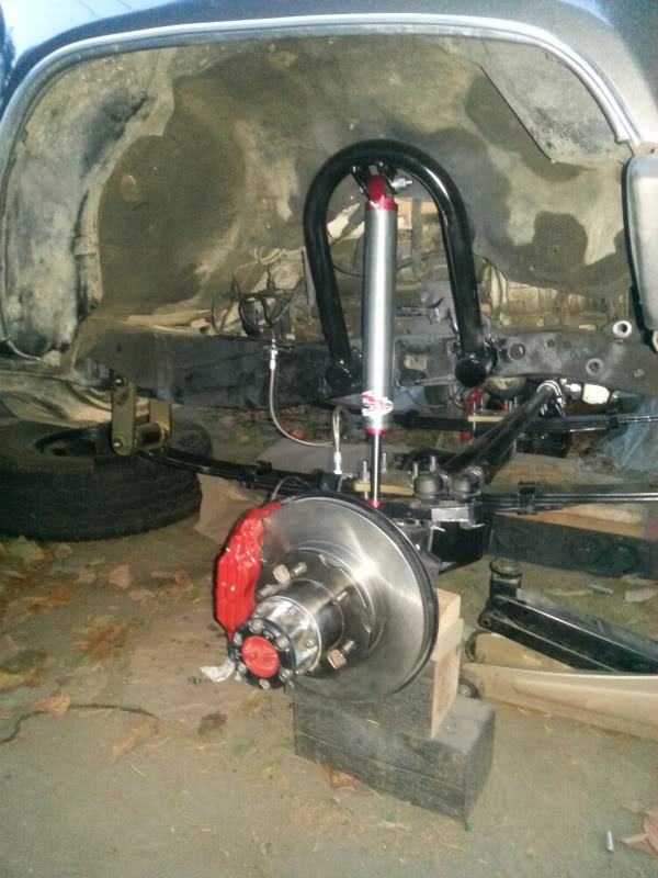

We also got around to welding the shock hoops painting them and then gettong those sexy Walker Evans racing shocks installed. Woooooot! We also ran the extended brake lines. Ruben had weld on the old ifs brake line holder with the clips to be able to hold the brake lines in place. You'll see in the next pictures what I mean.
Pure sexiness! Seriously loving the results. It looks great!
Just realized I missed a bit of black spray paint on the right side of that shock hoop lol! Ill get it tomorrow.

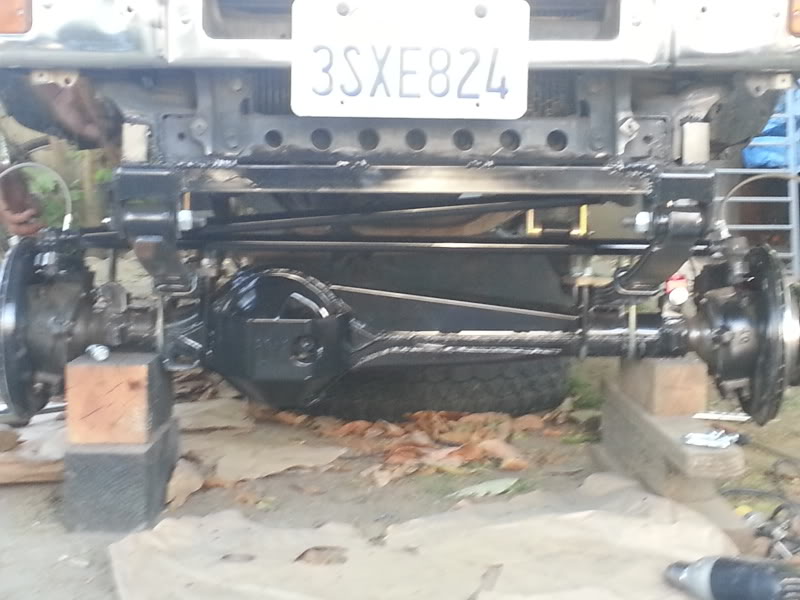

We also checked to see how much I'm going to need to extend my front drive shaft. Turns out I need to make it about 3" - 3&1/4" longer. We can't tell how much we need to extend the rear drive shaft till I get the rear 3rd member back from YotaMasters this coming saturday. So after that we're pretty much done.

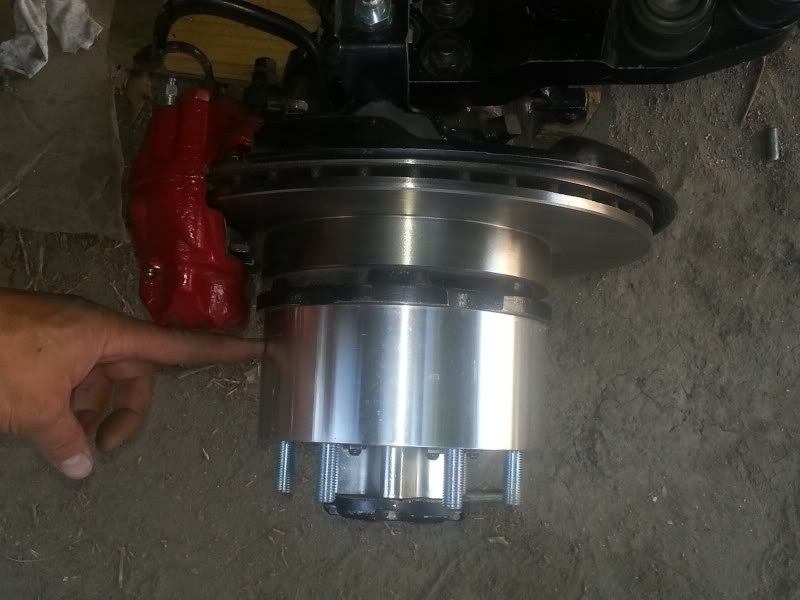

Got the huge A$$ wheel spacers on already.

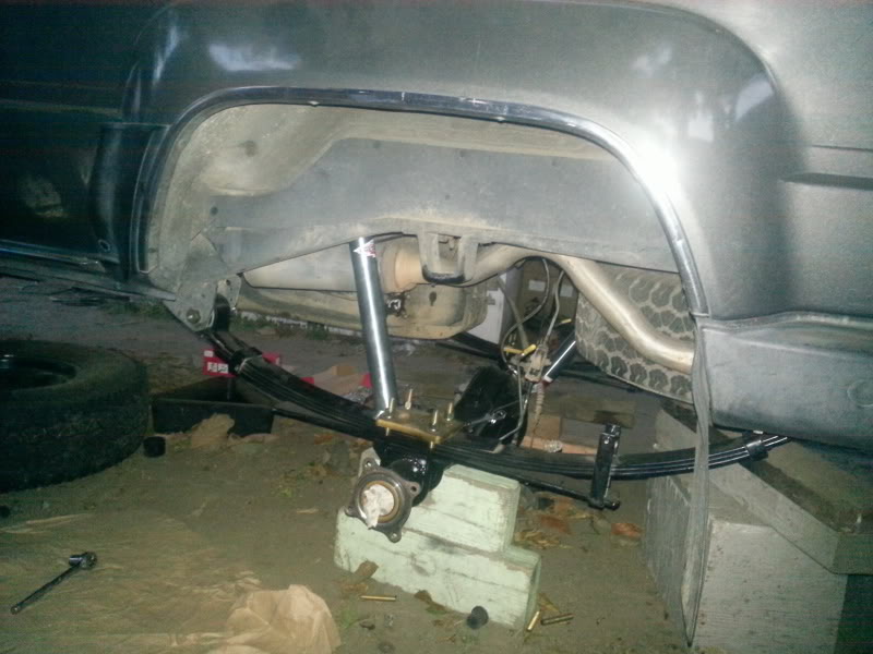

Guys Wheel spacers are a must if you plan to use the V6 caliper. Look at where my finger is on this picture. and you'll understand. Obviously you dont need to go as wide as me. Only reason im using 3" spacers is because the guy i bought the axle off of included them. But 1" -1.5" is all you really need. 1.5" is standard in Axle swap kits. if not i think they sell them for about $70ish.

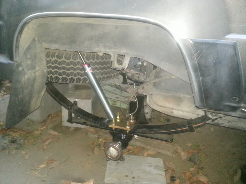

Ruben Welding on my new spring perches.
He also had to semi Fab a longer bolt only this piece here. It has to do with my Ebrake. mine was too short so he added on another 3 inches or so by just welding on another bolt lol.

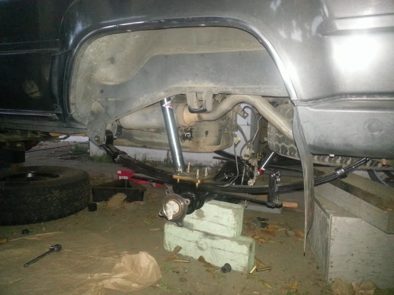

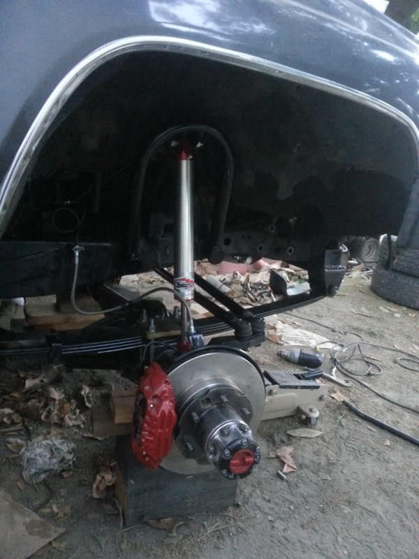

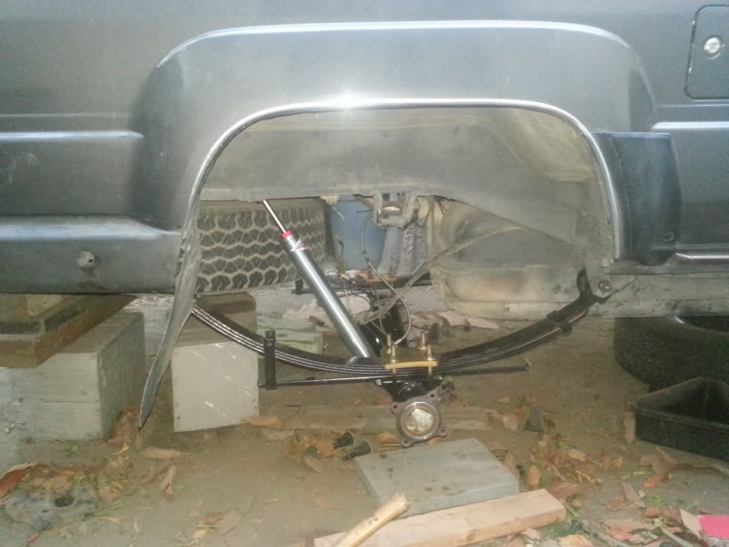

We got my Rear 12" Travel Shocks in now! Gotta say these were much harder to get in then the front!
Passenger Side:
Driver Side:
