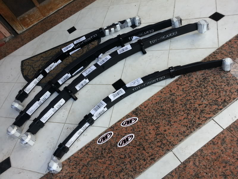

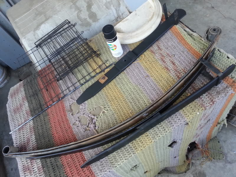

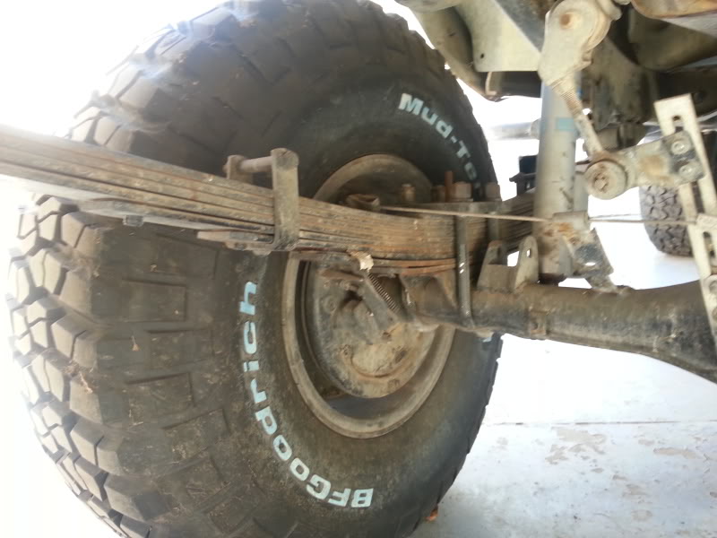

Alright guys so yesterday I took a look at Rubens pickup's rear leaf springs and I seen that he did not have the overload leaf. What he ended up doing was just adding a leaf about 3 or 4 leafs up (in the middle)
Here is his

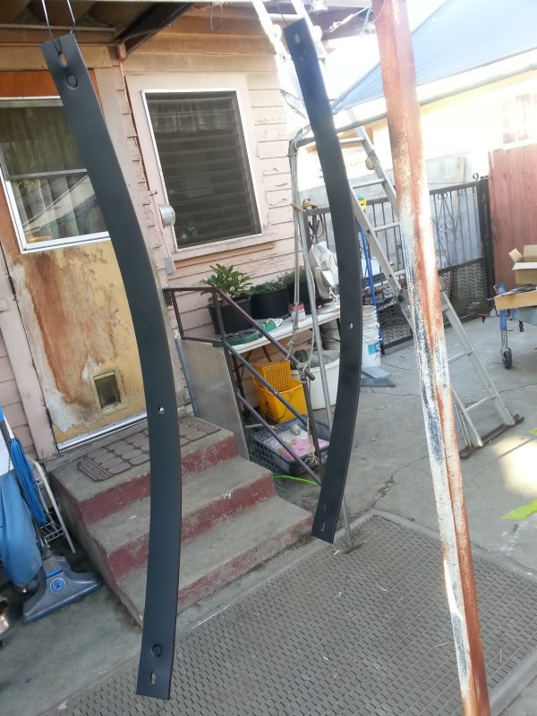

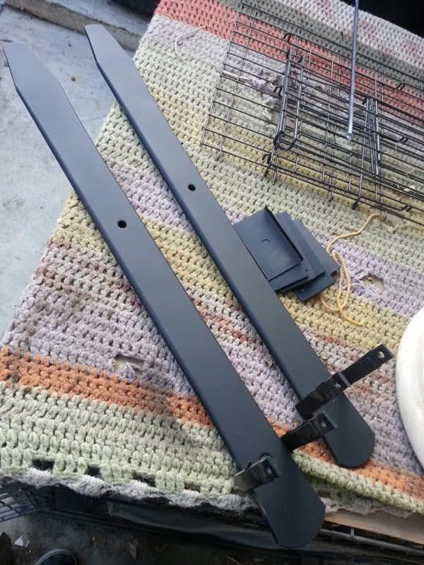

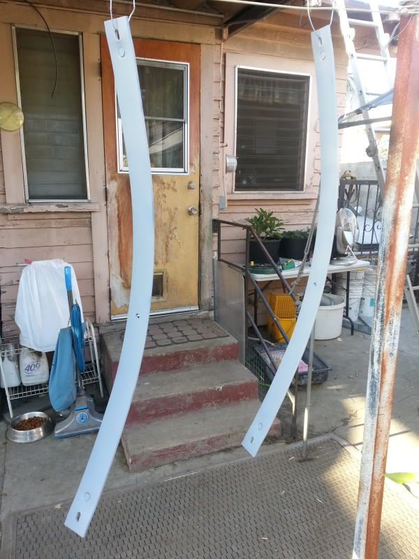

So this is what I plan to do. After I looked at his pictures I now know that I either need an overload leaf that is curved or add a leaf in the middle of my all pro springs. So the all pro springs are not as arched as the ones that mount to the stock hangers. So what I'm gonna do is stick one of the stock arched springs in the middle of my all pro springs and that should help the all pro ones give me that extra bit of height. I'm still gonna use the overload spring even though it ain't bent. That spring is a 1/2" thick and I'm sure that could help me some as well in adding a little height. And because it is completely flat it won't interfere with the performance of the all pro springs.
So I plan to use the bottom 2 springs and the 2 small plates in between them. See how arched these are?
Now look at how flatter these are due to being longer leaf springs. (The middle 2 are for the rear)
I was really considering using 2 of the old 4" lift rear springs but I wanna sell the old leaf springs so I decided to use the ones from the stock set.
So these are the ones I'ma put in the middle of mine. And I might still use another. I gotta look it over more because I don't wanna ruin the performance of these springs either. I can possibly cut off the other 2 top springs where the "eye" is for the shackle bolts. and somehow use those as leafs as well. i think that might possibly work better then having a flat overload spring. and this way i'll have either 2 or 3 more springs that are more arched to assist with the rear lift. Also considering using 5" longer shackles from all pro vs the 4" ones i have now if this experiment doesnt work out. Someone also mentioned that i could possibly use blocks in the rear. but i dont really like that idea too much. We'll see what happens.
And I've already cut off the straps so they don't interfere with anything. Ill let you guys know what I decide. On. I'm really hoping this fixes the problem. Hoping to get it all done today.

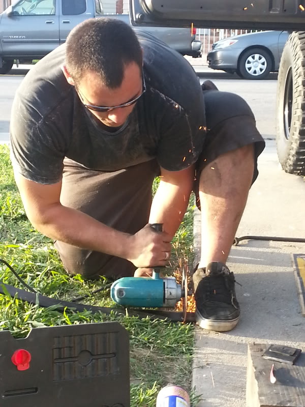

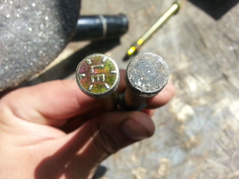

First off I'd like to say that doing this isn't too hard of a job. Its just a total pita when trying to re-align the spring with the axle because once you drop the axle it moves forward or back. Nothing a little kicking can't fix lol this is my 3rd time putting springs back on so I'd better be a pro by now haha.
Anyway here are the pix.

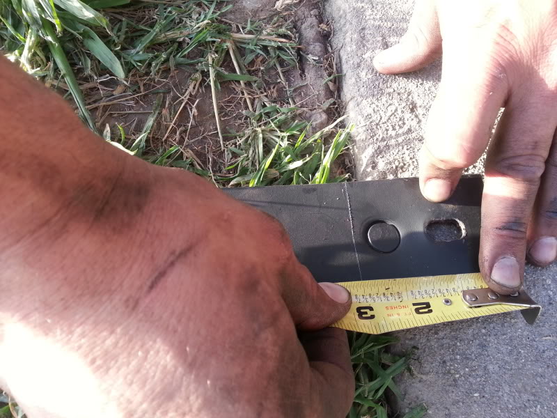

First thing was to round off the new grade 8 bolt end so that it is able to fit into the spring perch on the axle. The left we have the new bolt and on the right is the old.

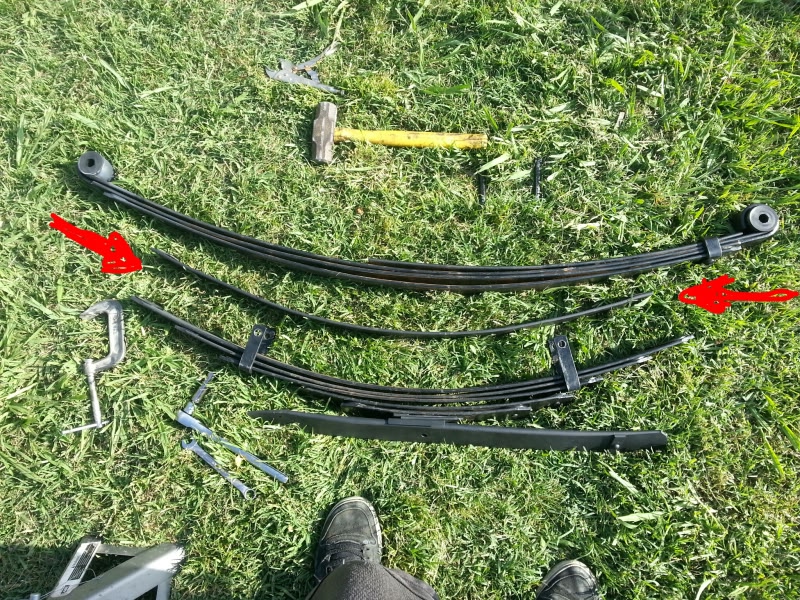

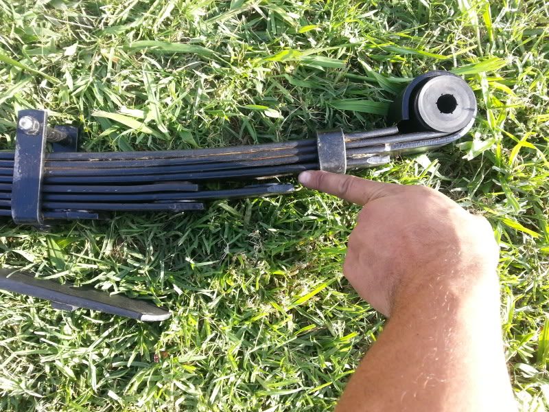

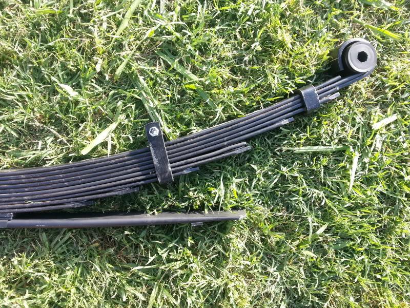

Once you have the leaf spring removed use a C-clamp to hold the leaf spring tightly together so you do not have any pressure on the bolt and nut while you remove it. In order to remove the bolt use a socket for the nut and pressure pliers for the round bolt. Once you take off the bolt that holds everything together then take out the straps on each side of the leaf spring. then loosen your C-Clamp. When you remove the C-clamp your whole leaf spring will come undone and look a bit like this.

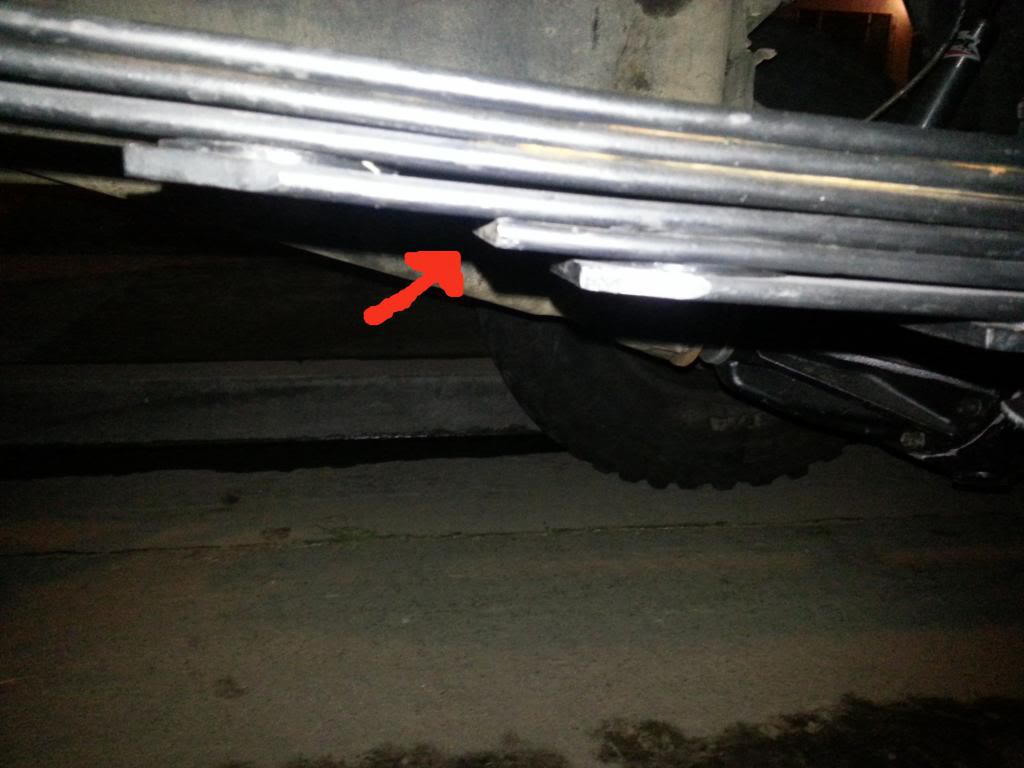

As you can see The leaf with the arrows is the one i added in the middle of the leaf springs. I also added the bottom poverload spring that you see. In order to re-align and re-tighten the leaf springs make use a longer bolt then what you plan to use so you can tighten them down and compress then with a c-clamp after then you can go ahead and swap in the actual smaller bolt that you plan to use.
As you can see... I ran into one little problem. I came up short on the spot where I placed my extra leaf.
This simply will not do.

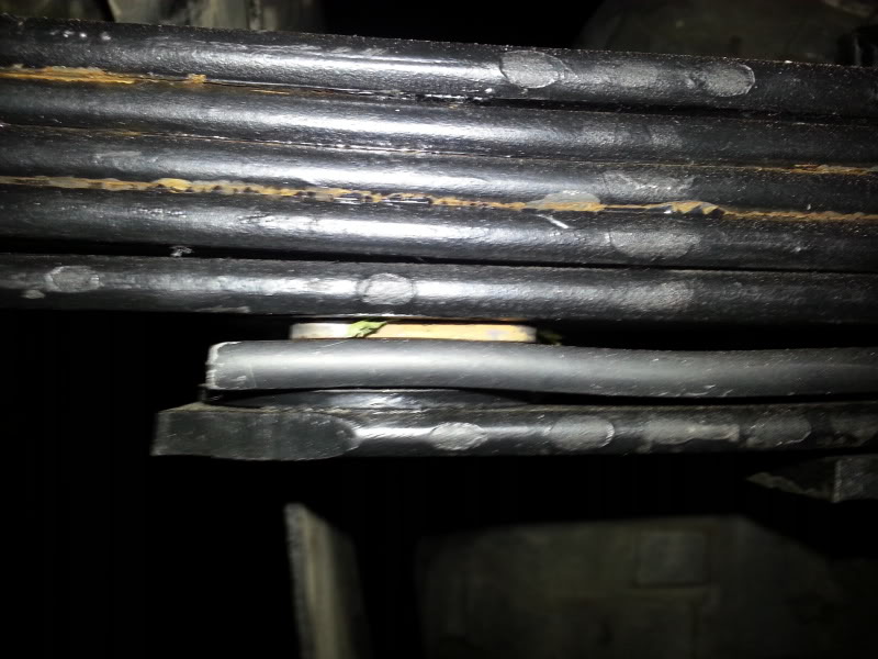

So I took the leaf springs apart yet again and moved my additional leaf down more spring. Then it turned out my spring was too long after. So I had to cut off 2&3/4" on the longer side of the leaf. The short side was perfect length.
Problem all fixed. They came out looking great. Just use the longer bolt again to align the leaf springs and c-clamp to compress your springs. Once conpressed swap out the longer bolt and put in the bolt that you rounded in the beginning. Once the bolt is tight you can put your straps back in and remove your c-clamp

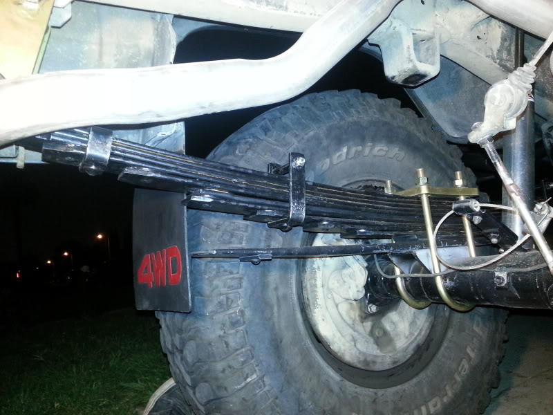

Here is my finished job already installed.
The only problem with doing this is that since the leafs are stacked up pretty thick your parking brake line won't fit correctly. It'll only fit while going either over the top or under the leaf sping. It'll stay slightly pulled even though its not engaged if you try to connect it. So I left it disconnected for the time being. At least until I figure out a way to mod the place where the brake line connects to on the drum. I need to make the lines a bit higher to clear the leaf springs so I can run it along the top of the spring. I'm thinking that I might also need longer brake lines. I need to inspect it some more. So as of now my parking brake is 1st gear. At least till I figure out what I can do.
I gotta drive the truck around this weekend. And see how everything performs. Once I use them and flex them I'm sure they'll break in to the height they're gonna stay at.

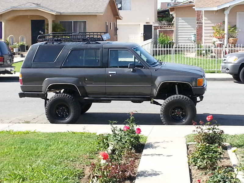

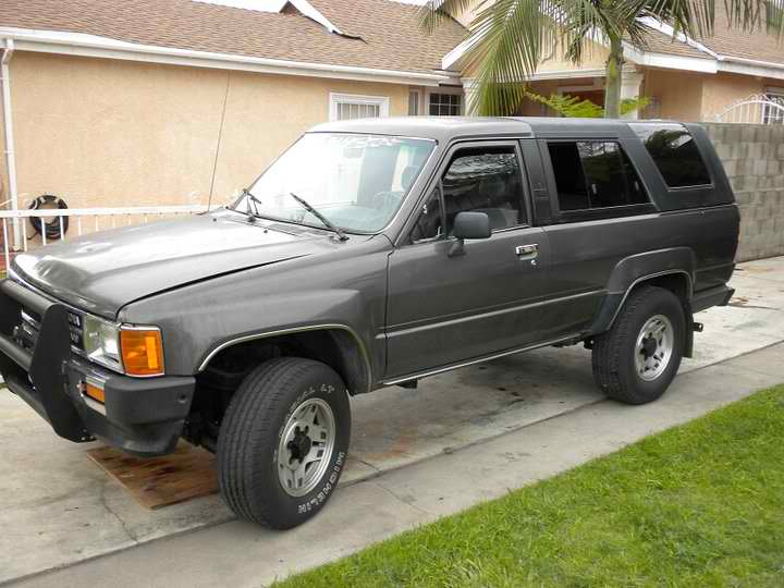

Here ya go Mr. Ed.
This is prior to messing with the leaf springs
And this is after

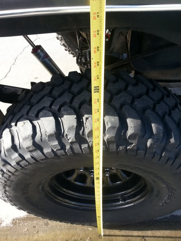

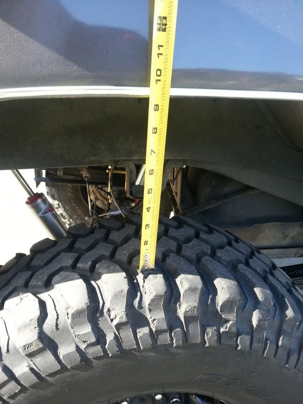

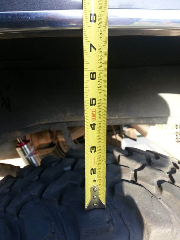

Measurments from the tire to the fender Before and after
Before: when the leafs were first put in it sat at 7&3/8"
After: now it sits just a lil' bit over 9&1/4"( the truck was slanted due to the gutter so i went ahead and measured the driver side as well and that one came out to 9")
So by doing this mod i got about 2" - 2&1/4 more in height when compared to when i installed the All Pro Leaf springs brand new.
Also Here is a picture from the ground to the fender. It's about 41&1/8"
EDIT: I edited the heights lol. I totally got that wrong the first time around. its all set now.

Today i got tired at looking at the Previous Owner's super crappy and ugly purple tint job. So i peeled it all off. I went to pep boys and bought some new tint and a sticker removal spray to take off all the tint residue.
Letting the solution dissolve the the sticky stuff. Then just give it a wipe down. Once i wiped it completely clean i outlined my new tint and cut it with scissors. Peel the tint from both sides and wet both the glass and the tint film(wet the sticky side) i used a water with dawn soap solution. My dad has used that for years and has never had bad luck with bubbling or peeling. After we placed the new film on the glass we used some hard rubber wedges to squeeze all the water out from between the two and direct it away from the glass. Here is how it came out. I'm satisfied.
Here's the only before picture i have of the rear from before. i should have taken a picture before peeling but i forgot. as you can see there is a big chunk of tint missing from the middle of the window. And yo ucant really see the color but i'll have Mark as my witness, i it was purple! And that drove me crazy. Now its more like a smoky black. it looks clean

Haha i agree. She's looking good now. i really hope she doesnt sag again after 1 week.
Hey Will, Will i still have the problem you're talking about if i have the leaf spring spacers on the ends? like this one here is on the rear side of the leaf spring:
The front one doesn't have one due to me cutting it off. This is the only side i would imagine i would have a problem with because it has no spacer.

the spacers arent they're slide pads i forget the proper name anti friction pads or something
they keep the spring ends from grinding on other springs ya may have squeaking scrunching sounds till the end wears in
Oh alright. Thanks for that info man. So even though the one side doesn't have that pad after it wears in will I be safe? Or do I have to worry about some freak accident like it digging in the leaf spring above it and possibly snaping while driving? Lol

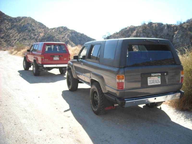

You're welcome Ed. How high is your truck sitting at? And I agree with you. Its definitely been a huge transformation since the first days when I bought the truck. so hard to believe it looked like this less than 2 years ago.
